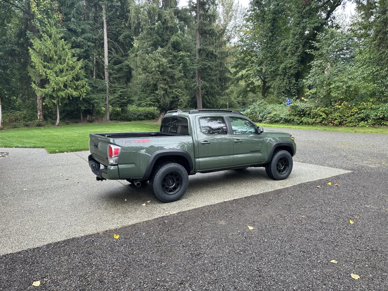

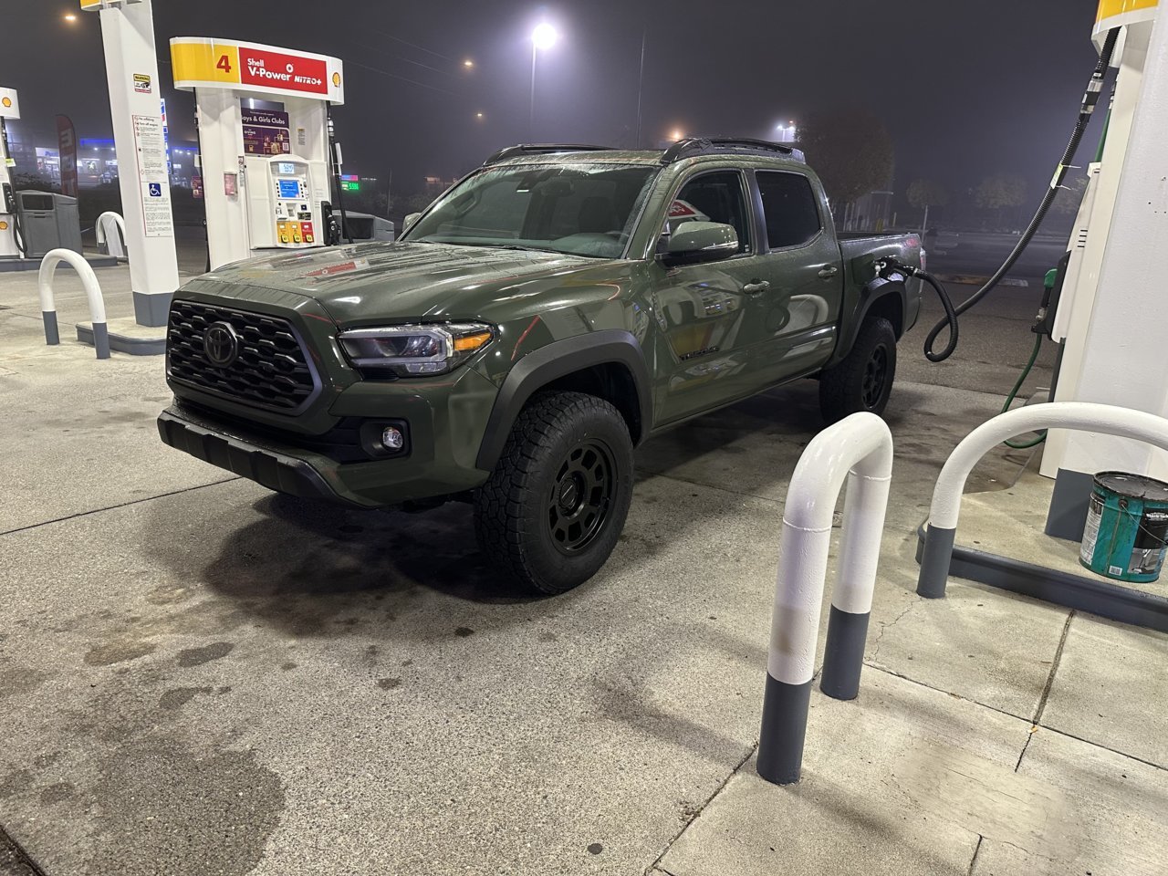

    upload_2023-9-20_19-14-14.jpgupload_2023-9-20_19-15-9.jpg265/70R17 Toyo ATIII on 17x8.5 0 offset Methods. Bone stock truck no rubbing.
    Discount Tire[QUOTED] likes this.

    @Kbar and a fantastic looking Taco! Love that set up!
