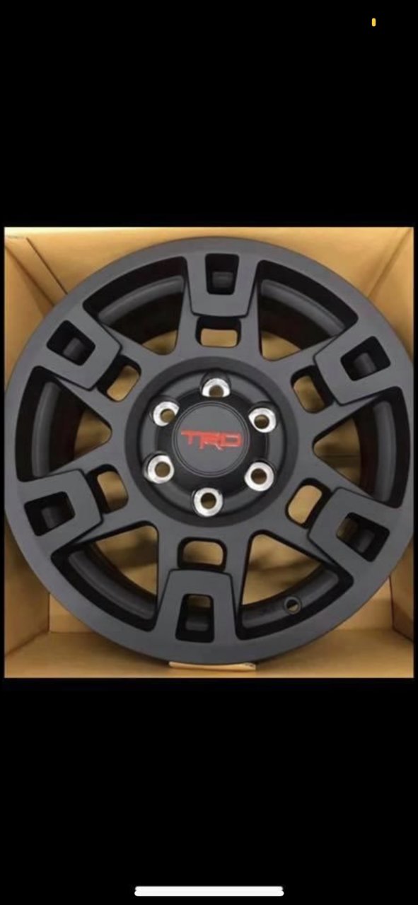

    Hello!
    I'm new in all the mods world.
    Just got a 2017 tacoma trd sport
    Can I fit 17x7 wheels (trd pro)
    On the stock tire 265/65/R17
    thanks

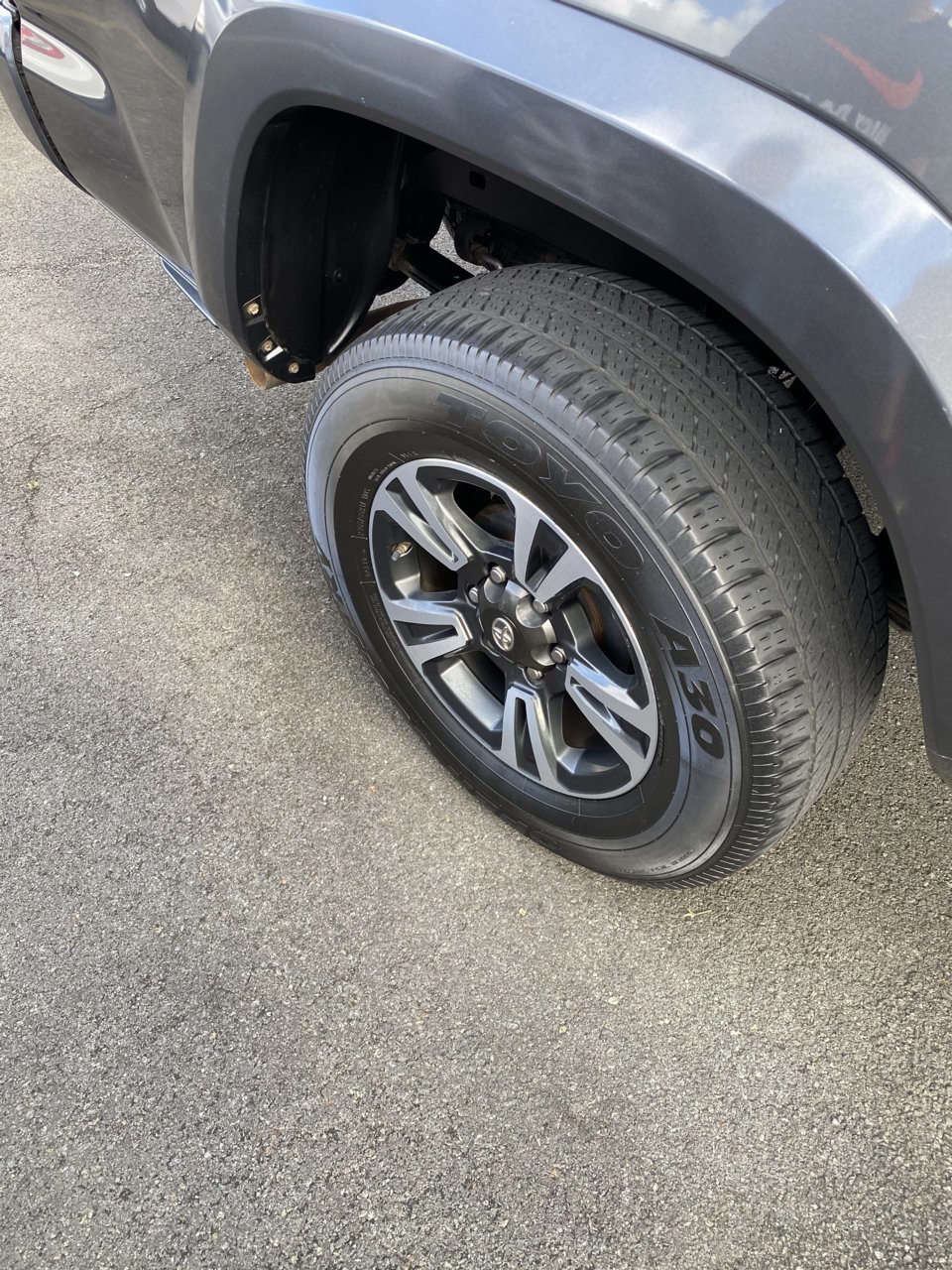

    Tacoma 2017 trd sport

    Yes, no problem. There are 16” TRD pro wheels out there, so as long as you have 17” pro wheels, you’re good.
    if you want bigger tires, 265/70R17 also fit no problem.
    And welcome :wave:

    yes. without even blinking an eye. could go up to 265/70/17 and be perfectly fine as well. in actuality since thats a 4runner wheel originally the t4r uses 265/70/17 as stock so itll look right at home.
