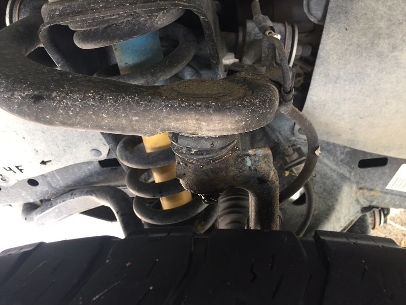

    What size tires are you running? And how much clearance is there on the UCA?

    Stock 265/65-17's. I'll snag a photo of the clearance tomorrow for ya.

    Clearance is roughly 2" between the UCA and the tire.

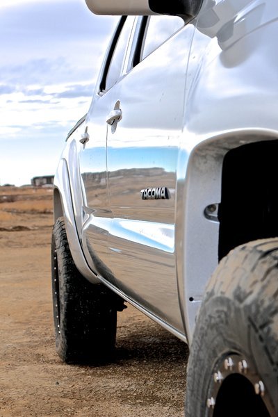

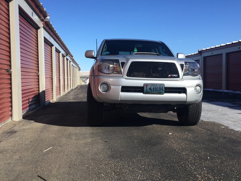

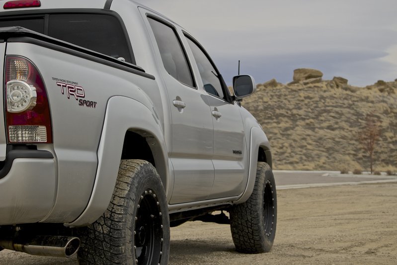

    Here's two shots that give an idea of the poke. I really like the stance of the truck now. I'm stuck between 265-70's or just getting 285's.
