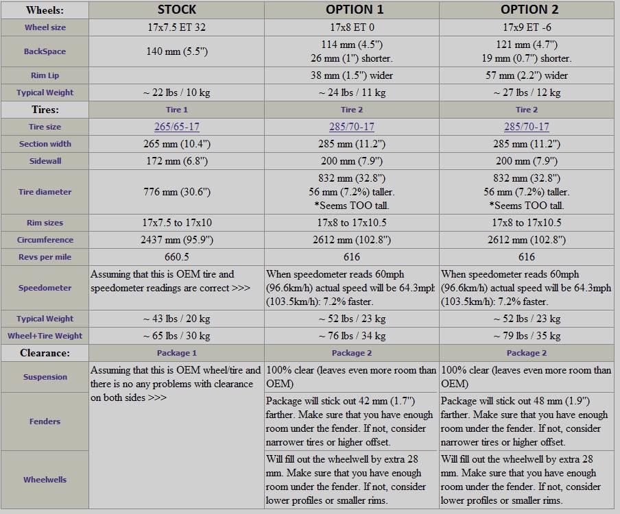

    So I want to get the procomp 7089s. Ive searched through the threads but can find the answer I'm looking. How far out will 17x9s stick out compared to 17x8 running 285/70/17s, and are there any advantages or disadvantage to either?

    Maybe this will help you...assuming you are going from stock rims to these....

    Great info AWorthyOpponent, thanks everyone for your input! And yes I'm going to lift my truck, should get my ULK and rims/wheels this week hopefully!
