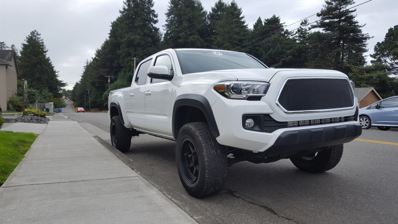

    17x8 -12 offset 4.5bs 285/70 17

    See 8 works well with the minus 12 think the 9 will look little to zombie apocalypse for me
