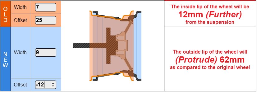

    To give you the specs, if you were to put a tape measure on the outside lip of your stock 16" wheel and measure out 1.5", this is where the outside lip of the 9" with -12offset would sit.
    the 265/65 size is going to help however its still possible you would need to modify/remove the mudflaps
    If you would like to measure out from your stock wheel and confirm if this is about where you would want the new wheel to sit, then that fitment would be the right one. If that is to far out and you would like to let us know where would be ideal for you, we can help match up your ideal stance with the right wheel specs.
