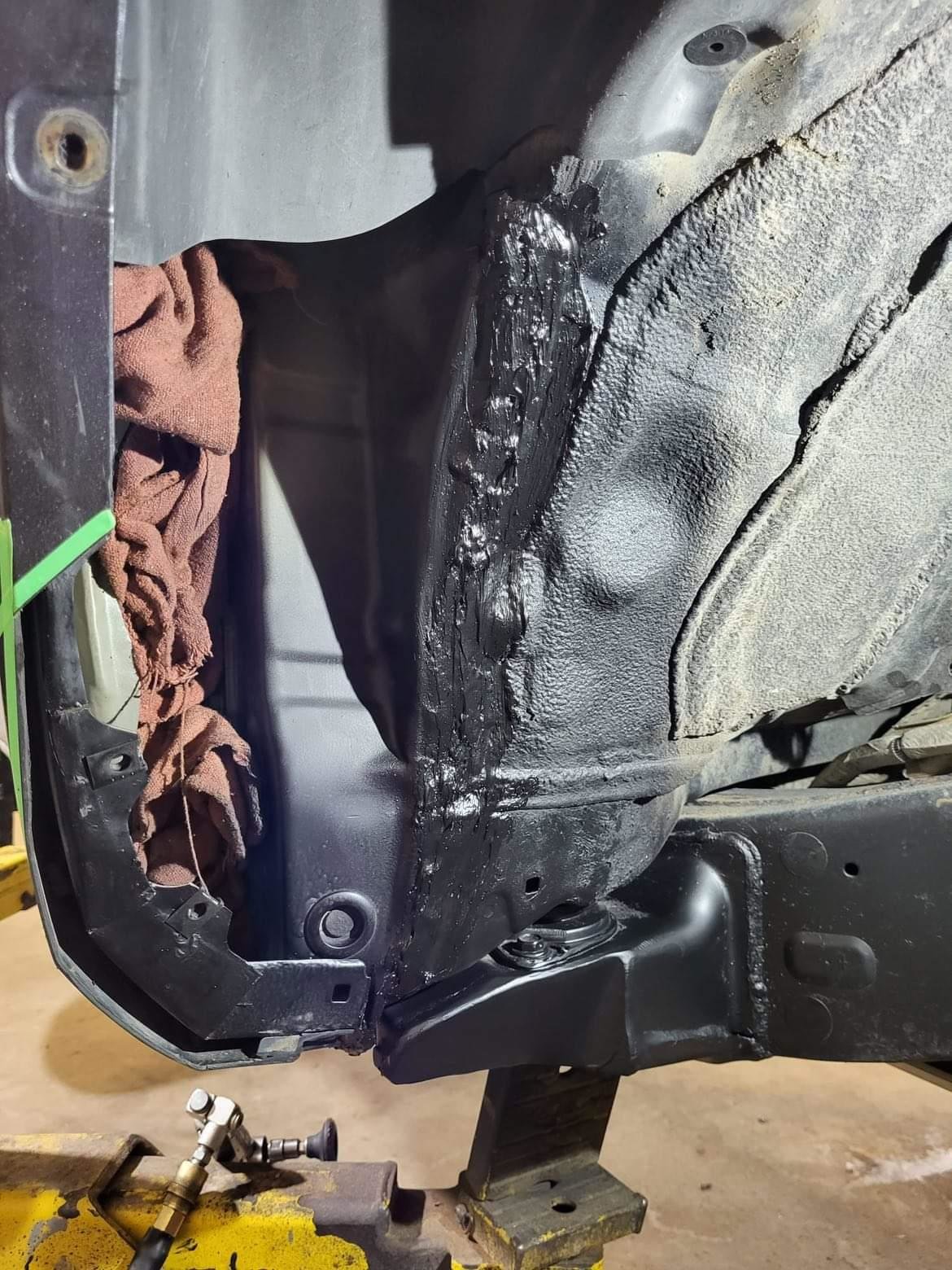

    Yep find a reputable shop that will clearence the truck only way your getting it to work. Especially a 12.5 tire. Forgot to include the fender liner trim and tuck up front.
    That's the chop job I had done before the section of fender liner was replaced.

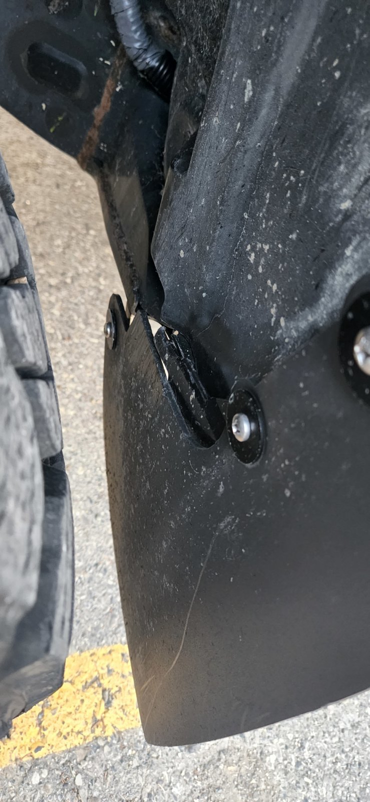

    Rub lines with same lift and alignment. No issues on the cab mount but it would kiss the flap once in awhile. That's a 285 on a 17x9 +1
    Fitment of a 17x9 -25 295.
    Just remember this can be a problem with high negetive offset wheels
