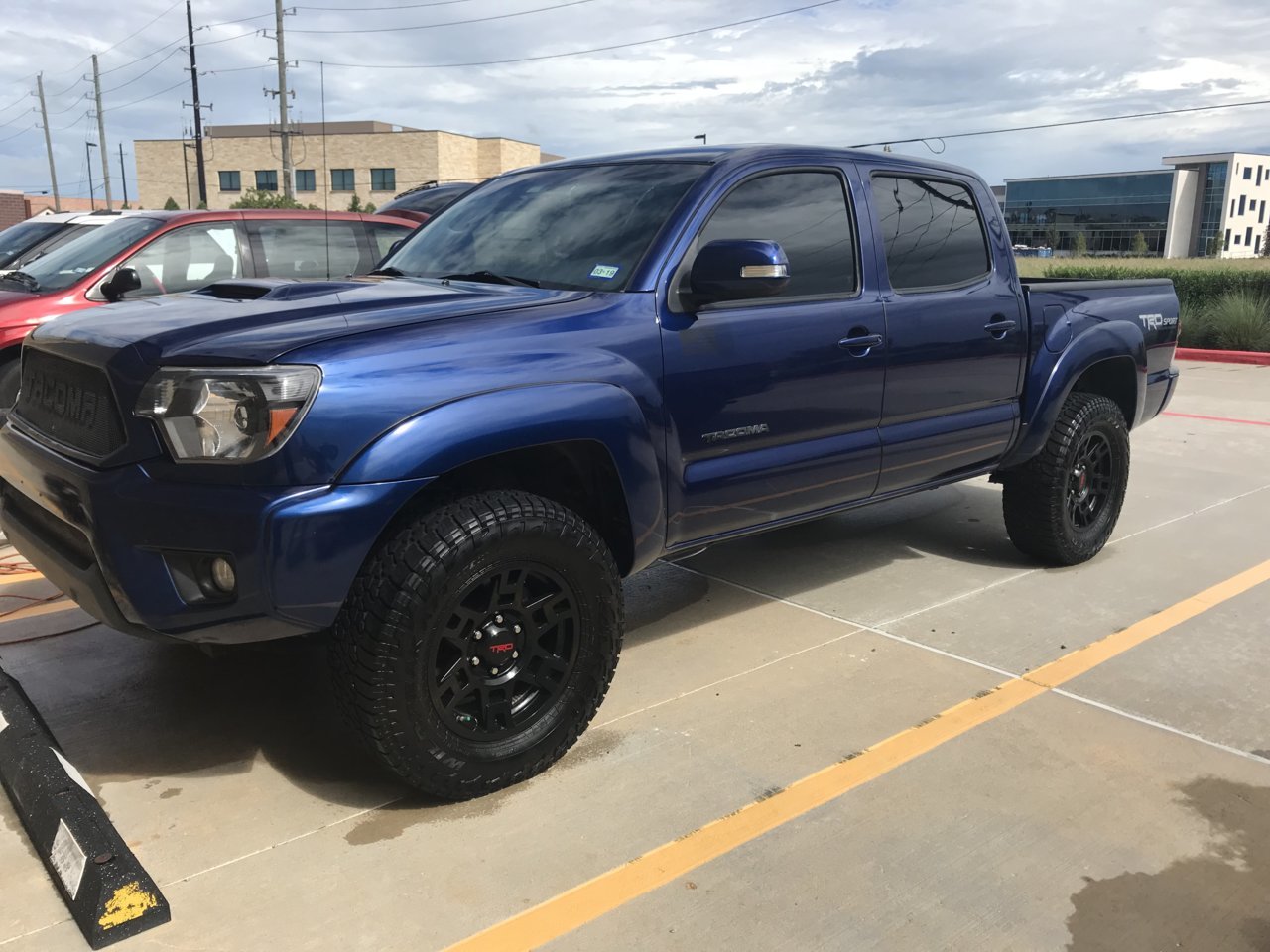

    Hey OP, for what this information is worth i have the Ray 10’s with BFG KO2’s in a 285/70/17. I do get some minor rubbing when turning the wheel all the way, turning into an uphill drive, and turning while reversing etc. it’s not terrible (been running it like this for about 6 months) but i am planning to fix mine with the TRD Baja lift kit. If you need any more pics or have any questions just let me know!

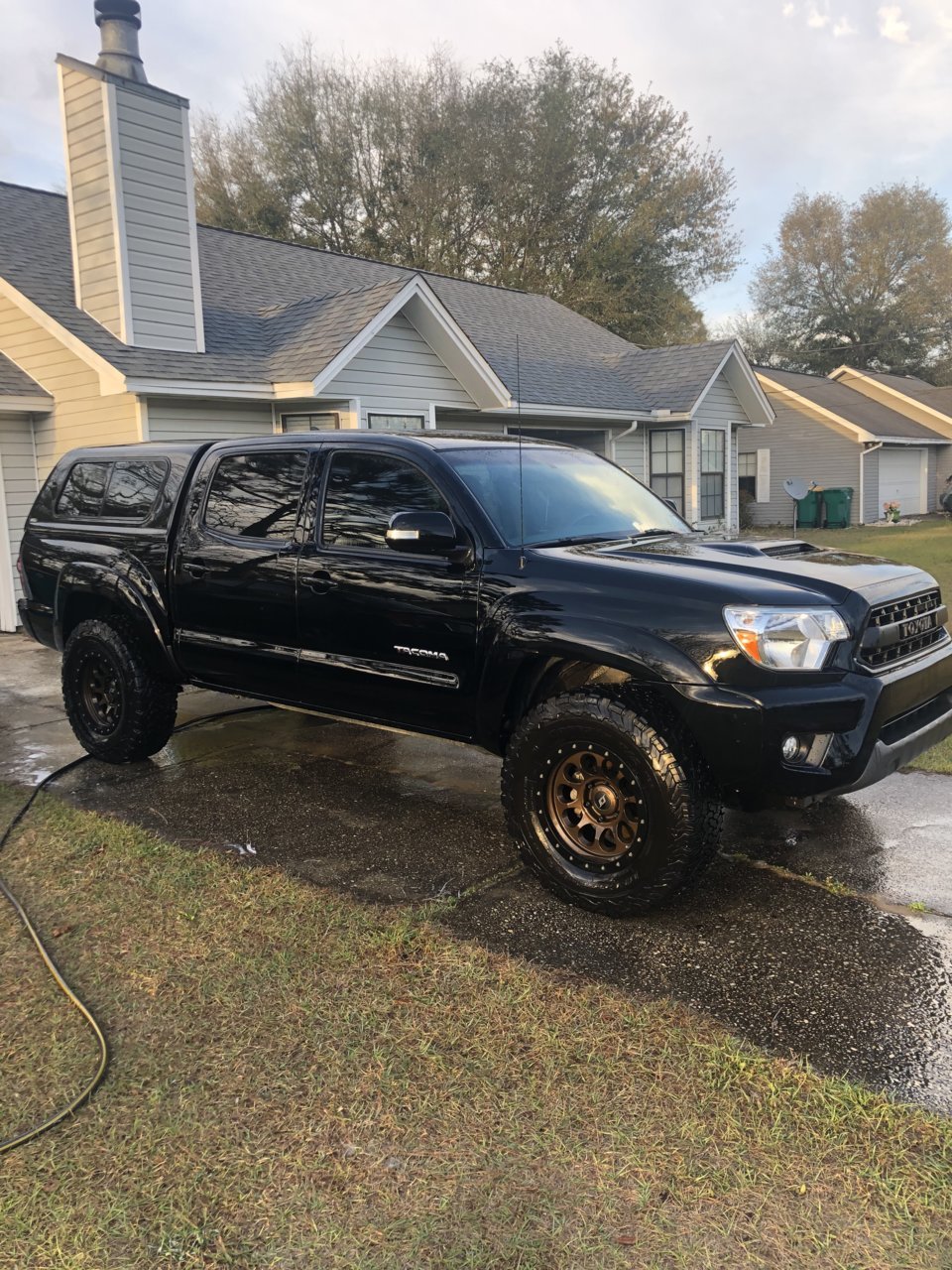

    Not running Ray10s.....I think my T4R Pro wheels are the same size :)crapstorm:), I run those tires and only had rubbing on the little front mudflaps. Took those off and all good. Stock suspension. :notsure:

    So sexy, my truck is black as well, are those brushed copper or the bronze?

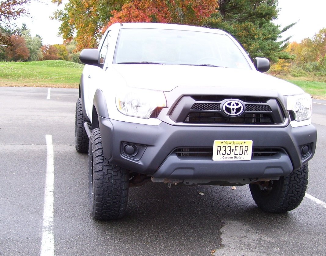

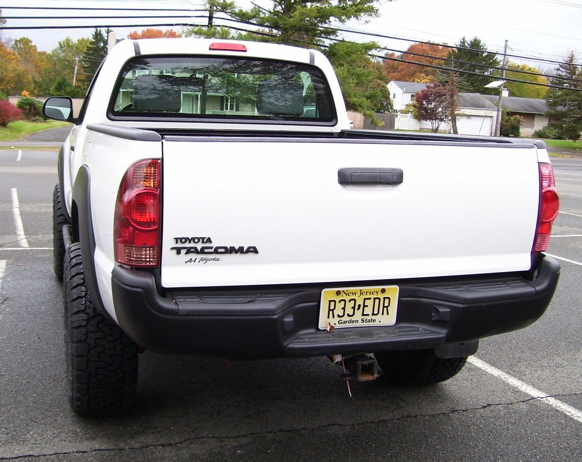

    I would guess they are going to rub. I have the17x8.5 with -12 offset but I have 305/65/17 tires and 3" lift and get a little rubbing at full lock on the chassis mount. You would be better off with the 17x8.5 and -12 offset. Here's a couple pictures of mine but remember, the tires are 305's.
