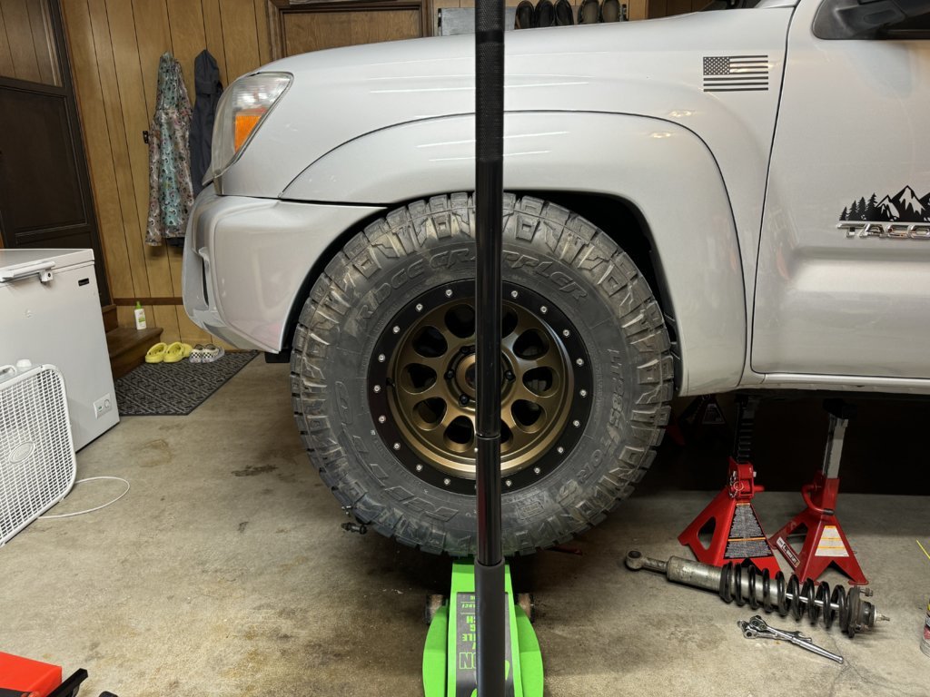

    I would advise checking the SCS thread linked above.
    I have 285/70r17 Nitto ridge grapplers on 17x9 -38 Ray 10s. It rubs.
    For street driving I could (barely) make my way around town without the body mount chop. With the body mount chop and hammered pinch weld, I have enough clearance for mild off-roading. If you plan on stuffing the tires off-road fenders will need to be trimmed. This picture is before the LCA made contact with the stock bumpstops.IMG_7314.jpg I only have around 1.5 inches of lift so my LCA’s are able to be pushed as far forward as possible.
    Oh and fender liner and bumper need to be trimmed as well. 15 min with a knife, drill, and zip ties can fix it.

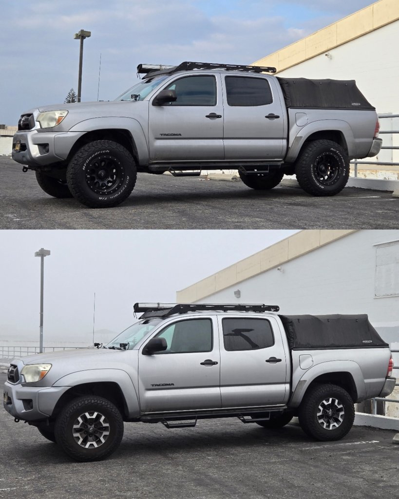

    Went for it. Cmc and some plastic cutting but nothing crazy.

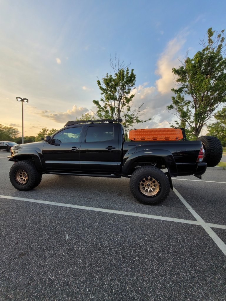

    285/70 r17 on 17x9 -38. CMC, pinch weld flattened, AVID UCA, on a 2" lift.

    Is your spare on one of those hitch mounted swing outs? Got any more pics? I want one but I’m afraid it’ll look weird so far away from the body.

    Yeah, it's a hitch mount swing-out. It does sit quite a bit back from the body, but I like it because there's room to stand on the rear bumper step. I'll see if I can find some more pics.
