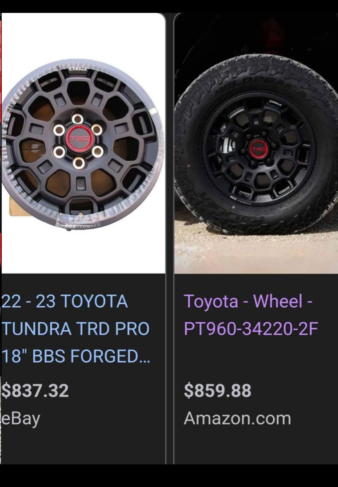

    IMG_1306.jpg Will these fit on a 3rd gen Tacoma that is lifted? I read that they have a +56 offset. I really like the way they look but just don’t know if they would work with my truck. Sorry, I’m new here I hope I’m not doing this wrong!

    I should mention I already have 18” wheels on my truck that came with it when I bought it used. I’ve got the Toyo Open Country AT 285/65 R18 on them right now

    If I remember correctly the center bore is different (smaller) So, no they won't fit. You can Google or go on Toyota site to confirm.

    Yup center bore is like 95mm, where your Tacoma is 106.1mm. So unless you have them open them up in a machine shop, you can't run these.
