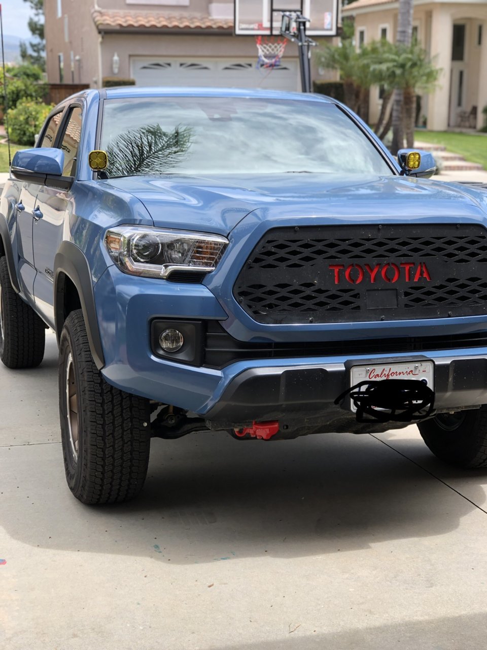

  12. Jun 15, 2019 at 9:13 PM
    El_Rocinante
    El_Rocinante Well-Known Member
    May 3, 2018
    #252467
    417
    Pete
    2019 Cavalry TRD OR dcsb 4X4
    I run an empire grille on a 2019...only had the tss freak out in a downpour in February we seldom see in California. No false brake, but idiot light came on saying tss was unavailable. Hasn't happened since...stock suspension. B043AA94-9636-4823-8AA6-E8F04DCFB90D.jpg
    WSchafer[QUOTED][OP] likes this.
