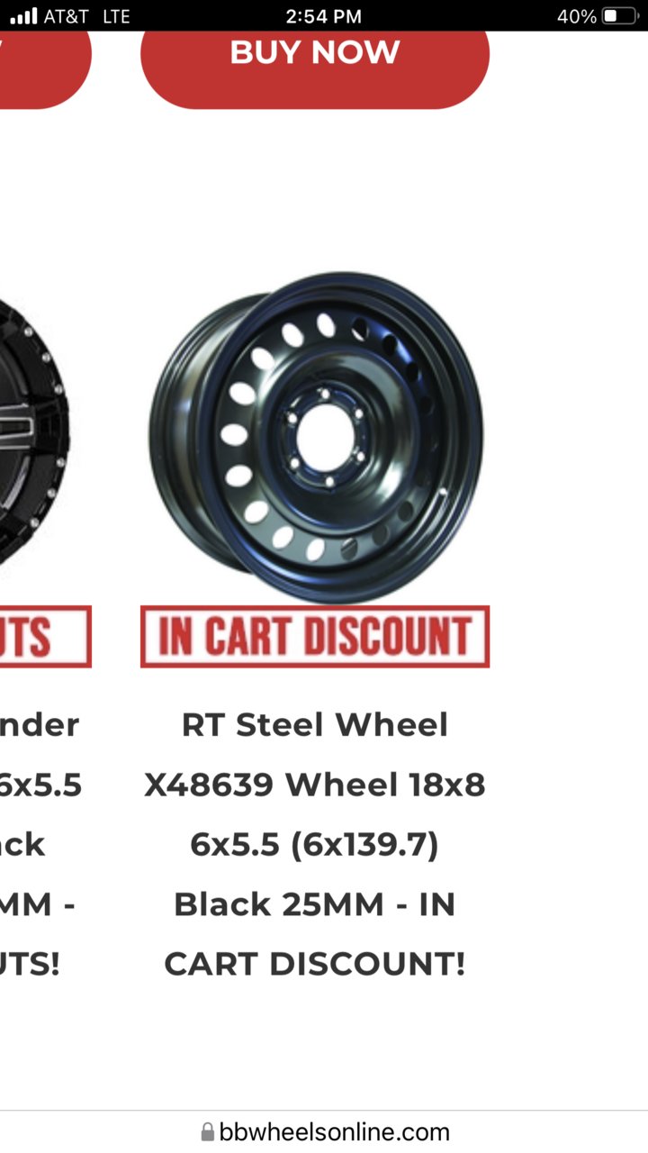

    Link to what you found?

    The only issue may be the +25 offset. That’s a 5”bs. May make it a little tight on the uca.
