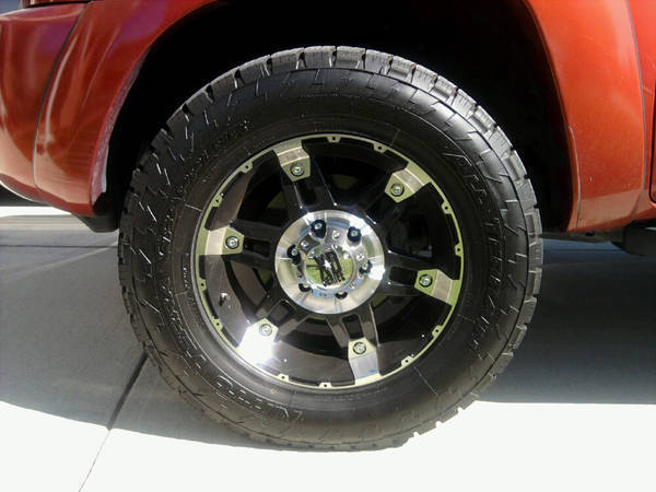

    Mine arent MM but I have 18x9. The only issue I had is I had to remove the front mud flaps. No rubbing (no lift either). Although I think they would look a little better if I had gone with 17's. Its up to how you like your tire to rim ratio. If you want 18's they should fit.

    They should fit with the right backspacing specs, which the wheels he was looking at did not have.
    Not all 18's are created equal.
