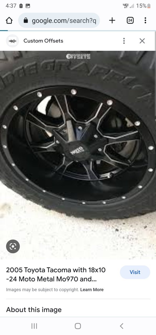

    When I bought my truck it had 20" wheels that are not functional with a 33x12.50 tire that has pretty much nothing to them. Feeling everything and rides pretty rough in the woods. I knew I would be replacing it once I went through the tires that were on there.
    Yay metal in sidewall so that means new wheels and tires! After weeks of debating I went with a 18 instead of the 20, MotoMetal MO970 black/Milled they are perfect and the Falken Wildpeak A/T3w tire is 295/70 18
    So get them and they won't bolt and rub on the upper controller arm but I don't want to get a different wheel (that bring another 3 week processes of trying to pick one) any thoughts on other options to push the wheel away from contoll arm? Spacers maybe?

    you would have to go with a spacer if you want to keep those wheels. Different upper control arms might do it to
