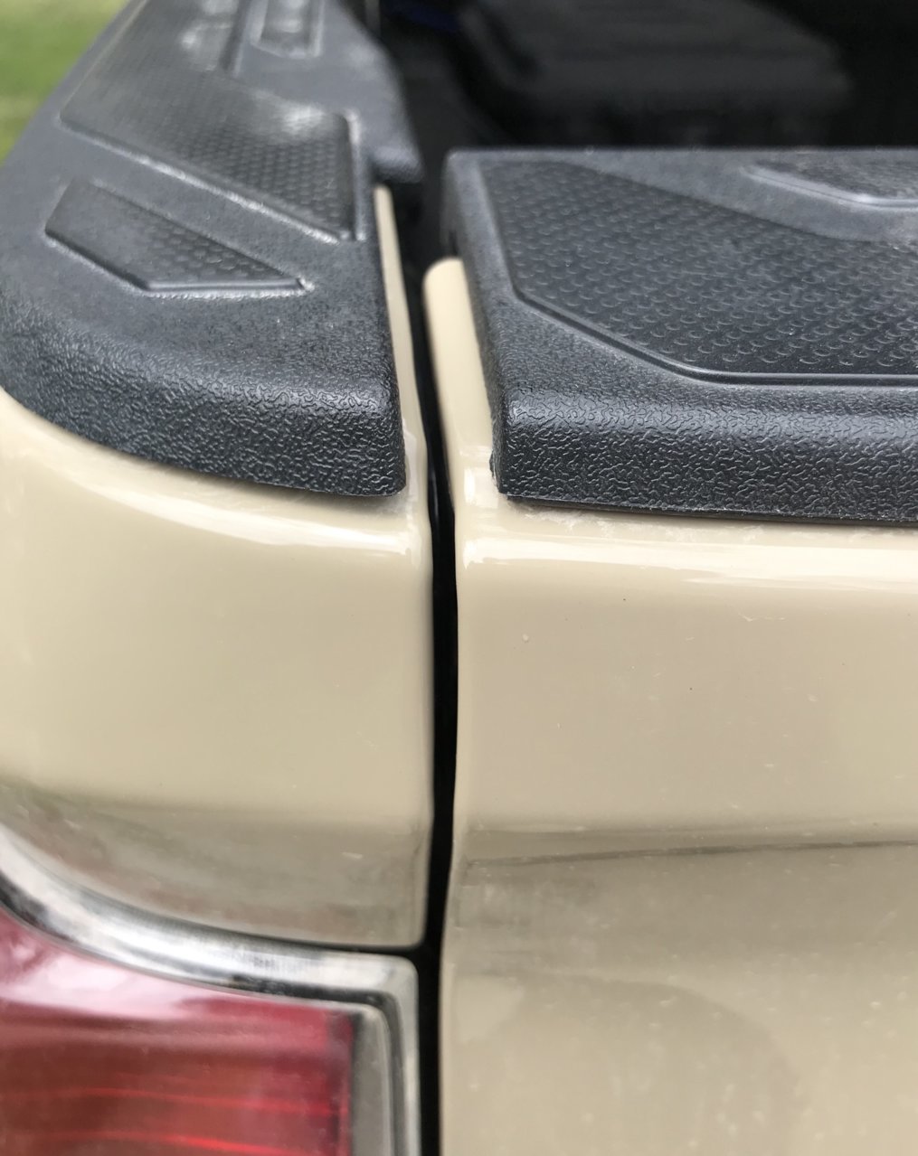

    I know this post is old but just discovered this today on mine ('17 SR5). Left side has much bigger gap than the right. Will leave as is.

    Same here..17 TRD Sport. Left has bigger gap. Leaving as is.

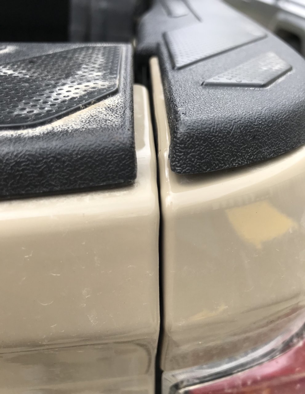

    Bumping a very old thread BUT the alternative is starting a new one.
    so my tailgate is off too. I’ve tried pushing it over and adjusting it without any luck. Any suggestions on how to fix without taking to the dealership? I’d rather avoid if possible. And yes, I have bed stiffeners but it seems to be more the tailgate is off.
    I don’t really care except for it seems the paint of the bed side and tailgate are occasionally rubbing. Thanks for the help!

    That gap is TIGHT! Do you have bed stiffeners? Usually they pull the bed inwards, but maybe in your case they might spread it a bit?

    I do have bed stiffeners and I get the pull the bed in but not sure why the gaps are uneven (and that tight specifically). I’ve taken them off right now and the gap is a little better. Just trying to see whether to keep my appointment at the dealer—and take RTT, Rack off and drive an hour each way or deal with it as a result of the stuff I have

    I noticed this too months ago. I opened the tailgate then manhandled it to the left. It moved. I think that the tailgate floats in the hinge and just shimmy’s over during driving. There is definitely some play there. Try opening the tailgate and sliding it left and right.

    I’ve heard that too and have given it hell with no noticeable movement. I even took off my stiffeners on the passenger side and put washers in between it and the bed to hopefully push it out. No change. Makes me wonder whether it’s worth a trip to the dealer

    I doubt anyone would even notice if I left them in. I only did 1 washer though because I didn’t want to drill another hole, have Cali Raised stiffeners that bends around, but I might try putting 2 washers in and see if that does anything. I don’t need much, just that little push out.
    Also, having washers in between the stiffeners and bed seems to have at least one positive, dust and debris don’t get wedged between the two metals and could reduce those rubbing/rusting. I’ll update if that works tomorrow

    I know this is an old thing.. but I have that problem too. My driver side sticks out further than my passenger.
