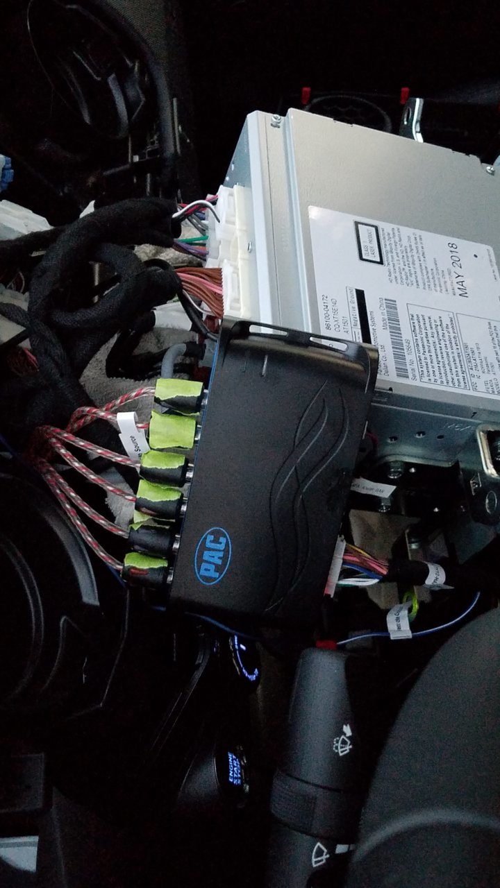

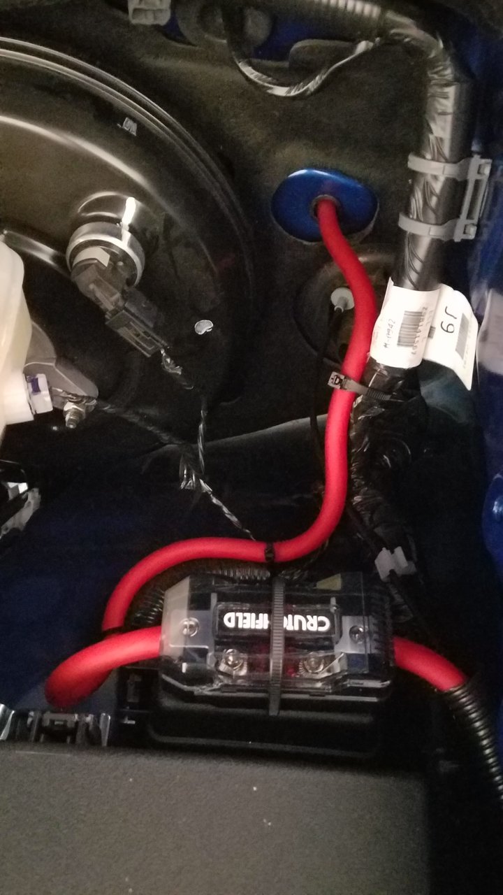

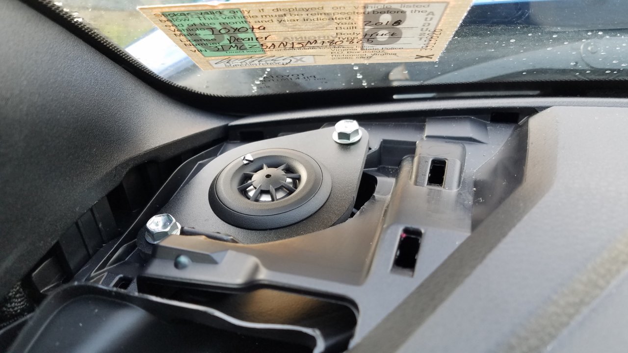

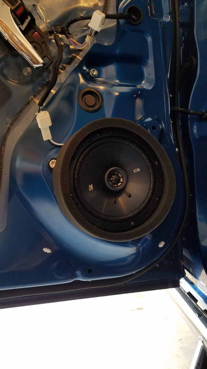

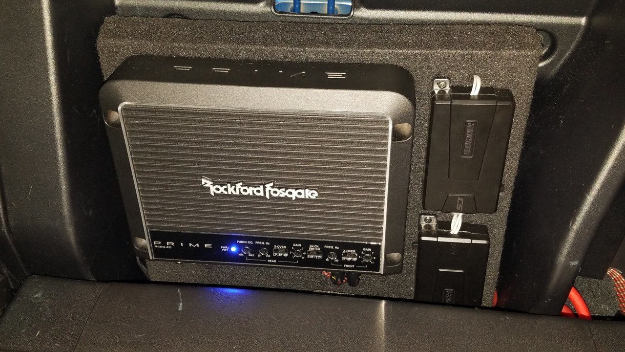

    So I wasn't happy with the JBL "premium" audio and decided to upgrade front door and dash to Kicker 6x9 CS component and rear to Kicker 6.75 CS coax with a Rockford Fosgate Prime 400.4D amplifier. For factory headunit integration I'm using a PacProTY12 unit. It's the most expensive piece but best plug and play option to retain factory headunit controls. Crutchfield 4ga amp kit and Stinger RCA. The door speakers have Stinger Roadkill Fastrings. I spliced into the factory speaker wires at the factory JBL amp harness and extended the 6 pairs of speaker wire over to the driver side rear cubby and built a wedge style amp rack. Everything soldered and tesa taped. I'm still driving the factory JBL sub with the factory JBL amp. System sounds great!
    Definitely more work than I anticipated! Took 10 hours by myself!
    Big shout out to @destin_meeks!!!!! He has been assisting me for 2 months on this project and I can't say enough about his responsiveness and knowledge!

    Everything looks great! 10 hours is a good time for all the work you did! Especially when you soldered/shrunk everything! And Tessa tape to top it all off. I know audio shops that would take longer than that and do a worse job!
    I’m glad you were willing to listen to my advice, and buy the parts to make the job clean and factory! People try to cheap out and go without the PAC, or the brackets, and the quality suffers.

    I get it (kind of), however, I am using the Maestro in order to use the factory wiring. It would be a big win for me to be able to use the factory wiring at least to the amp location.
    I assume you are tapping the wires before the amp so you get a clean signal.
    Where did you get the tweeter mounts?
    Where did you get the amp cabinet?
    Thx! Also, the install looks great.

    I cut and extended the factory speaker wires at the JBL factory amp over to my aftermarket amp. Tweeter mounts from Amazon (had to file them out 1/16 or so to make the tweeters fit. The amp rack I made myself.

    Thanks for that! Tweeter mounts are the only thing I couldn't them. I like what you did with the amp mount. I will have to come up with something. Maybe in the under seat cubbies.
