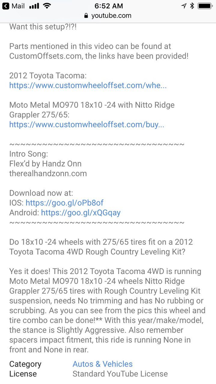

    Is anyone running an 18x10-24 wheel . If so what size tire and how much lift and any trimming.
    I have searched and I can't find an answer to all three questions together. Thanks for any info.I'm sorry I meant -24 offset. Pretty sure -12 will work but don't know about -24.

    5112's front 5100 rear. Dirt Kings UCA's 17x9 -38 Ray 10's on 285/70/17 Toyo Open Countrys
    Check out custom offset on YouTube. They have a Tacoma running that set up with no rubbing. Maybe that’s where you saw that setup? They’re running a 32” tire. It looks badass.
