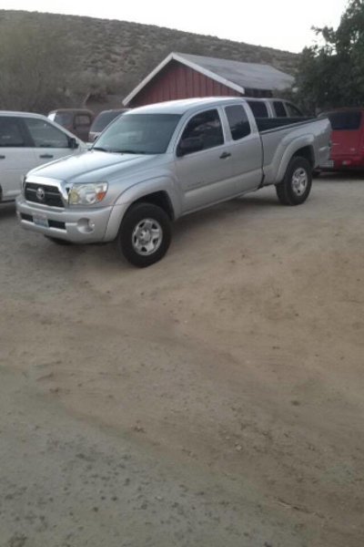

    (As for the pictures below, or in the post, hell if I know. The lifted one is on 18x12s and 33s with a 6 inch. The other one is my stock truck)

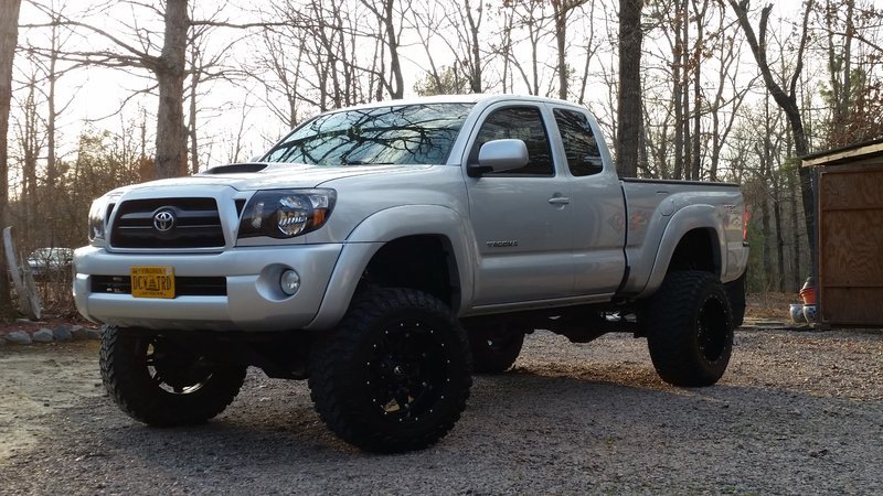

    6 " Rough Country suspension lift with 6" Rough Country struts. 18x12 Black Fuel Hostage wheels with Atturo Trail Blade MT 33x12.50r18 tires
    Lol no bullshit thats my truck lol and tbh i would go with the 6" lift cause your going to rub on your cab mounts. People do it though.

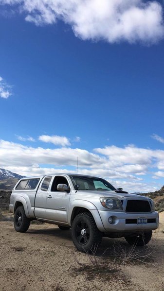

    lol holy shit I forgot about this post. Even have a different truck than the one in the picture. I kinda figured that about the cab mounts so I decided against this route. I'm stock height with 255/75/17's and stock TRD Sport 17's. Have a 3 inch lift ordered and I'm keeping this wheel/tire setup. Anyway, here's the new truck and what she looks like now:
    @hmasonb34 your going to have to get the cab mounts chopped no way around it without at least 6 ". Thats what im running in the pics of my truck.
