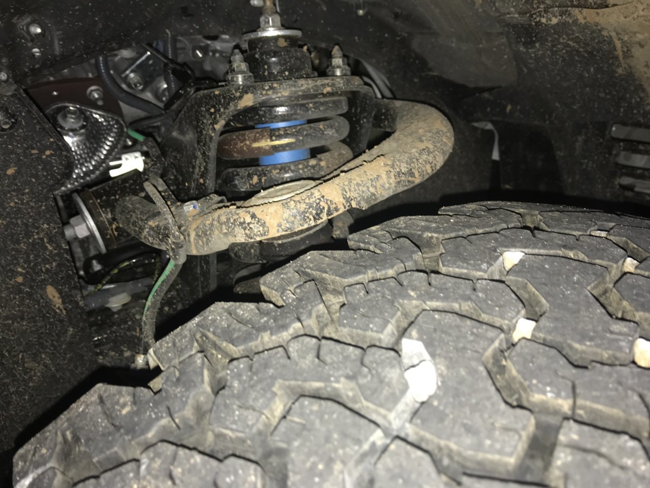

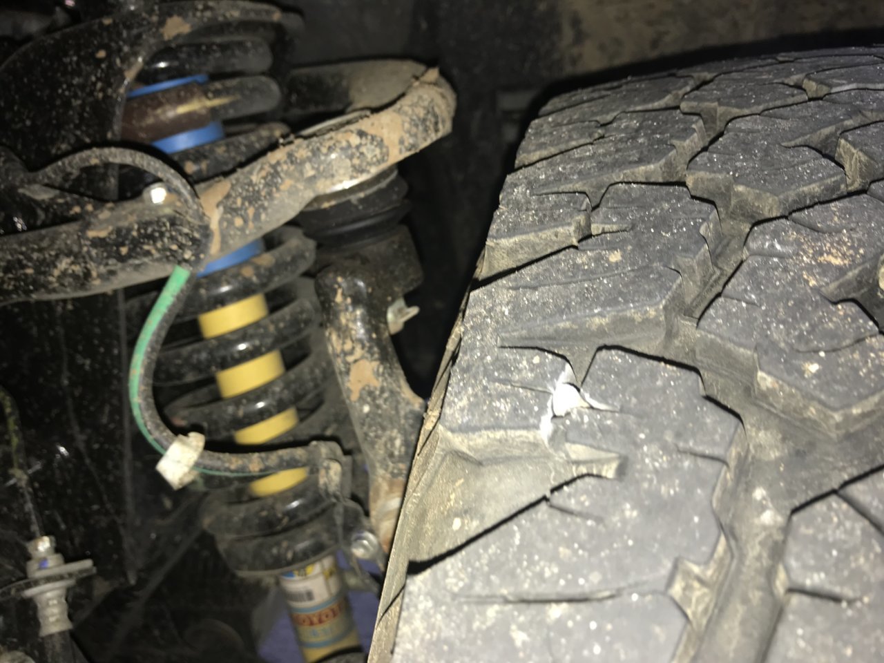

    Here are a couple of photos of where my tires sit with a18x9+12. This is stock suspension and 31.5’s. With your lift and bigger tires I don’t see any issues. Your tires will be 3/4” taller and less than .5” wider.

    I’m goin -12

    Then you'd have an extra inch between the tire and UCA

    That’s the point.
