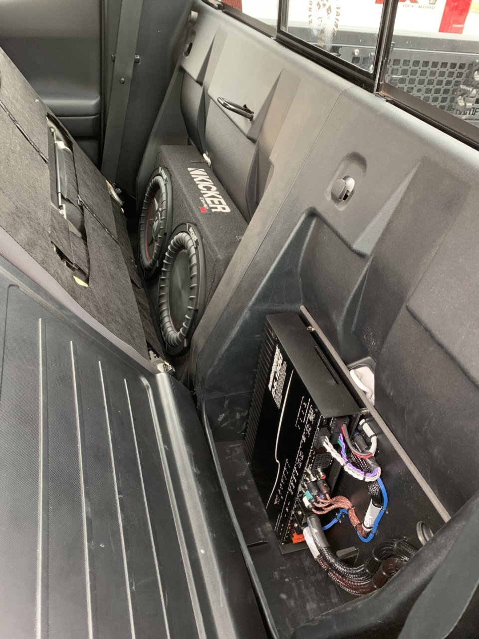

    You can also fit a Kicker CompRT box with 10" DVC sub and passive radiator behind the rear seat on the passenger side. You have to remove the lip from the storage cubby and the plastic panel on the seat back:

    May I ask what Amp did you use?

    AudioControl D-6.1200. It's 125Wx6, channels 5 and 6 are bridged so the sub sees its exact RMS power rating of 400W.

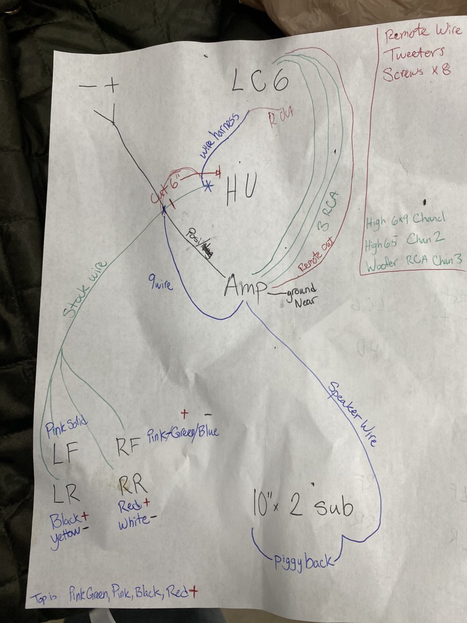

    3015A825-2D40-4F17-A80D-6A1D2B68F6C1.jpg I have a JL audio set up. The box is custom made from a guy in LA. My woofers are JL audio 10w1-4. Swapped out the stock speakers for JL audio c-2’s. The 6x9 needed a universal mount. The 6.5 I cut the old speaker out and mounted the new speaker In its housing. The amp was a JL audio RD900. But I swapped it for a hiphonics 5 channel 2500 watt amp for clearance under my passenger seat. I was able to slip a LC6 audio control behind the head unit for the RCA’s. Here’s my wiring diagram

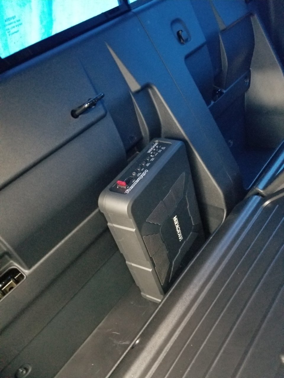

    Ahh I knew I recognized that amp install, Dean and Fernando do phenomenal work.

    They sure do!
