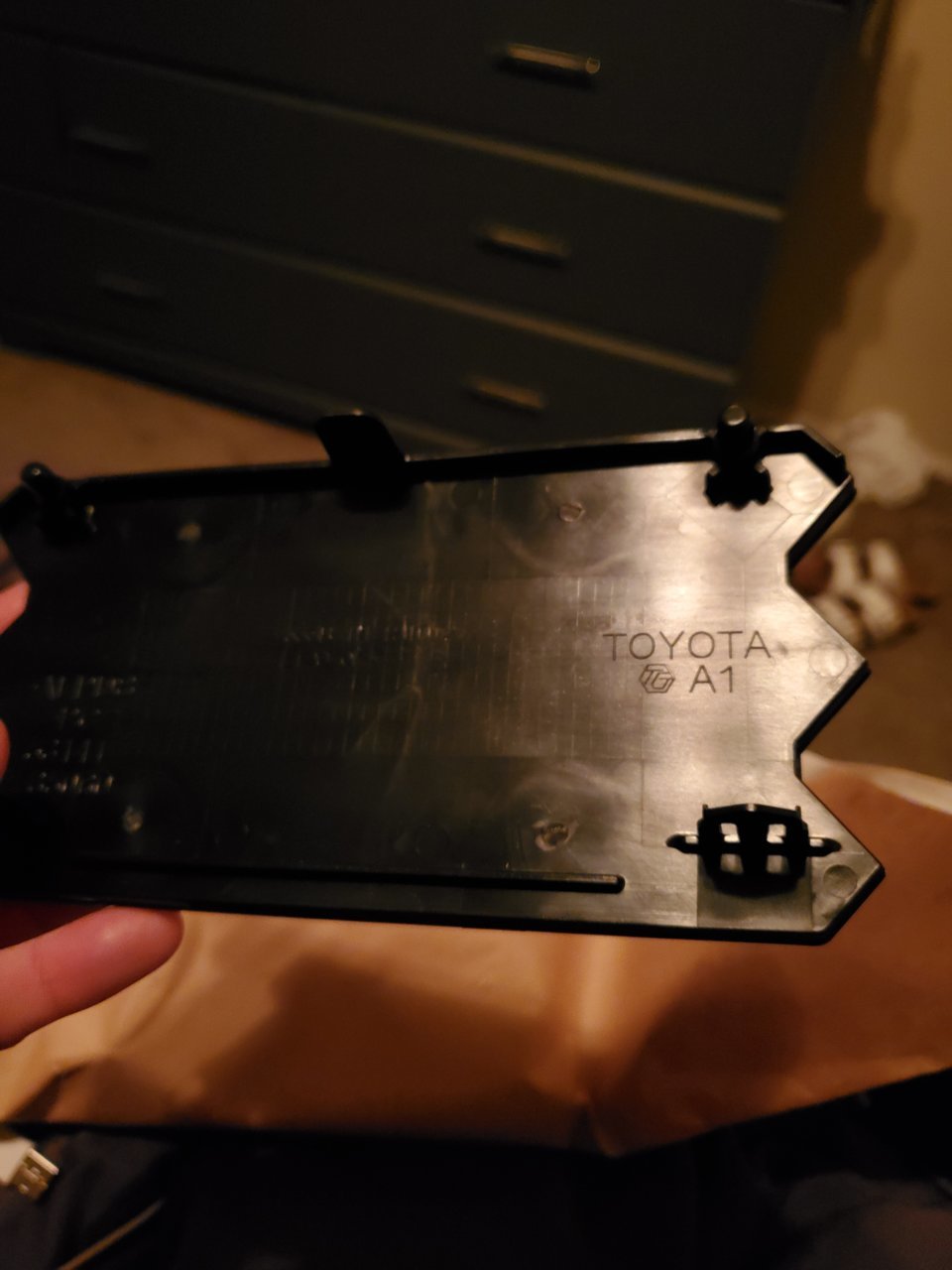

  3. Aug 25, 2019 at 12:35 AM
    tacochep
    tacochep Well-Known Member
    Apr 17, 2017
    #216462
    654
    Phoenix AZ
    2019 S White Taco DCSB TRD 4x4
    scs ray 10's, demello sliders, meso stuff
  4. Aug 25, 2019 at 12:38 AM

  9. Aug 25, 2019 at 9:42 PM
    tacochep
    Apr 17, 2017
    #216462
    654
    Phoenix AZ
    It is 100% oem from the one I got. Was very pleased
    sangbro[QUOTED][OP] likes this.
