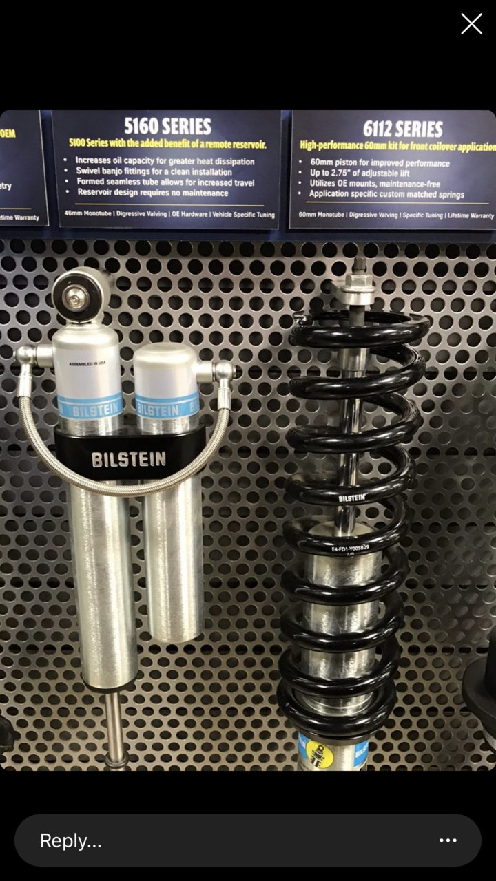

    I just did the 6112 & 5160 on 18 DCLB 4X4 Yesterday. Looks good, in my opinion
    I was going to do the 5100’s but I just pull the trigger with the 6112 & 5160. Plus the 6112 have a special note for the taco lean

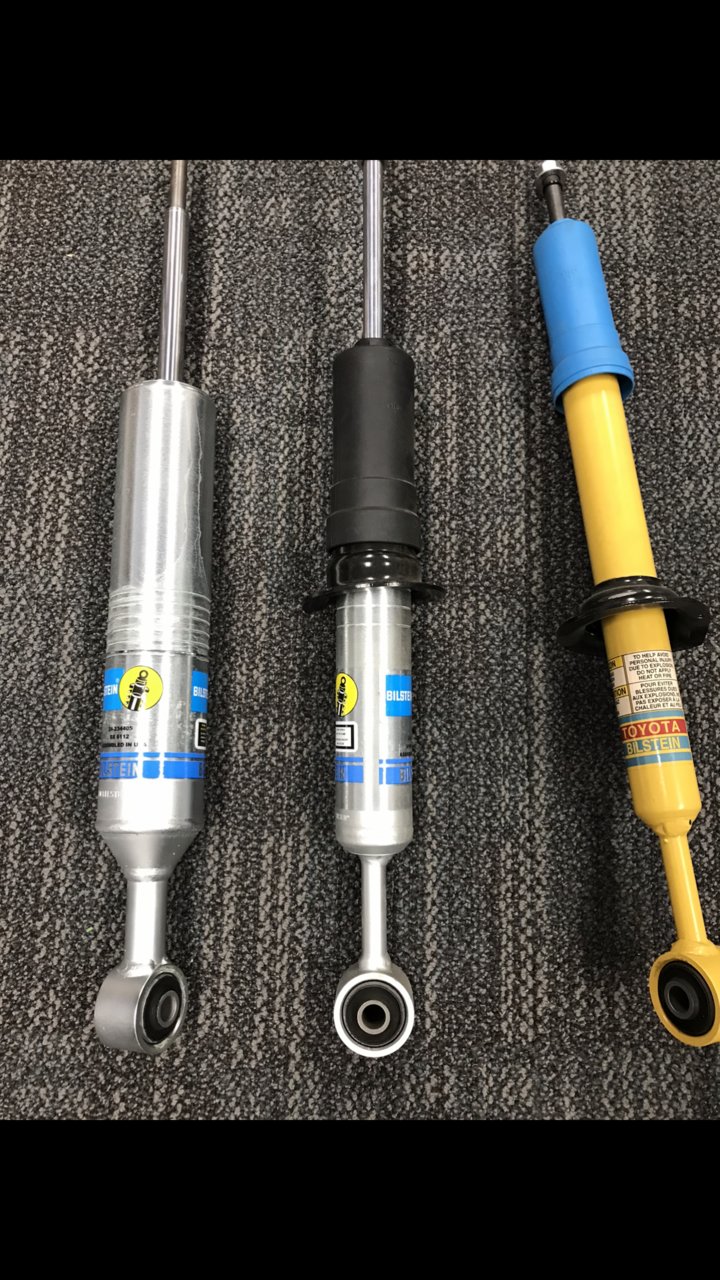

    Here what you looking at to compare
    6112 5100 Stock off the TRD OffRoad

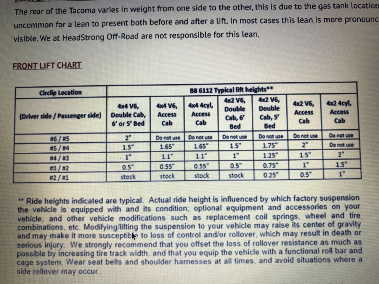

    See thats what confuses me it says 1.65 inches on the as the highest for the v6 access cab but people say they get 2.5 inches out it.
