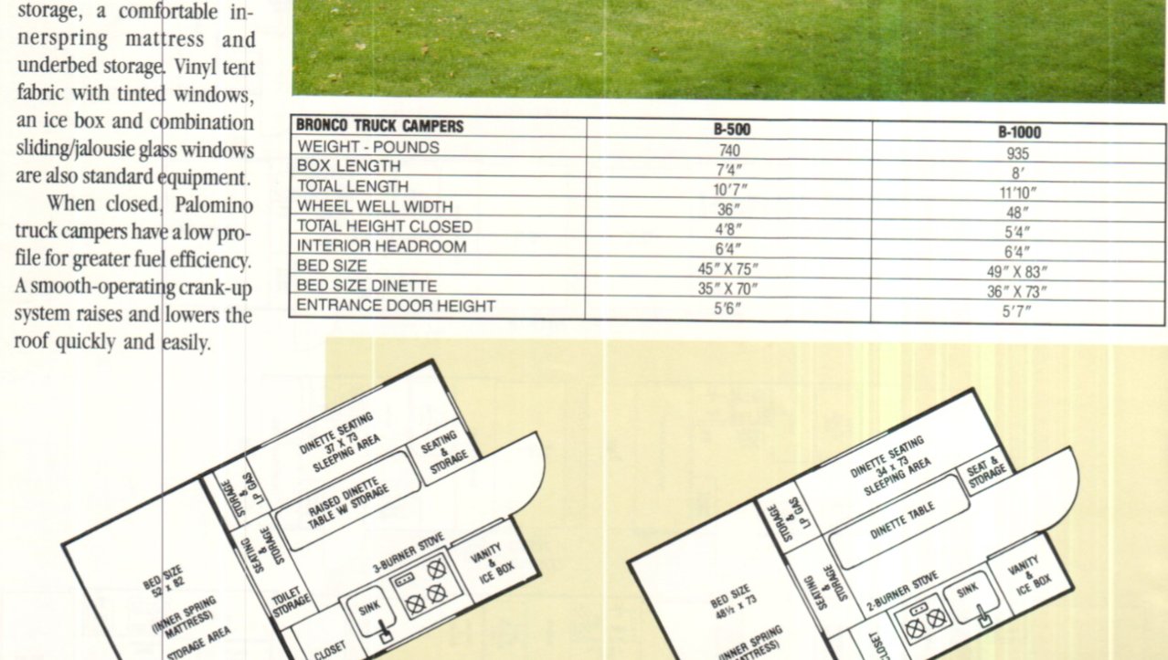

    will it even fit (or stay) in a 5 foot bed? Box length listed is 7'4". Maybe I am looking at this correctly.
    Even if it fits, it's not gonna be fun,,,, at all. Plan LOTS of time for rest breaks and a slow drive.
