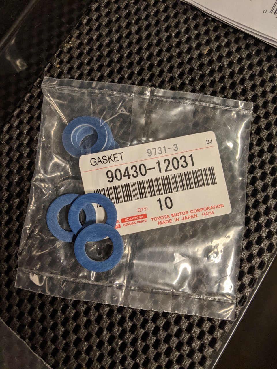

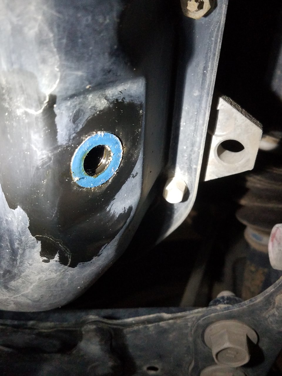

  14. Mar 16, 2021 at 4:06 PM
    tacotoe
    tacotoe Pastry Chef
    Nov 25, 2007
    #3593
    5,915
    Nebraska
    `17 AC Sport MT
    ARE Topper, Icon aal, OEM Audio+
    Taco_mike73 and waltuo like this.

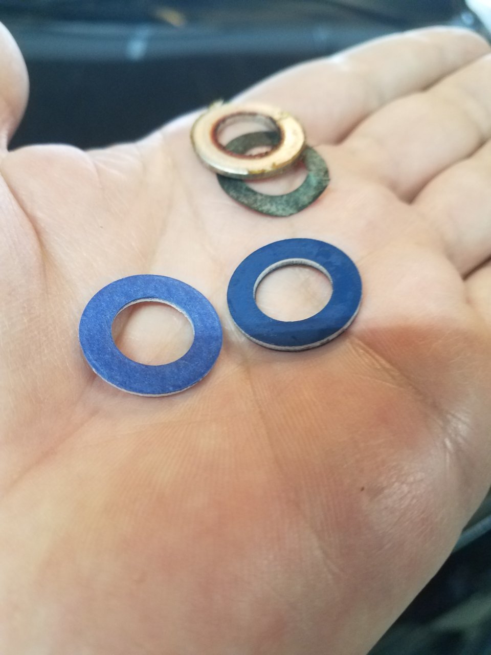

  15. Mar 16, 2021 at 4:57 PM
    tacotoe
    tacotoe Pastry Chef
    Nov 25, 2007
    #3593
    5,915
    Nebraska
    `17 AC Sport MT
    Pictured, in my hand left is genuine Toyota plug gasket, the one on right is the knock off garbage. I've never had a factory gasket come apart and stick to the pan like the other two photos.

  17. Mar 16, 2021 at 5:21 PM
    #17
    tacotoe
    tacotoe Pastry Chef
    Nov 25, 2007
    #3593
    5,915
    Nebraska
    `17 AC Sport MT
    I doubt you'll have any trouble with those gaskets pictured. I threw the last five cheap ones in the garbage because I had gotten a bag of the ones like you pictured. Yes the genuine parts although they stick to the pan, they have always popped off clean, unlike these others.
    Another thing, not sure where I seen it but somewhere found that the thicker paper side of washer goes toward pan. ?? That's the way I've been putting them on. For quite a long time
