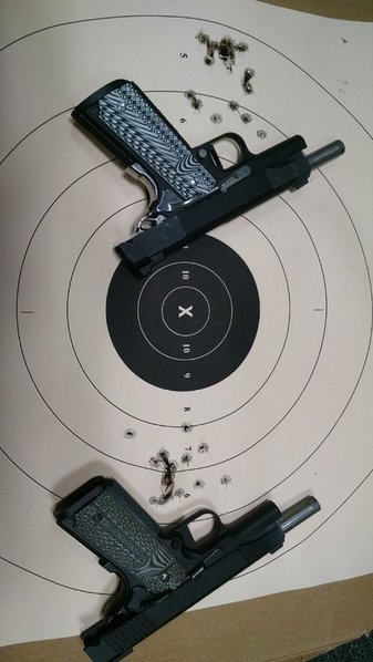

    My carry piece and a recent build, 10 yard target.

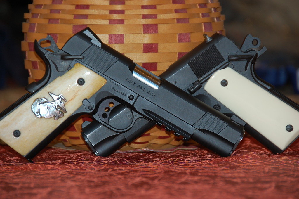

    My carry gun and a gift for my son.

    Right side looks like Tru Ivory grips.
    14489 likes this.

    Yeah. Some type of fake ivory. They are around 20yrs old and I don't remember who made them. I've thought about upgrading to real ivory many times and just end up spending the money on other guns. The one on the left is giraffe bone.

    Ivory is cool and all, but there are so many other exotic scale materials available these days that I don't think I'd ever feel the need to actually go with genuine ivory. Lot of other stuff available that isn't questionable, and is less fragile.
    Tru Ivory makes some pretty decent alternatives, though.

    I don't mind real ivory but it has just never seemed a priority on this gun. It gets treated rough at times and has lots of wear. I keep thinking I'll replace it with one of the newer 70 series commanders with better grips. I just keep spending on other stuff though. The last two guns were a Cooper and a Freedom Arms so I probably will upgrade my carry gun at some point.

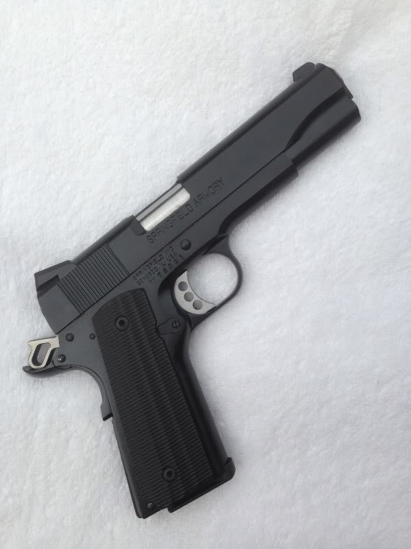

    I do love this 1911. It started out as a Springfield GI. I've done some work to it, and had multiple 'smiths do more. Learned a lot along the way.

  14. Sep 30, 2015 at 5:50 PM
    #354
    Polymerhead
    Polymerhead Well-Known Member
    Oct 15, 2010
    #44737
    4,800
    Missouri
    '18 TRD Limited Inferno...Tundra!
    I probably won't remember everything...
    Factory Springfield GI
    Hand-fit oversize barrel bushing
    Front sight dovetail milled, Yost front sight
    Rear sight milled for a Novak sight
    Lowered & flared ejection port
    3-hole trigger
    Wilson beavertail grip safety installed (scariest thing I've done on it)
    Wilson hammer
    VZ slimline grips
    Slim bushings
    Flat MSH
    KG Gunkote finish
    Arcticelf[QUOTED] likes this.
