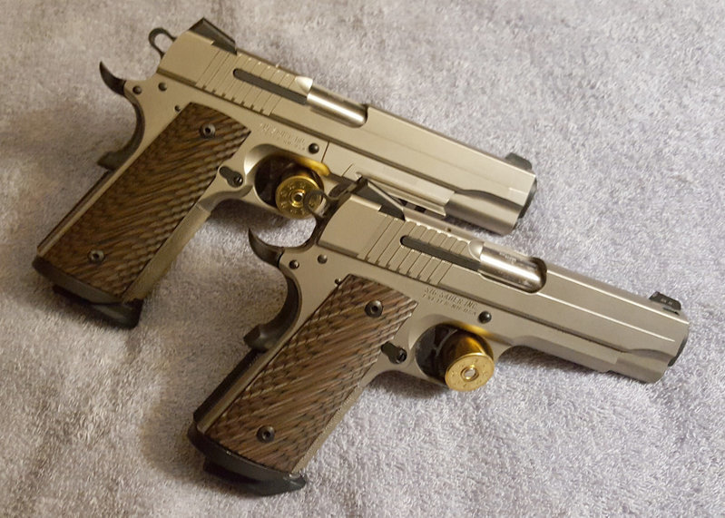

    My LGS where I traded mine in still has it and is closing in on the time frame where they will drop the price, and it may just be mine again...:cool:
    Ahaha, Sig Nickel??? I bought the 5" and then when the 4" came out I snagged one of those. Damn good shooters. :thumbsup:
