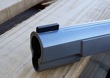

    I like the "Browning cut" on the slide.

    That's a ball cut not a browning cut.
    The sights, ball cut and French line all require machining. But he could do a trigger job and safety.

    This is not my work just did a interwebs grab.
    This is a highpower cut, browining cut or carry cut. All the same thing.

    I forgot the front of the slide gets cut as well.

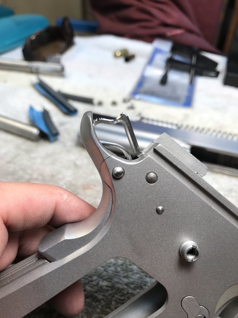

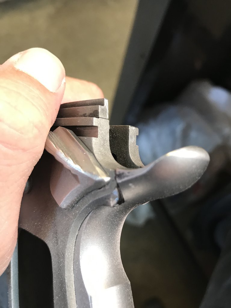

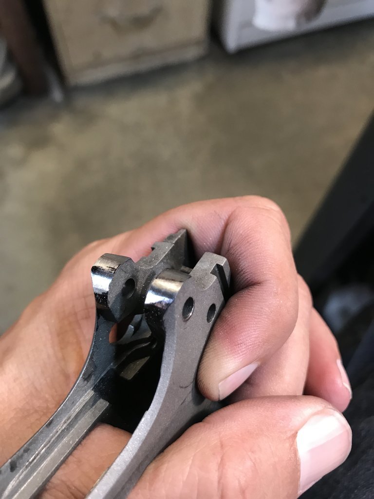

    Nothing to exciting today. Did a couple trigger jobs. First one using C&S parts the second using OEM parts. So used the mil to set up the OEM hammer hooks properly than did the job. Once that was done fit a new ambi safety. The ambi safety overhung the frame so I blended it to match the frame lines then re beveled it. I did not fit this beaver tail it's a factory Kimber fit.

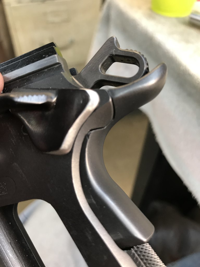

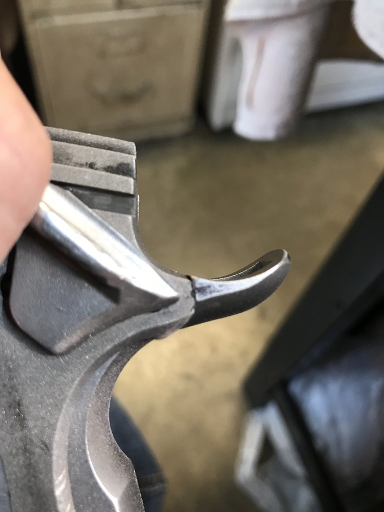

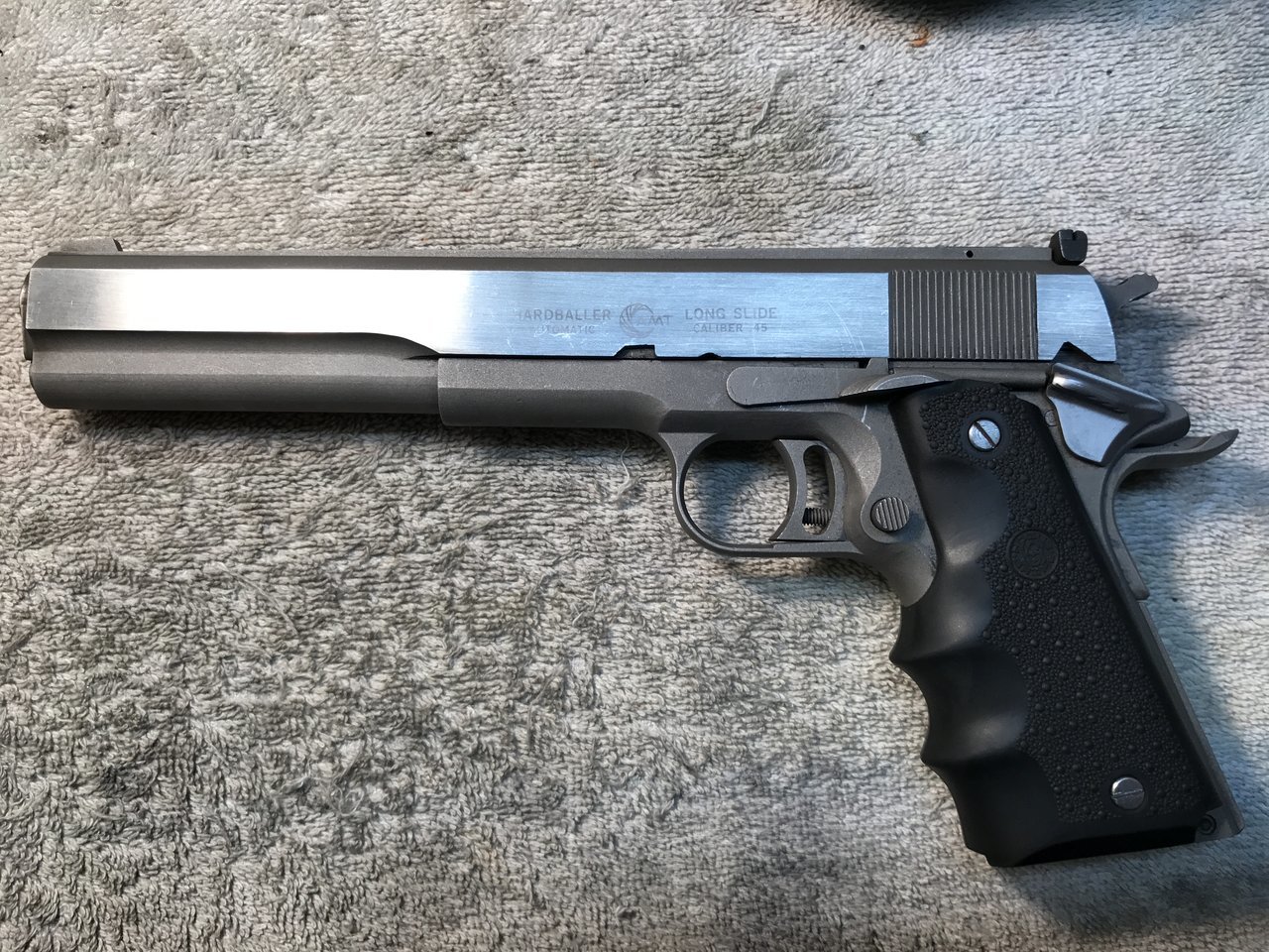

    AMT Hardballer came in wanting a beaver tail, trigger job and refinish.
    Shot before work
    In progress of working on cutting the mil spec tangs and fitting the beaver tail.
    Beaver tail fit but still needs blending.
    Blended
    Refinished and did the satin finish on the sides of the slide by hand.
    Captqc, SAB_0010, GPsevinSixx and 5 others like this.
