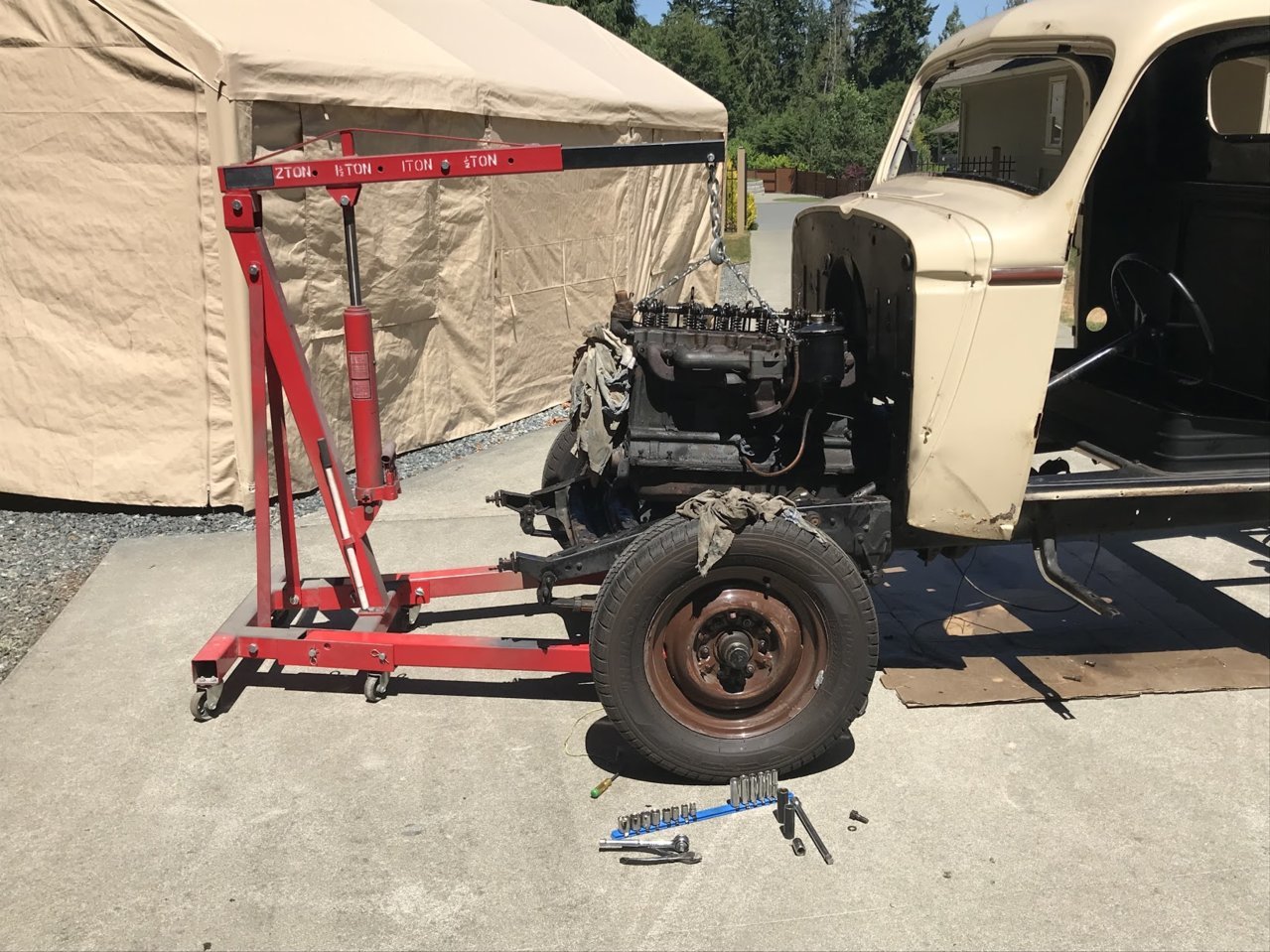

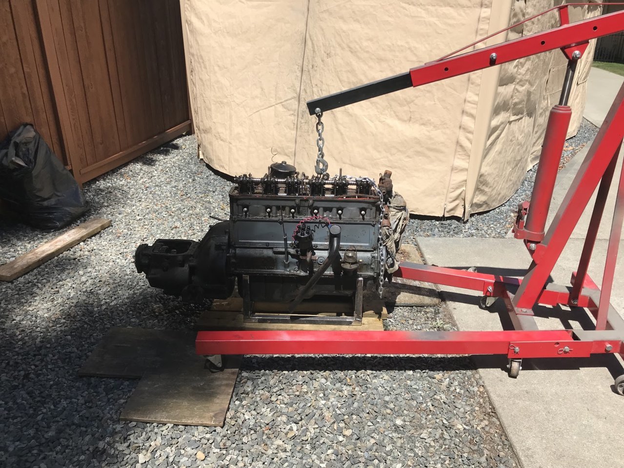

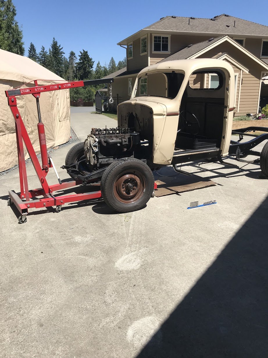

    Today was engine/trans removal day
    Got some plans off stovebolt .com for an engine stand... turned out pretty well and works a treat

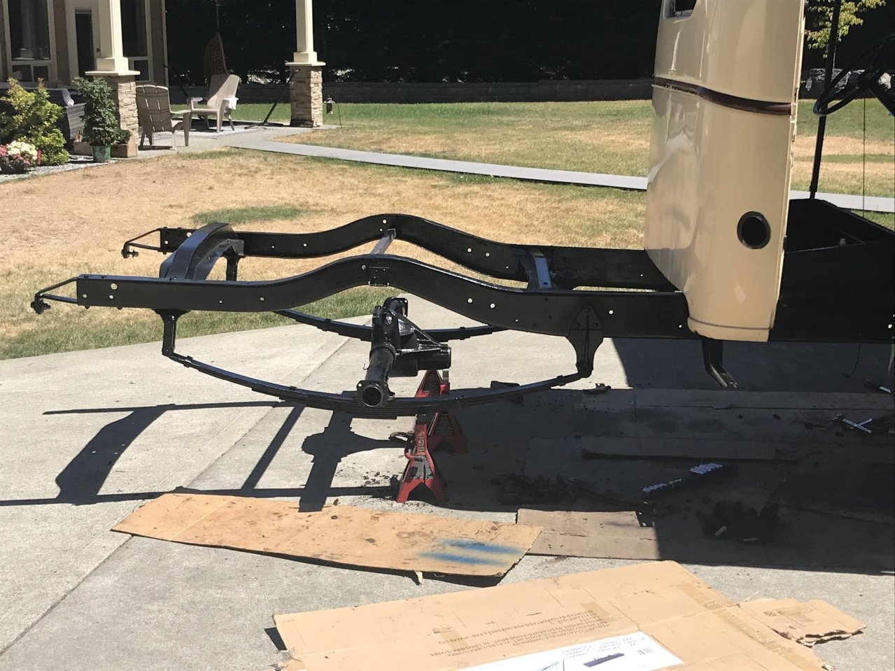

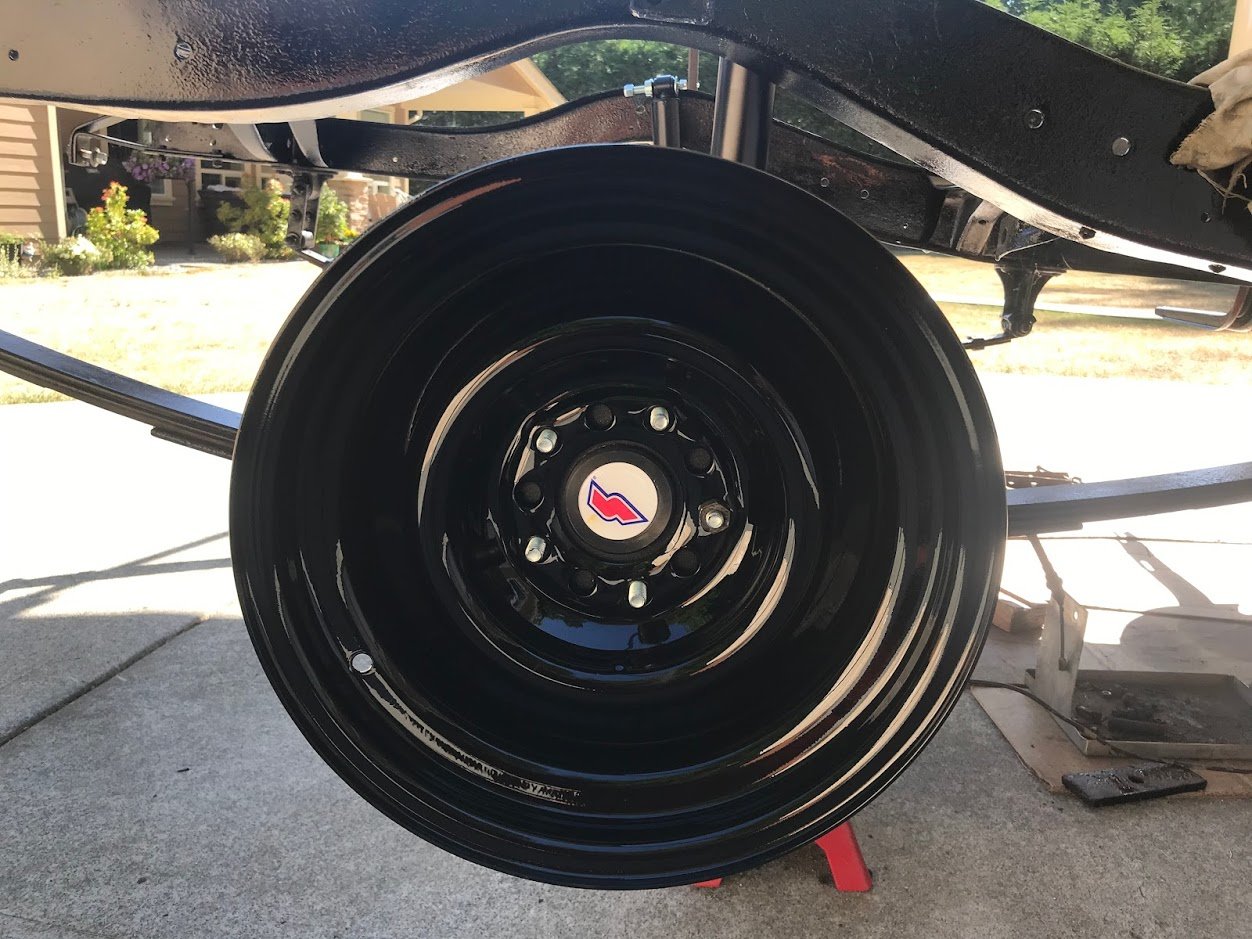

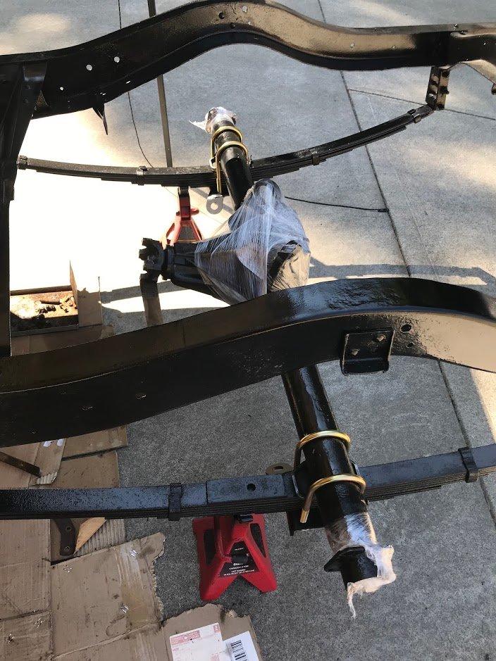

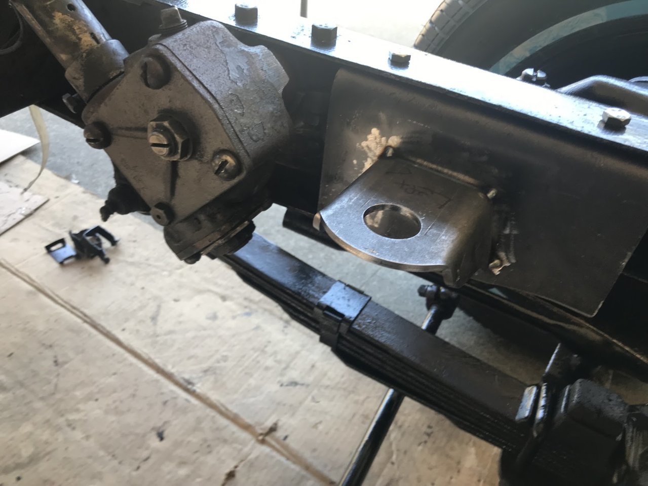

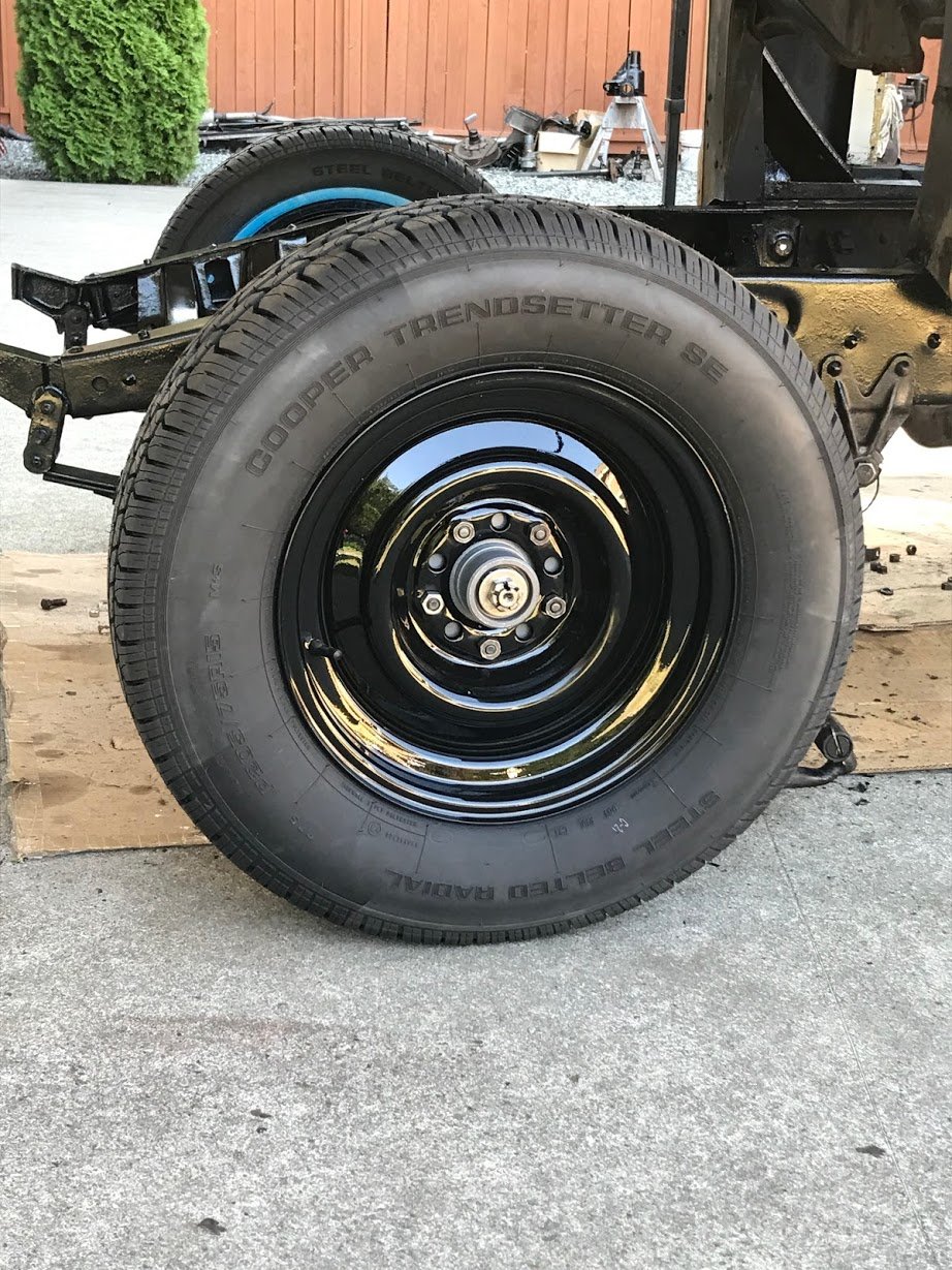

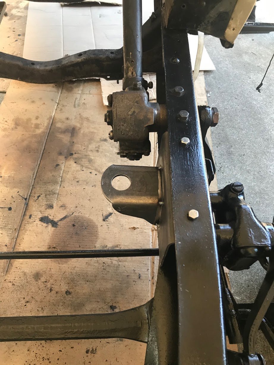

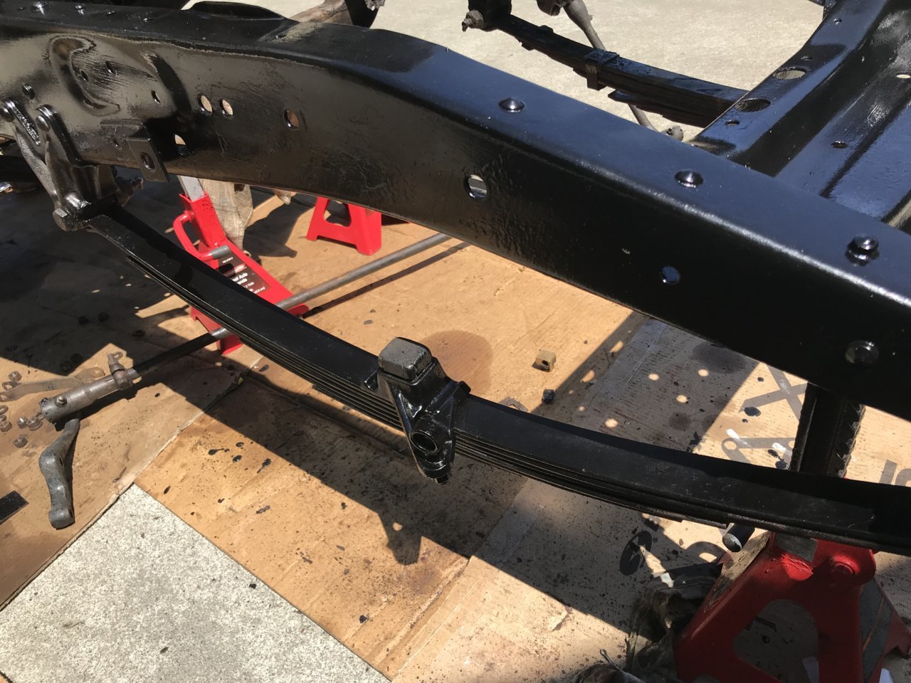

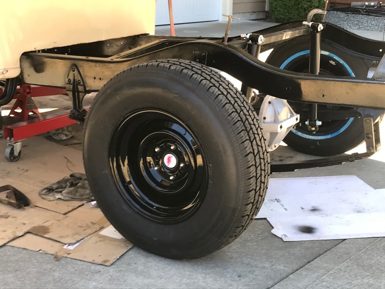

    Been working on the front of the truck...got the frame and the leaf springs cleaned up, took the springs apart and removed a leaf from each side. Dropped the beam and painted it while I was at it

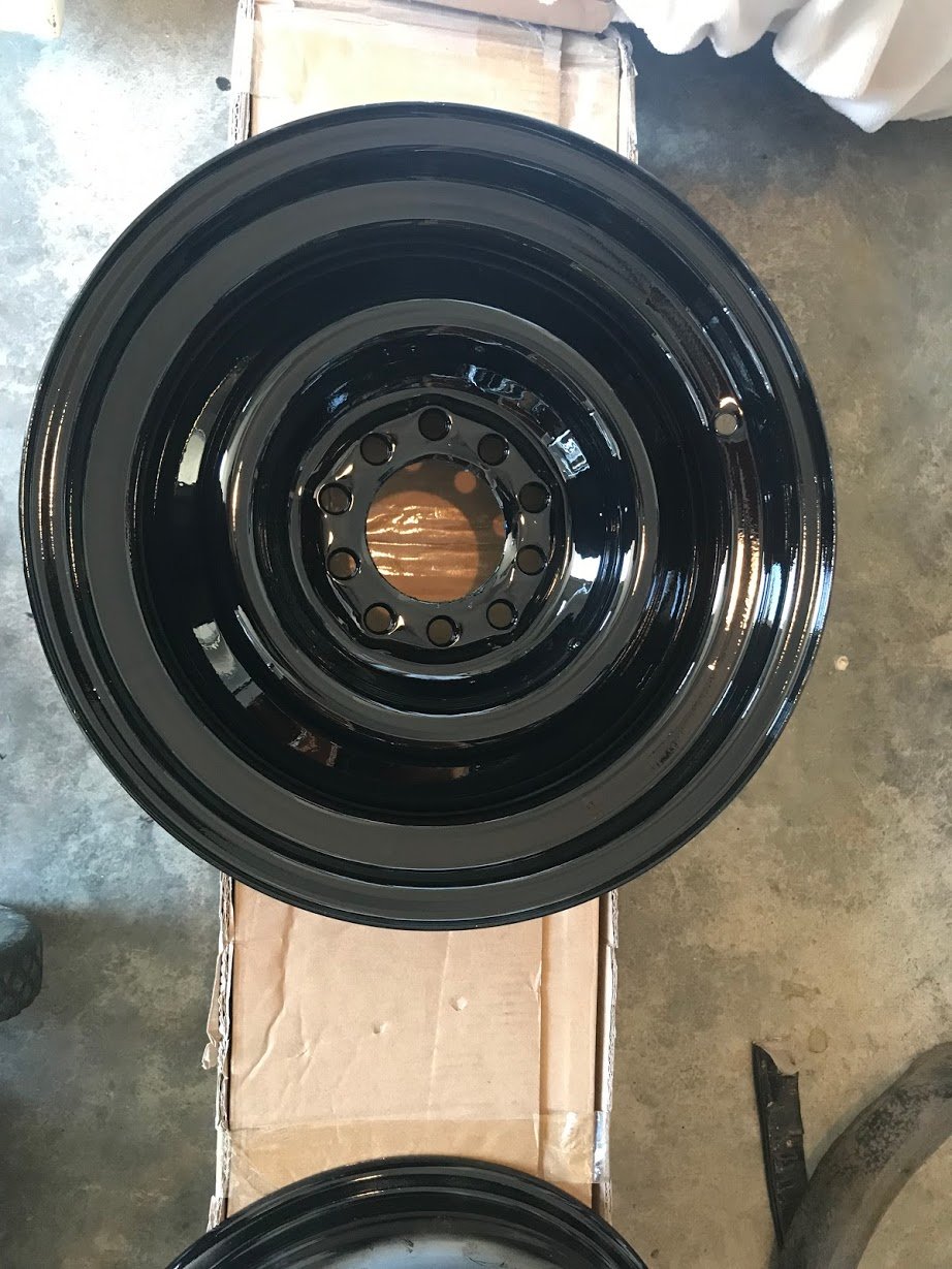

    Front rims got some paint
    Had the rims mounted on the new coopers
    Spindles went back together
    Rolling chassis once again... next up is trying to shoehorn the BBC into it. Steering box is a bit of a concern and I'm itching to see what that puzzle is going to look like

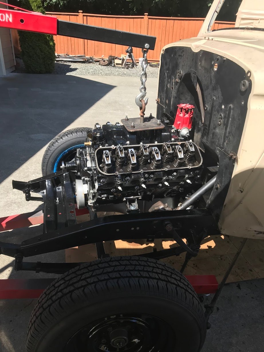

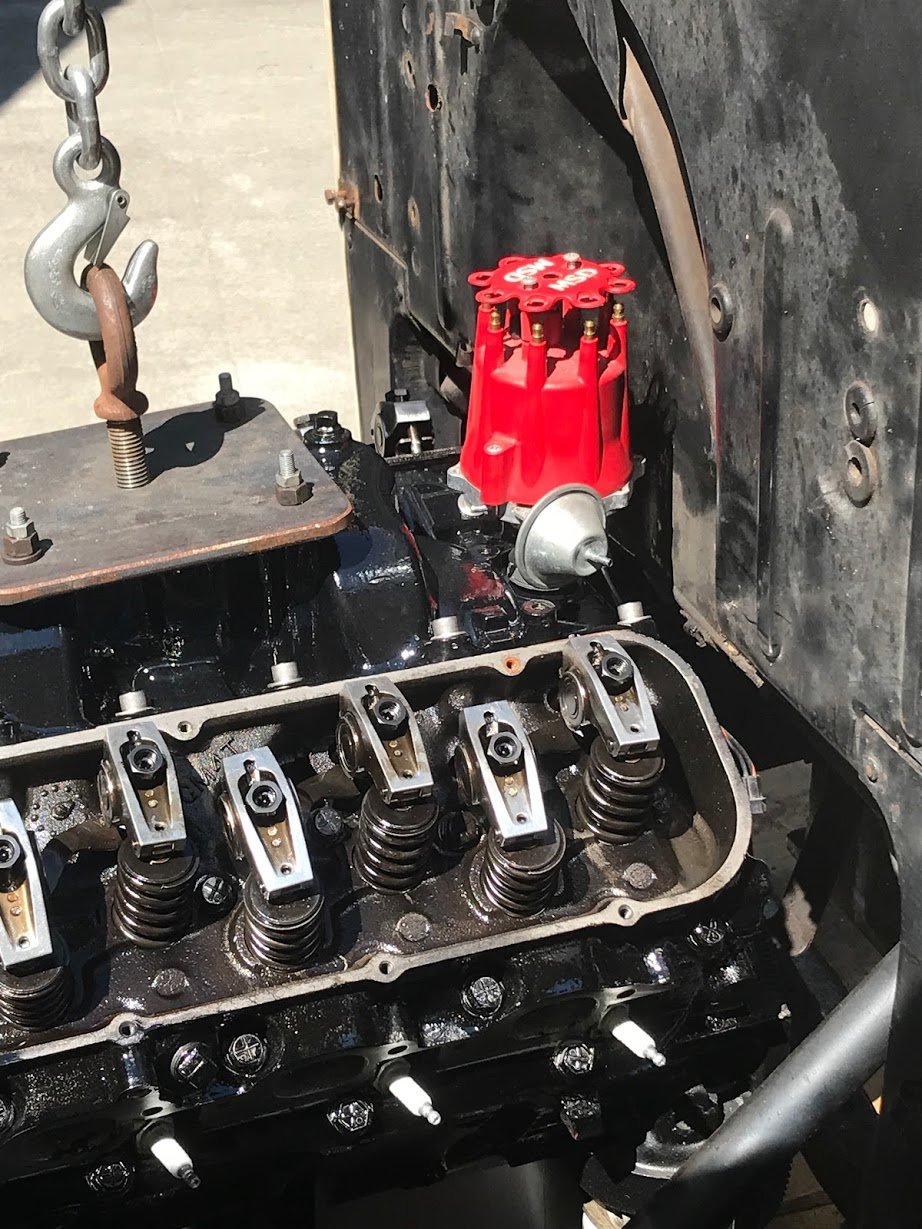

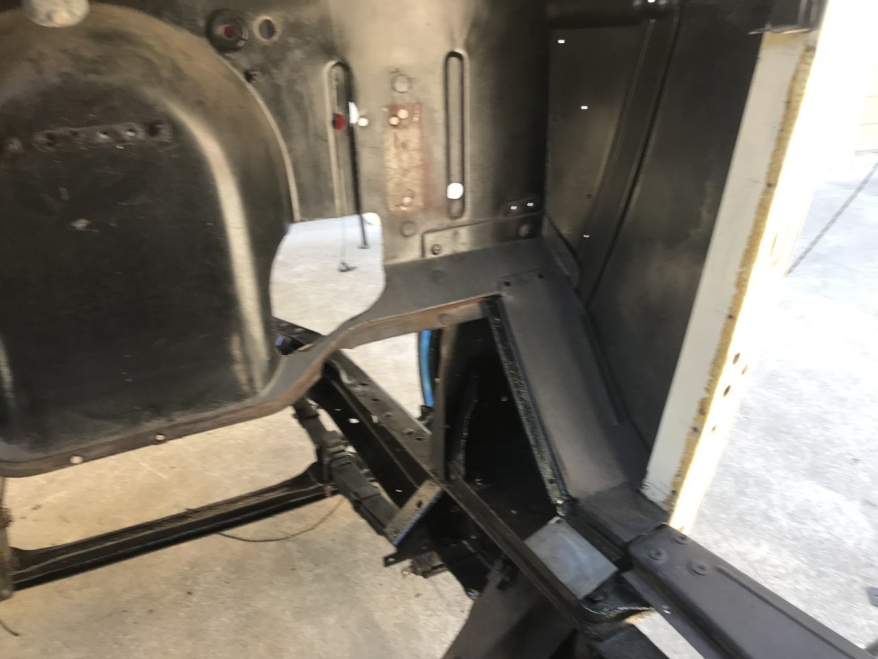

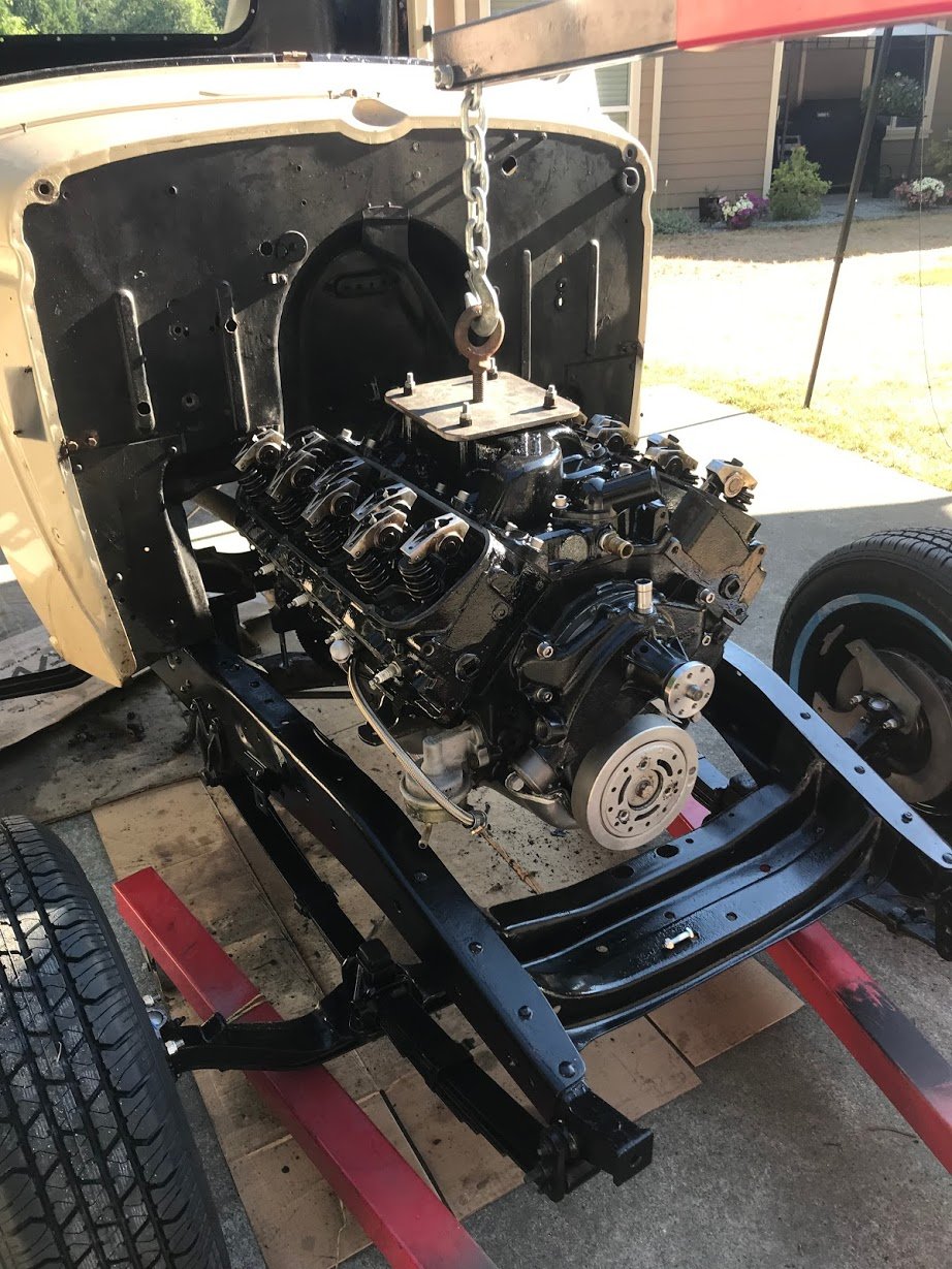

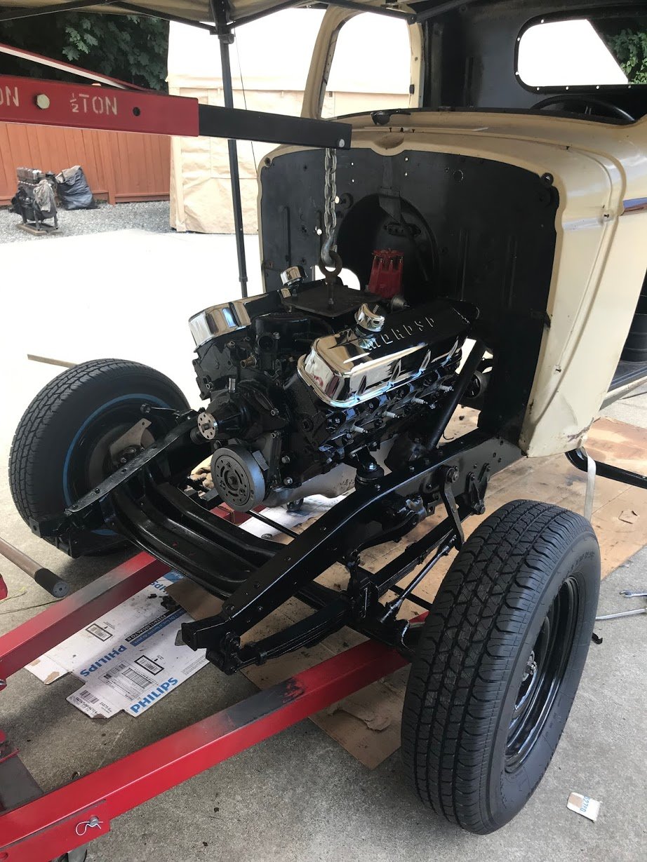

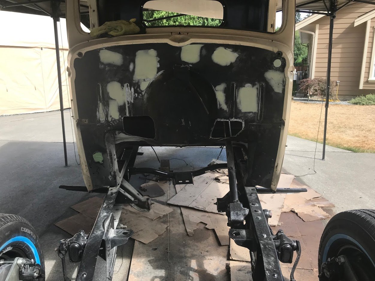

    Spent the morning getting the engine test fit into the truck and then made some adjustments to the firewall. Happily the steering box and engine have no interference issues that I can see...might need fender well headers of some type but I'd rather deal with that than attempting to redesign the steering
    Fuel pump needed to come out to get past the frame rail

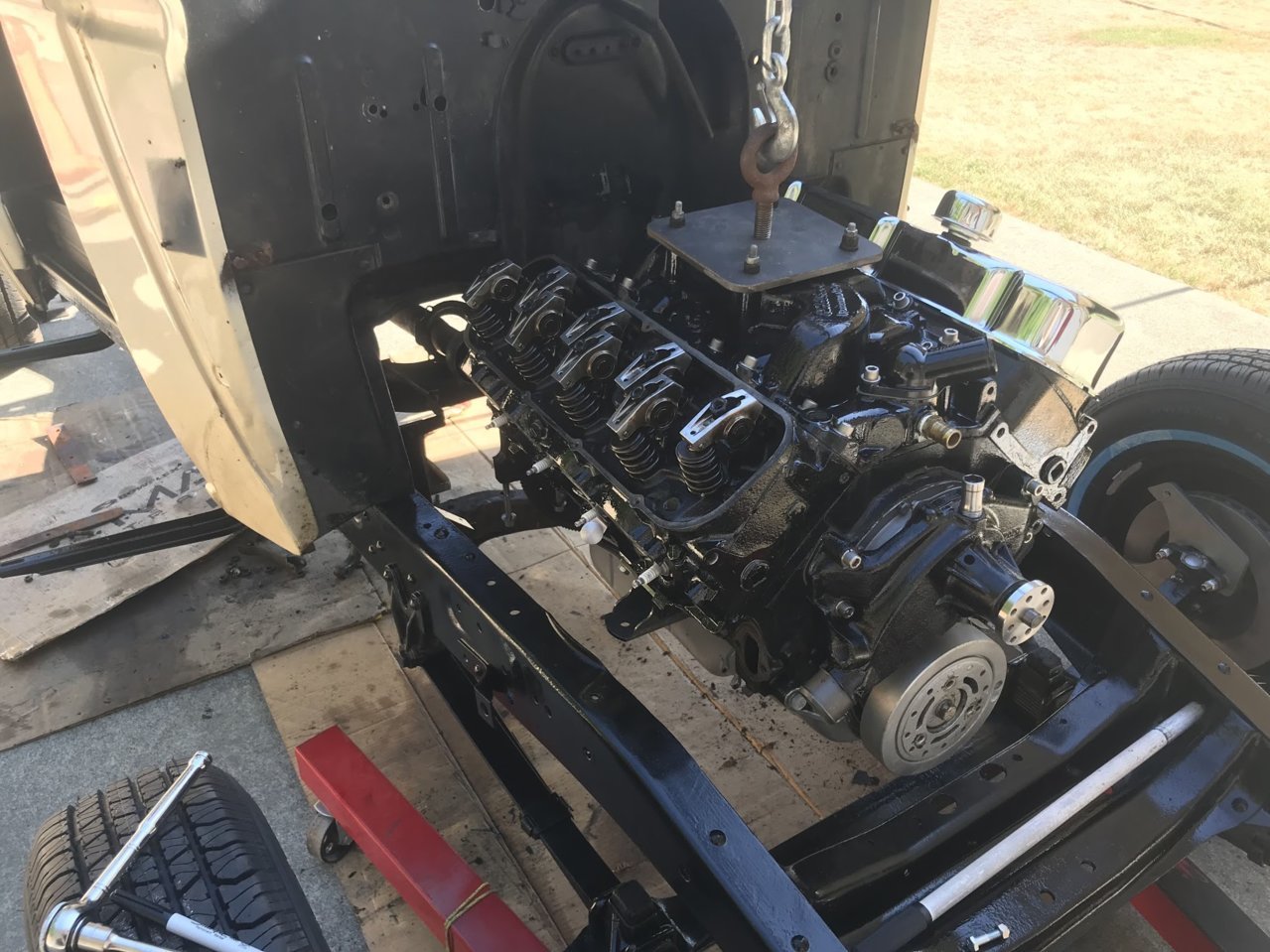

    Progress is slowing as the project moves into small tedious jobs that seem to take forever
    Got the engine and the mounts mocked up, along with getting the steering reconnected

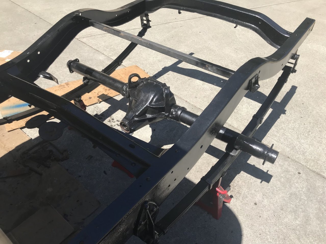

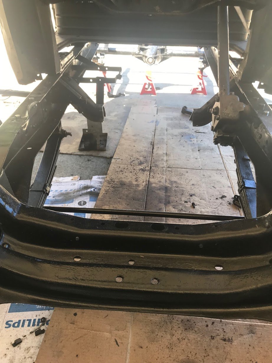

    Original rear got pulled today, cleaned up the leaf springs, mocked up the 8.2 and removed two of the old crossmembers...not a lot of progress but some

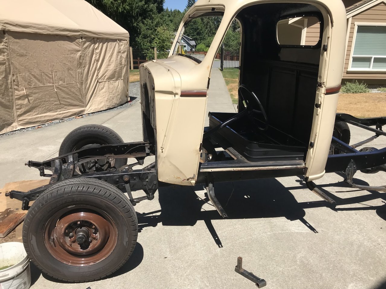

    Time for some overdue updates

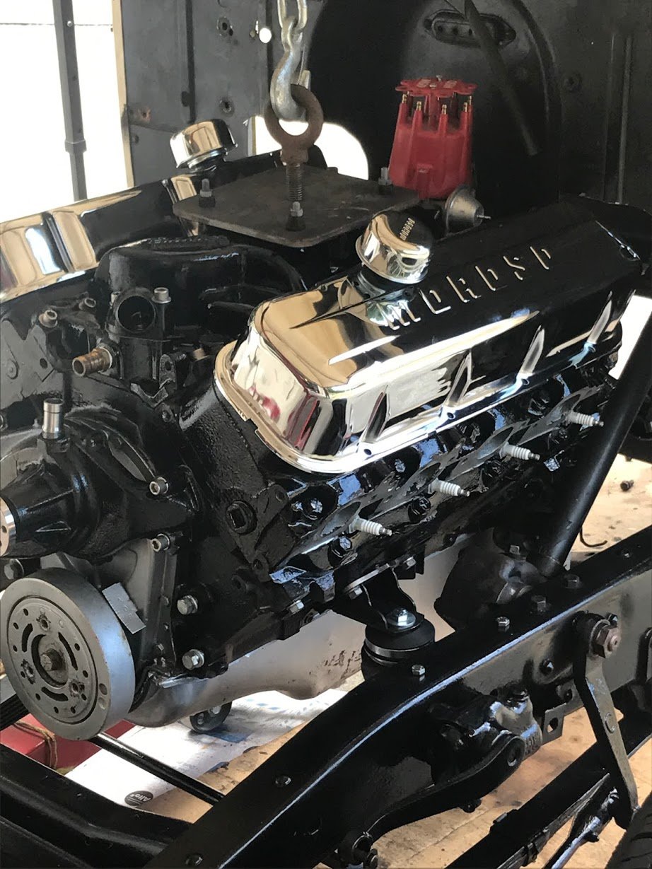

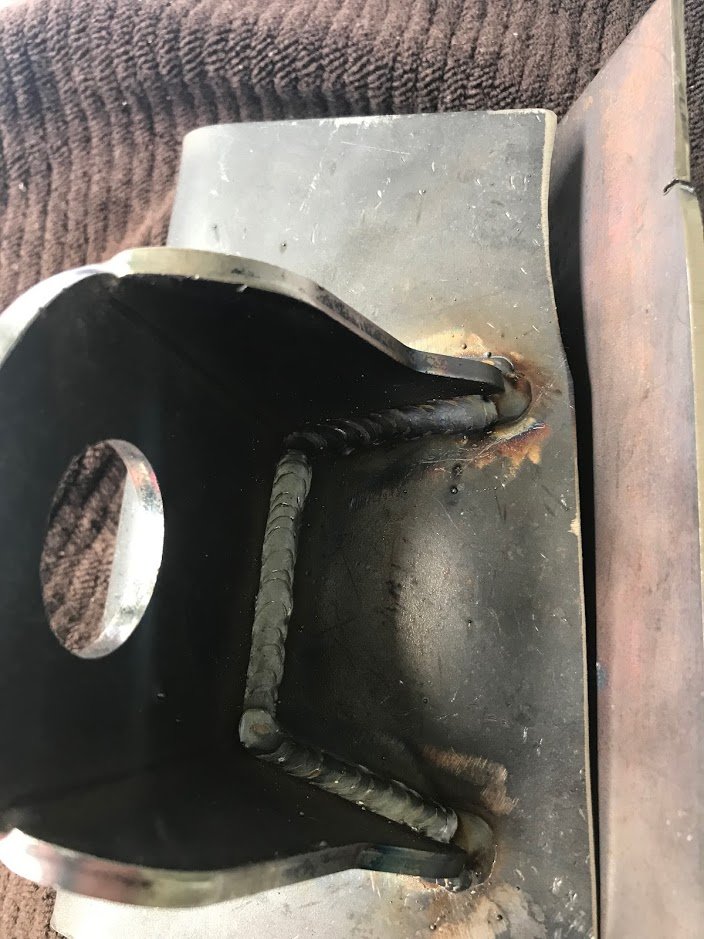

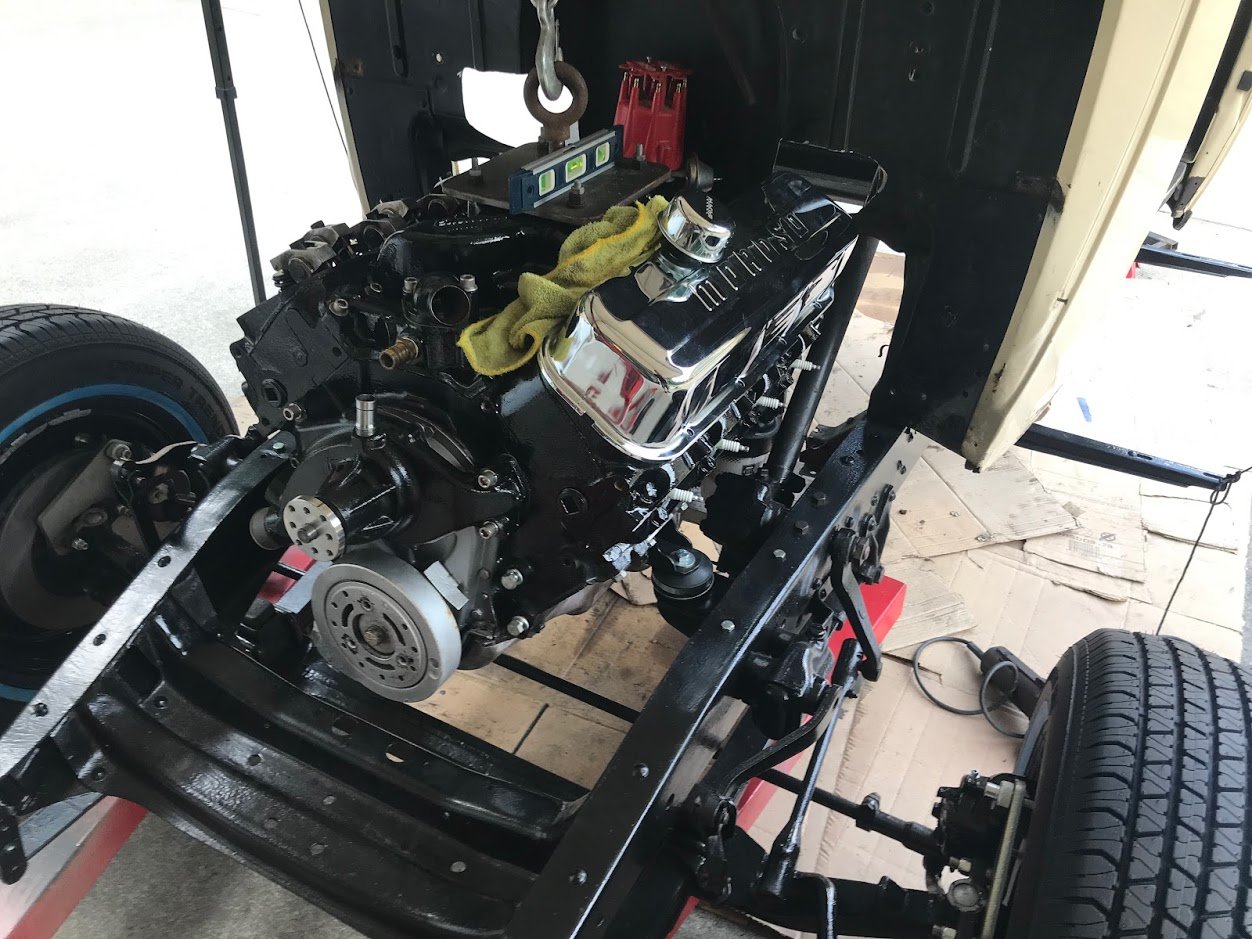

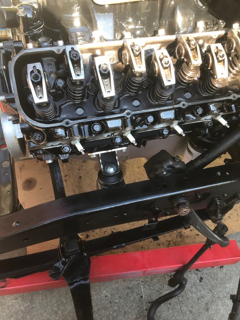

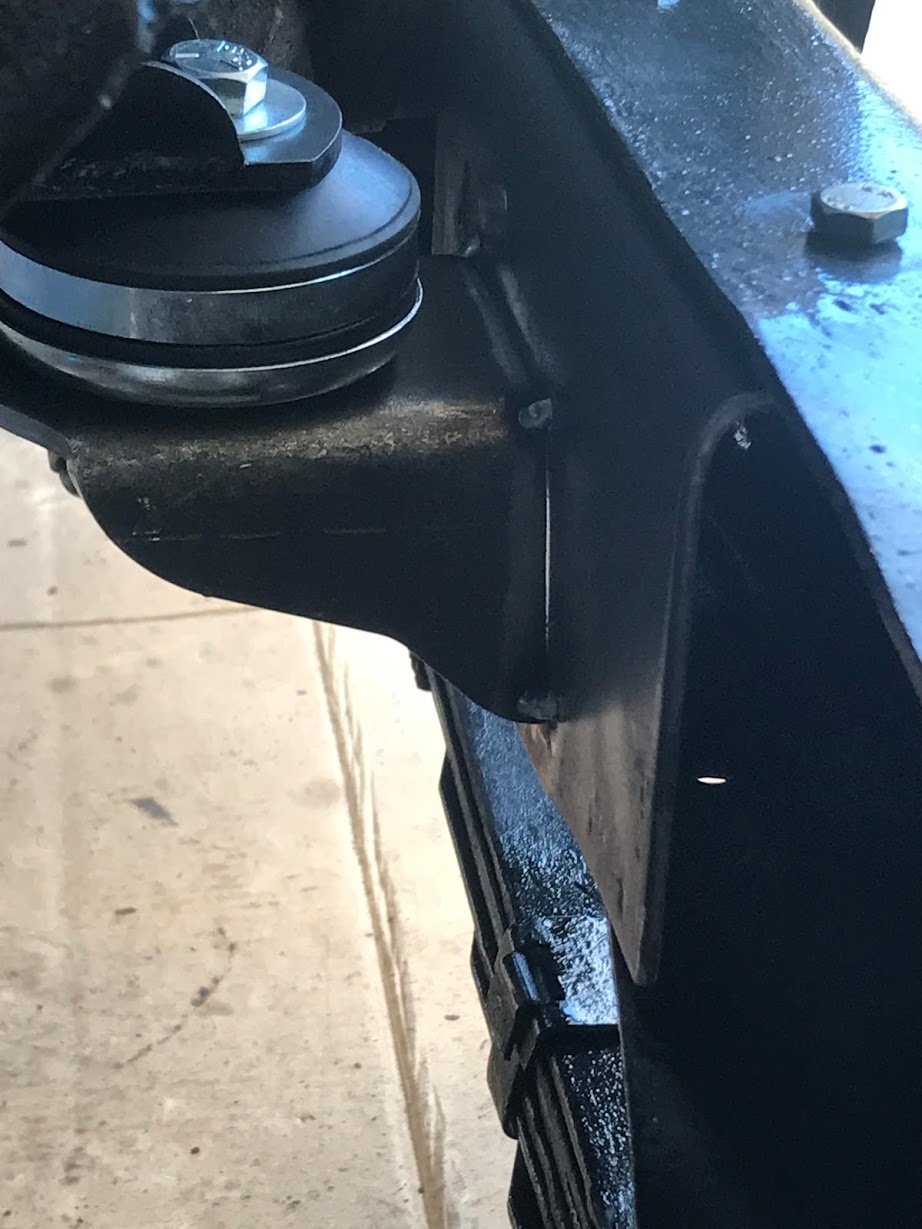

    Took the engine mounts to a local fab shop for final welding....

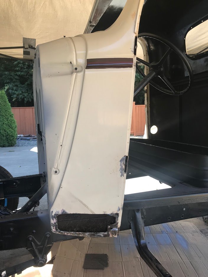

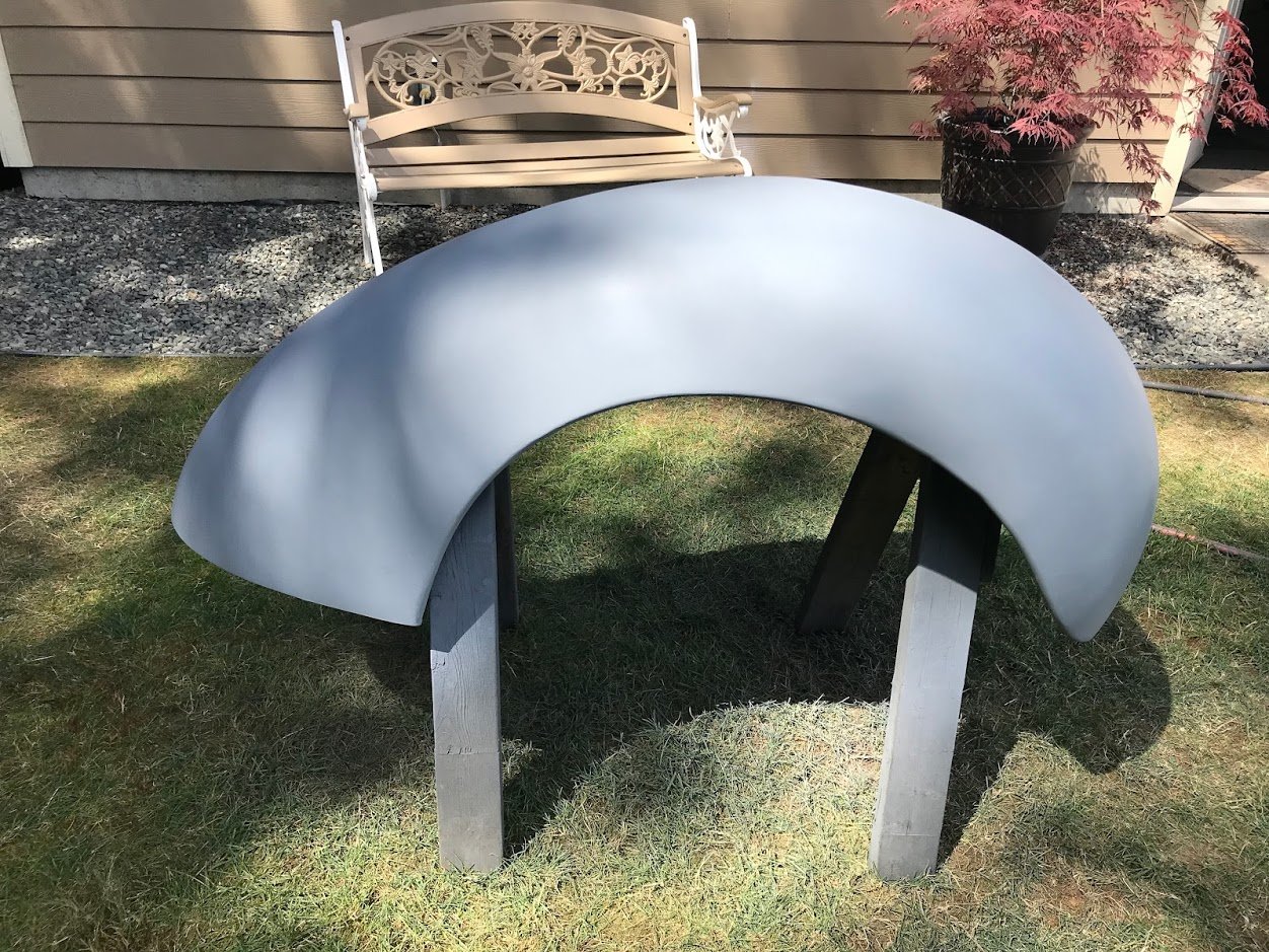

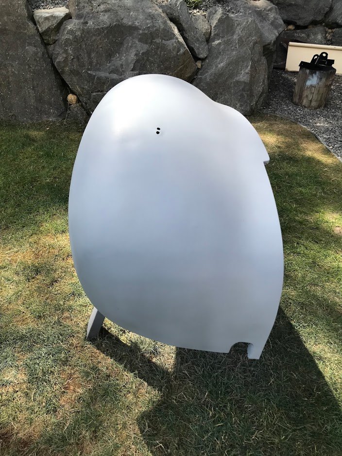

    Front fender got primed...it's now in paint but I didn't snap any pics

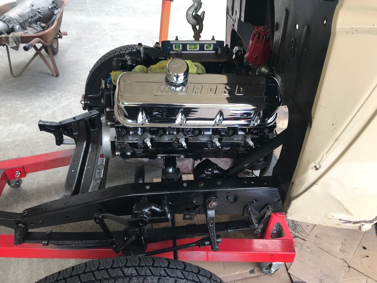

    Engine's finally sitting on bolted mounts... truck dropped roughly 1.5inches with the engines weight on the chassis

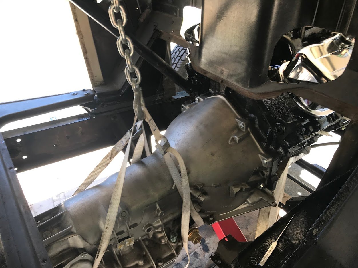

    Trans placement looks like it won't cause too many fitment issues

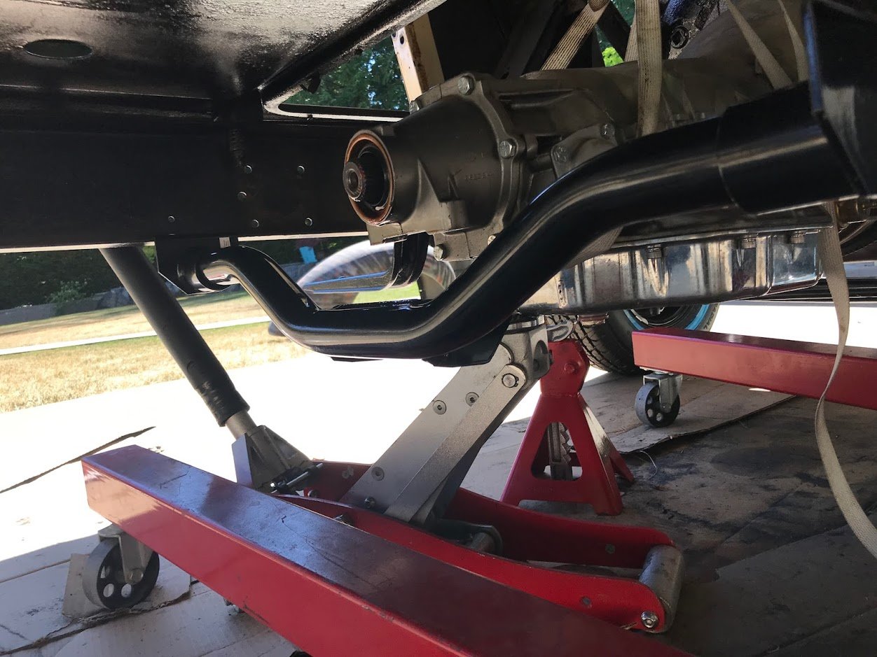

    Final cross member fitment will be 3" up from the bottom of the frame rail....the tail shaft angle sits 2.75 degrees downward

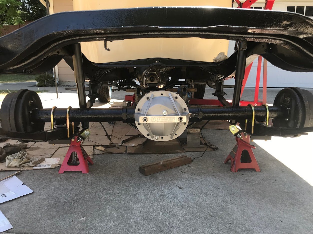

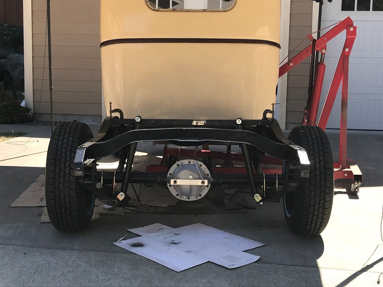

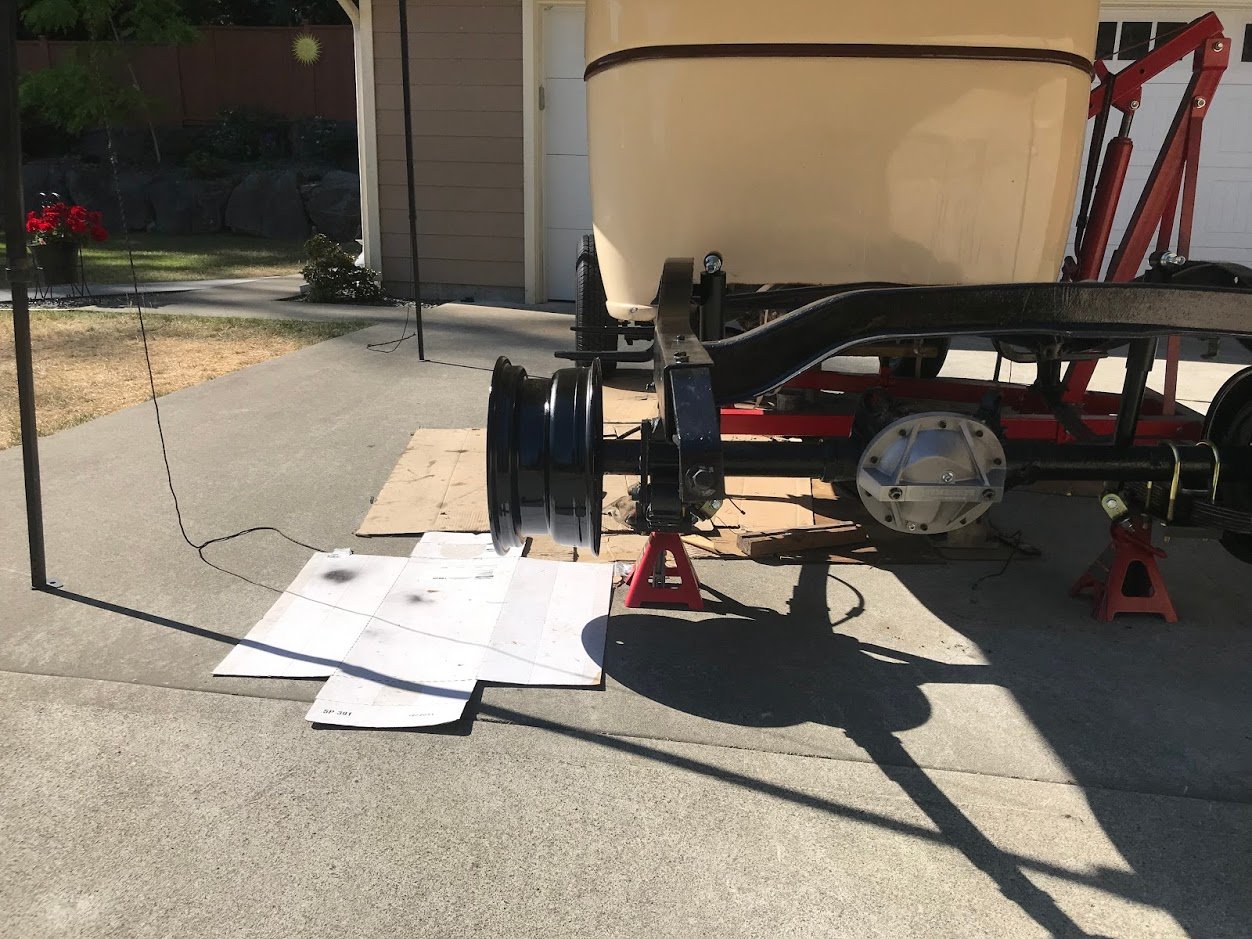

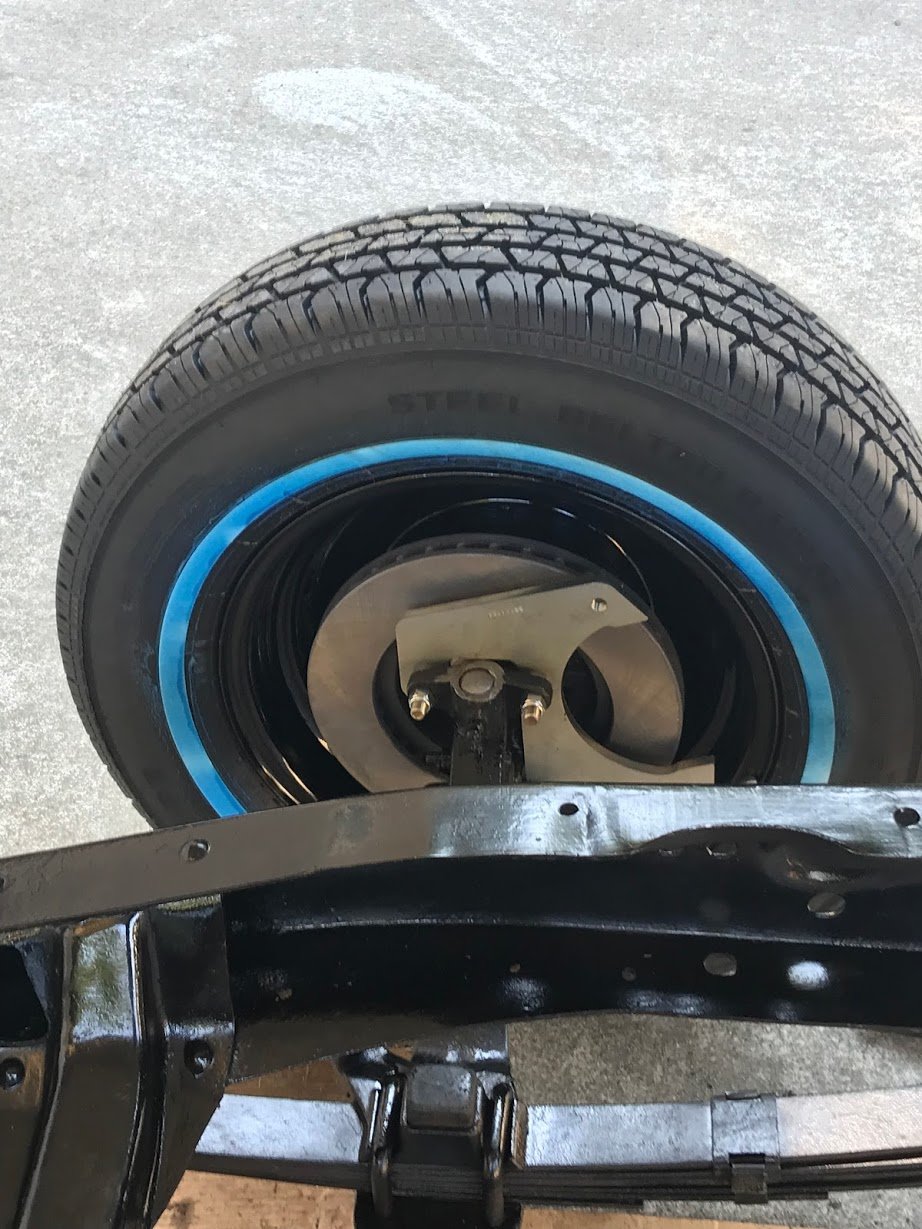

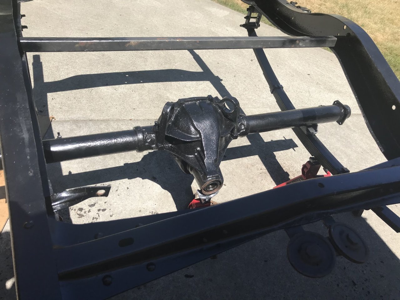

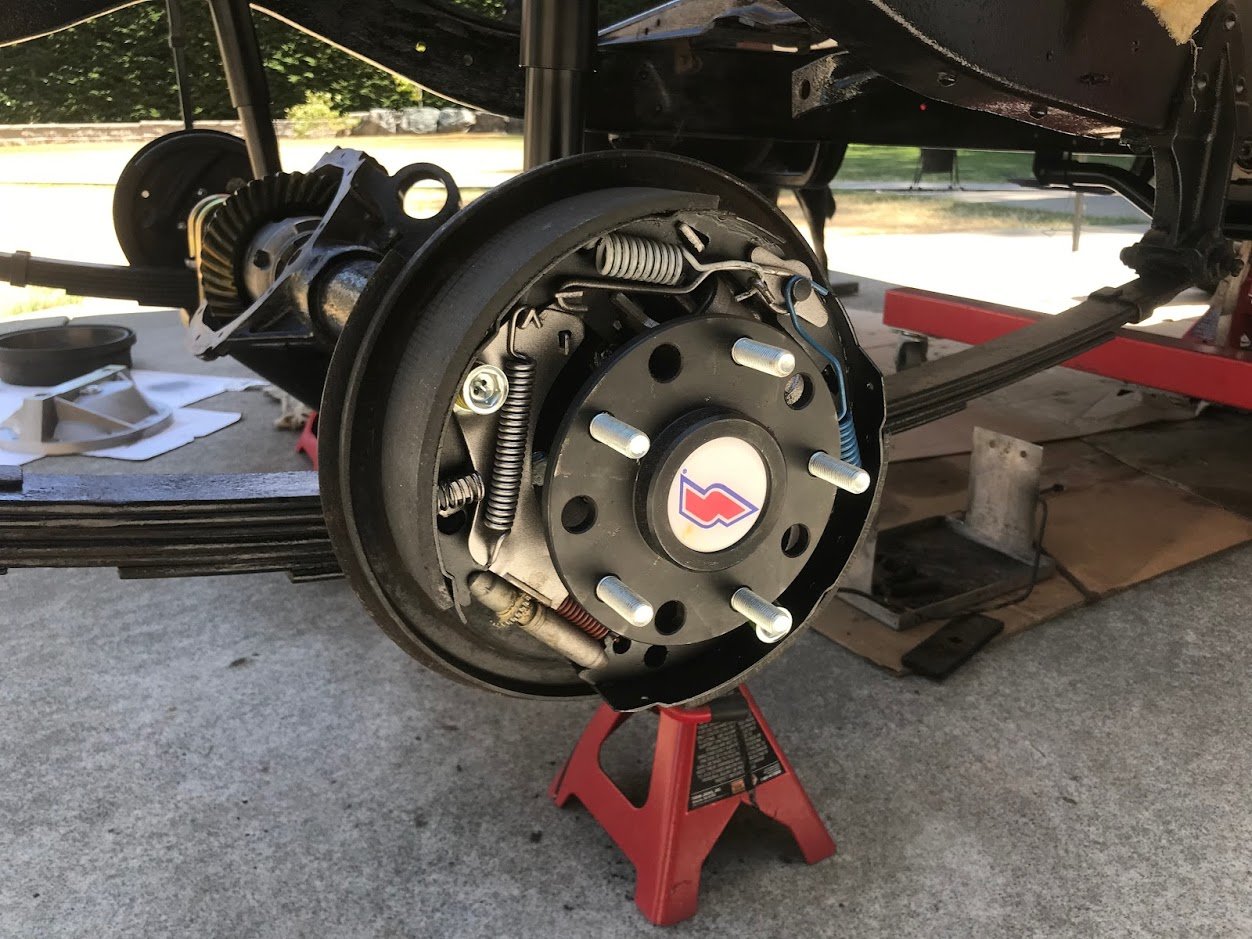

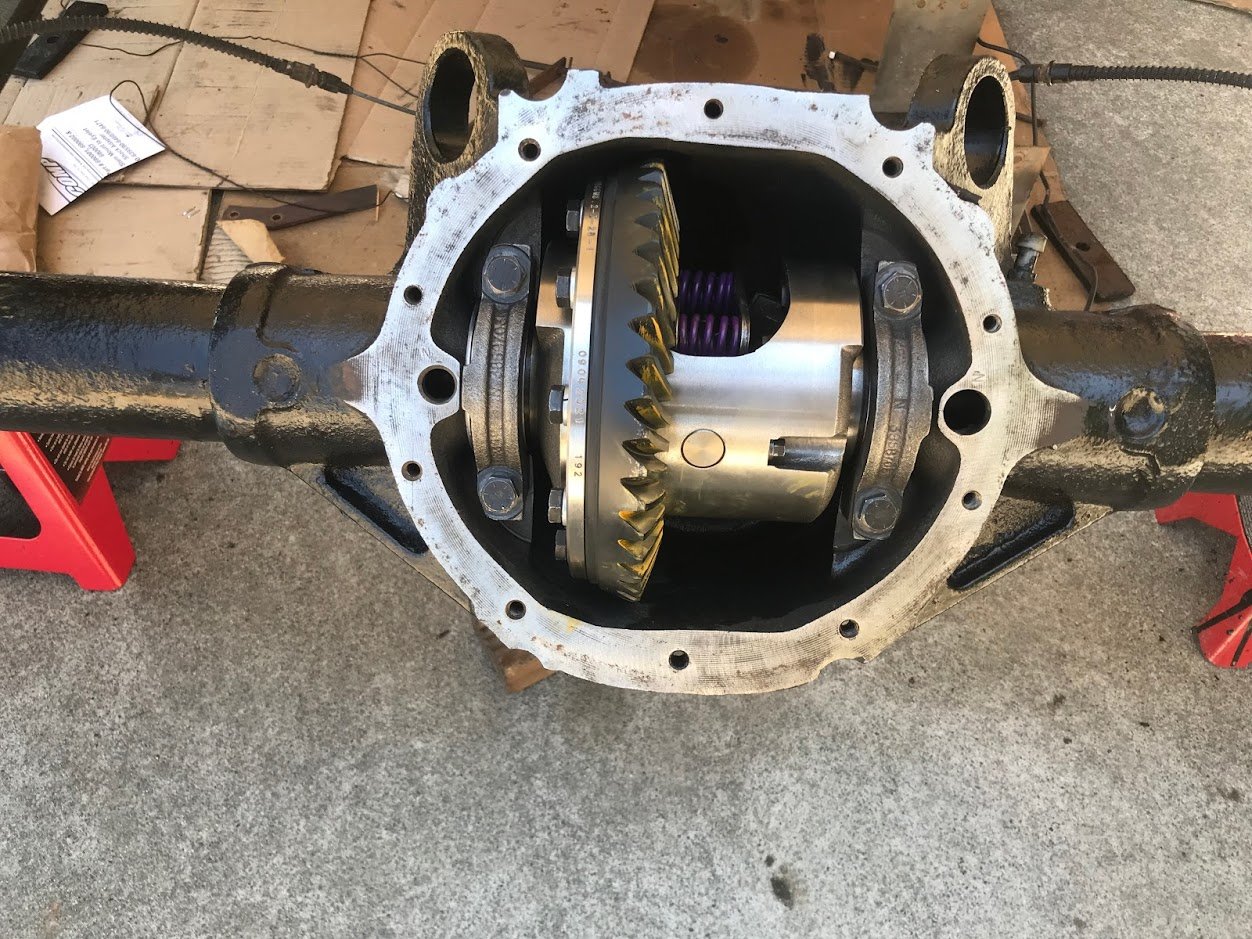

    Took the rear to a local 4x4 shop to have the R/P and diff installed. I've had them set up gears before and never had an issue.
    Limited options when it comes to diffs for the 8.2 so I ended up with the Yukon unit
    Axles and brakes on
    Followed by the diff cover.... moved the shocks to behind the rear as opposed to in front

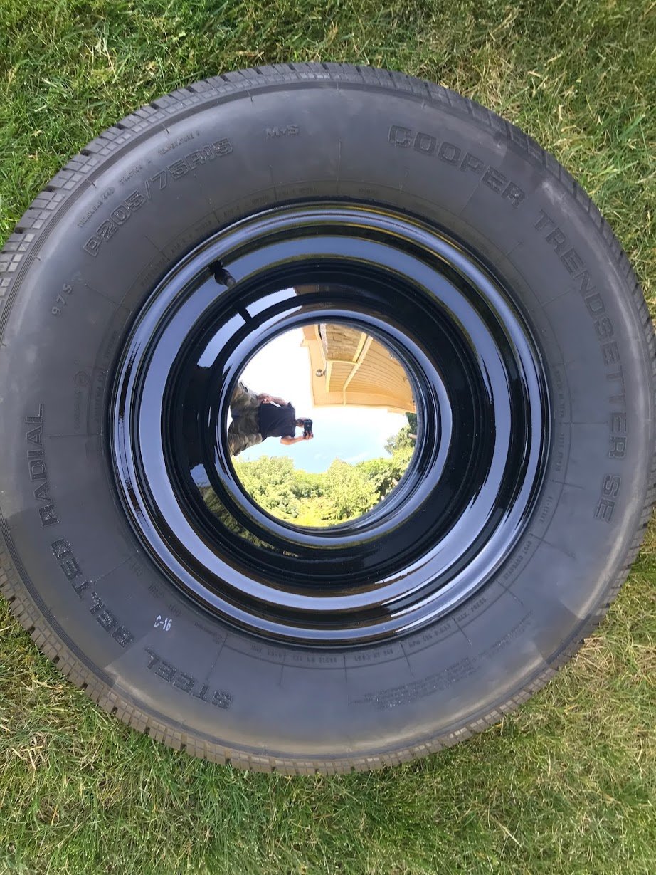

    Rims got some paint love
    Tires mounted and finally it's a roller again

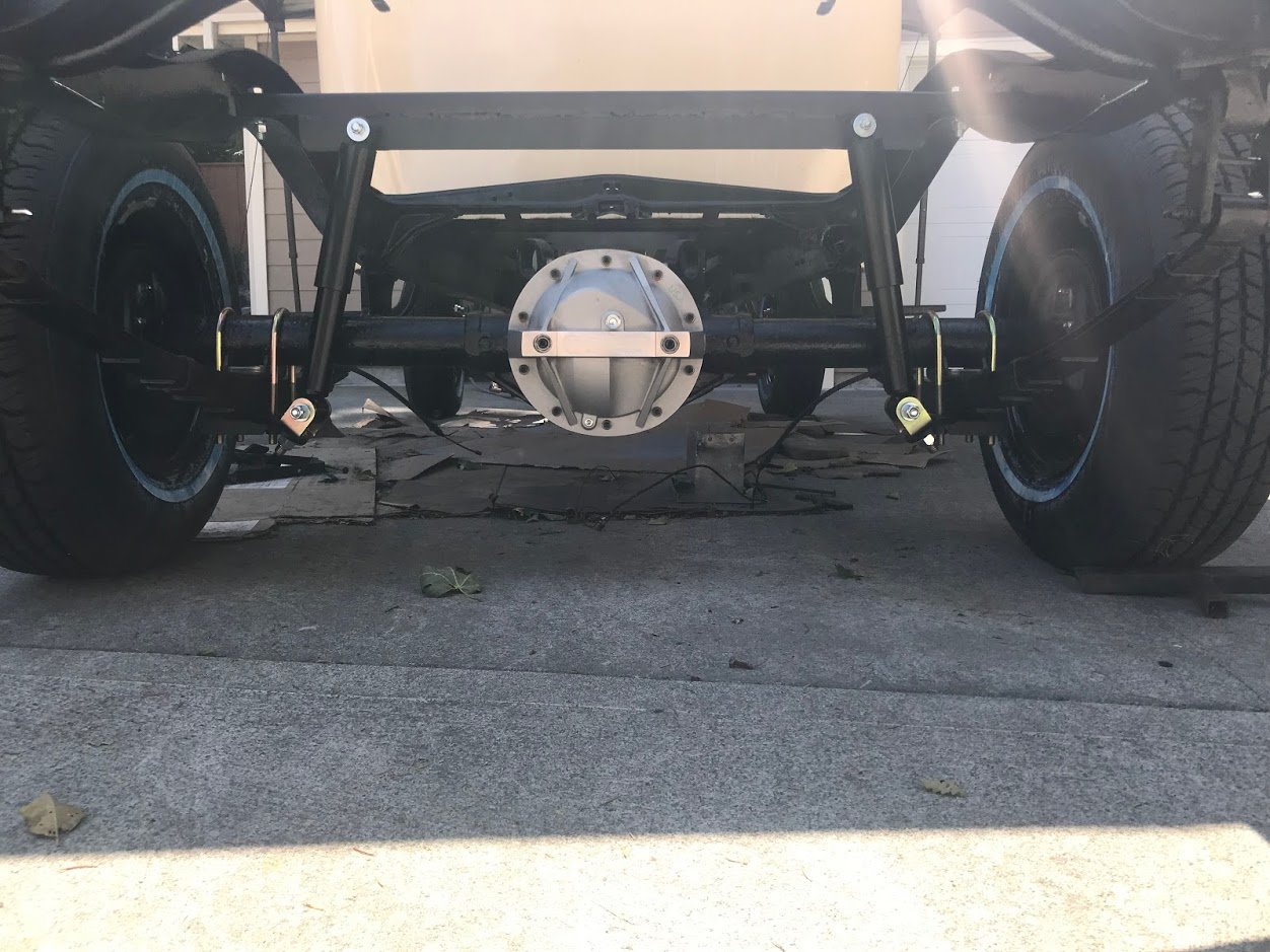

    Rear shock pics are still in mock up...cross member will be sitting lower in the frame rail

    got the rear shocks fully mounted @ a 10degree angle but man they look really straight up in photos

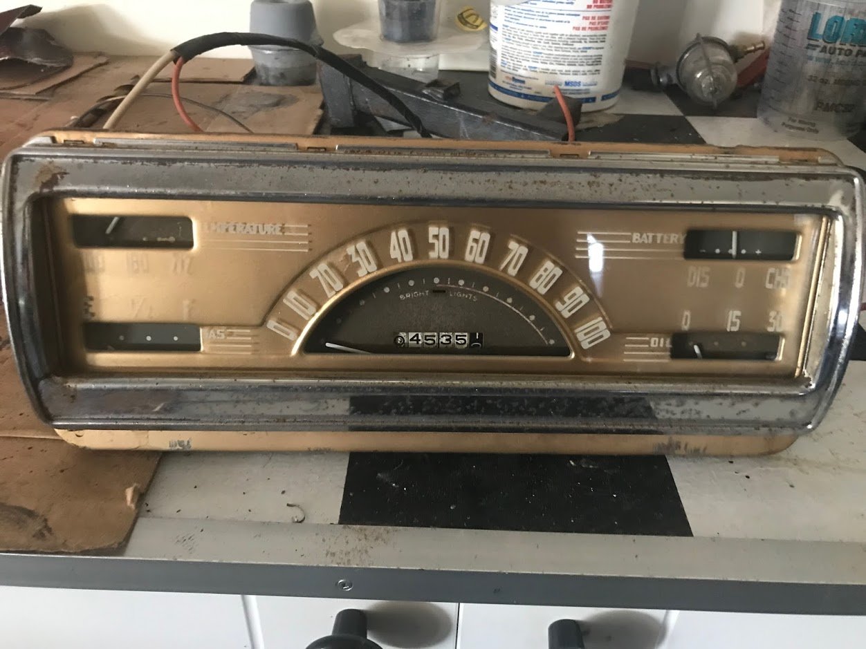

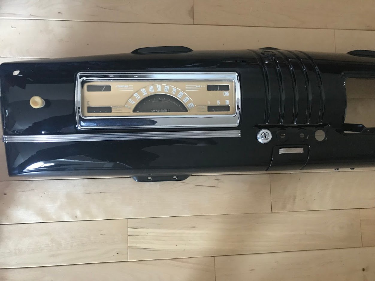

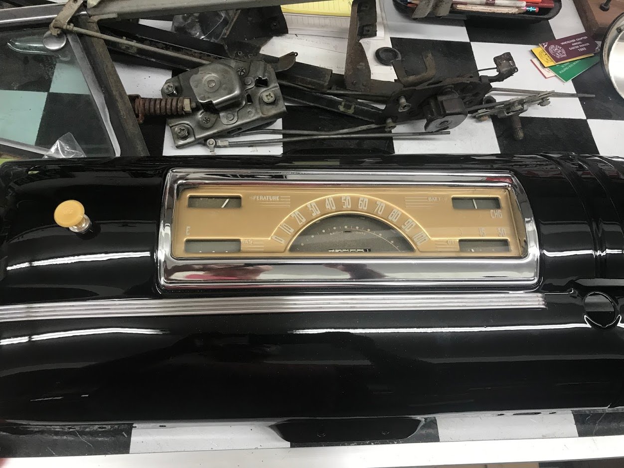

    Spent some time putting the dash back together
    New chrome bezel, polished up the stainless trim and the ignition switch
