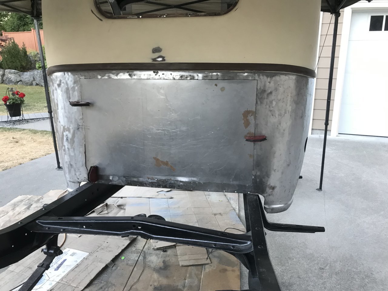

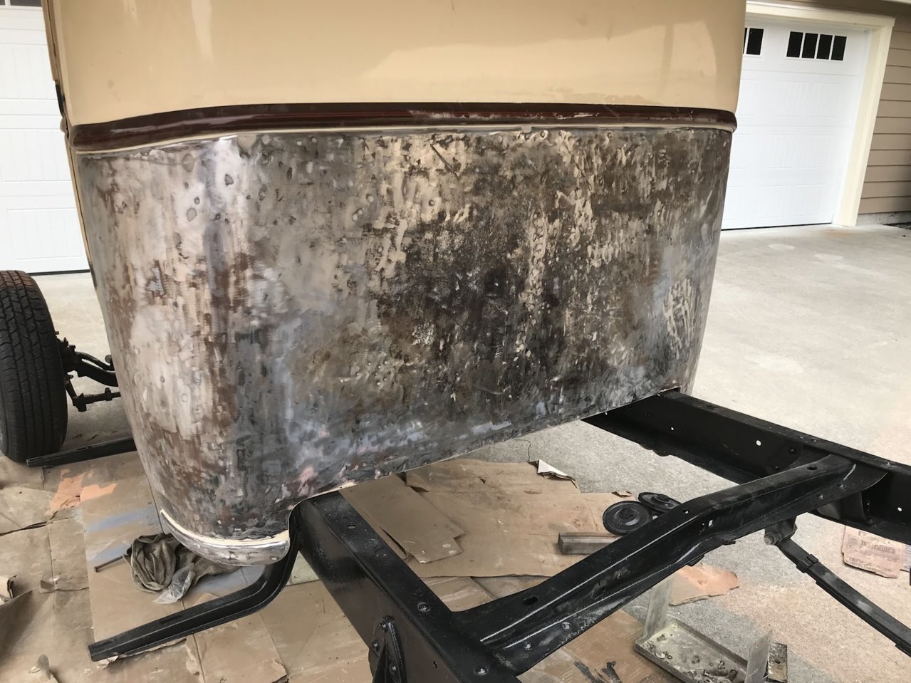

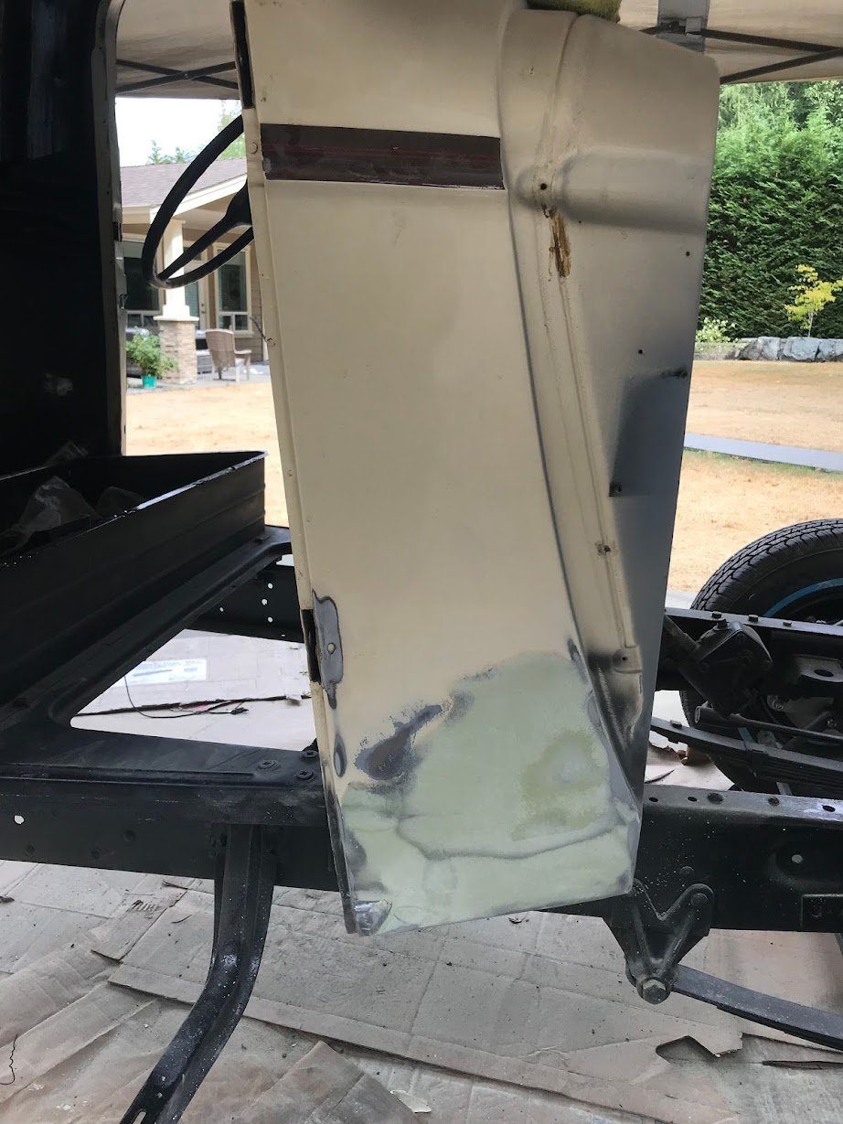

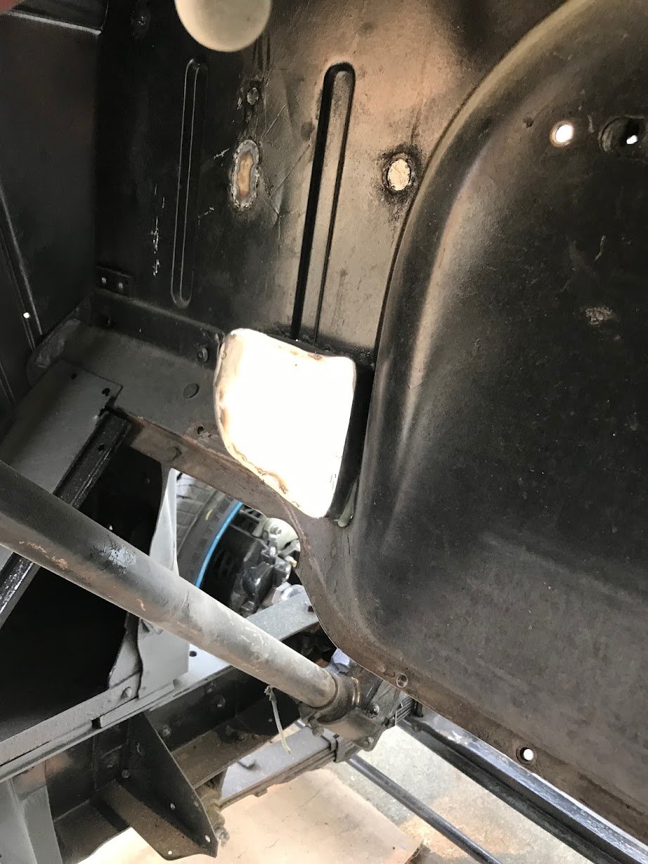

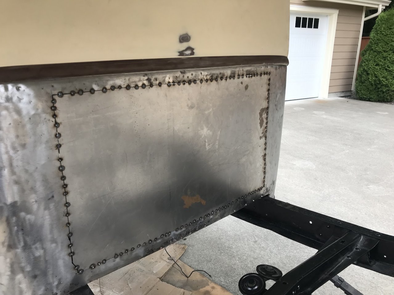

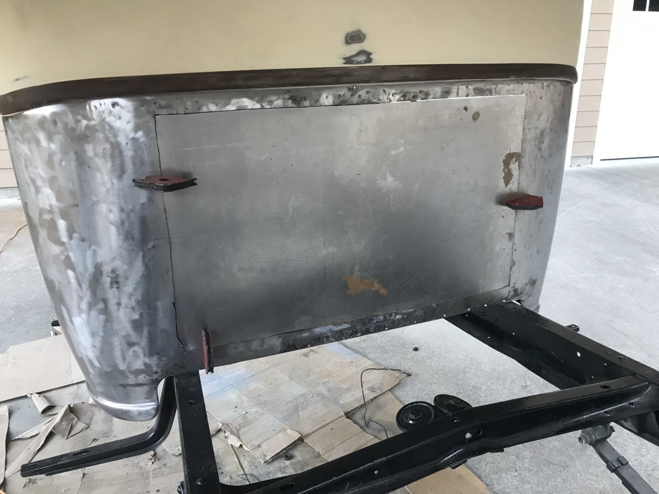

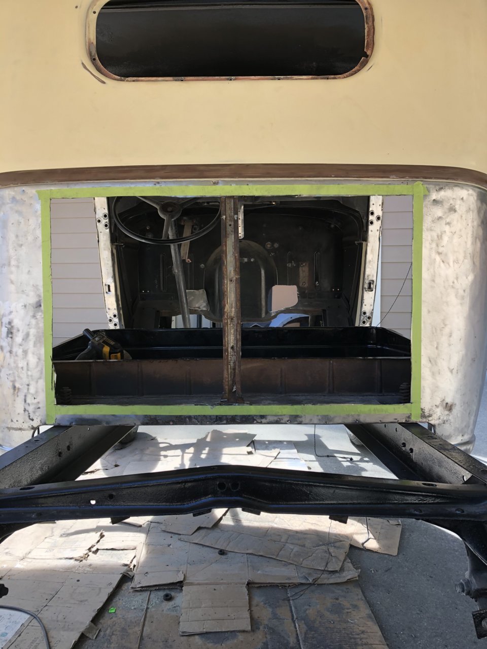

    So... turns out I'm the grand winner in the bondo lottery.
    Much like the fenders, lots of dents and an abuse of bondo to shape and flatten out the surface...
    deanosaurus and wilcam47 like this.

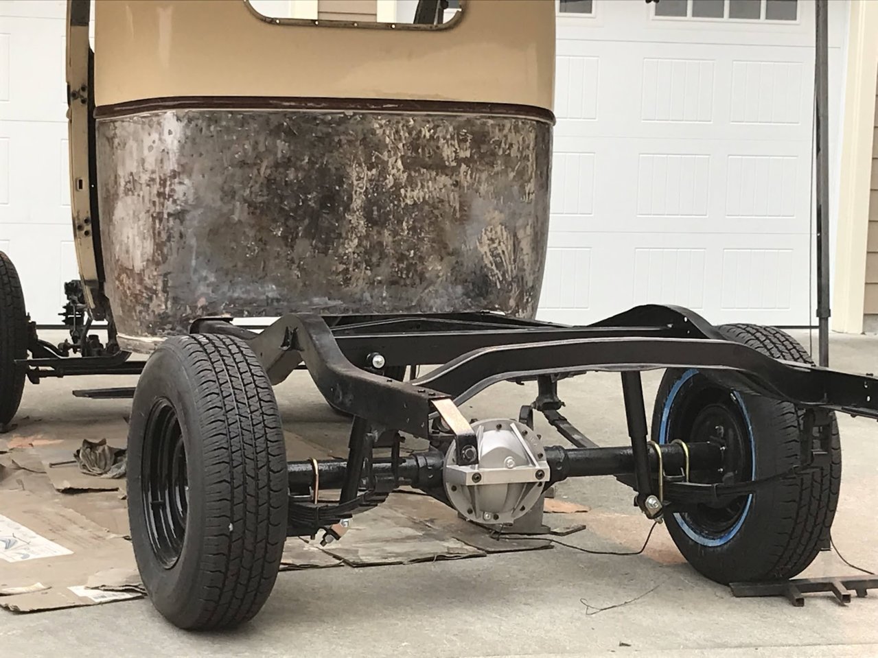

    2019 TRD OffRoad AC M/T

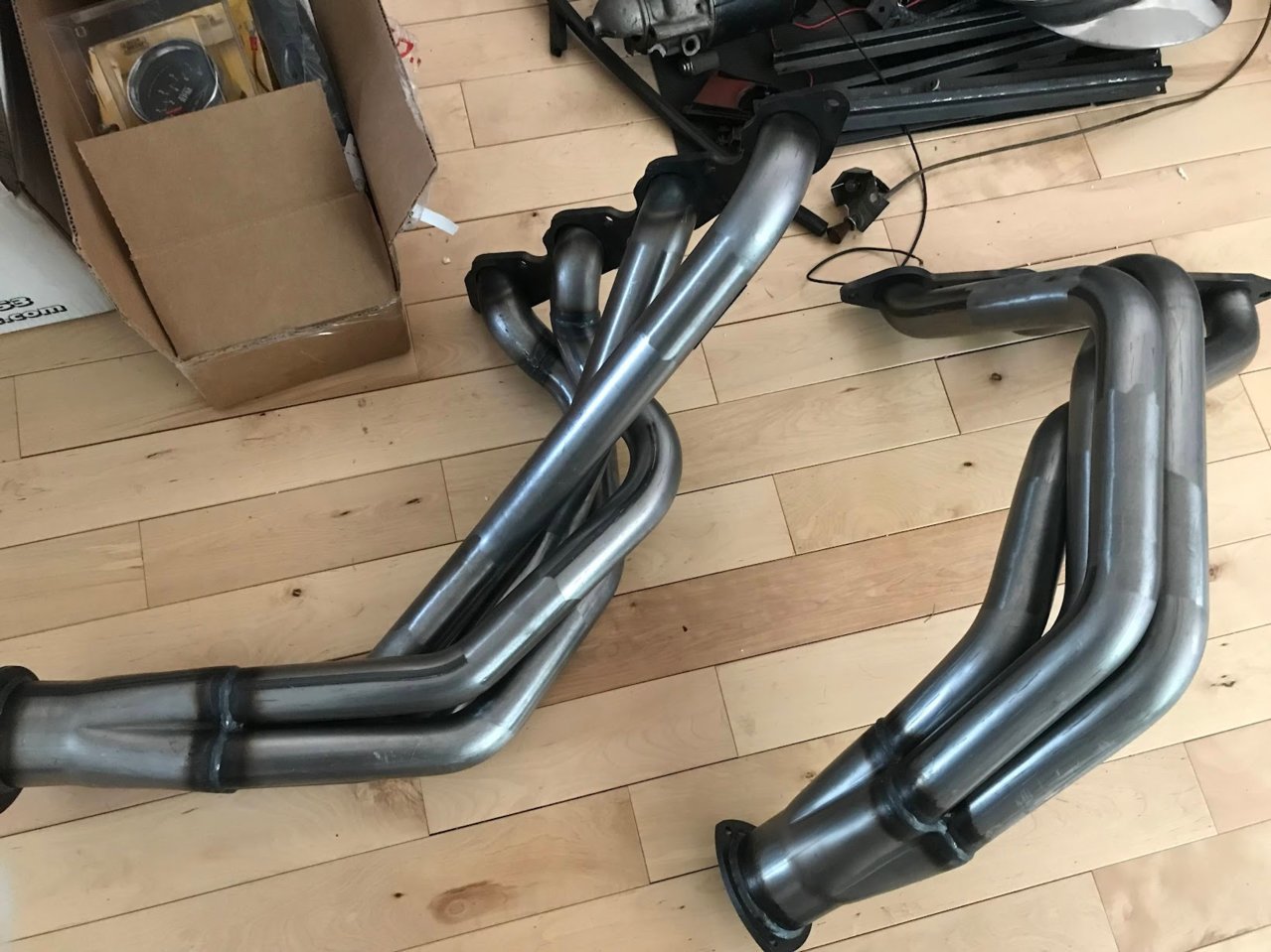

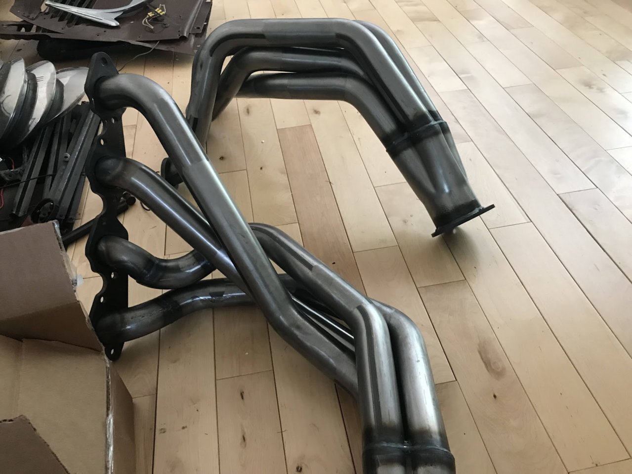

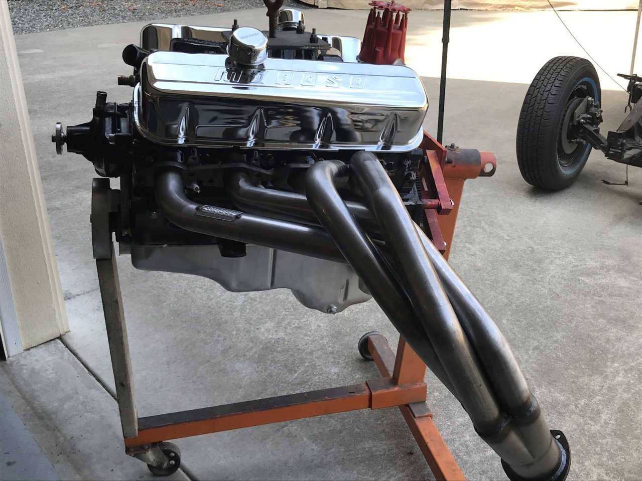

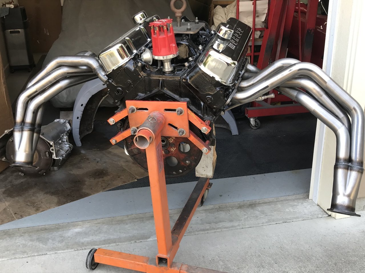

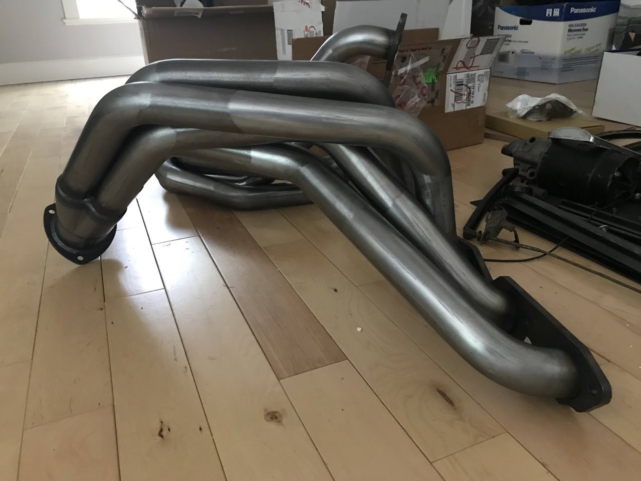

    Made some more progress with the metal work... having a heat wave the last couple of days sort of slows things down. My headers showed up yesterday... Patriot tri 5 fenderwell headers. Needed these to clear the steering box and the motor mounts but they are a little on the crazy side

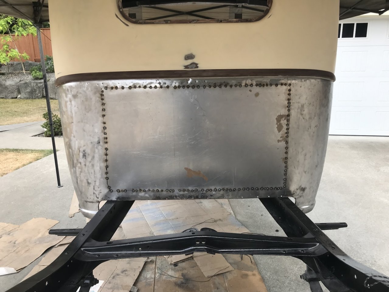

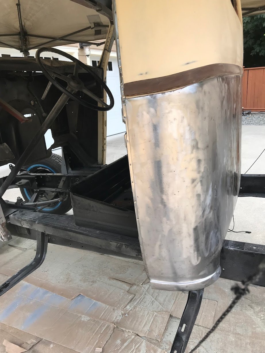

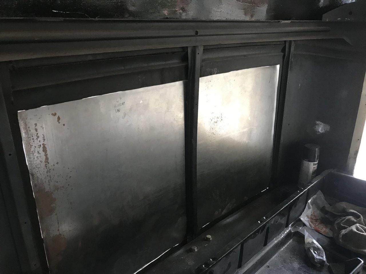

    Body work is easy.... when you get rid of the sheet metal
    wilcam47 and Heyyo_Friday like this.

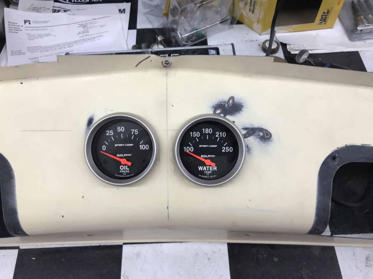

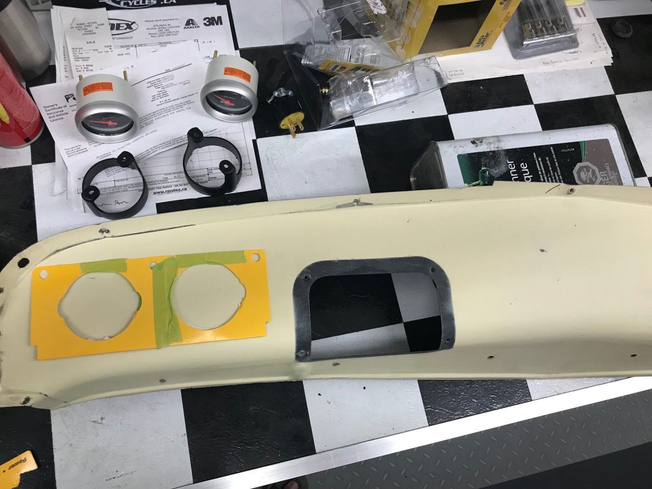

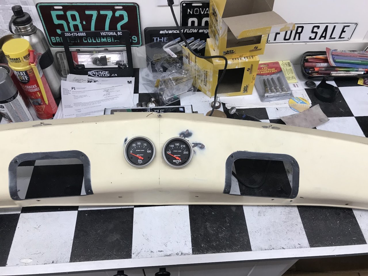

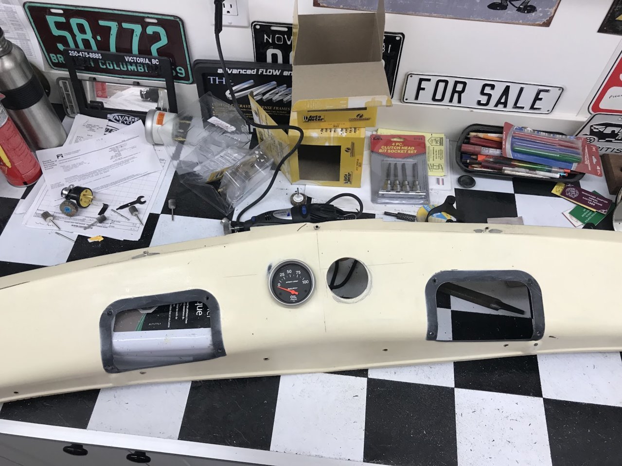

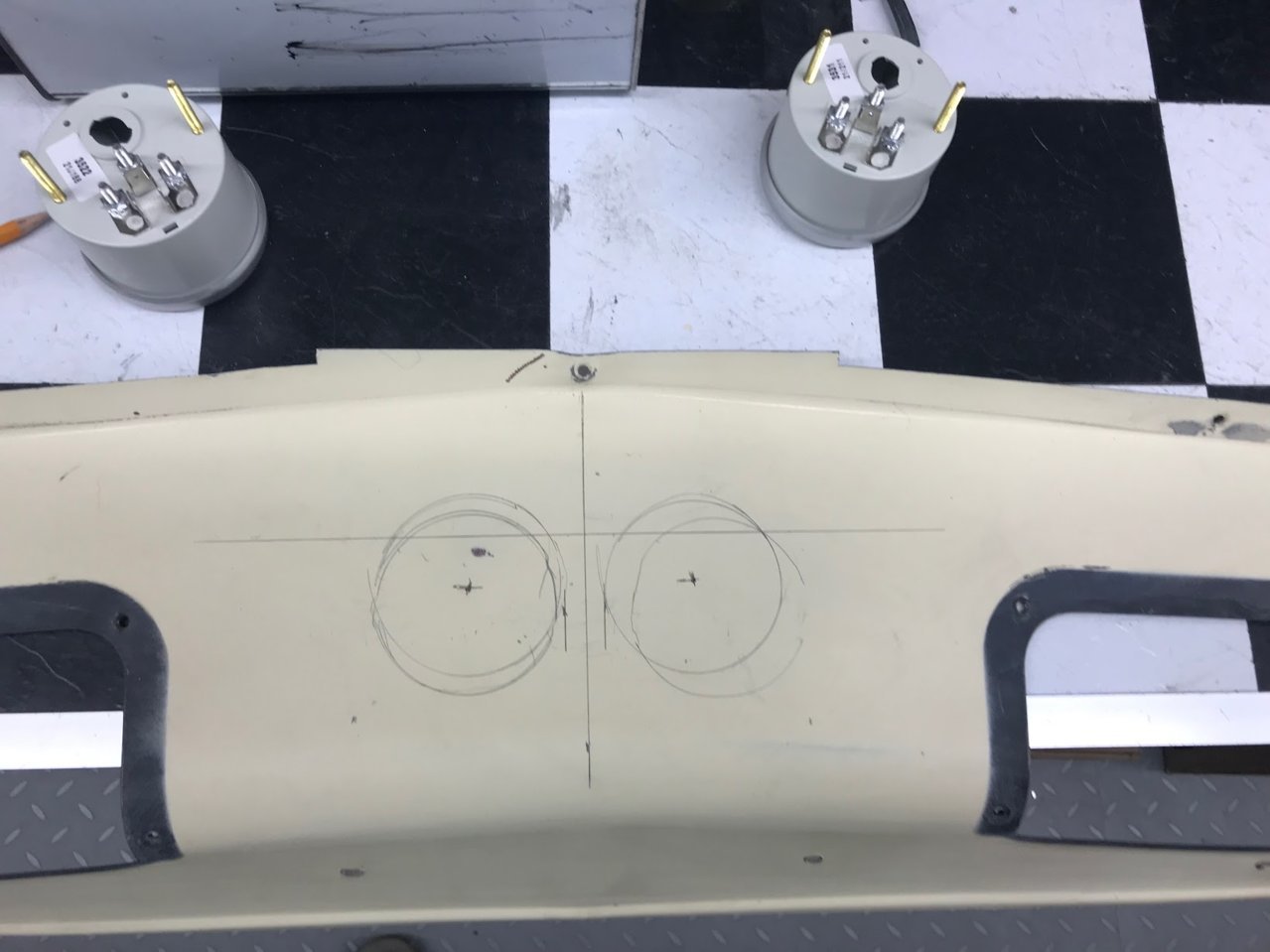

    More of the same...fill some holes and drill some holes
    Was going to run two 2 5/8 gauges offset to the left in the overhead panel... but the curvature of the panel made it impossible for the gauges to appear optically "straight"
    So moving the gauges into the middle of the panel
    jayuu likes this.

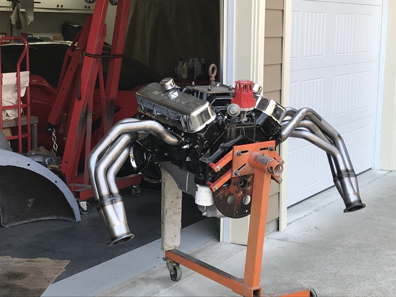

    Got the first one done
    And then there were 2

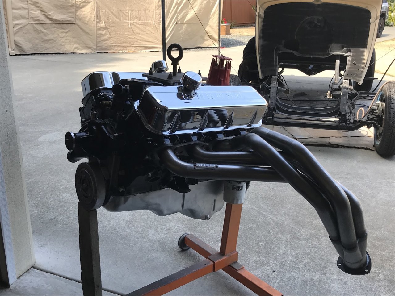

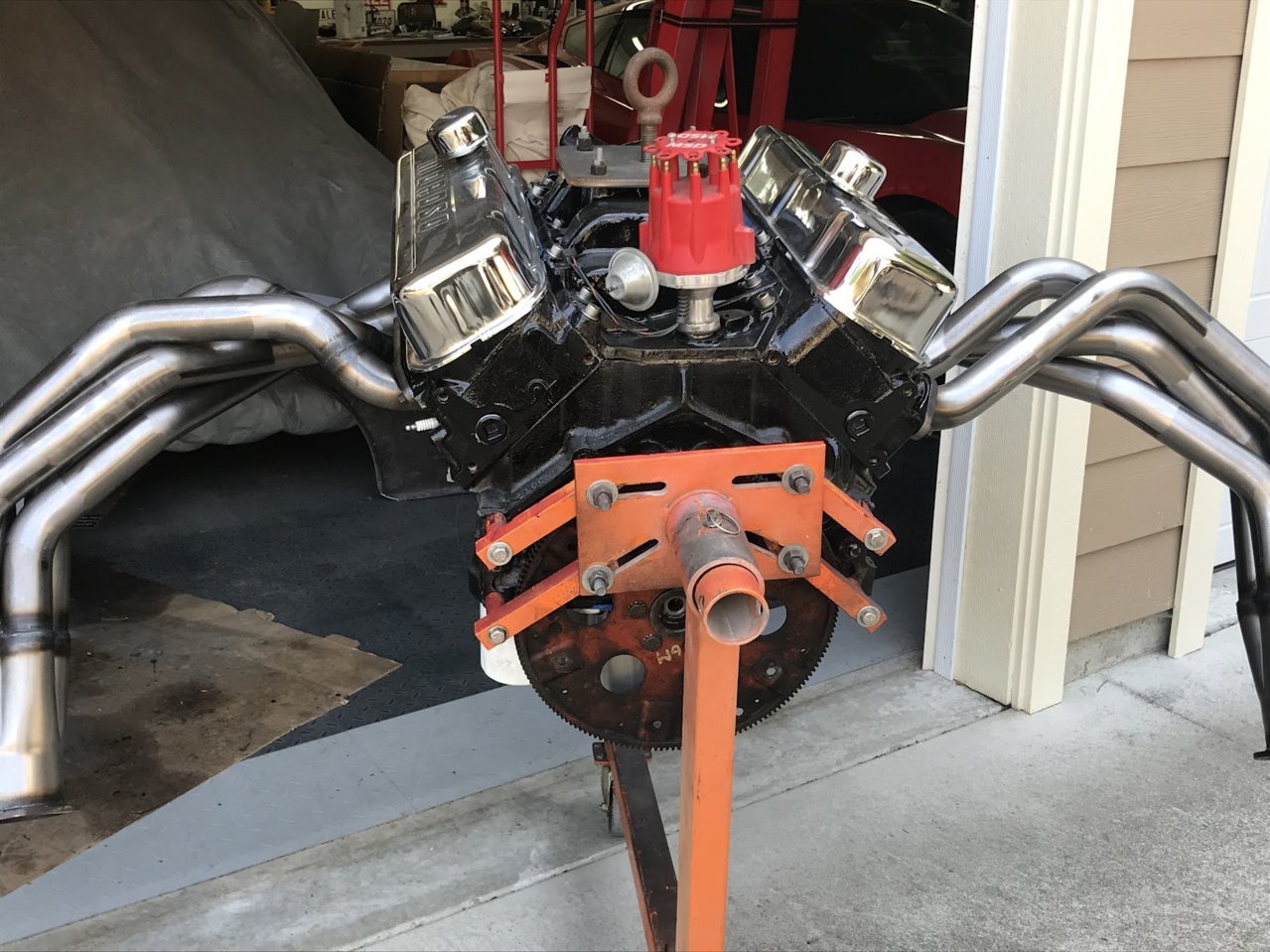

    And because I'm a child at heart... couldn't resist seeing what the mounted headers look like
    Result....awesome ridiculousness

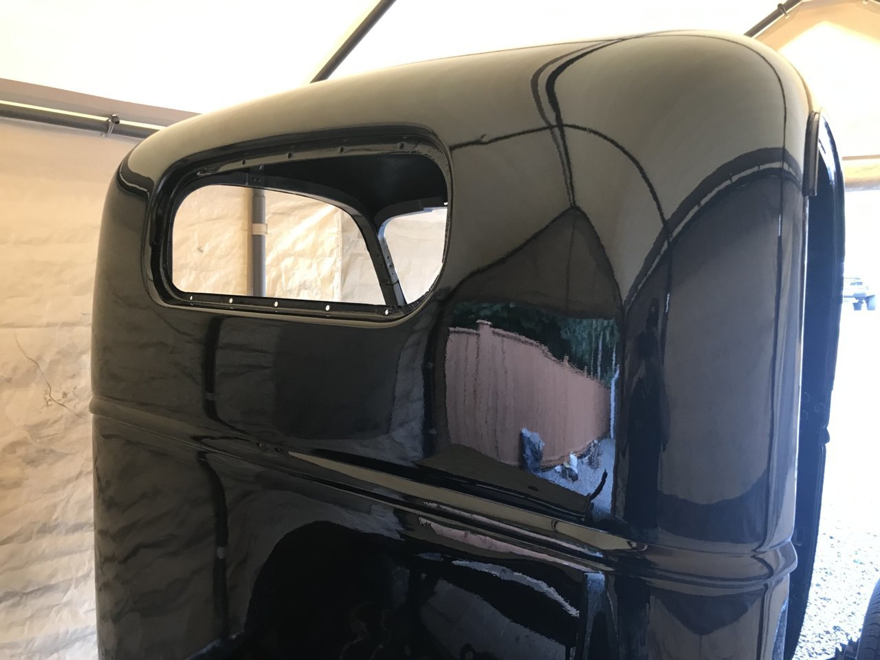

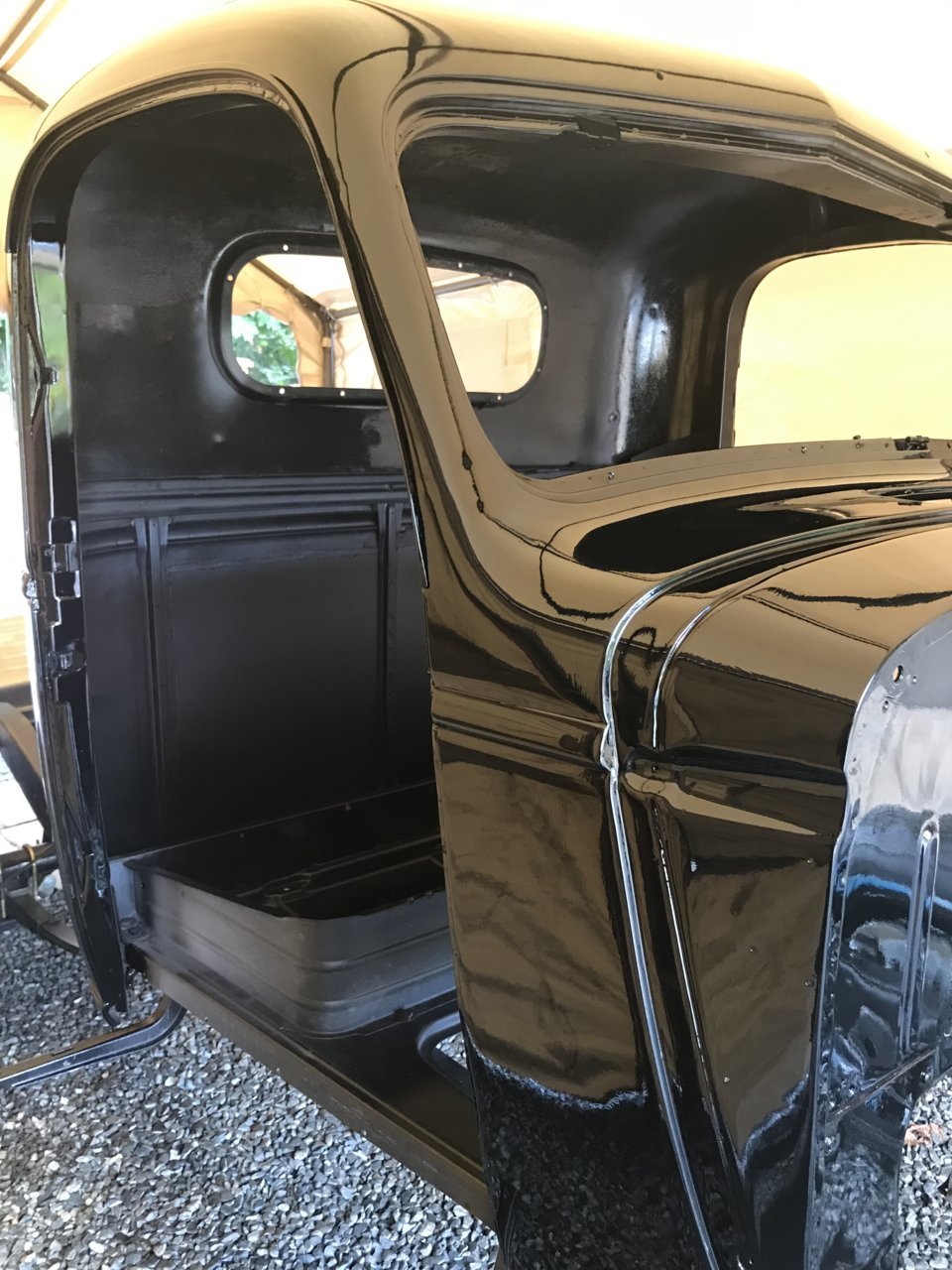

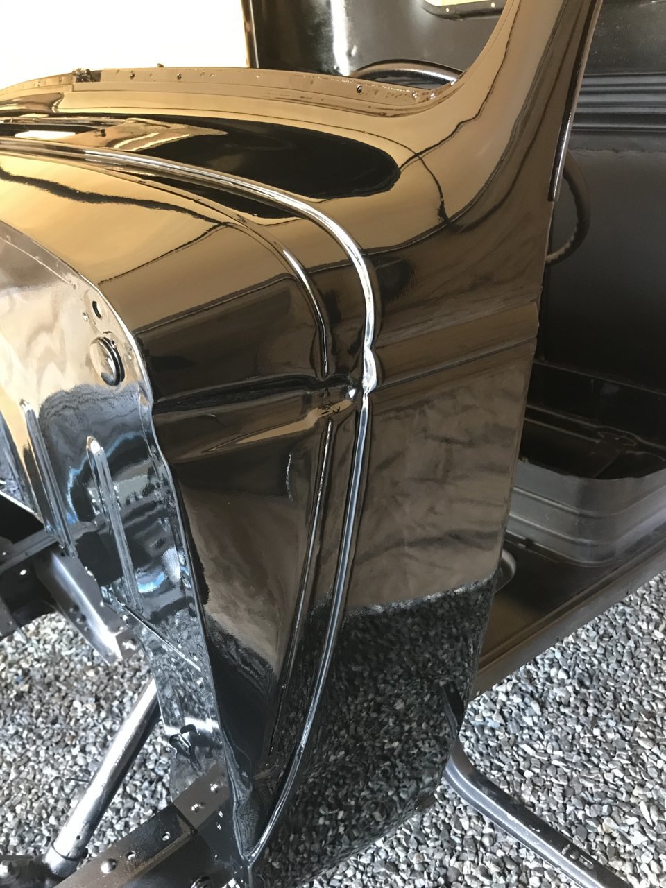

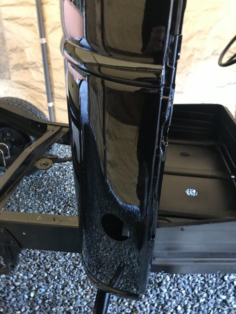

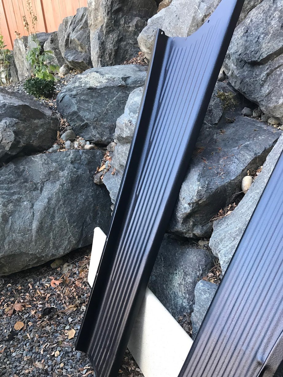

    Been a while since I've done any updates...so it's the good, the bad and the ugly update

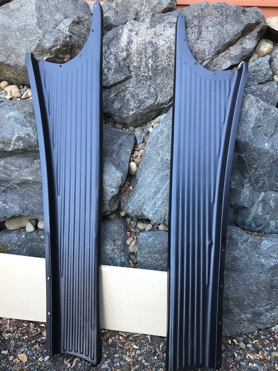

    Finally made a decision on what to do with the running boards... spray on bed liner makes them useable without worrying about scratches and rock chips.
    Body got some paint which is the good

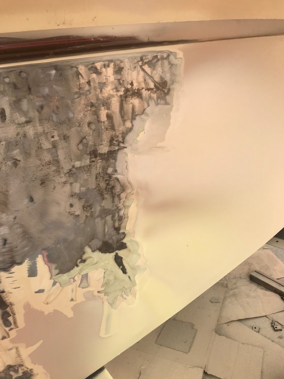

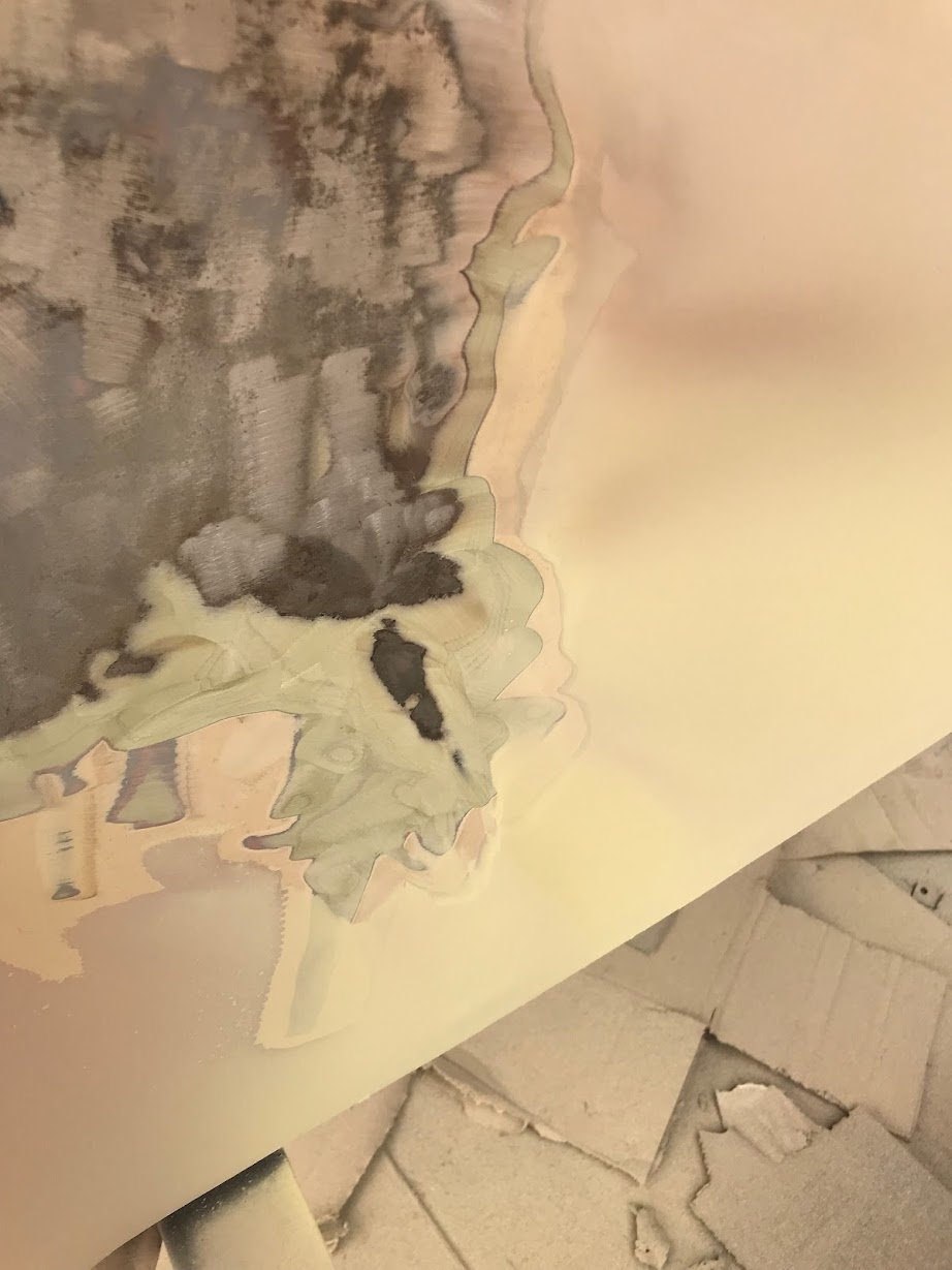

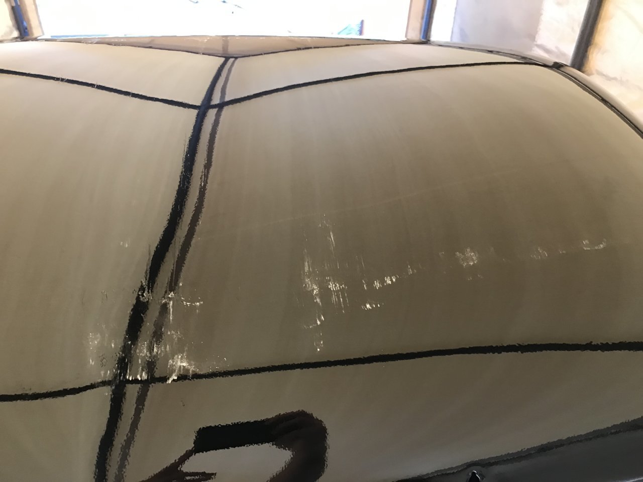

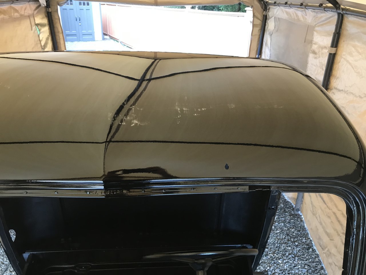

    And then the bad and the ugly.... Rolled it partially outside to take a look in the sun light and didn't notice the tent door was hanging a little low... anyone interested in a project vehicle...

    Is that just scuffs in the paint or is there actual metal damage?
  17. Sep 9, 2021 at 7:44 AM
    #57
    32vsnake
    32vsnake [OP] Well-Known Member
    Oct 8, 2013
    #114132
    380
    Mill Bay BC
    No metal damage.... scuff marks and a couple of deep grooves that look like they go through the clear and into the black.

    That's good... annoying AF, but at least it's just paint, and the roof.

    Plan A is to tape the affected section off, sand it back and respray/ blend. If the blending fails then Plan B will be to sand the roof down to the beltline and redo the entire roof.
    Puts a crimp in my plans to put the engine /trans back in this weekend...oh well
