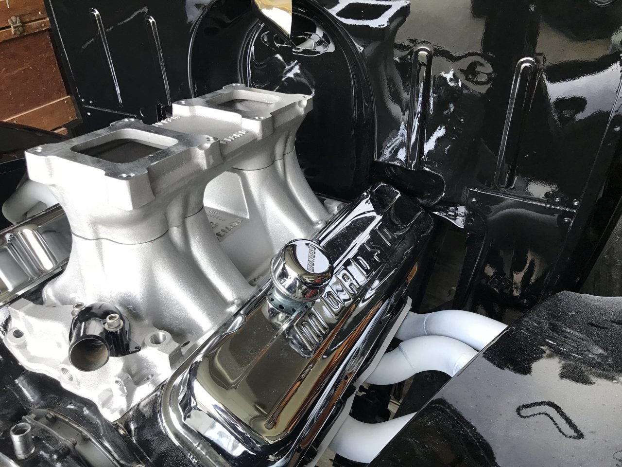

    In that 60's type vein, I actually have a wieand tunnel ram ordered but it's on back order and won't ship till the end of the month.

    Plan B it is

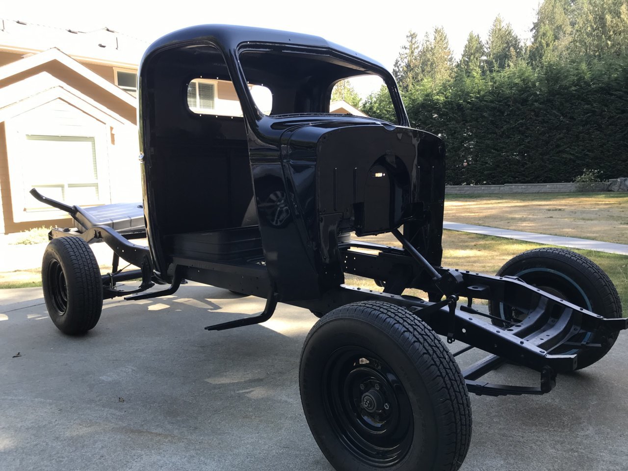

  5. Sep 12, 2021 at 2:59 PM
    #65
    32vsnake
    32vsnake [OP] Well-Known Member
    Oct 8, 2013
    #114132
    380
    Mill Bay BC
    2019 TRD OffRoad AC M/T

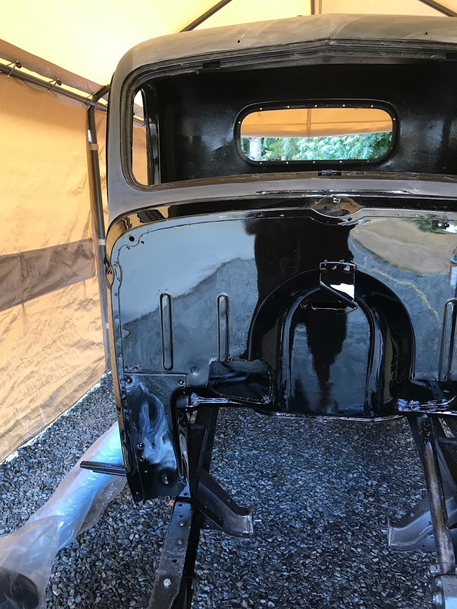

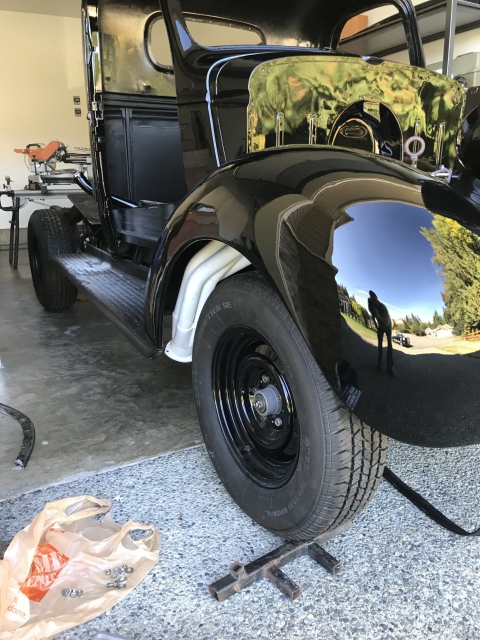

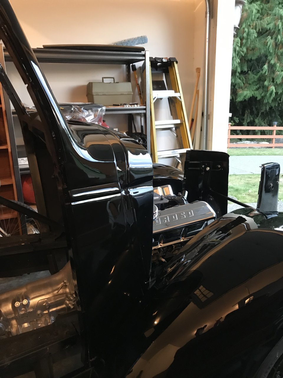

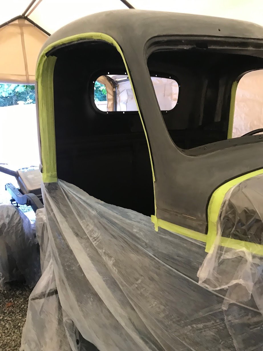

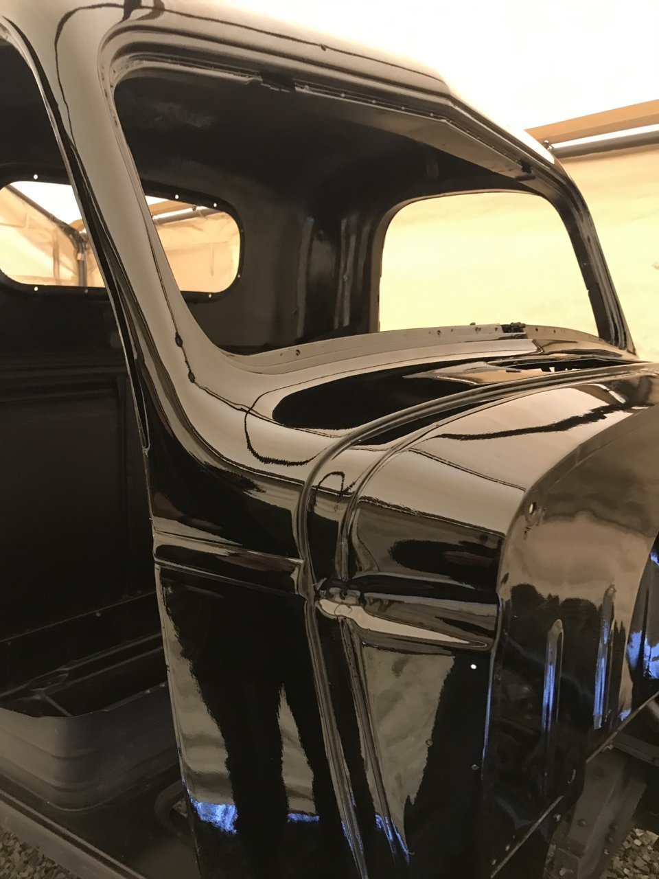

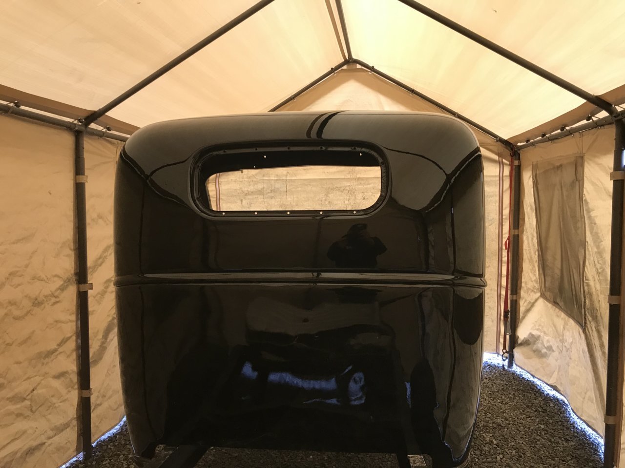

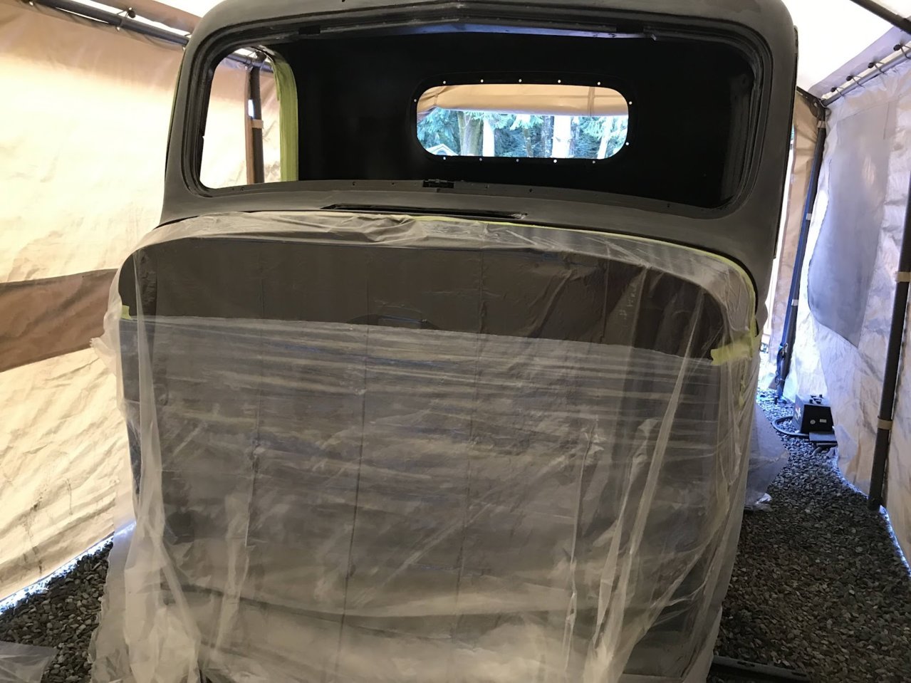

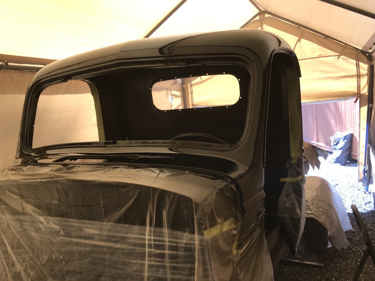

    Got a break in the weather so it's time for the second attempt at painting this thing
  6. Sep 12, 2021 at 3:16 PM
    #66
    Truckntran
    Truckntran Well-Known Member
    Apr 22, 2021
    #363518
    172
    1996 and 1998 Tacoma 2wd
    High mileage work trucks
    Beautiful finish! Don’t even need to color sand or buff!
    What are you using for paint? And what gun are you spraying it through?
  7. Sep 12, 2021 at 4:39 PM
    #67
    32vsnake
    Oct 8, 2013
    #114132
    380
    Mill Bay BC
    So I had a smart ass response ready to go about a dollar store brush and a gallon of Home Depot exterior latex …then we lost power … karma
    it’s Nason2k base and clear sprayed with an old sharpe platinum gun

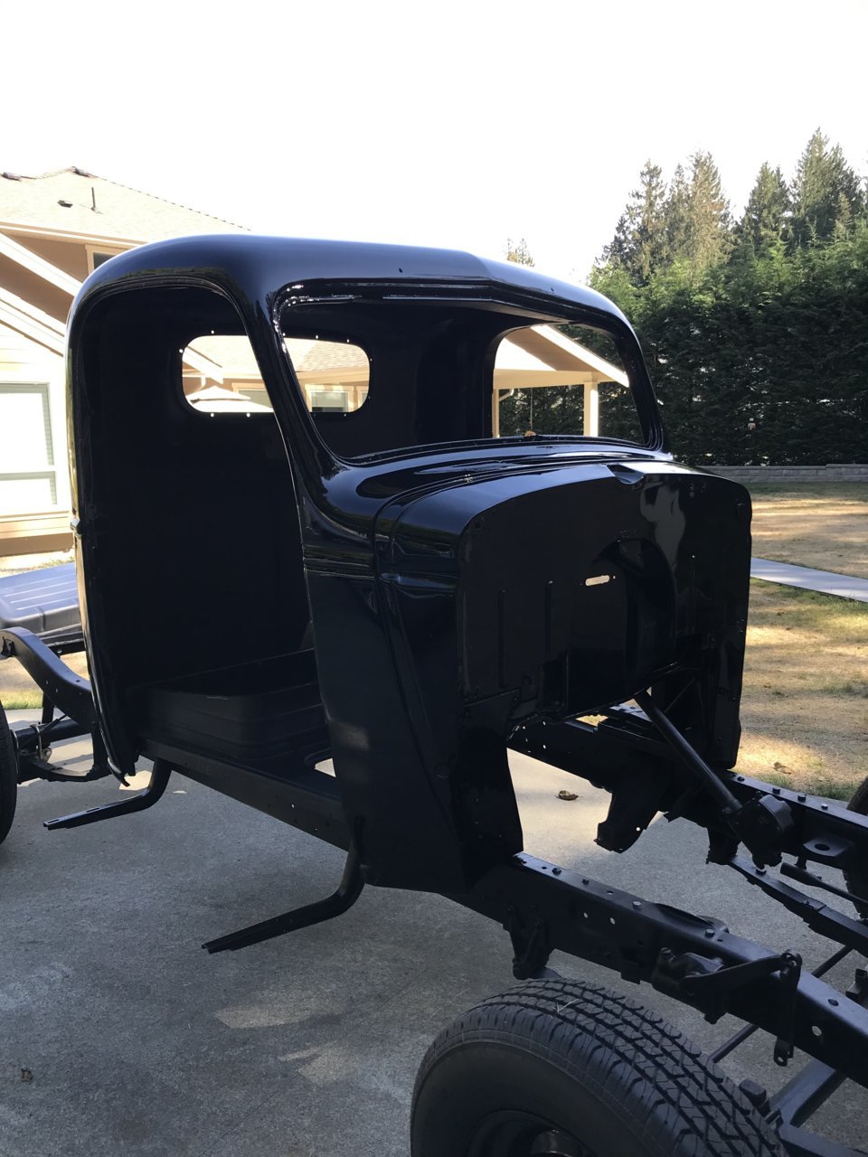

  8. Sep 12, 2021 at 6:14 PM
    #68
    32vsnake
    Oct 8, 2013
    #114132
    380
    Mill Bay BC

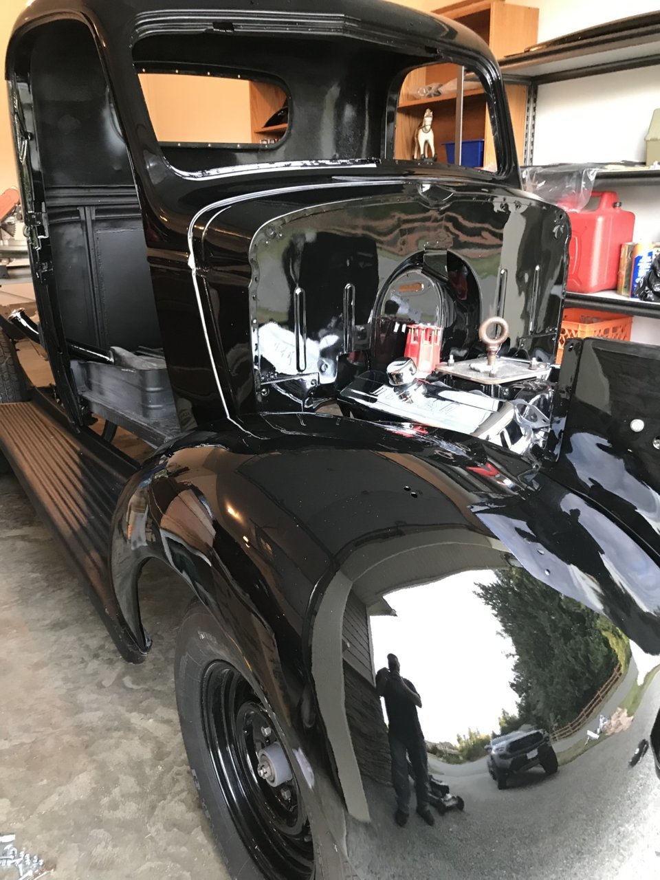

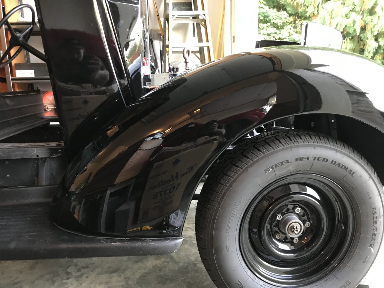

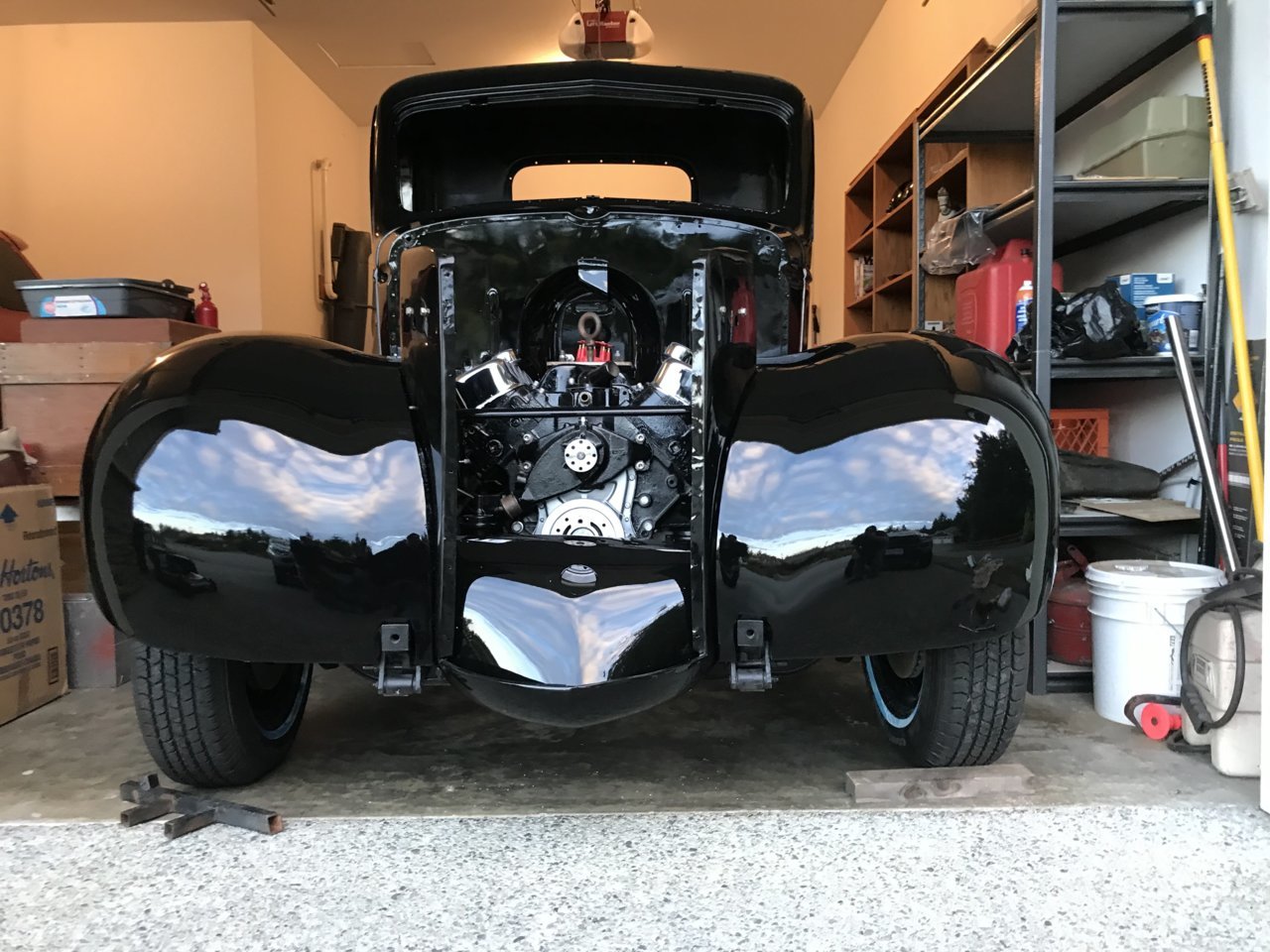

    Couple more pics

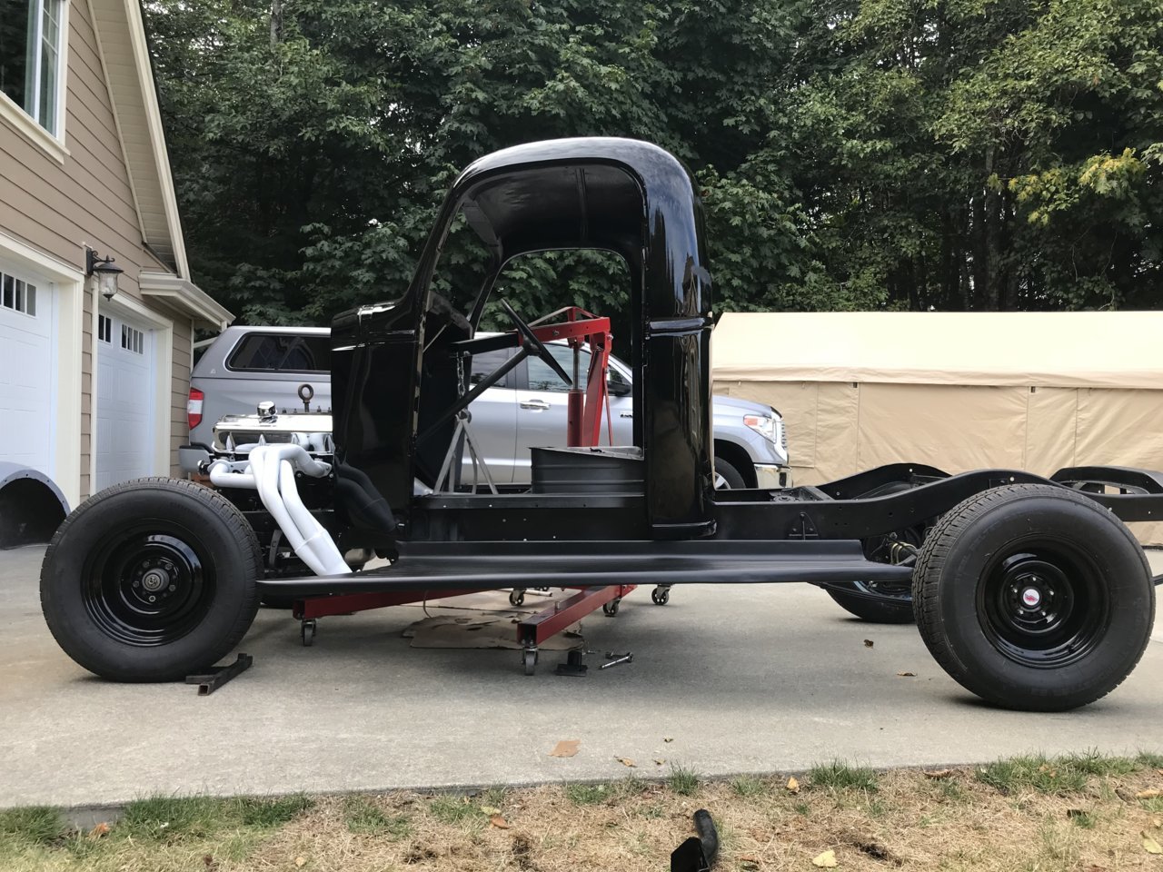

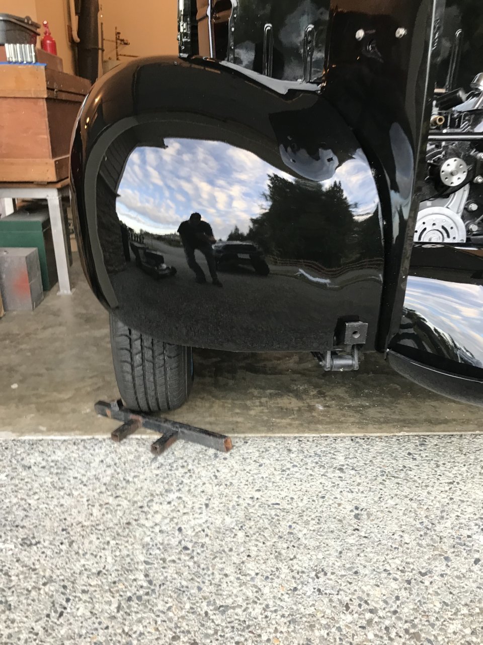

  9. Sep 13, 2021 at 4:26 PM
    #69
    32vsnake
    Oct 8, 2013
    #114132
    380
    Mill Bay BC

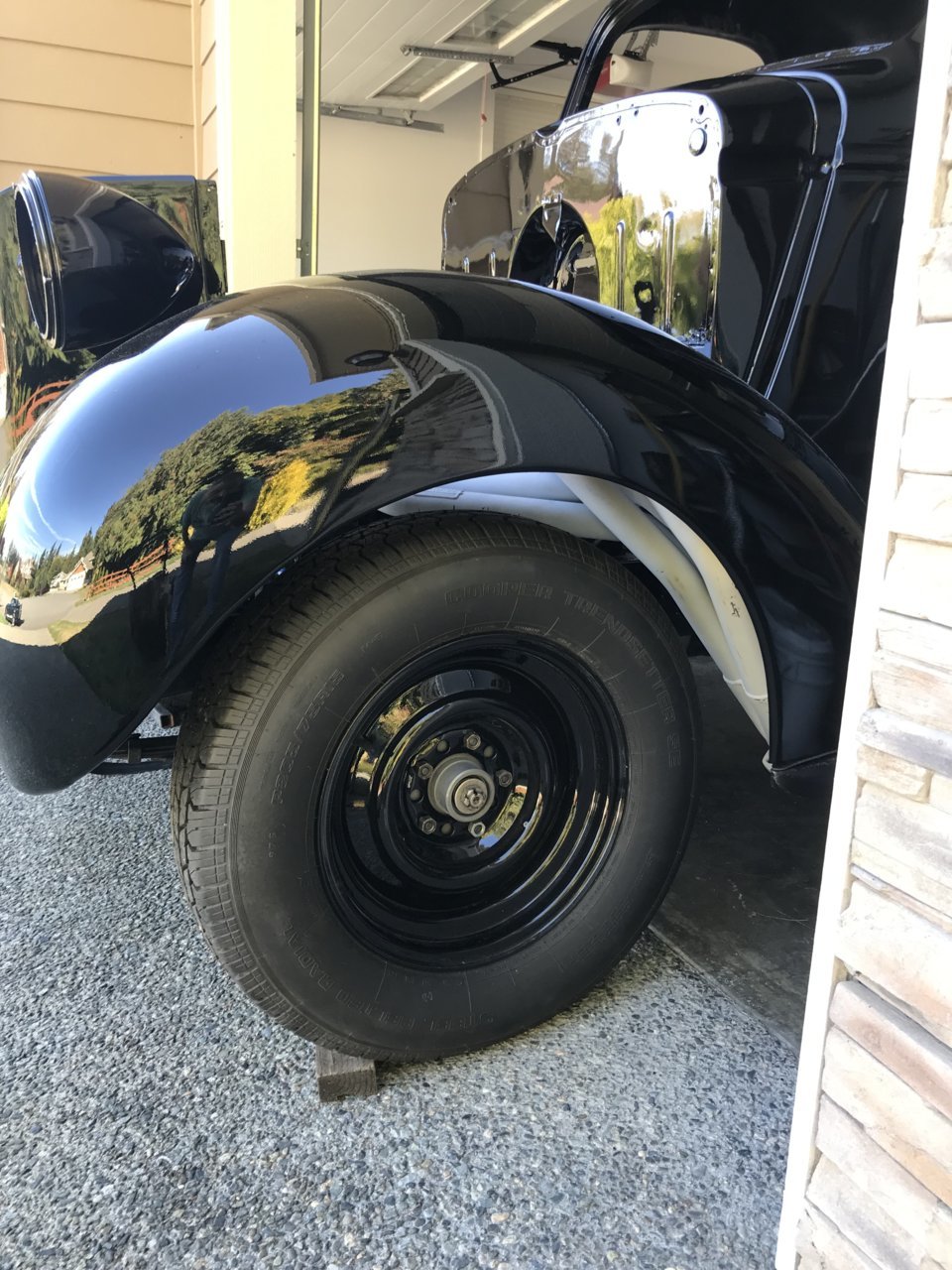

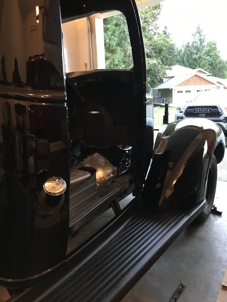

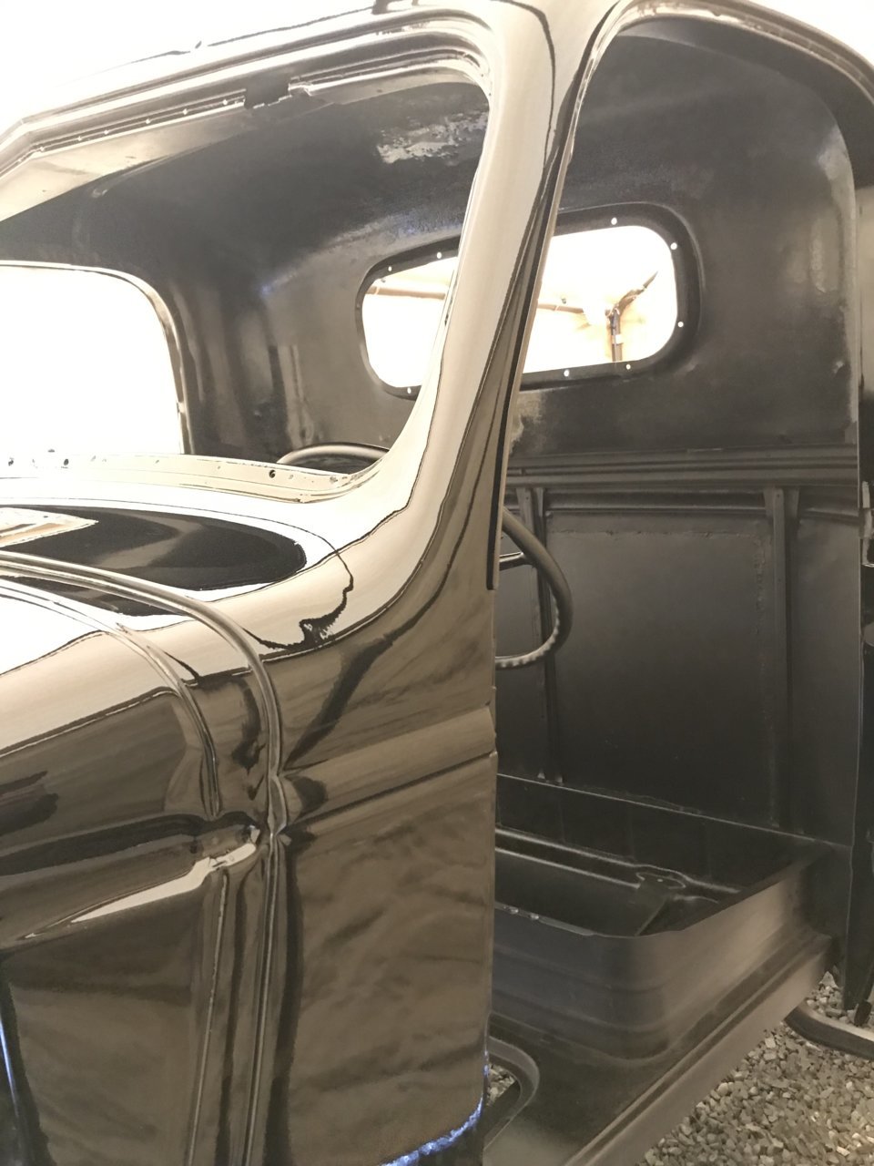

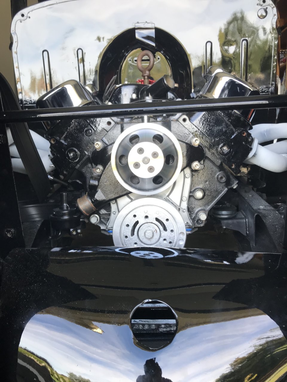

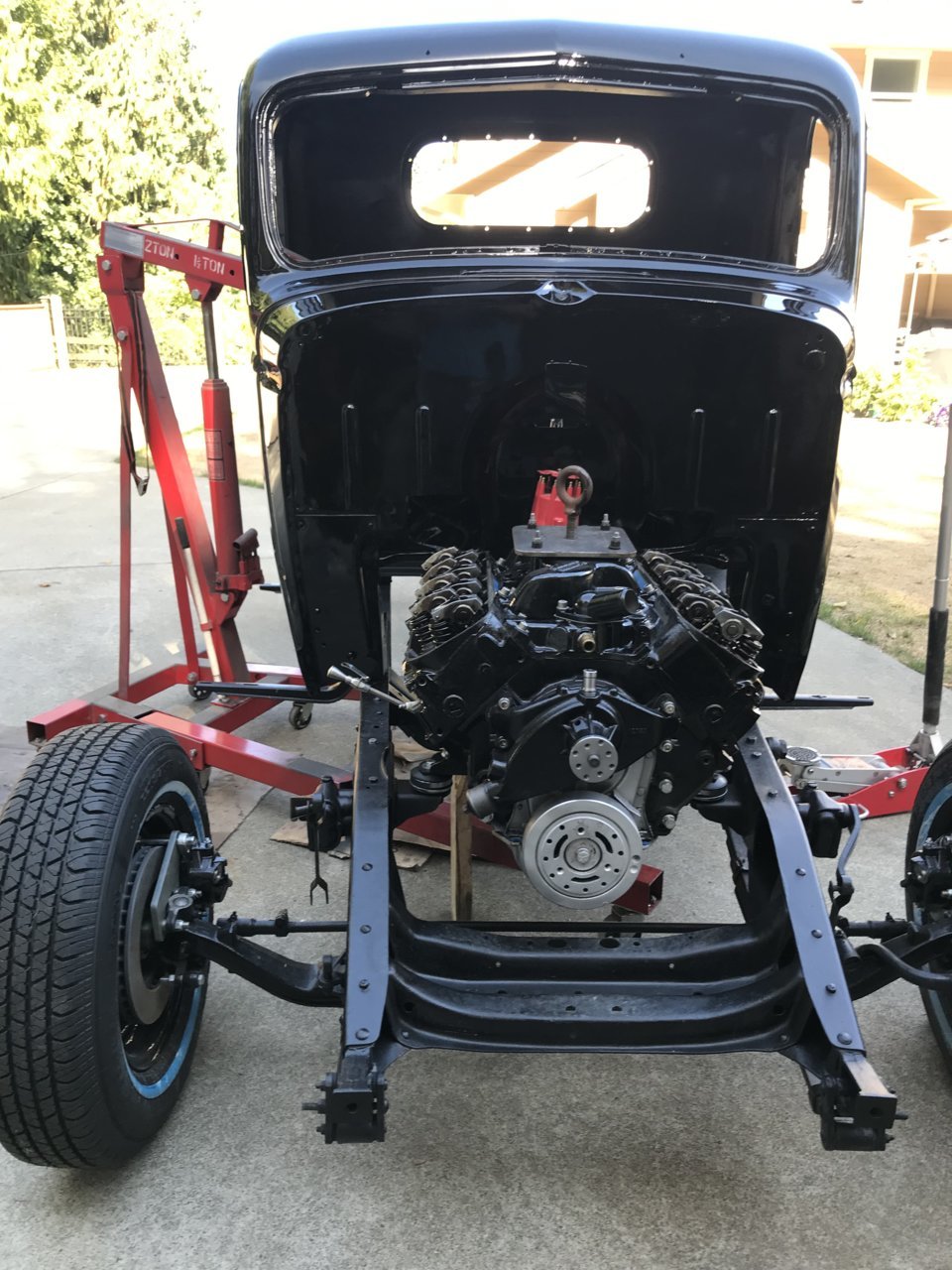

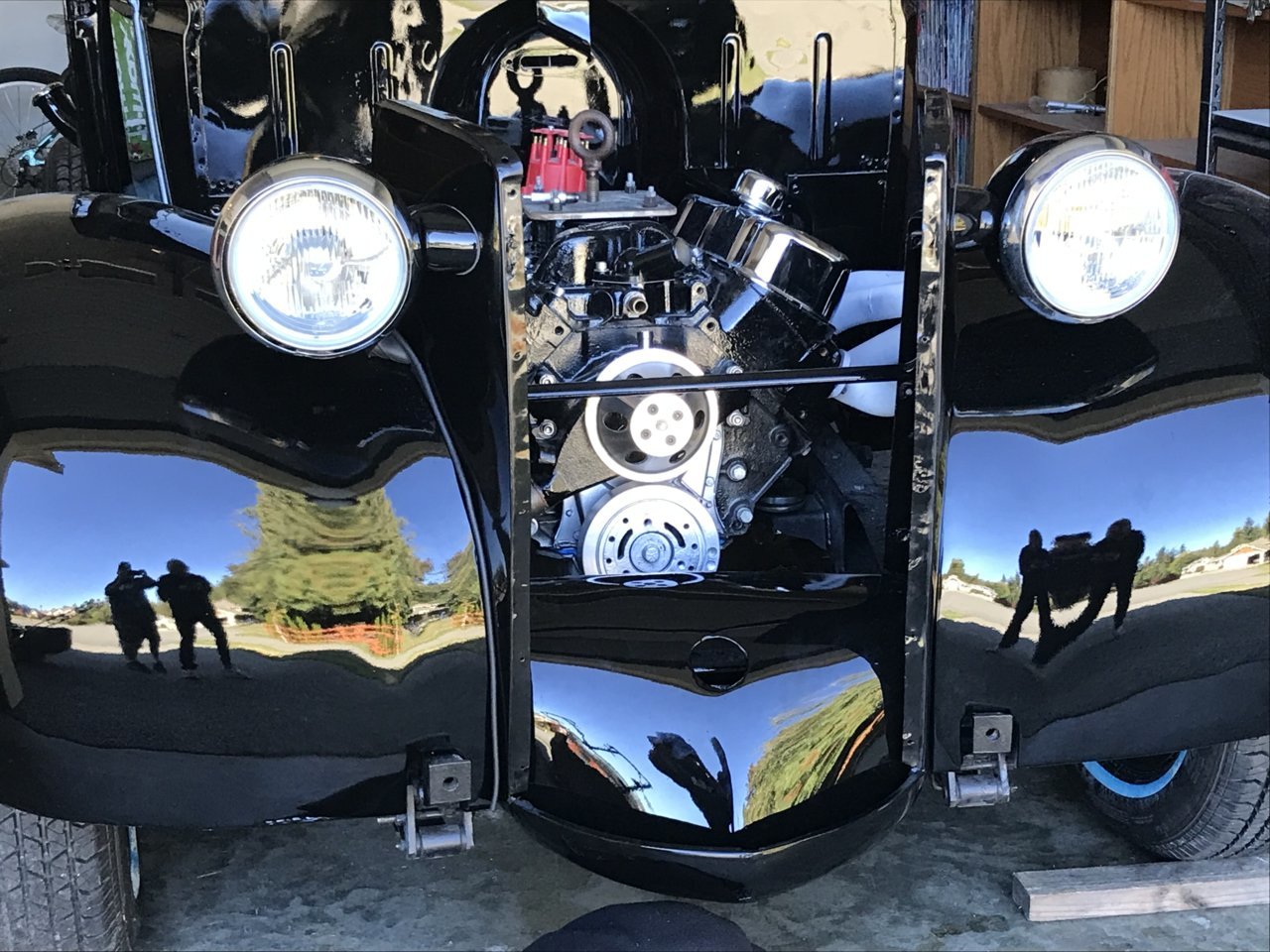

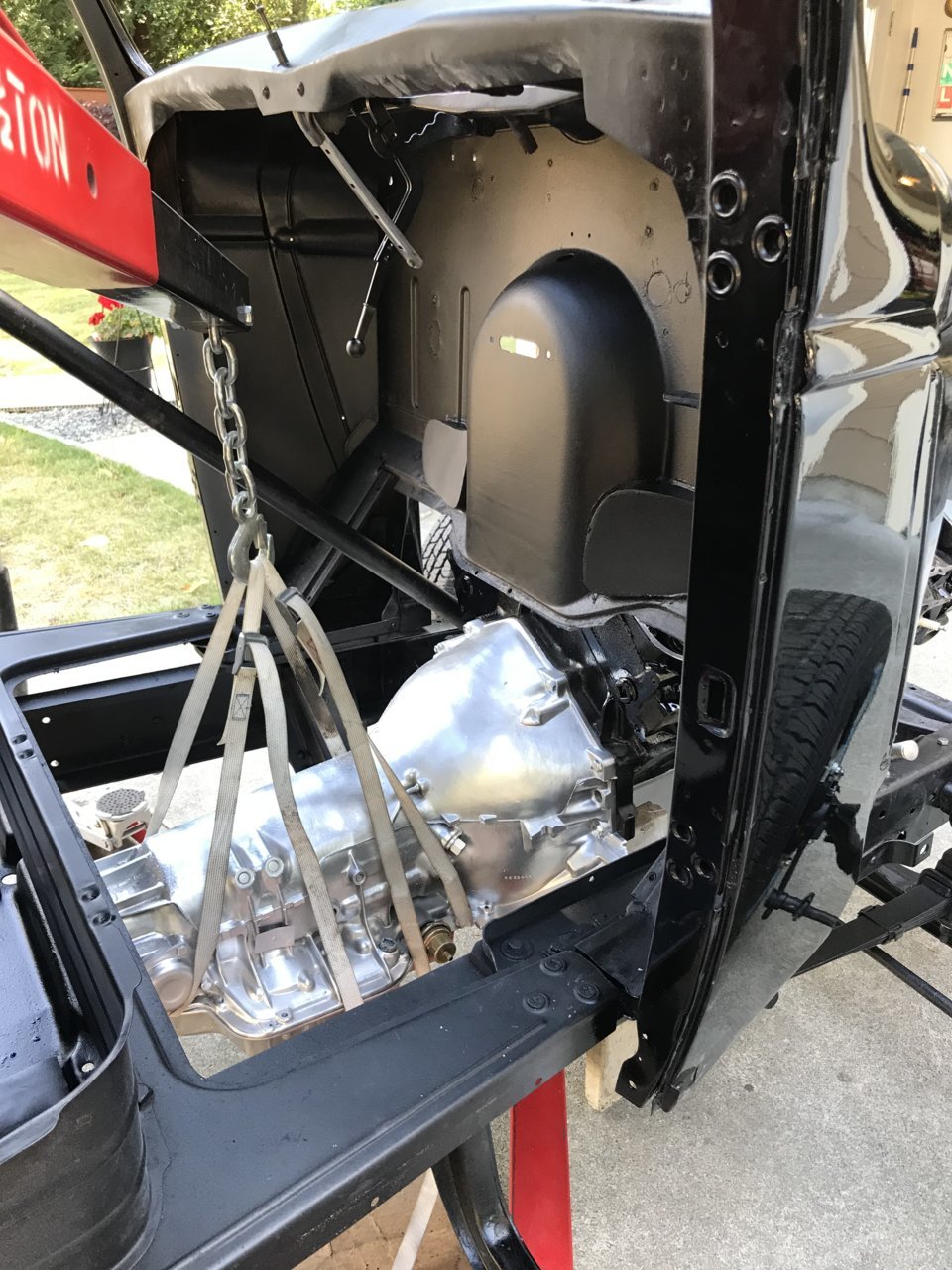

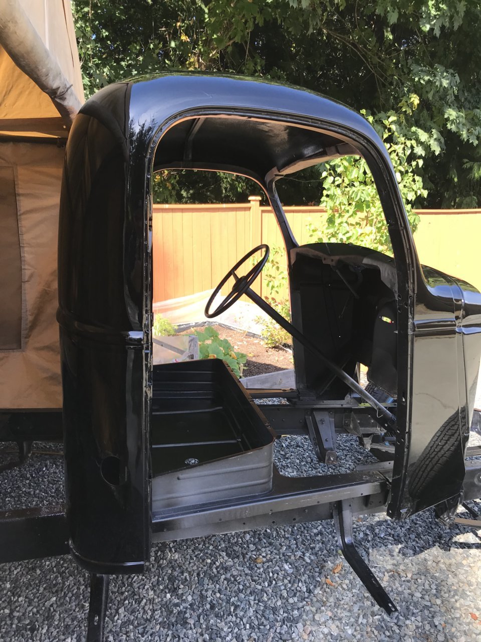

    took the afternoon off of work and got a fair bit done today.
    Warning... it's going to be a bit of a photo bomb since I'm thinking the truck is turning out to be a pretty cool piece

  10. Sep 13, 2021 at 4:29 PM
    #70
    32vsnake
    Oct 8, 2013
    #114132
    380
    Mill Bay BC

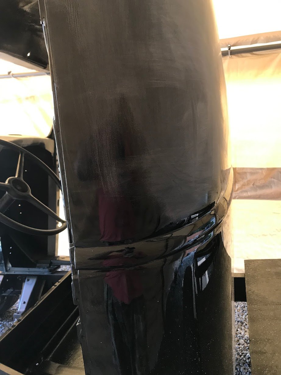

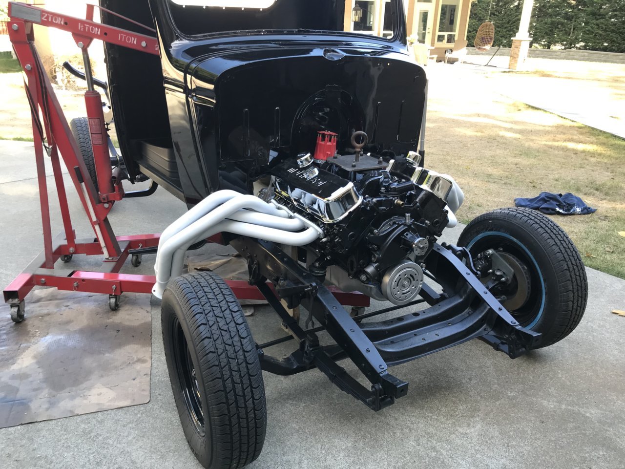

    Continued
    wilcam47, BassAckwards and tirediron like this.
  11. Sep 13, 2021 at 4:30 PM
    #71
    32vsnake
    Oct 8, 2013
    #114132
    380
    Mill Bay BC
  12. Sep 13, 2021 at 4:35 PM

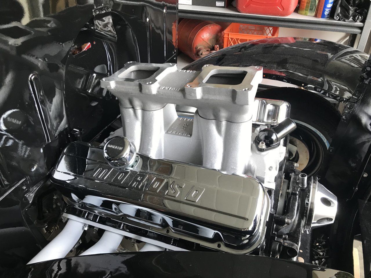

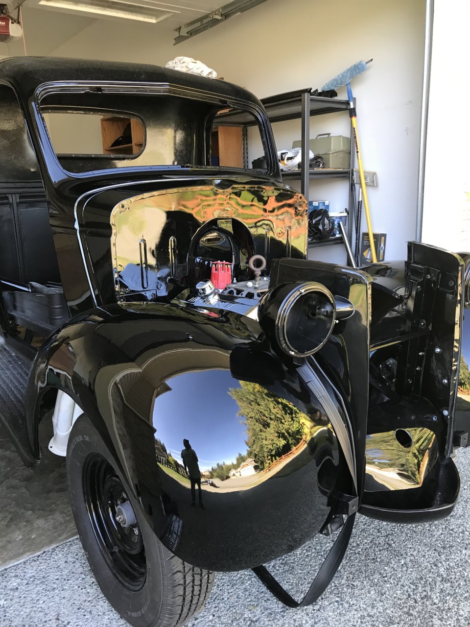

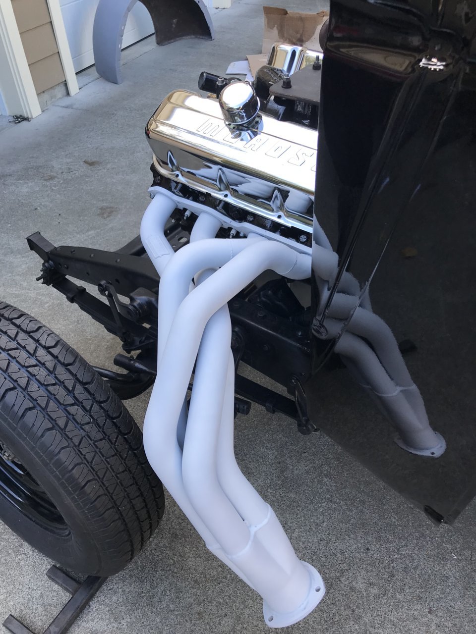

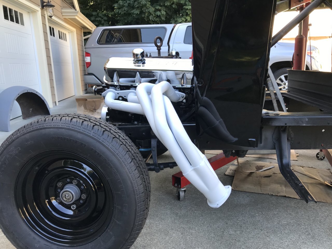

    Are the headers something like Jet Hot coated or painted with header paint?
    Really enjoying the pics!
  13. Sep 13, 2021 at 4:41 PM
    #73
    32vsnake
    Oct 8, 2013
    #114132
    380
    Mill Bay BC
    VHT header paint...

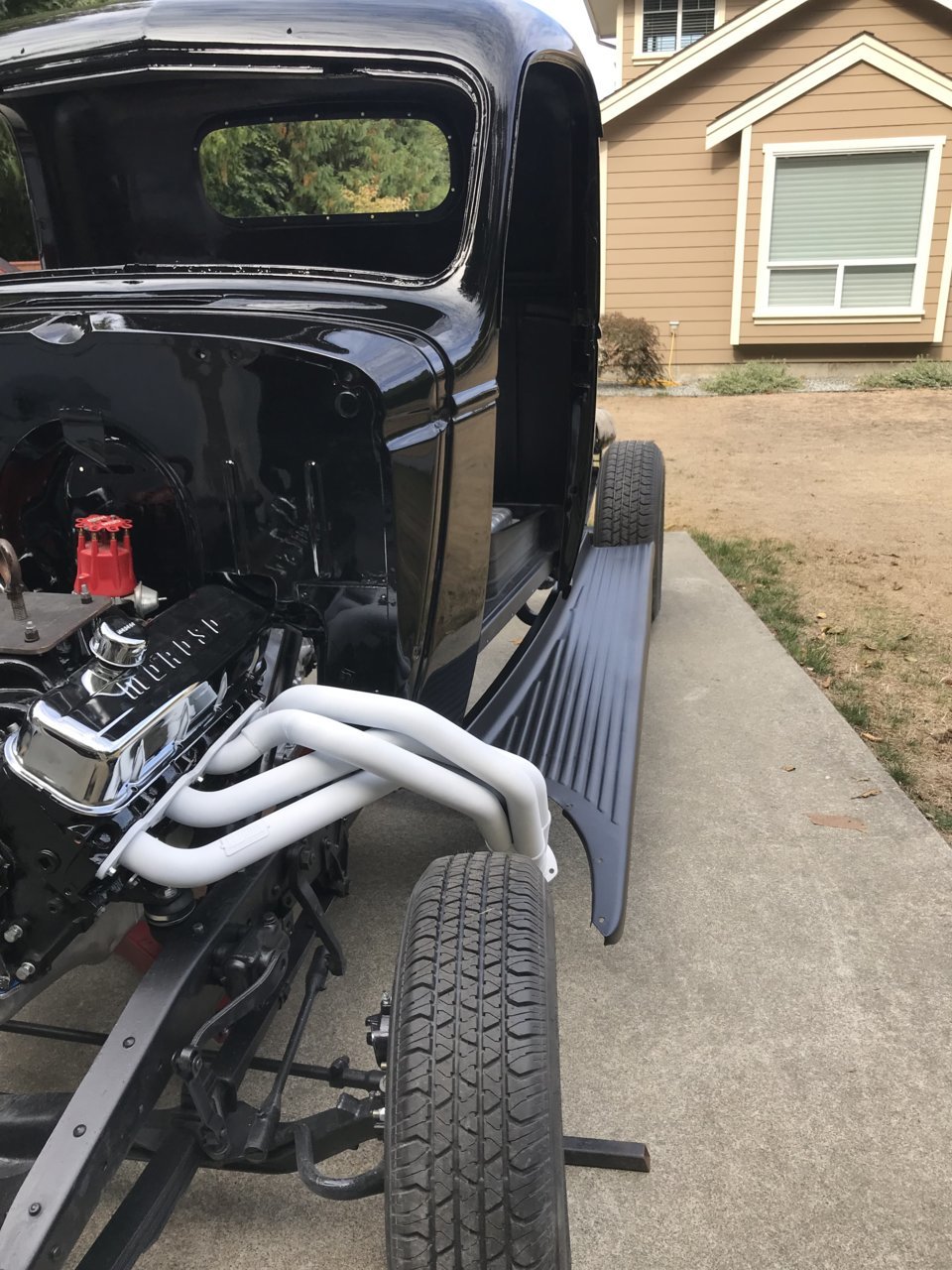

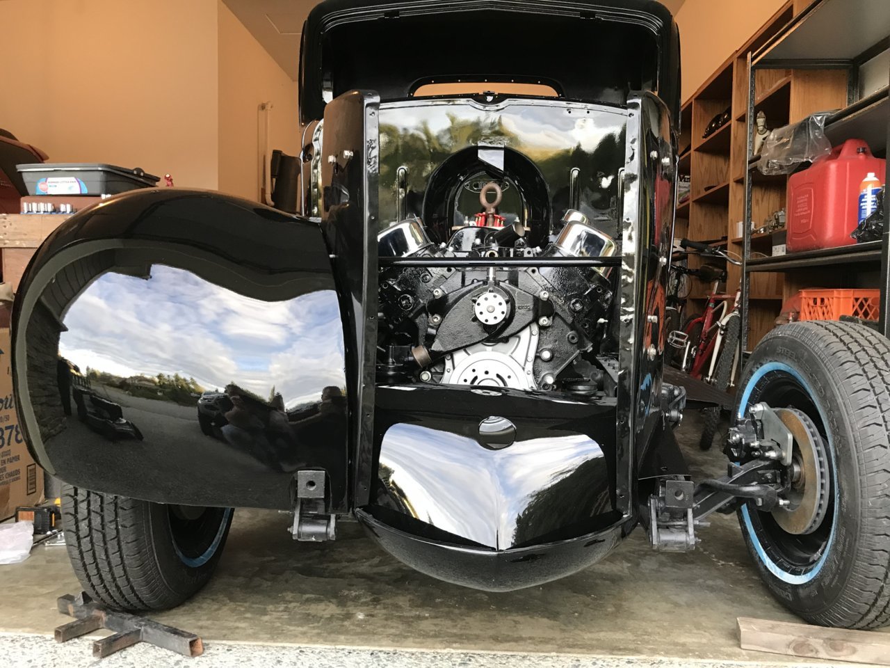

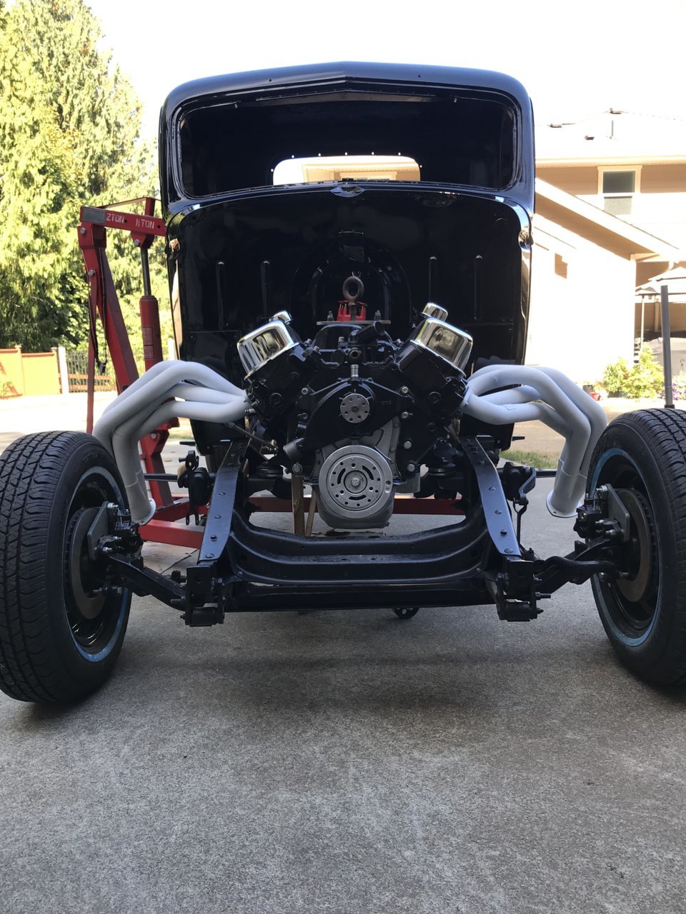

  14. Sep 20, 2021 at 9:02 PM
    #74
    32vsnake
    Oct 8, 2013
    #114132
    380
    Mill Bay BC

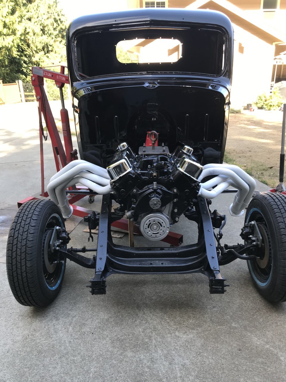

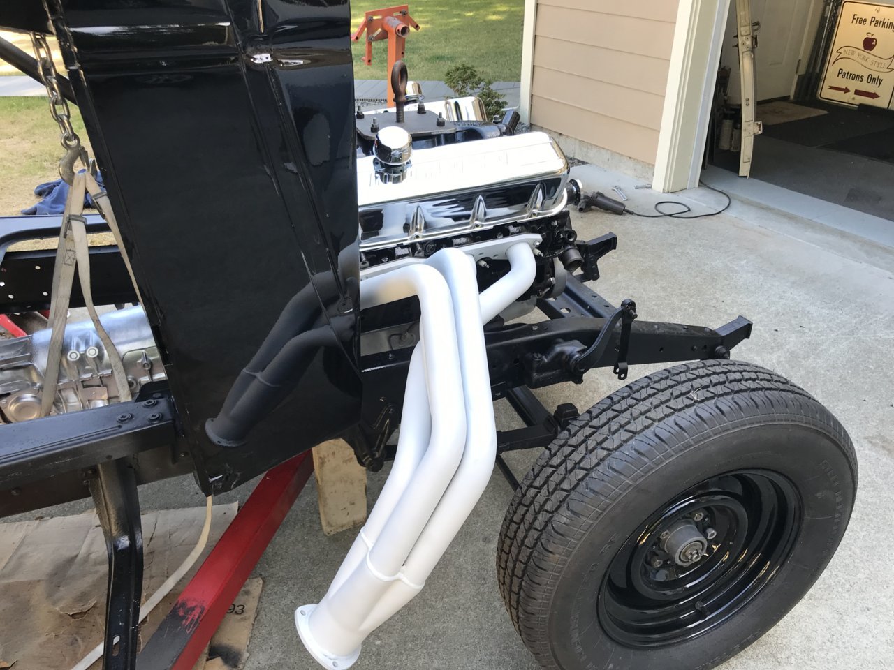

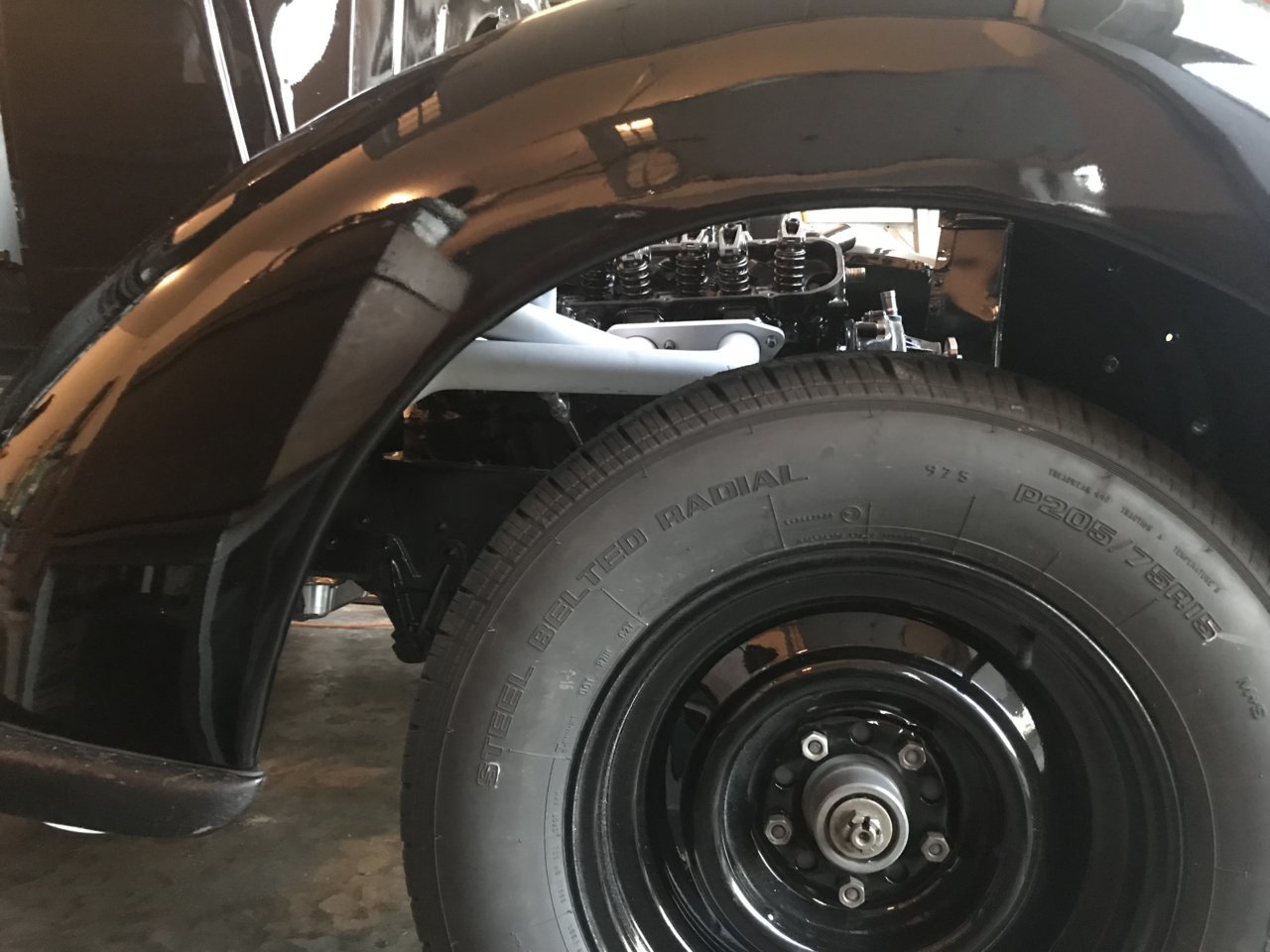

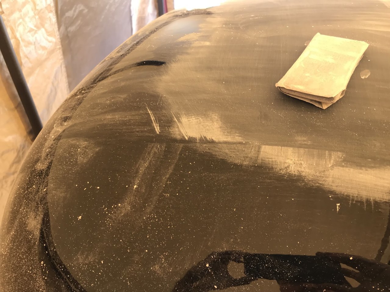

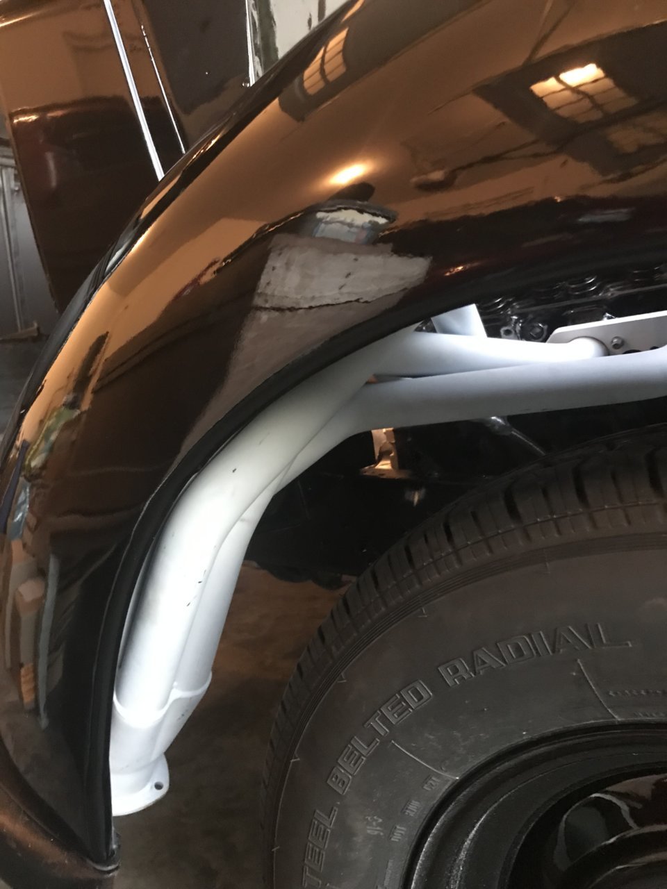

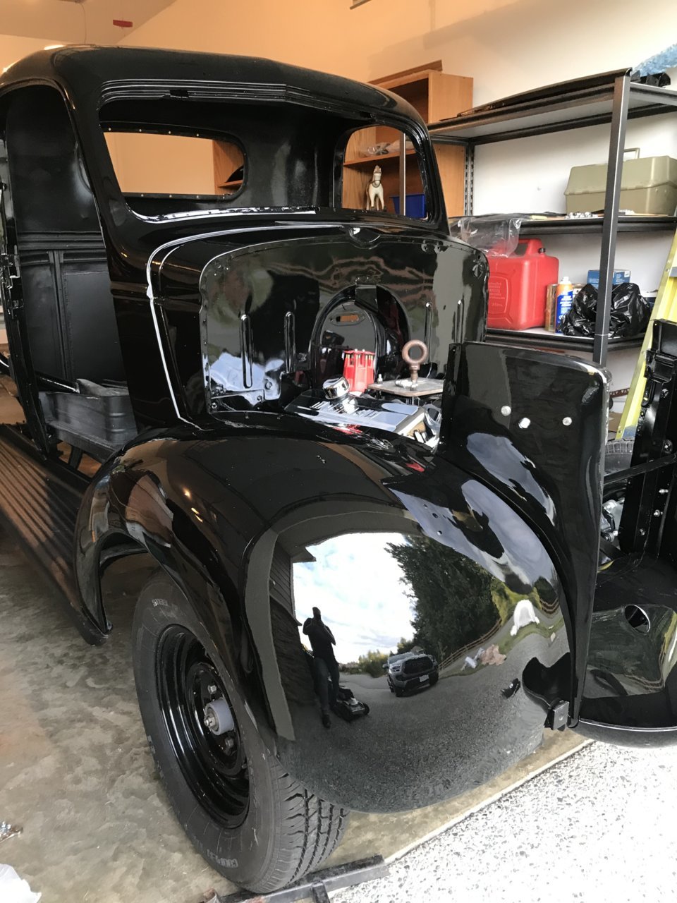

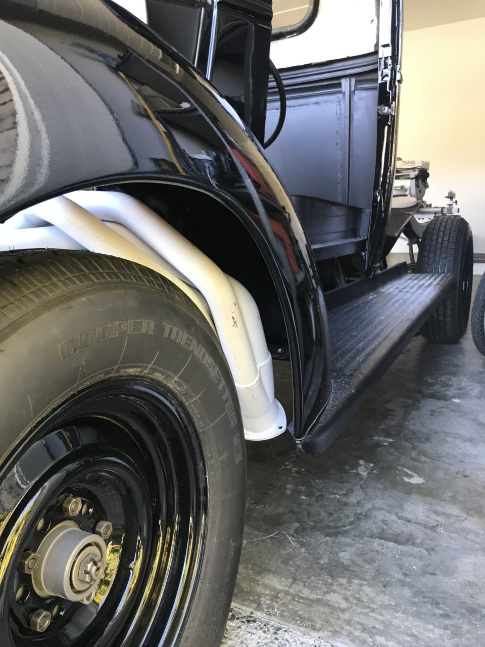

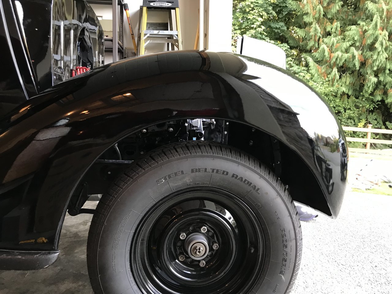

    So not much progress.... got the truck moved into the front garage, followed by some color sanding on the cab... then mounted the rad shell and trial fit the fenders. Looks like I might have a fitment issue with the headers..

  16. Sep 23, 2021 at 9:18 PM
    #76
    32vsnake
    Oct 8, 2013
    #114132
    380
    Mill Bay BC

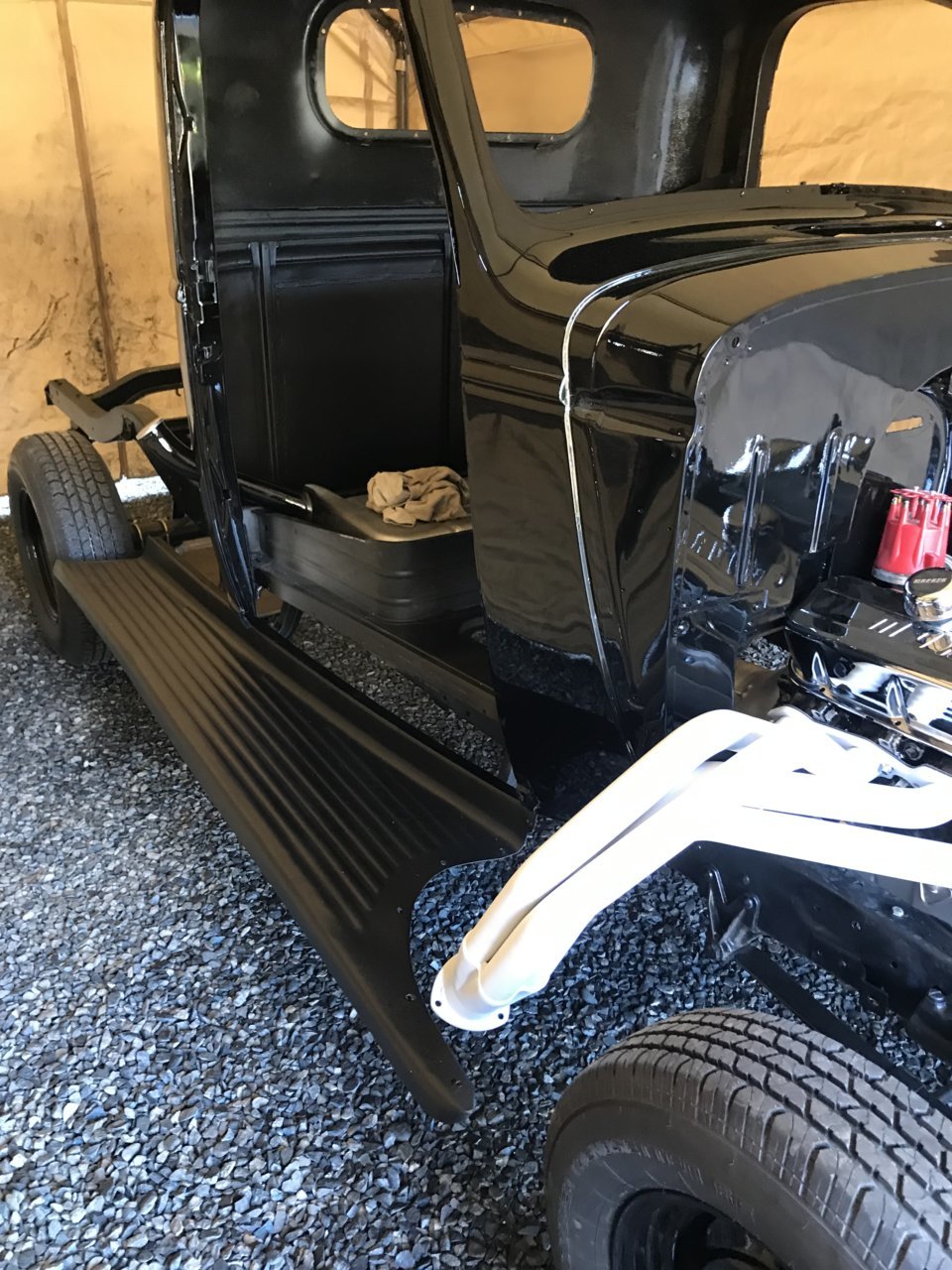

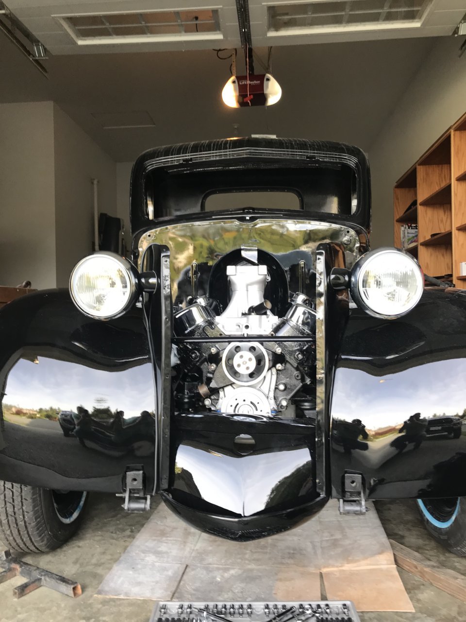

    Minor update...more color sanding done on the cab and trial fit the headers with the fenders on. Going to have to slightly clearance the inner fender lip.

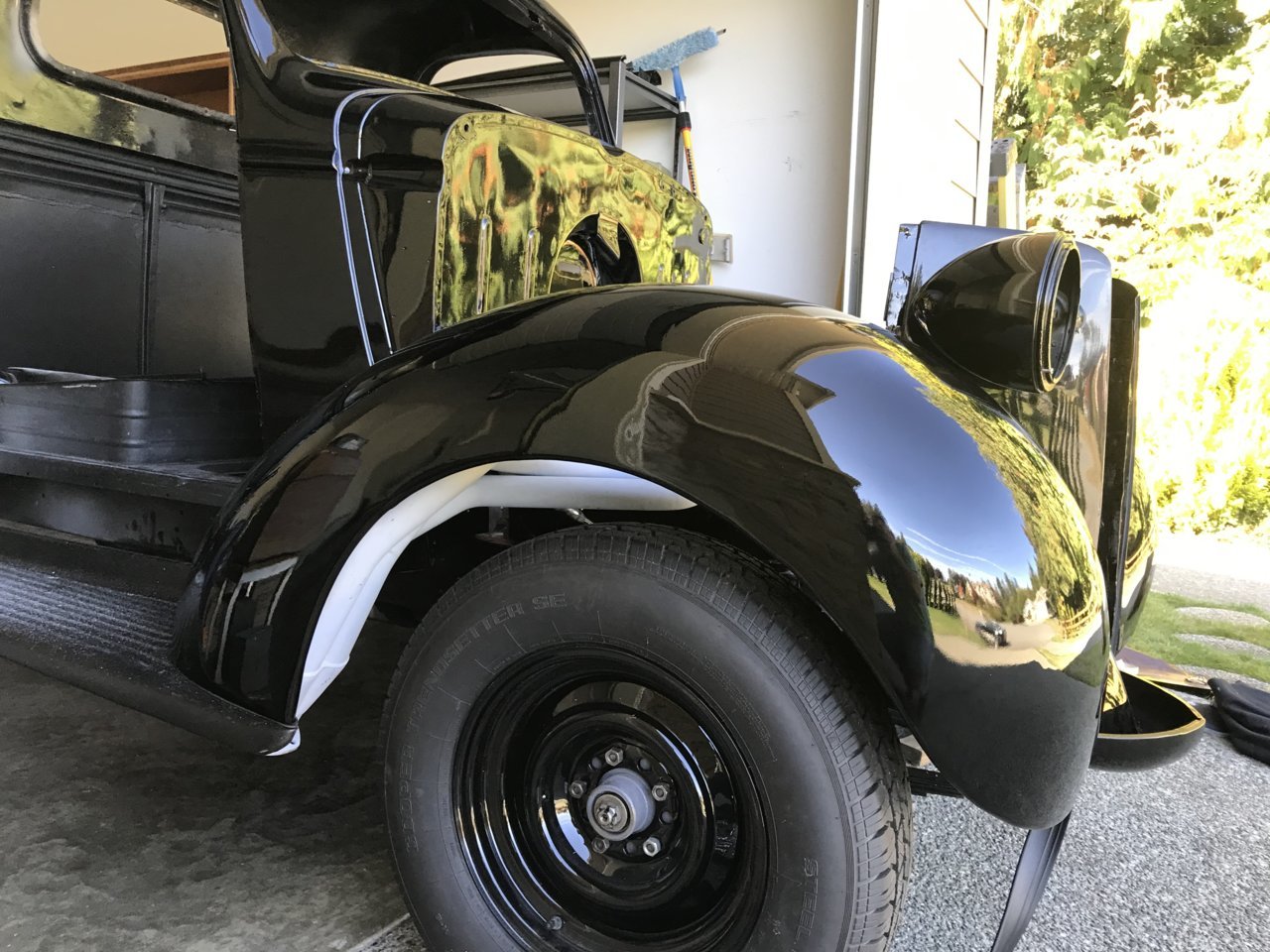

  17. Sep 24, 2021 at 6:56 PM
    #77
    32vsnake
    Oct 8, 2013
    #114132
    380
    Mill Bay BC

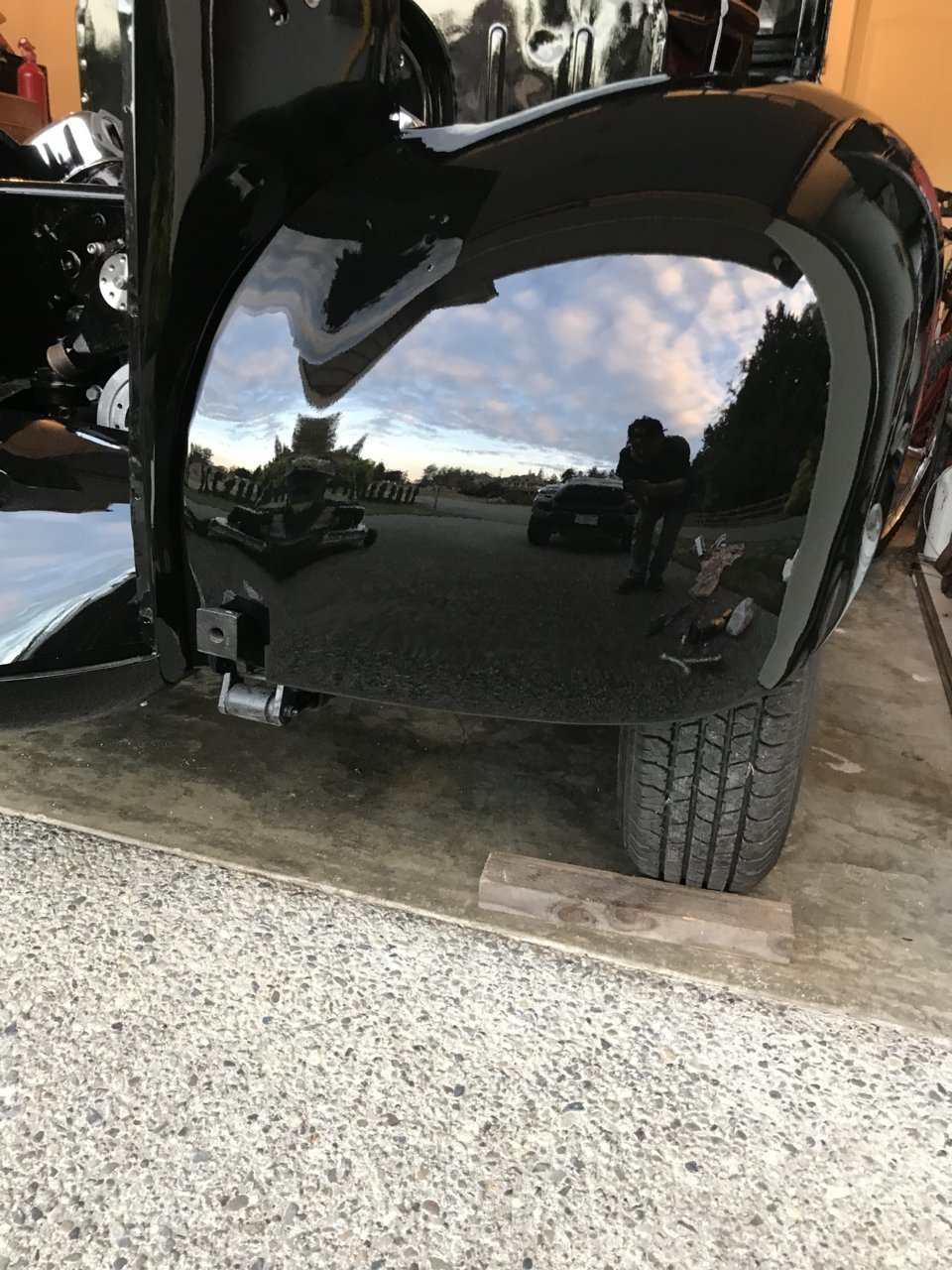

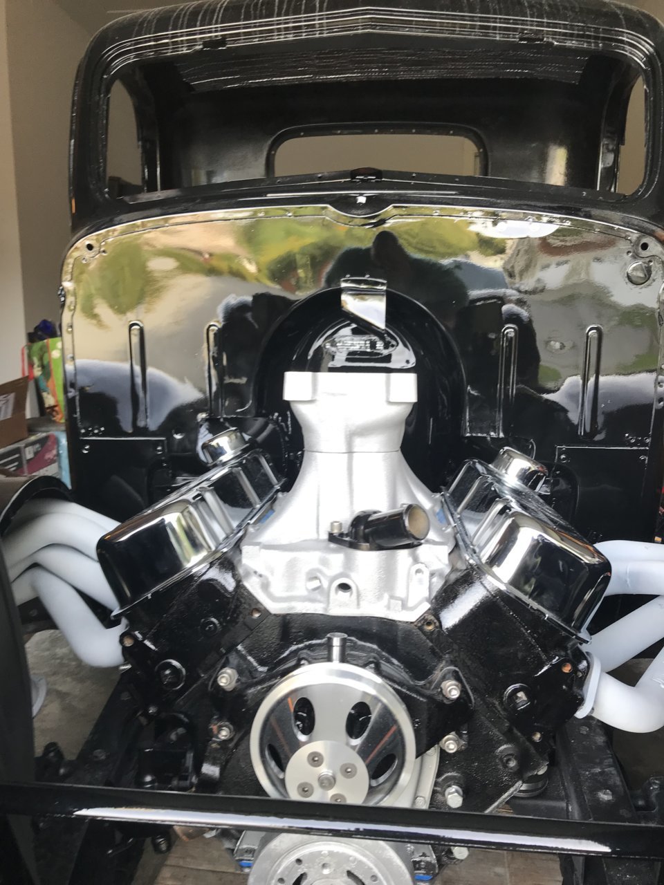

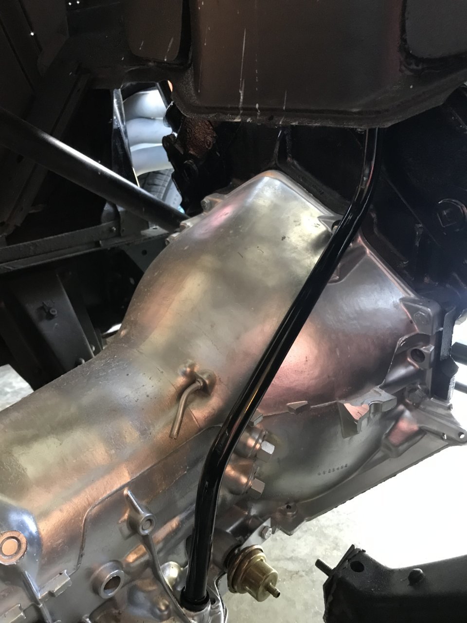

    Got the other header on, moroso tranny dipstick installed, water pump pulley and mounted the headlight brackets/buckets. So the process continues...temporarily bolt stuff together and then blow it apart to make it fit

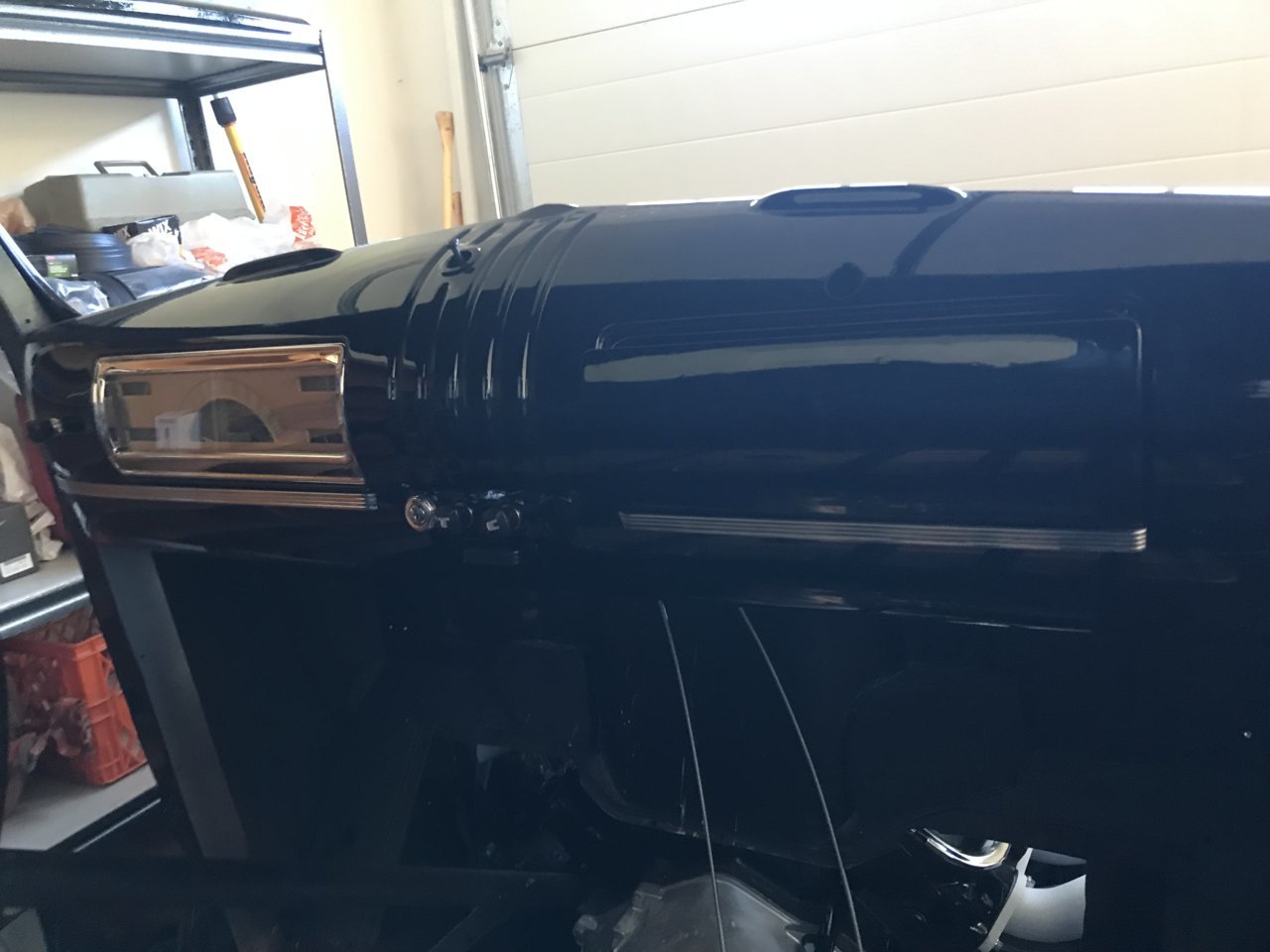

  18. Sep 25, 2021 at 3:42 PM
    #78
    32vsnake
    Oct 8, 2013
    #114132
    380
    Mill Bay BC

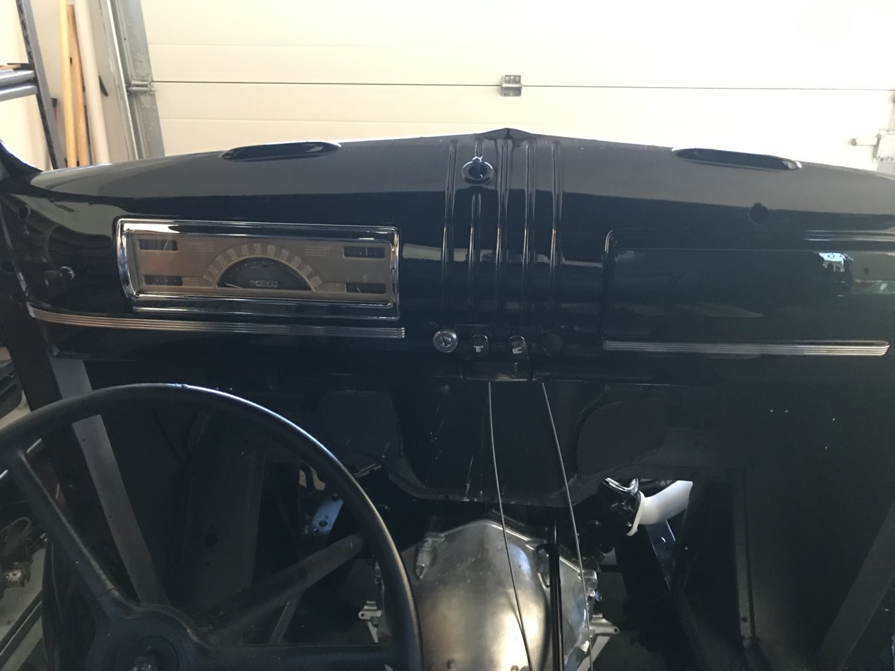

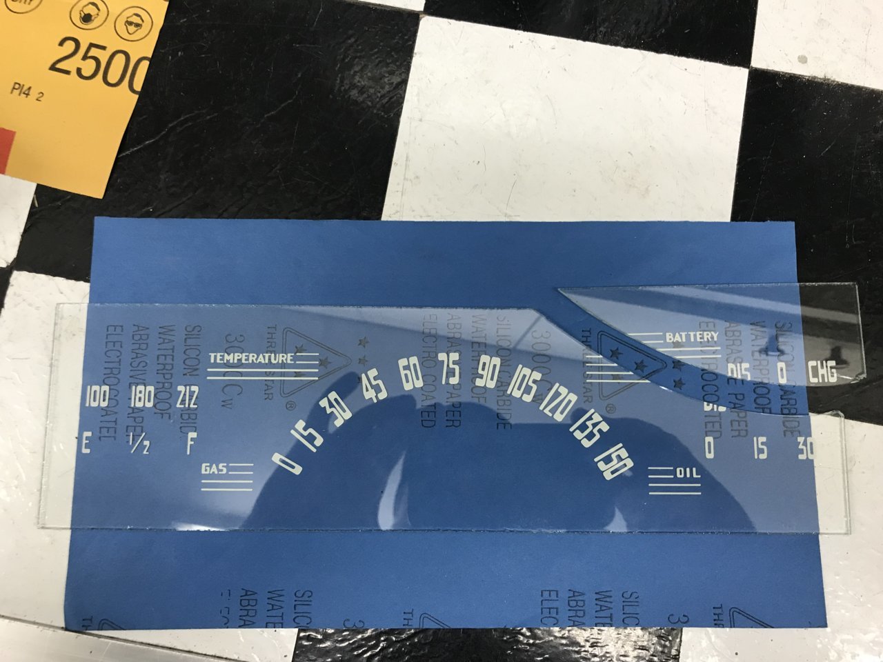

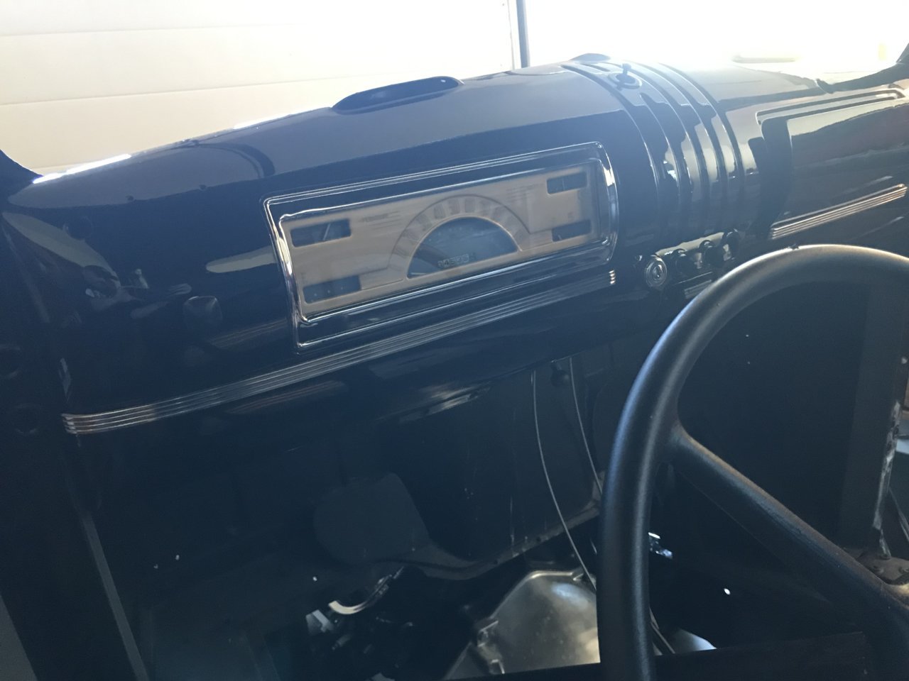

    Got the new H4 headlights and the dash in... of course the new km/h glass for the instrument cluster cracked on me... sigh. back to the faded but original mph glass. Headlight rings are currently chrome and need to be redone, so contemplating painting the rings black.

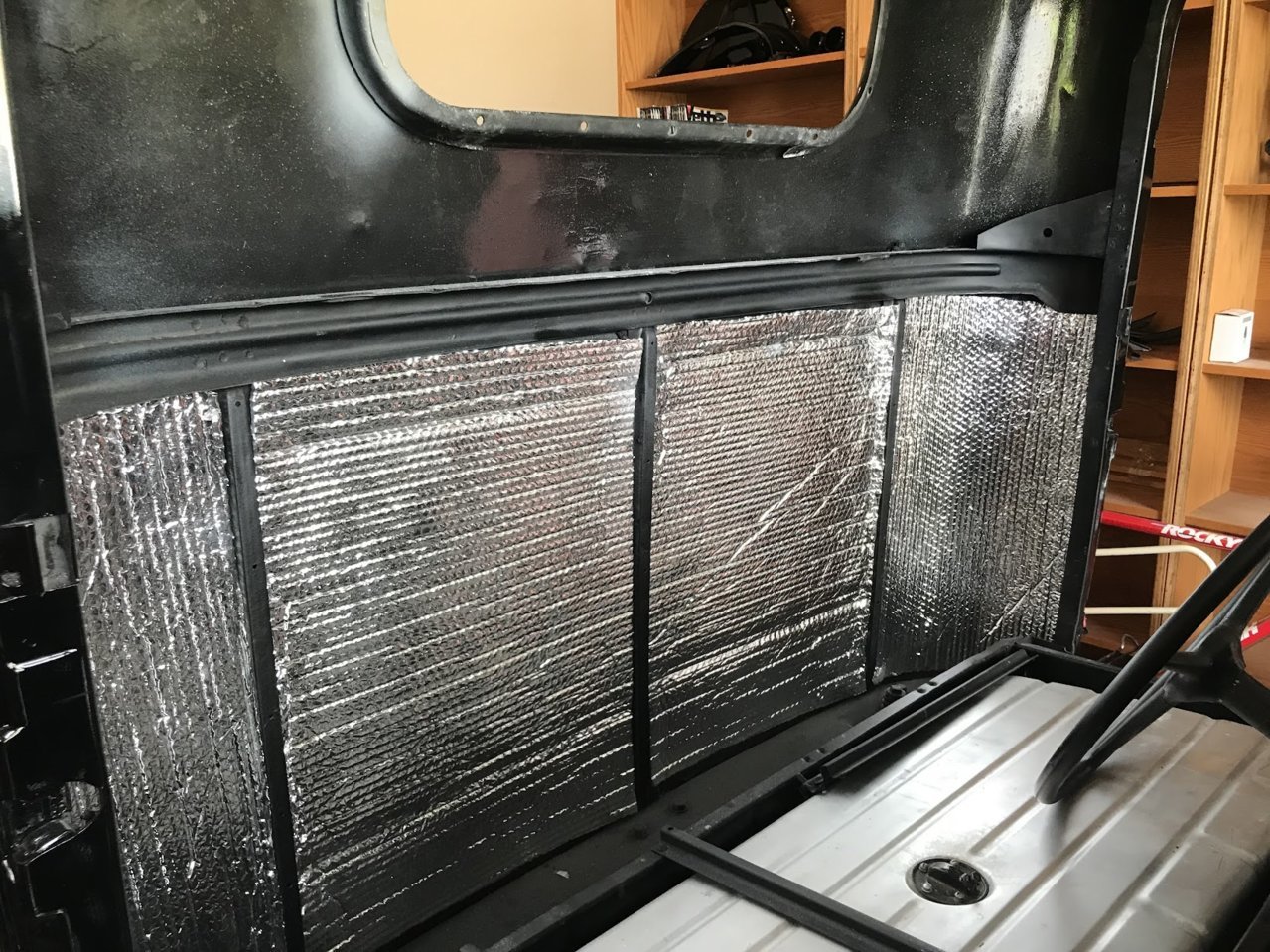

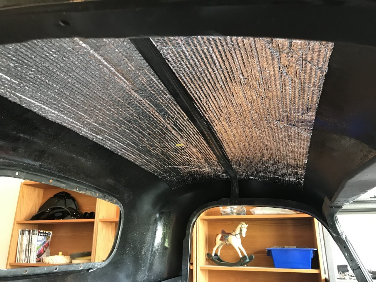

    Getting some minor things done on the truck, not a lot that show progress but it's getting there.

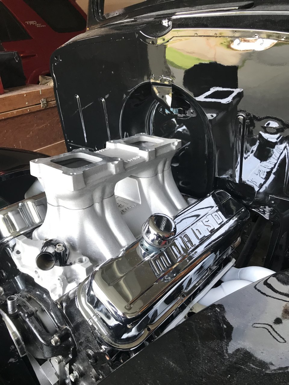

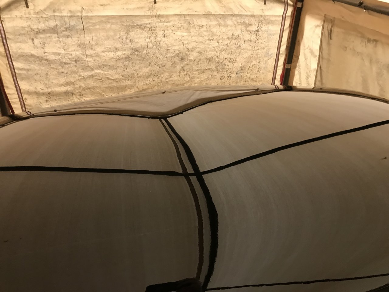

    Wrapped the cab in some insulation and finally got my jewelry that I ordered 2 months ago from summit...eventually cancelled my order and grabbed the last one Jegs had.
