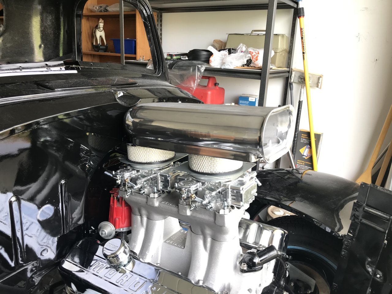

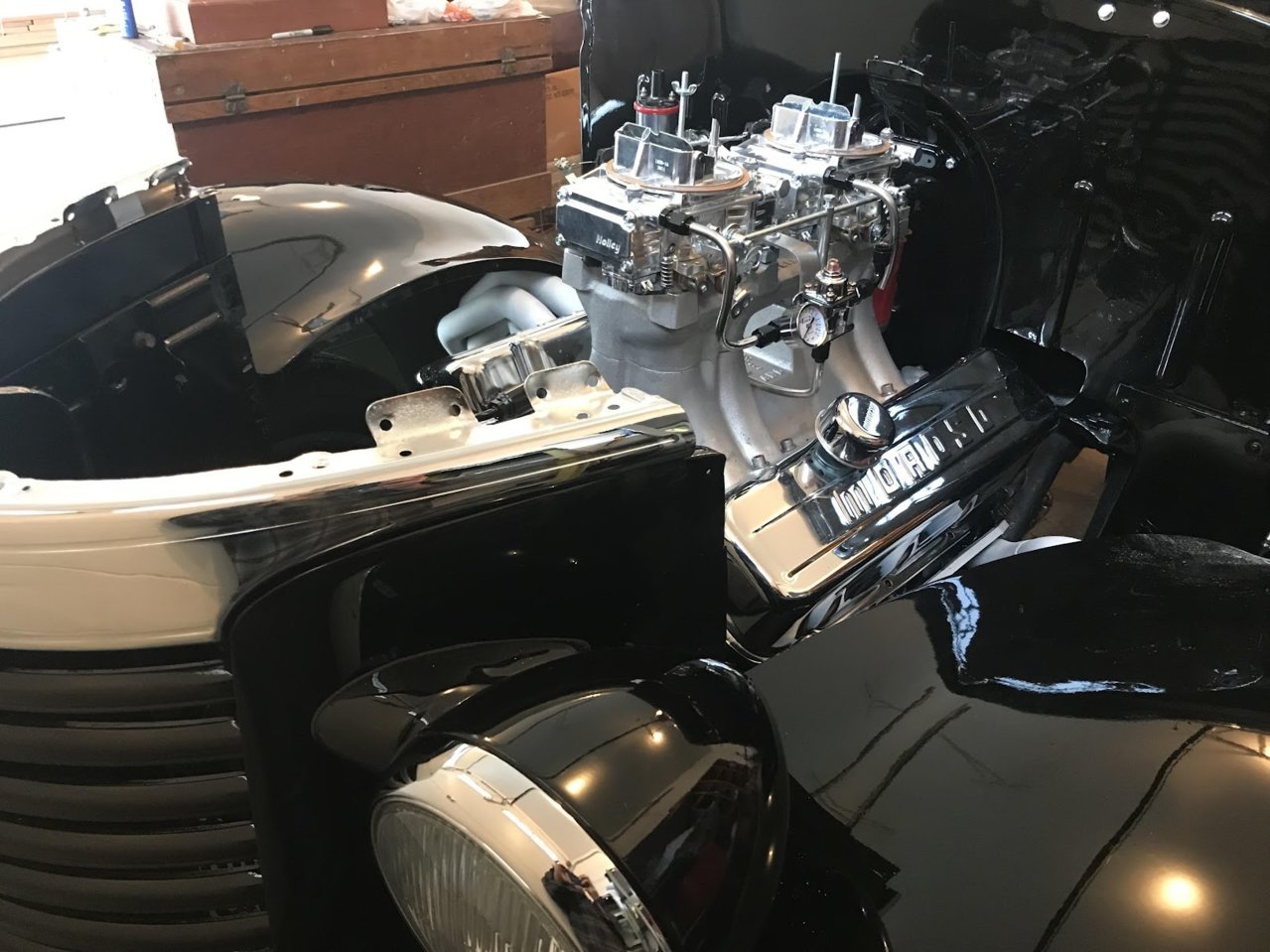

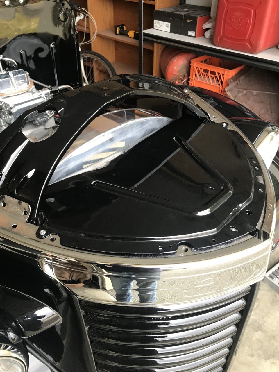

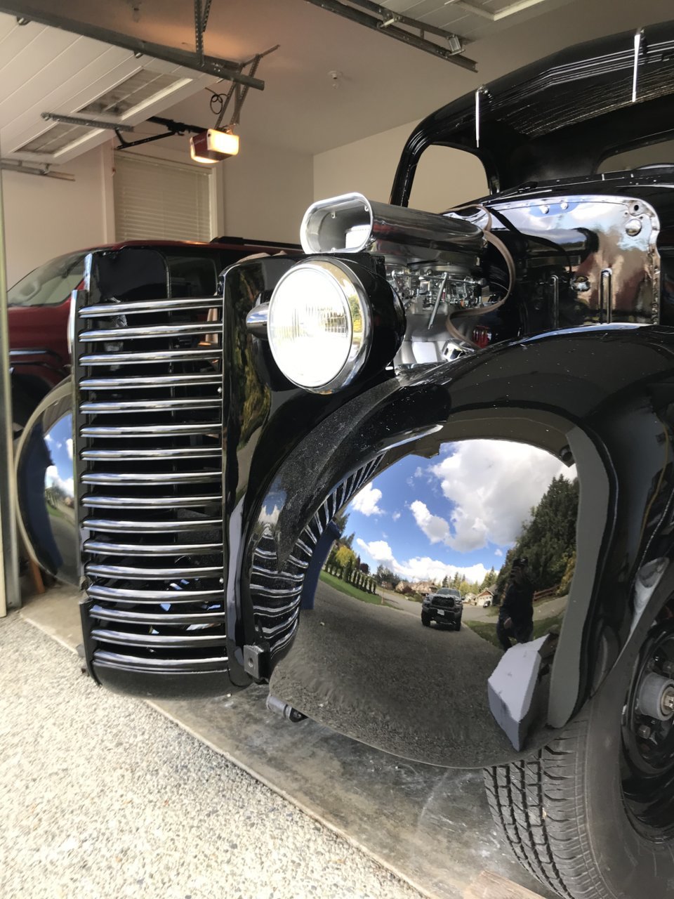

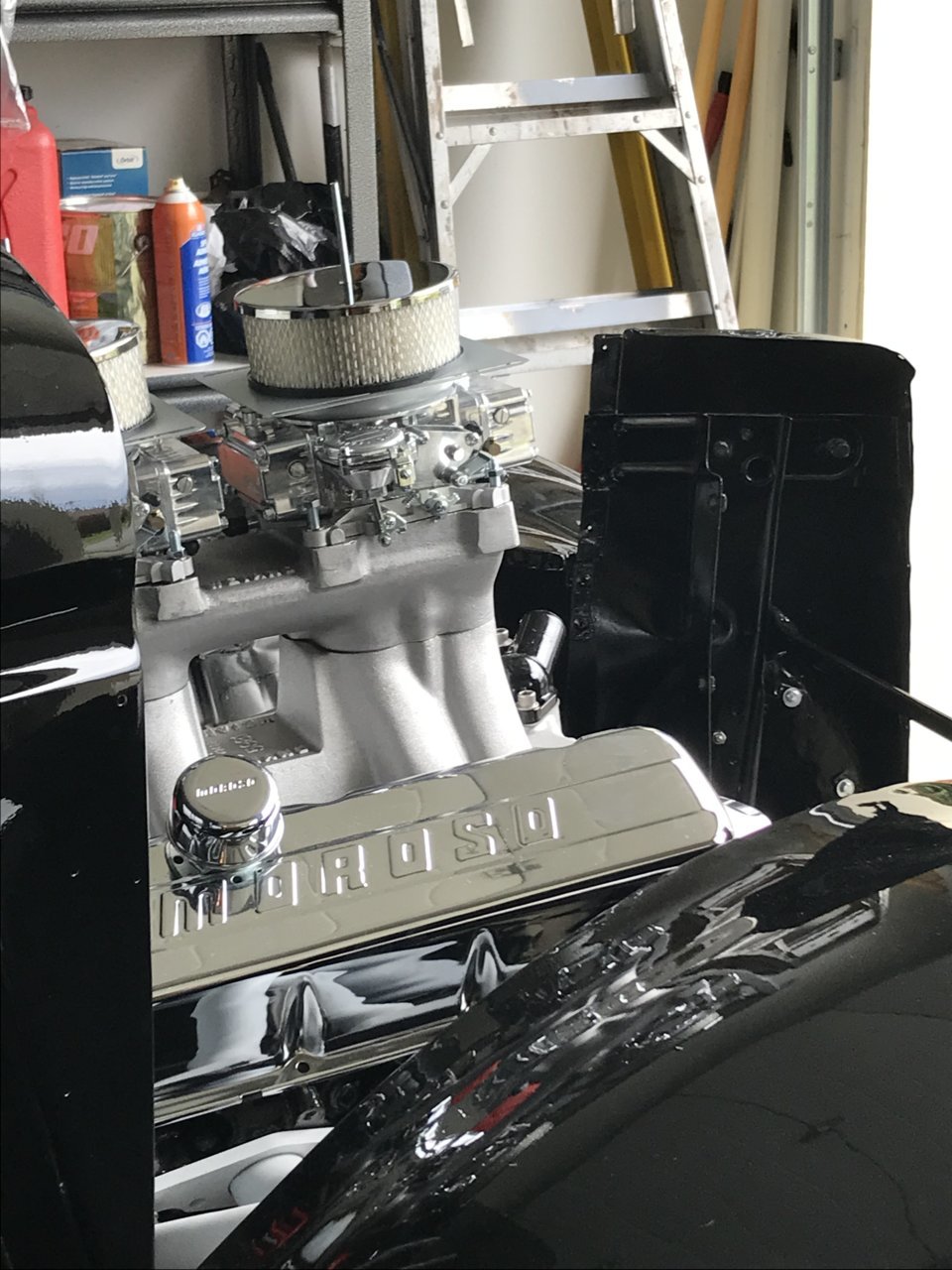

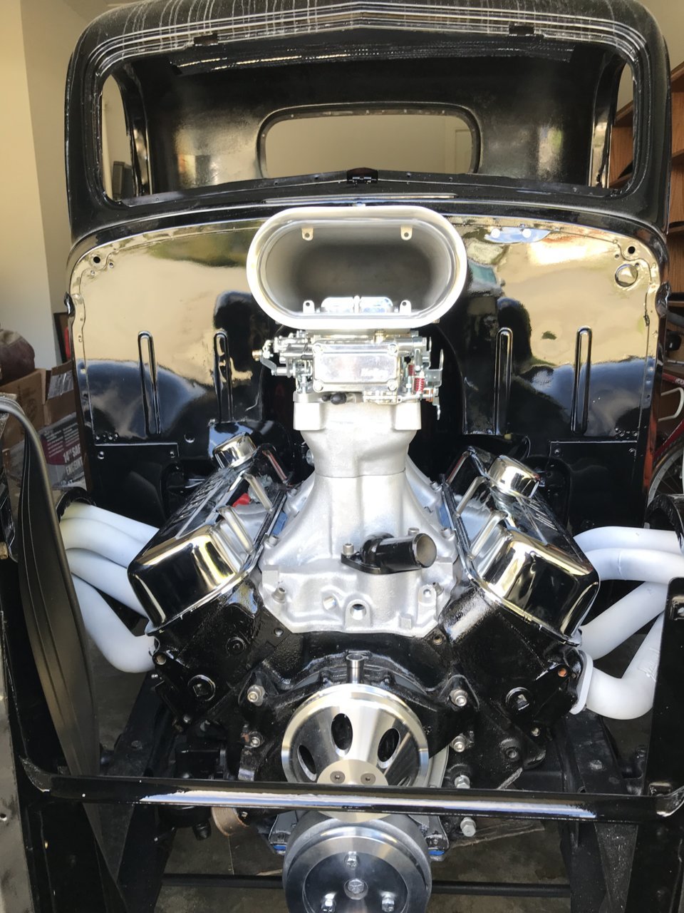

    Summit box showed up today..so some joy followed by slight sorrow. When I estimated measurements for my Hilborn style scoop I was mostly focused on height and I forgot about depth...damn thing won't fit without hacking up the firewall...sigh

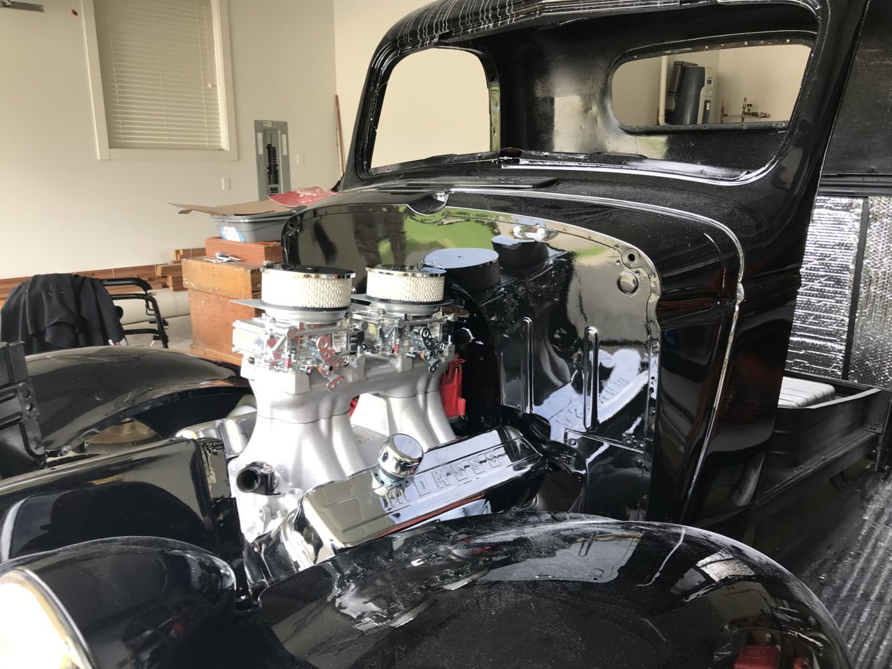

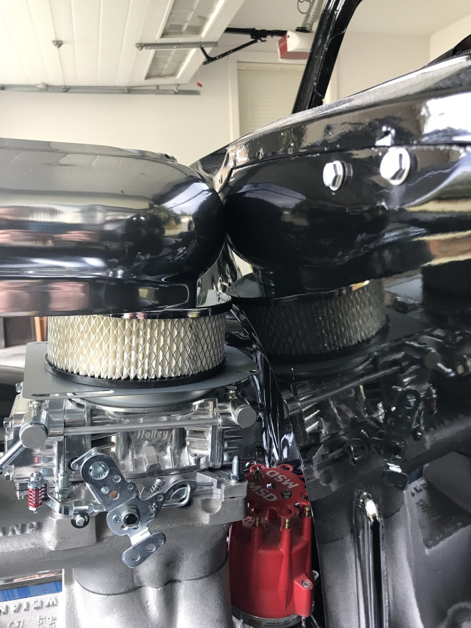

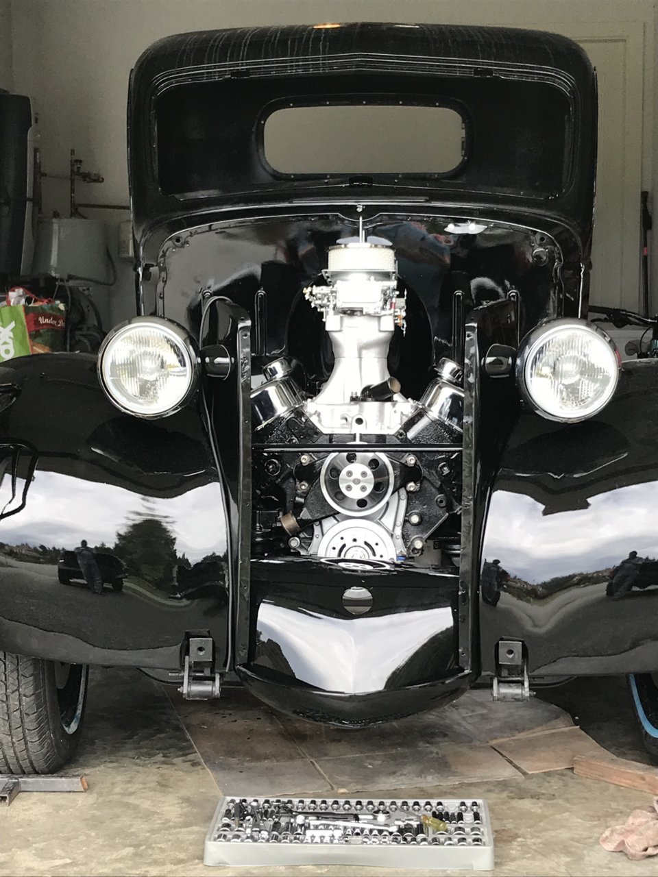

    Couple more fail points and then some interesting and positive developments

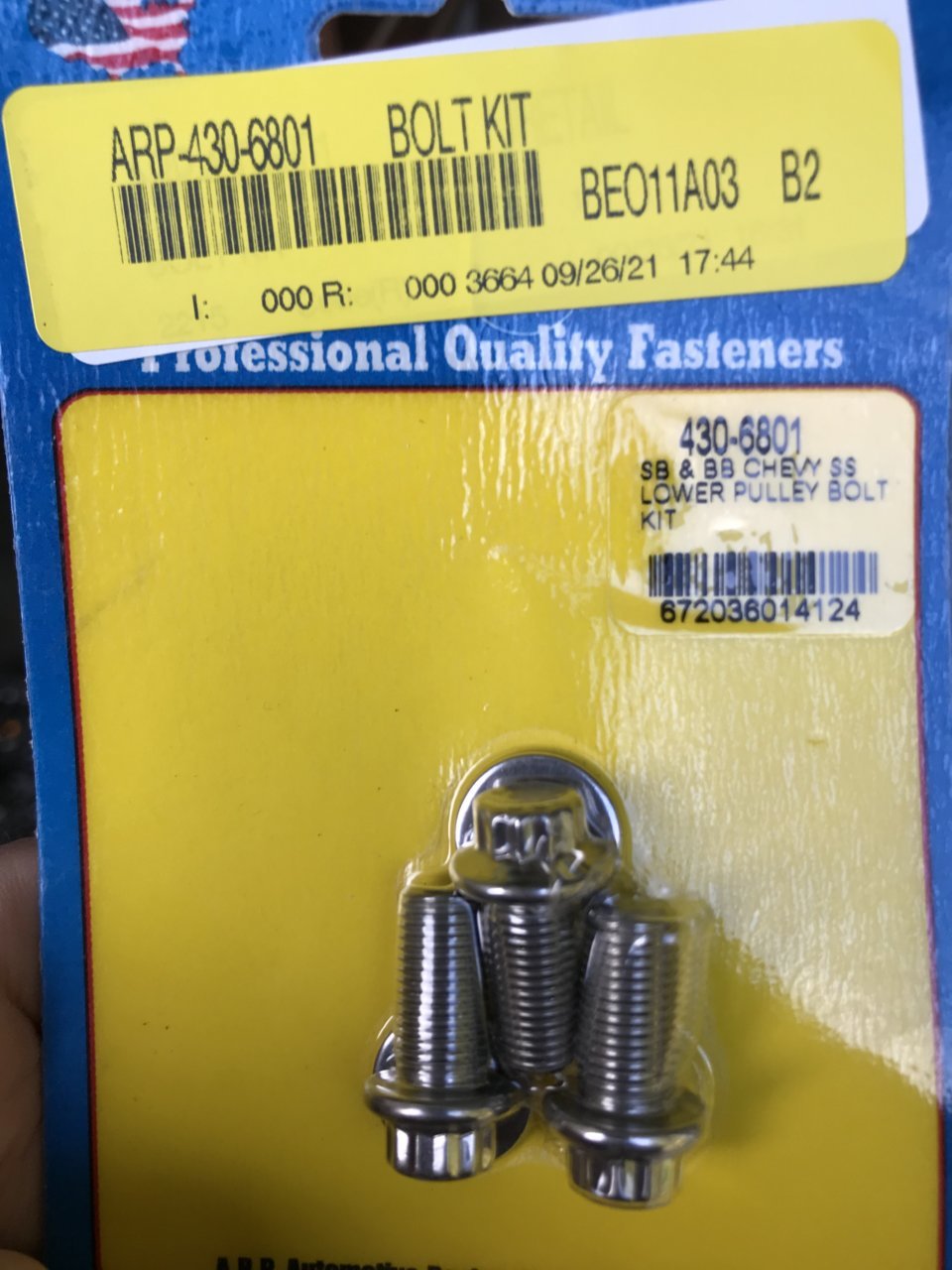

    Rear brake lines designed to fit 68-72 Chevelle...fell a little short. My ARP bolts are fine thread and the balancer on my BBC is course threaded...fail

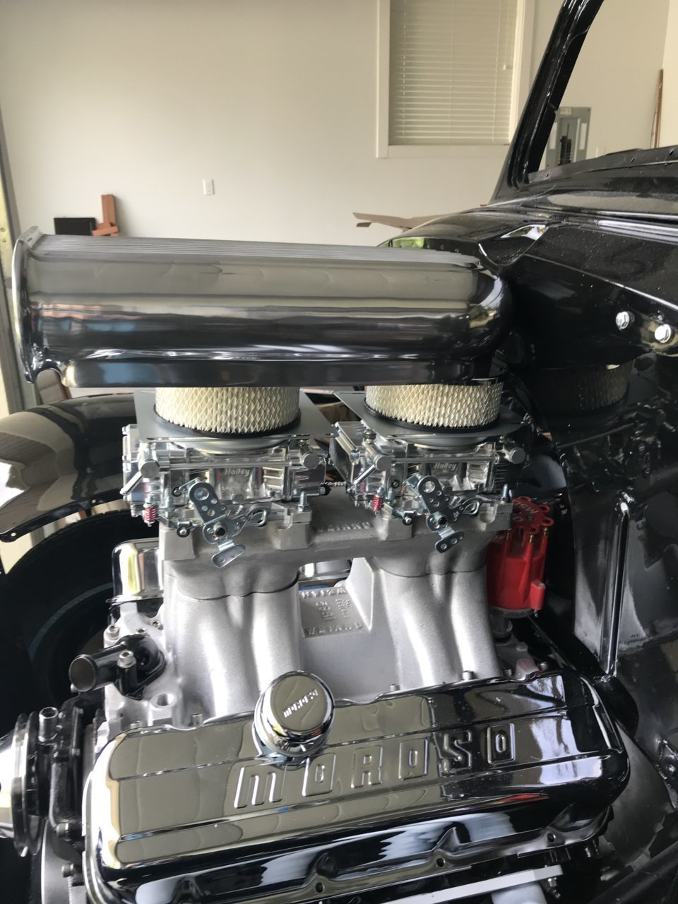

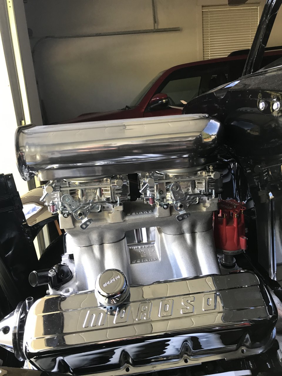

    Followed by some good news... when I mocked the driveline up the first time we ended up raising the trans 2.5" to get an approximate drive line angle. When the truck went back together this last time the angles and the numbers seamed out of wack so I ditched the 2.5" riser block.
    Today I put the blocks back in the trans mount and viola.... all my little fitment issues went away. Steering column clears, the recess for the passenger side valve cover slides in and out easily, room to get at the distributor.
    With enough room for my scoop to fit with some minor trimming of the rear carb mount... Win!

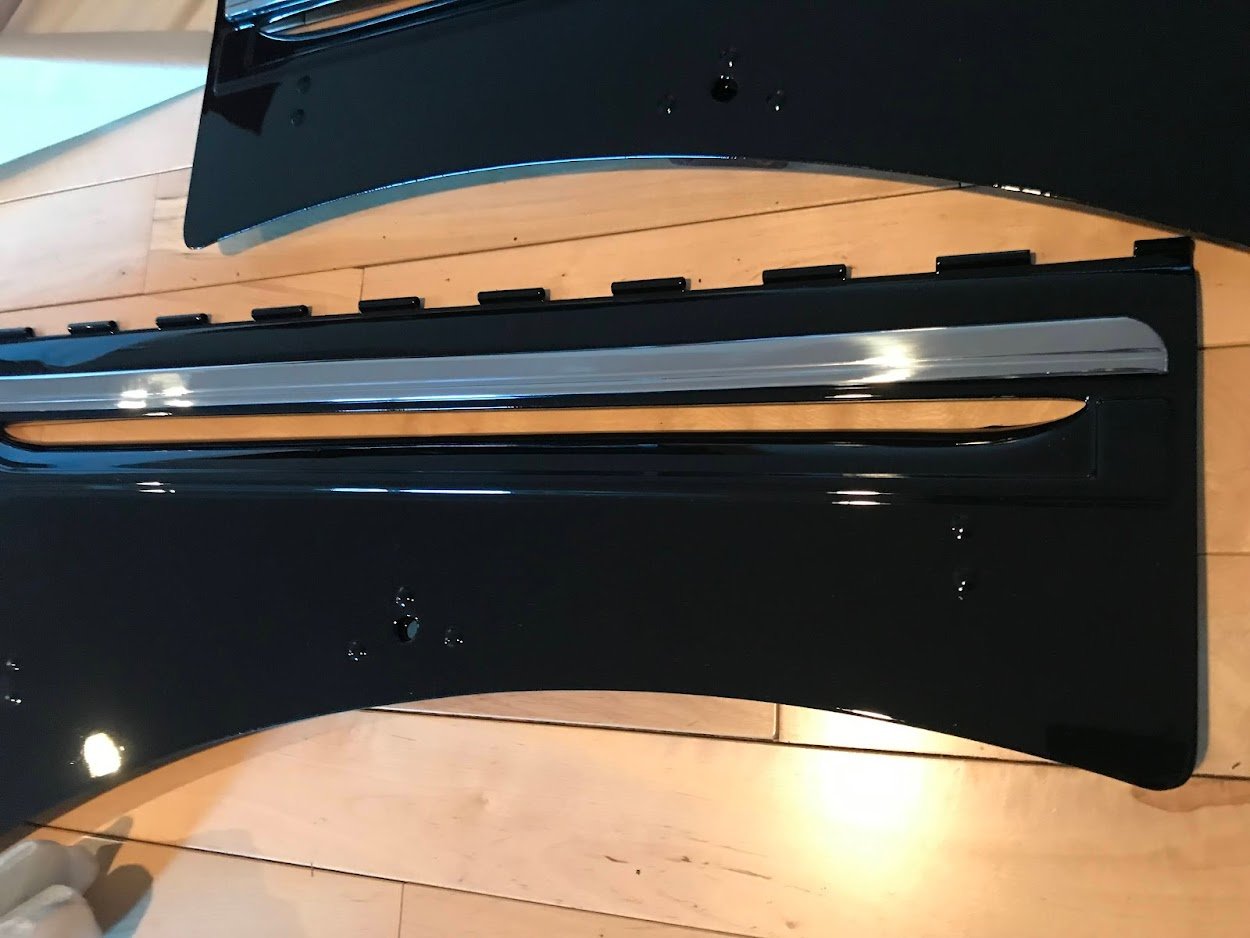

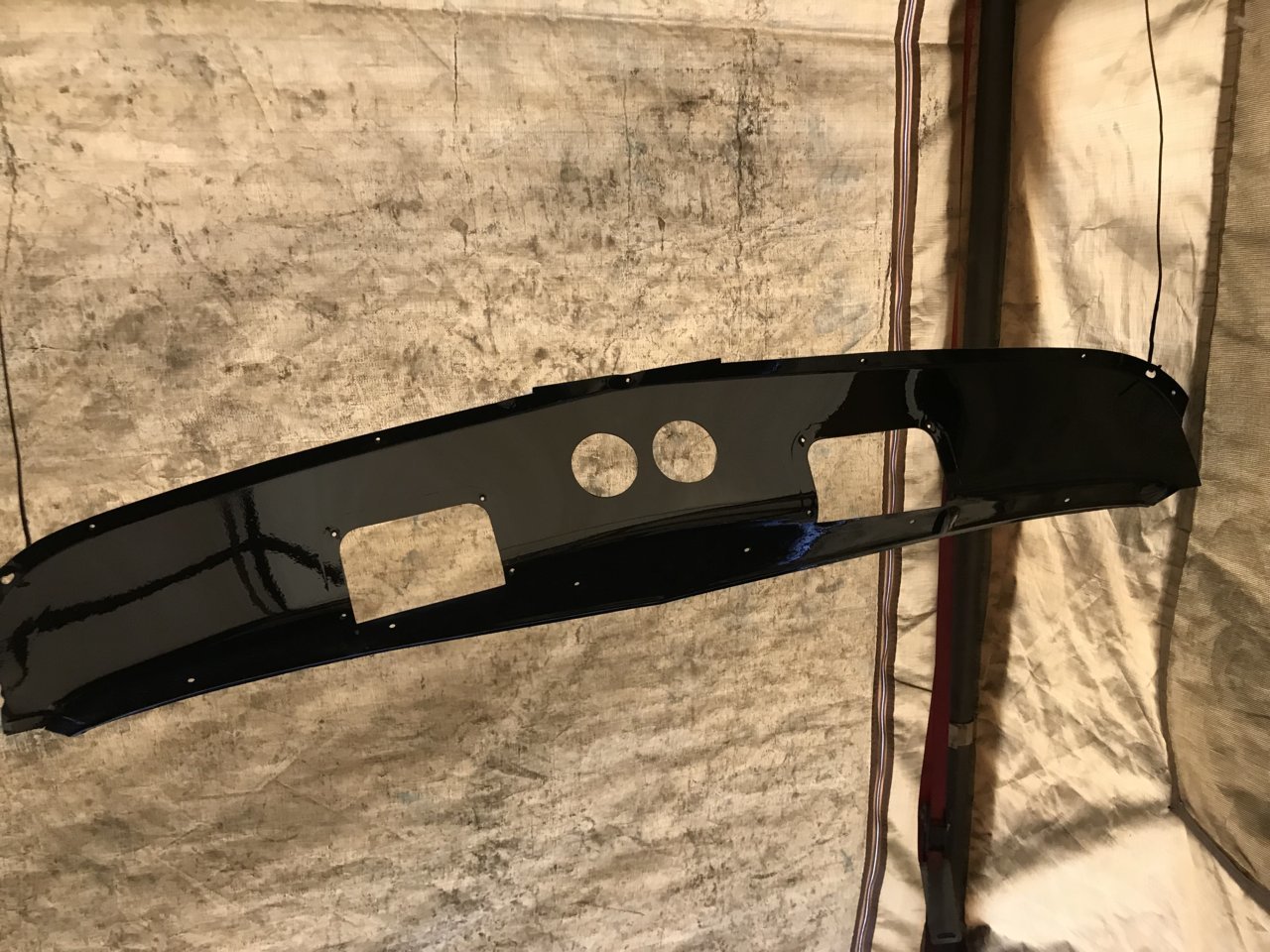

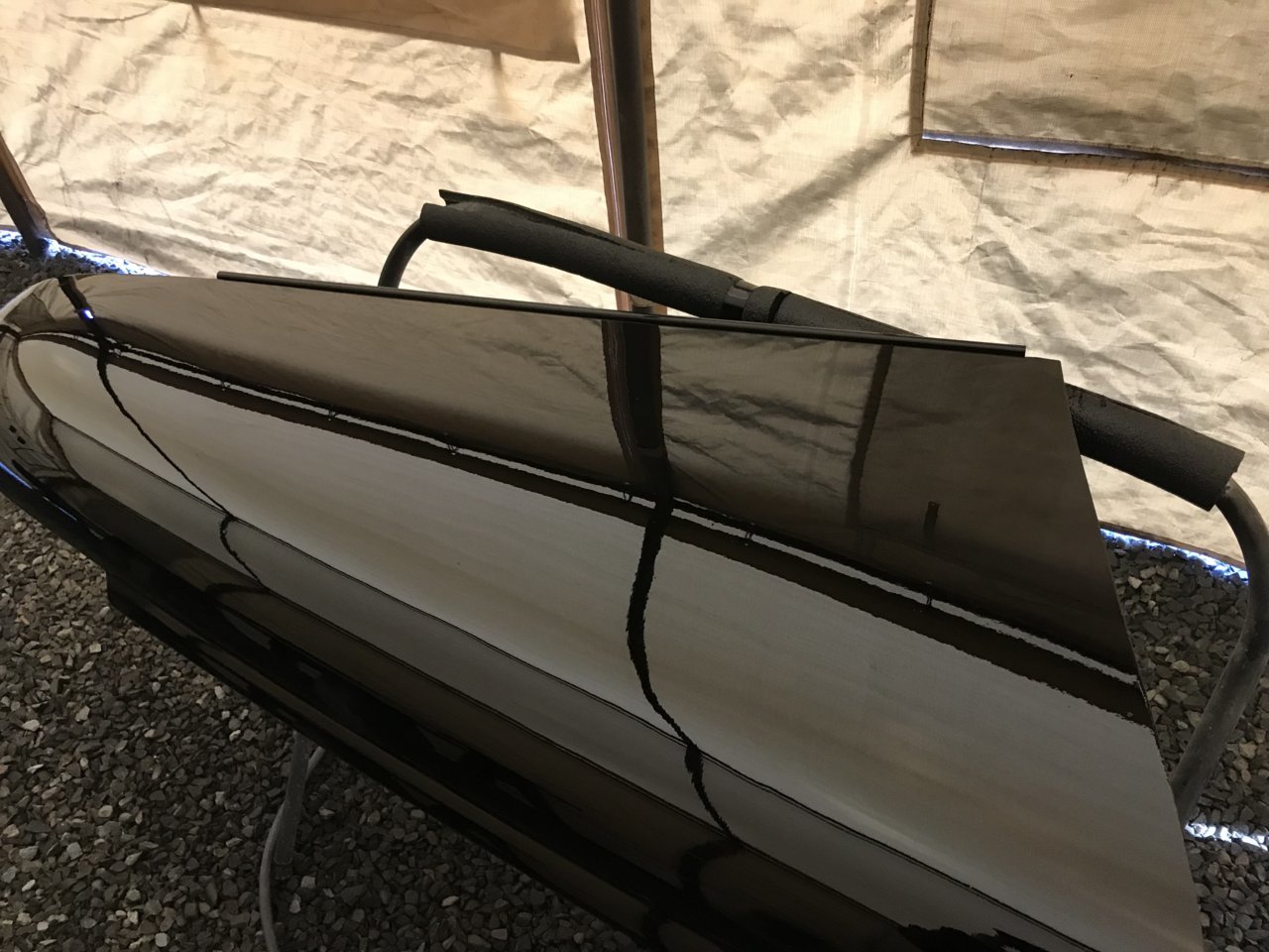

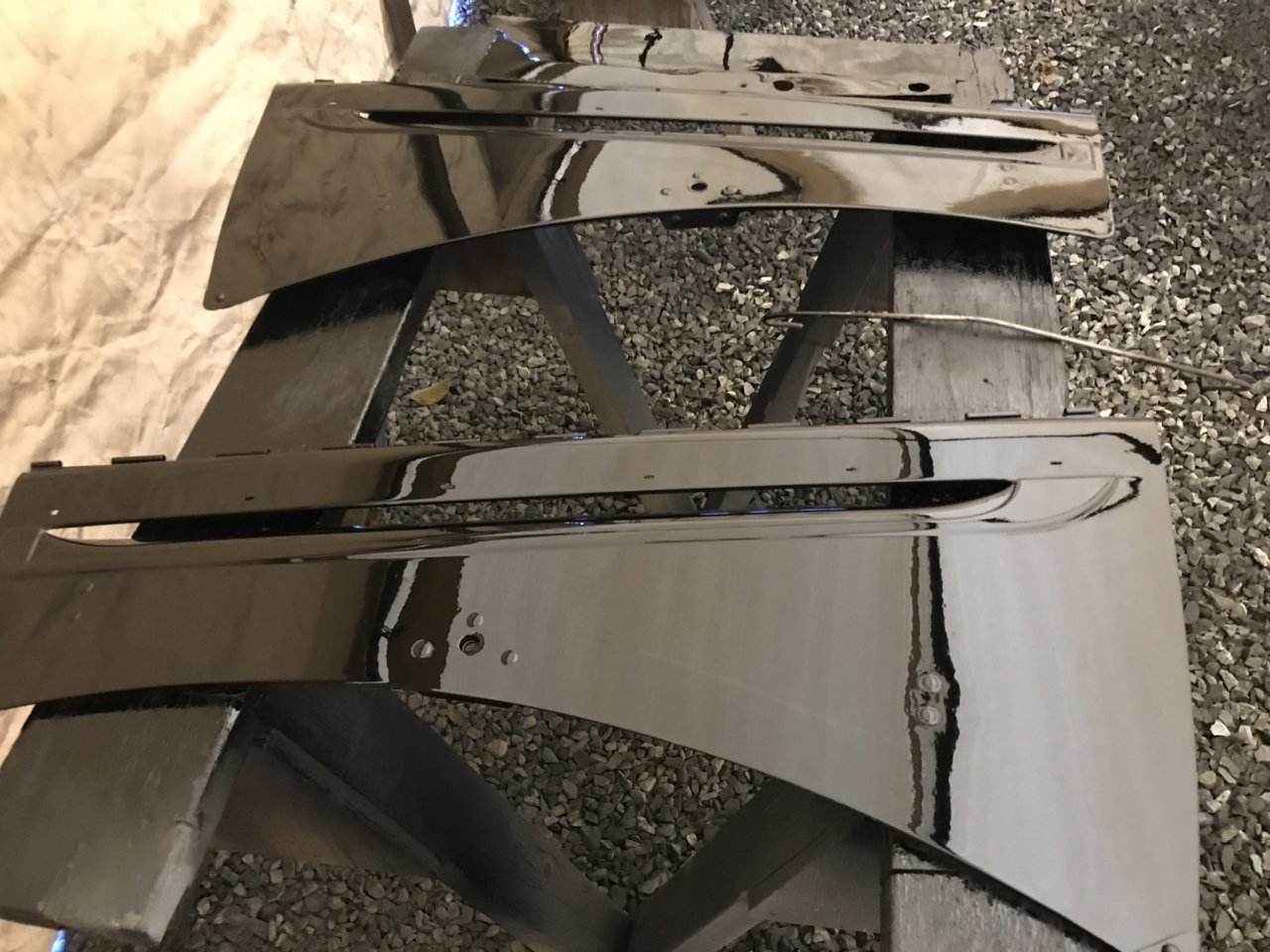

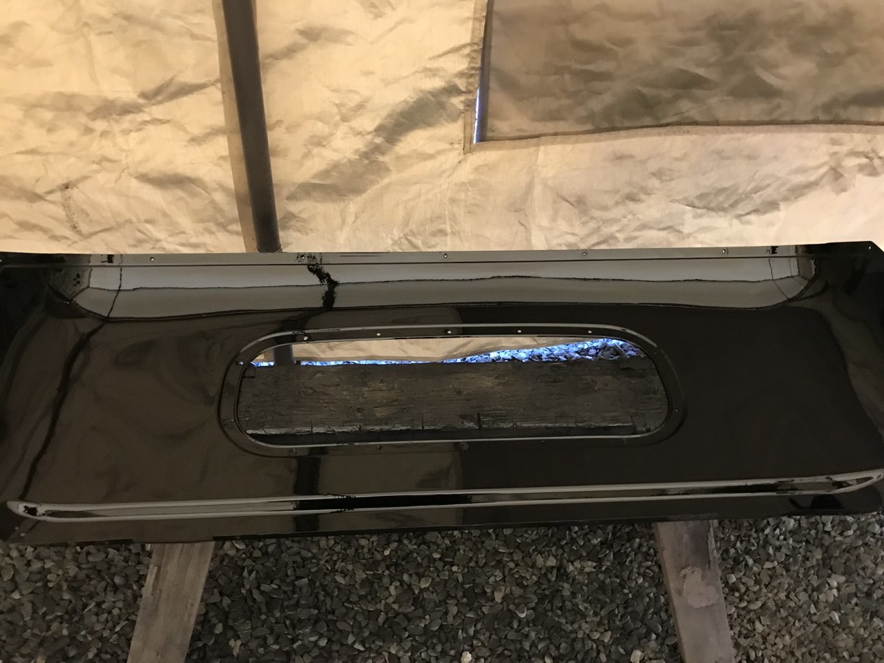

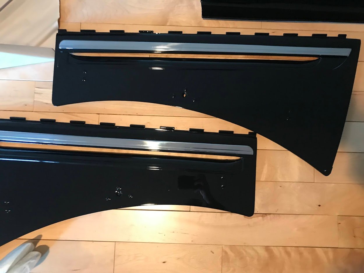

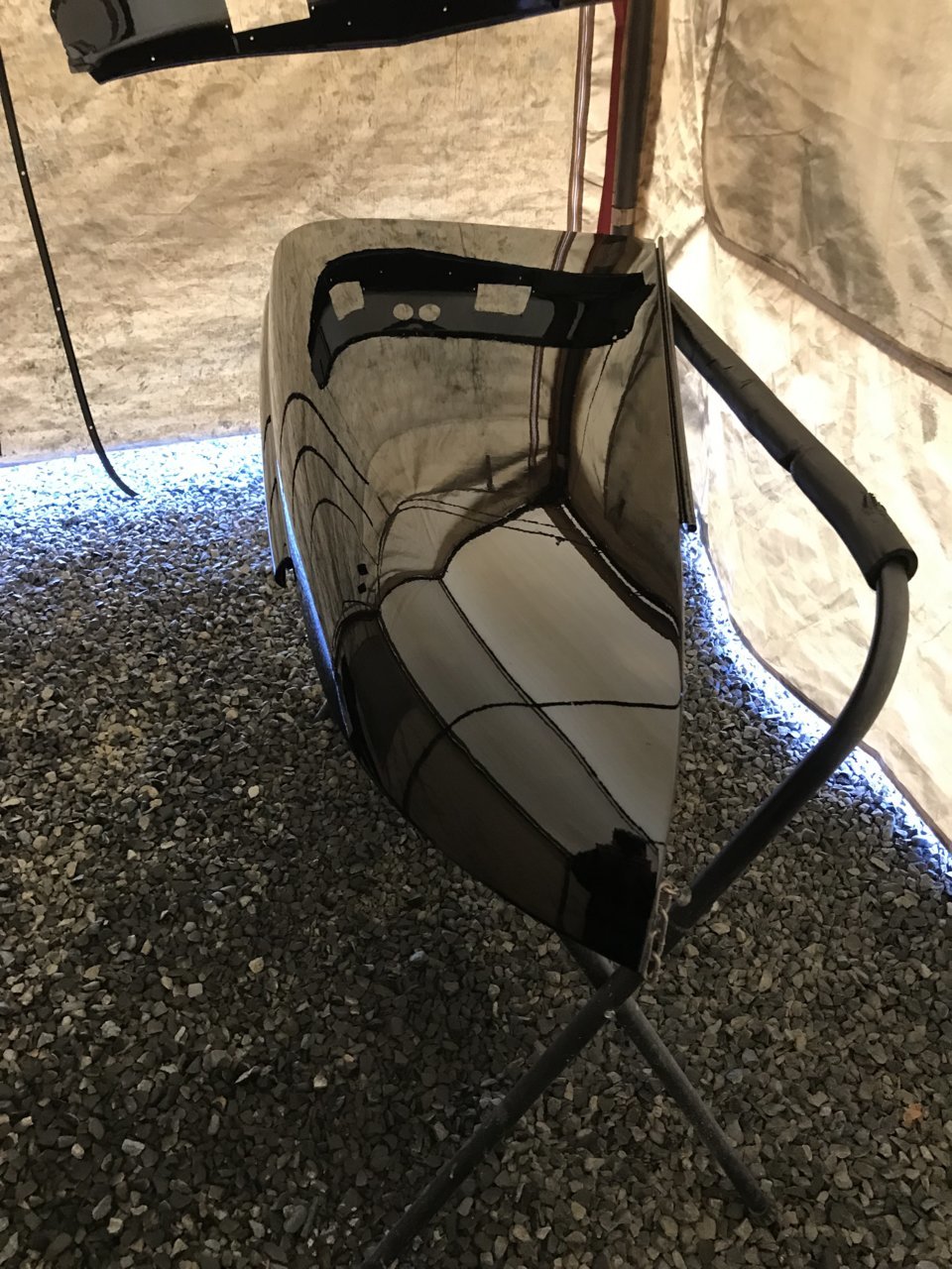

    And the last day of decent weather...so couple more items got a lick of paint

    Crazy you painted that outside. Looks amazing dude

    No s**t! I couldn't get results like that in Chip Foos' booth, never mind the friggin' back yard!

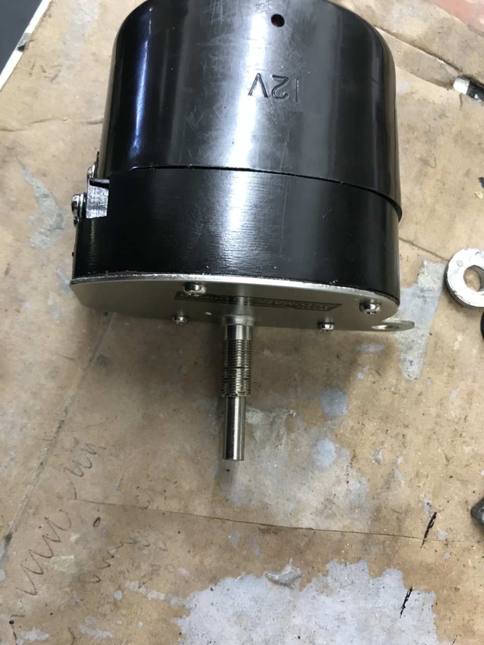

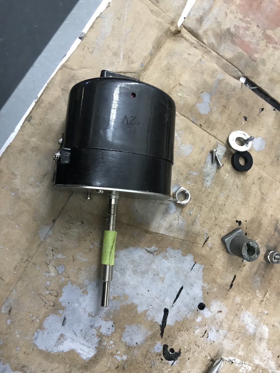

    Spent way to long modifying the electrical wiper motor arms to fit the truck... actually just the first one took a lot of measuring and trial/error to get the right length time.

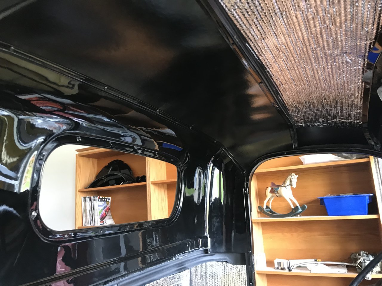

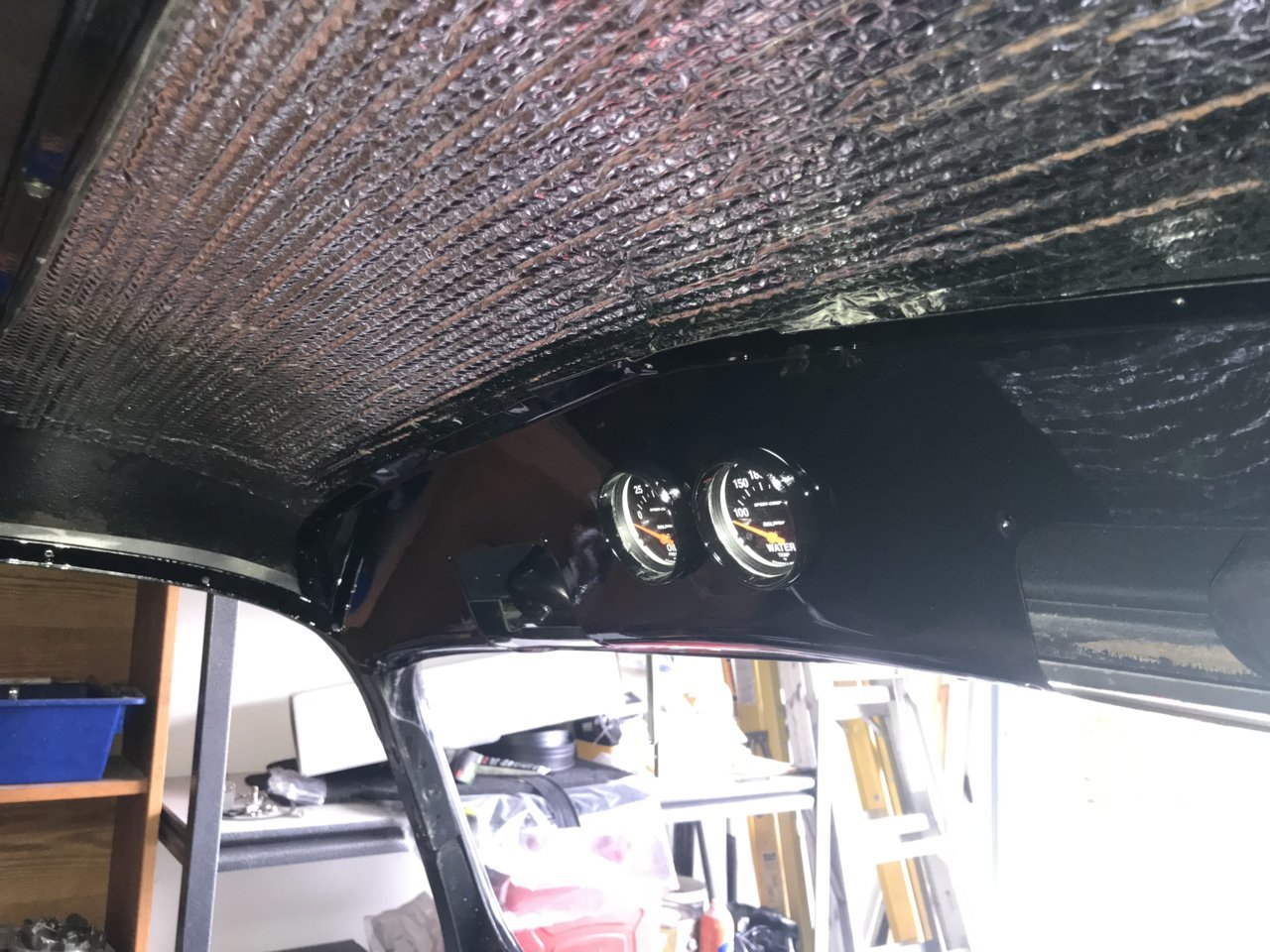

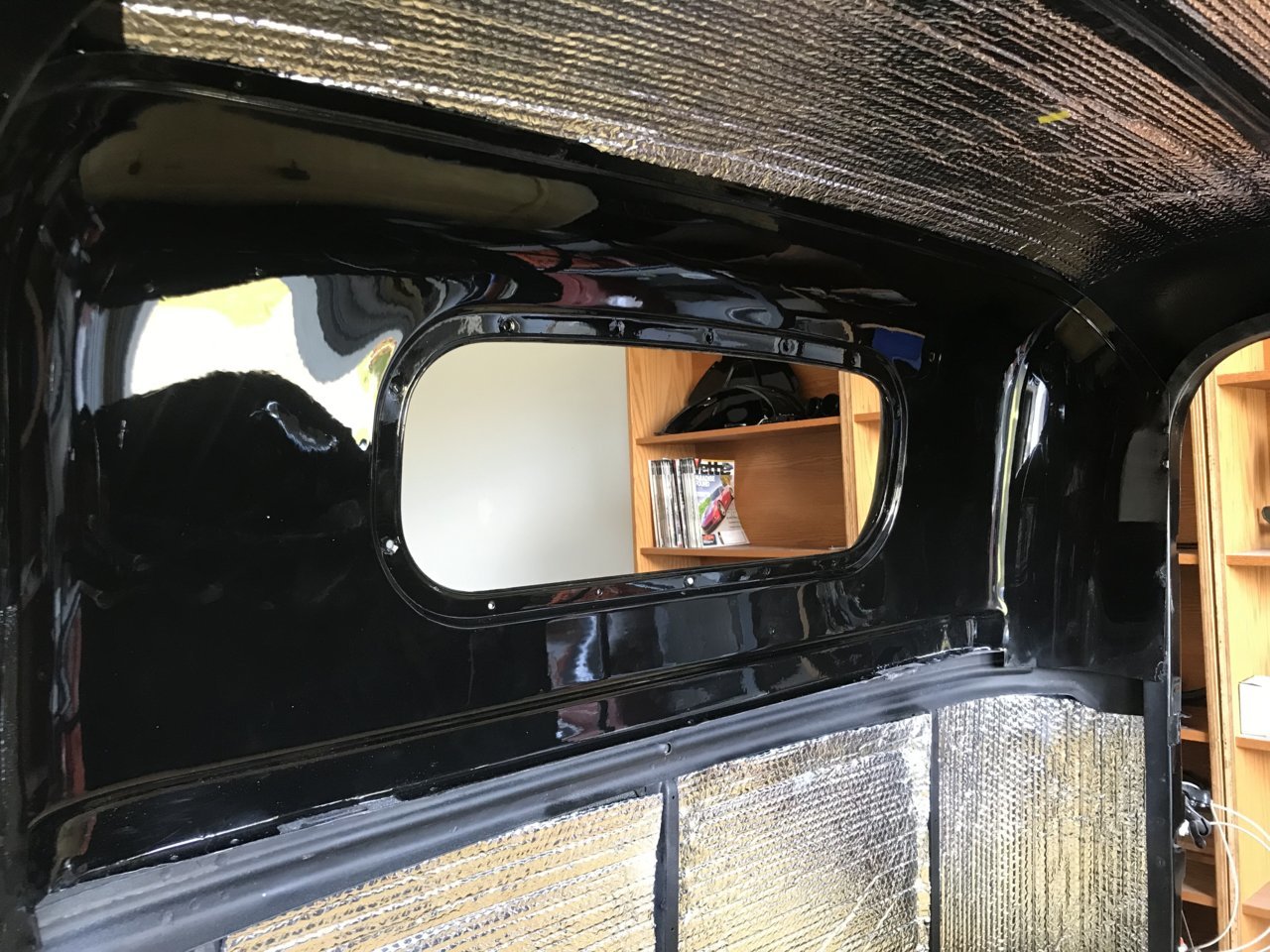

    Started to put some of the interior bits in place... rear cab backing

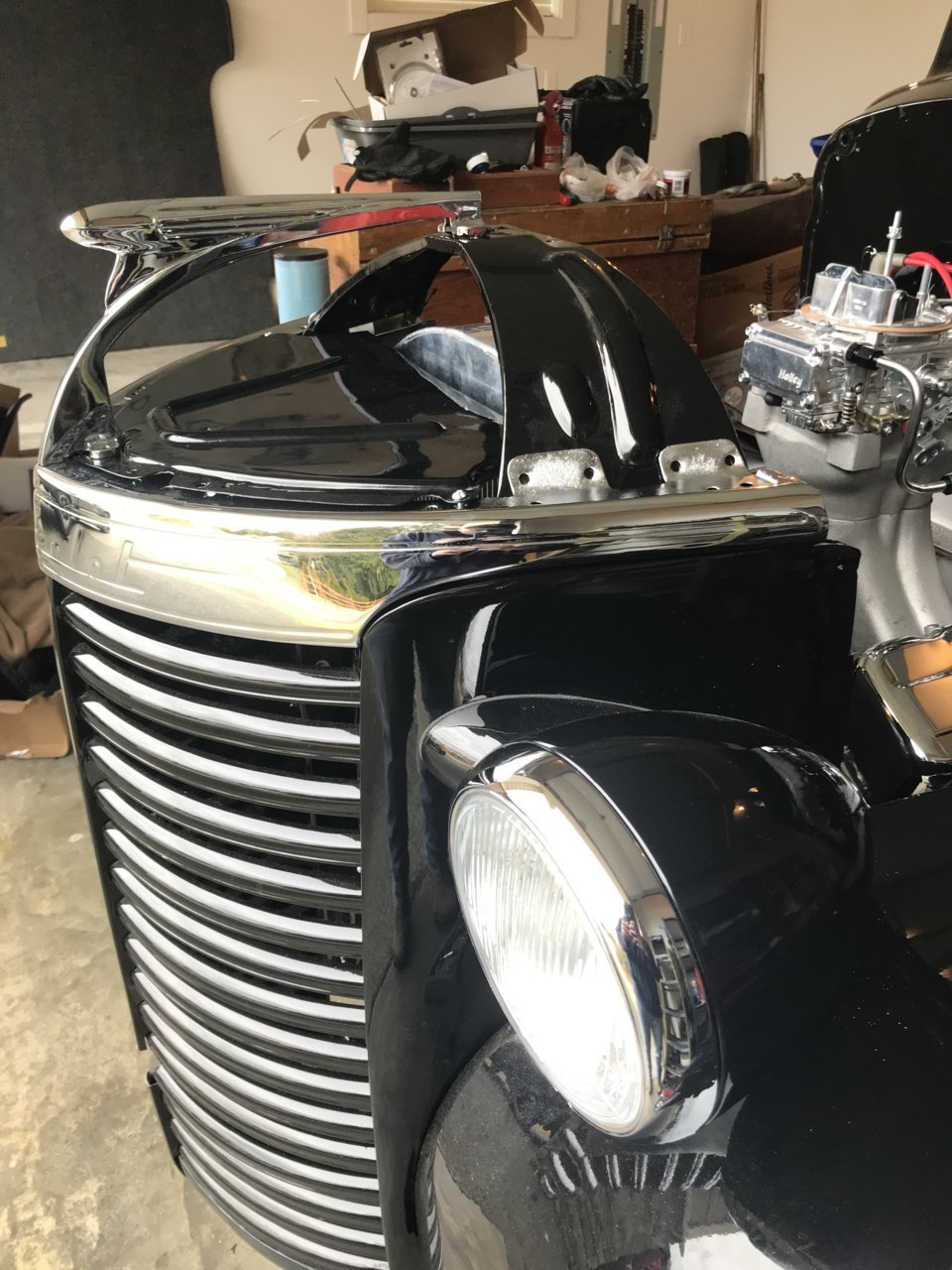

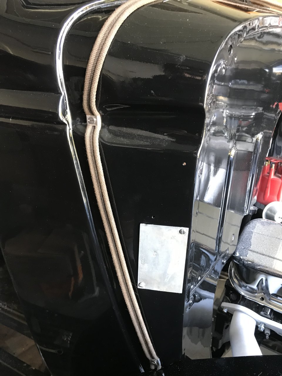

    Mounted the grill and started the hood lace

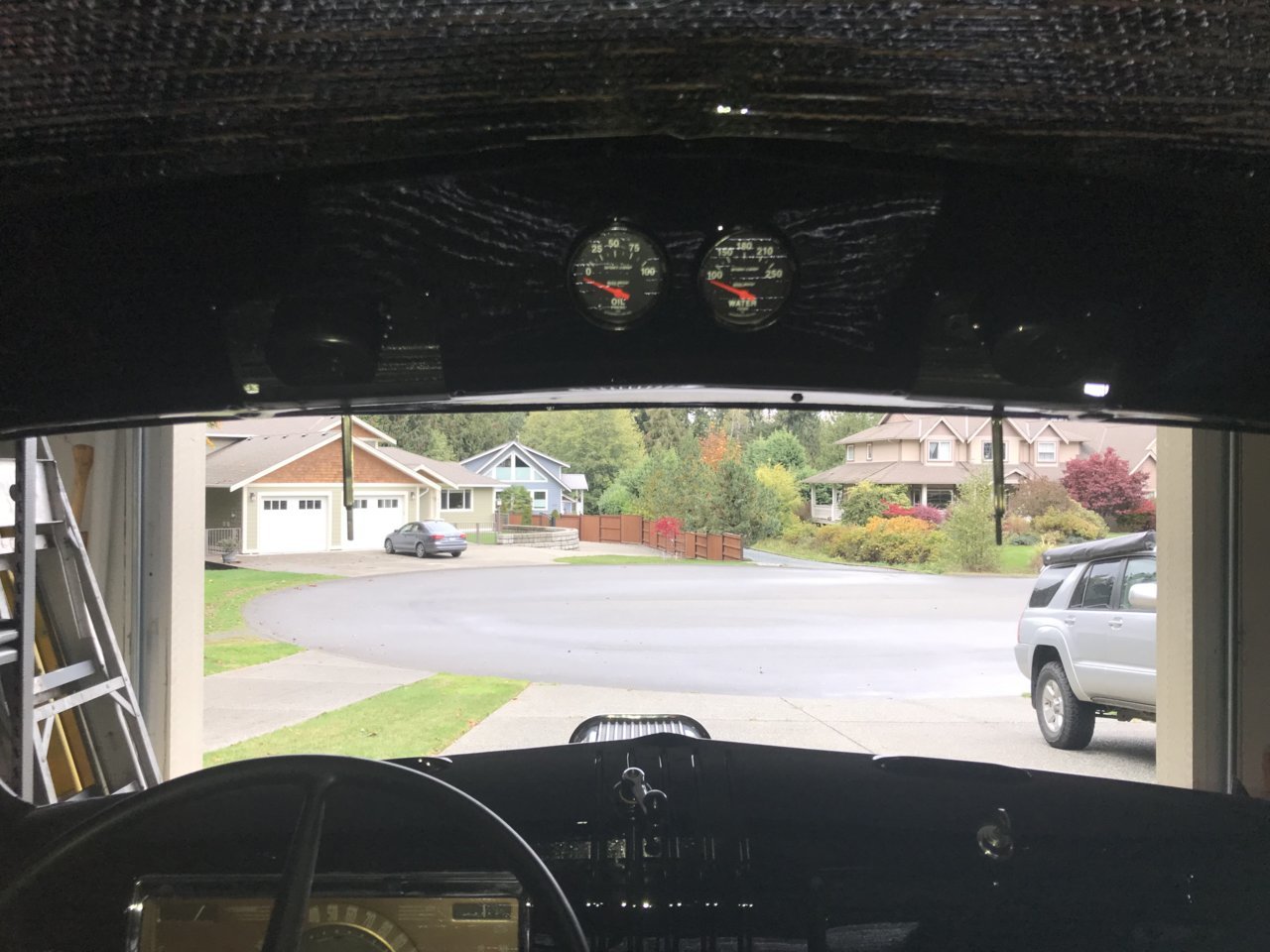

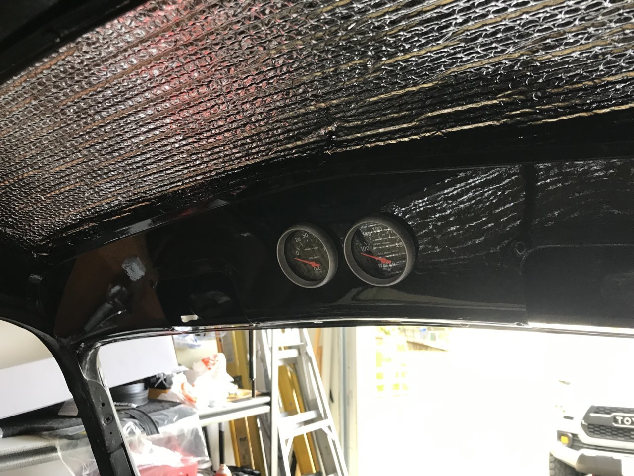

    Fitted some more of the interior bits, gauge bezel's will need to be painted black so they blend into the background a little better.
    Current struggle is getting the new rear window rubber around the glass and into the frame. Ended up taping the rubber to the external frame in an attempt to get the twist out of the new rubber...will see if it works

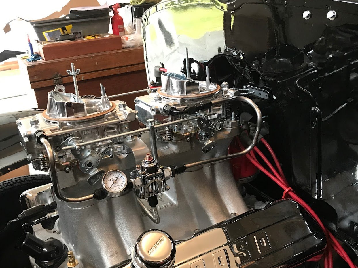

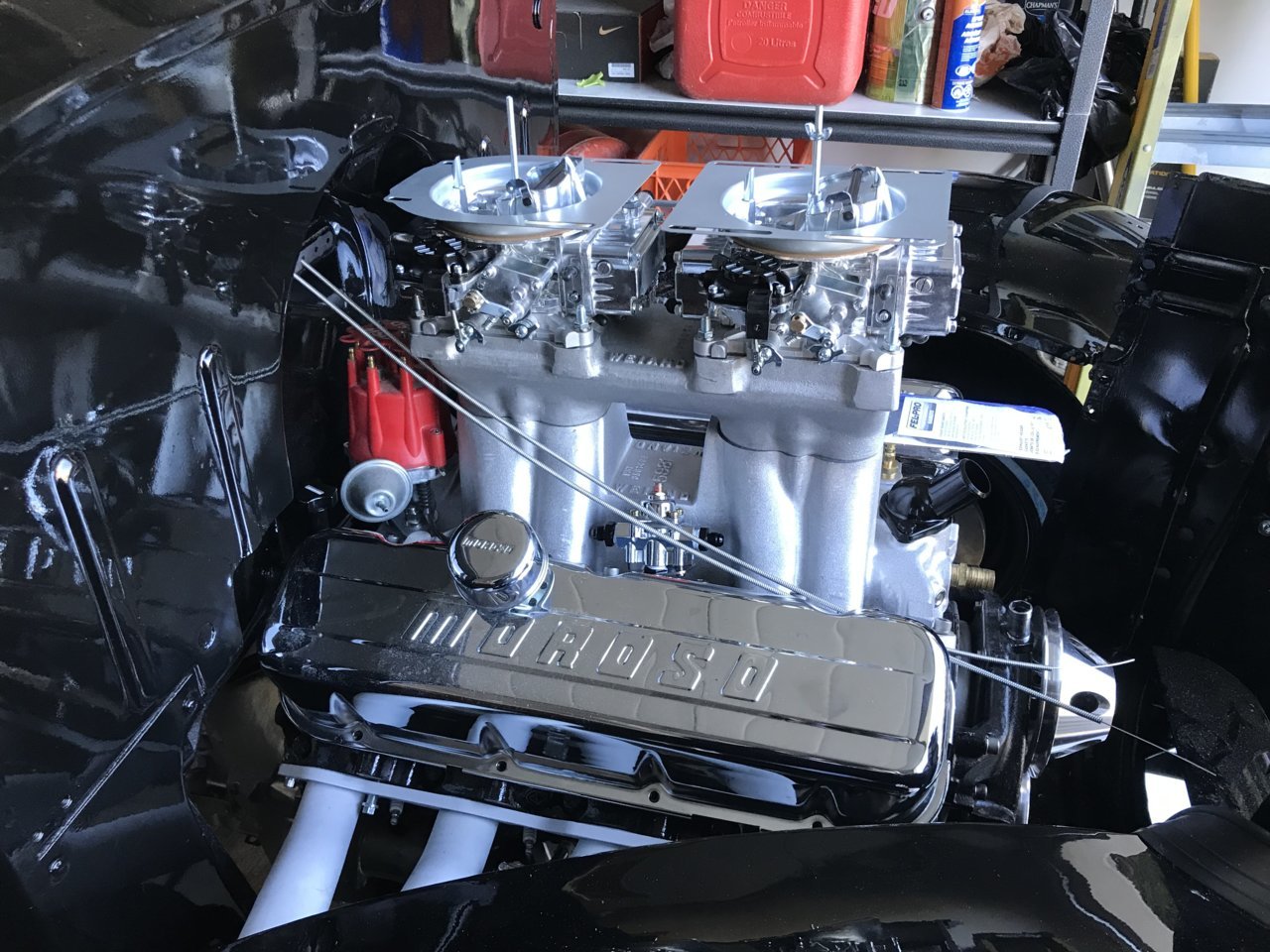

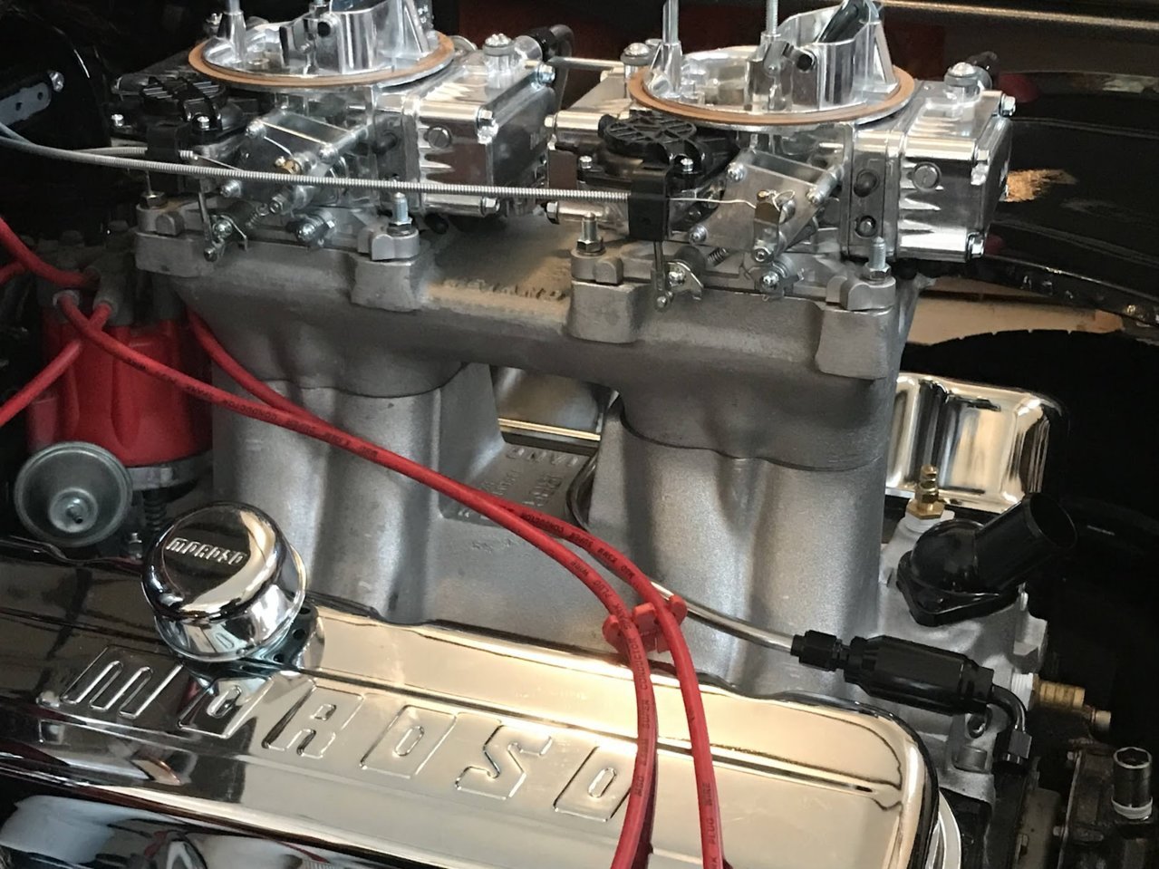

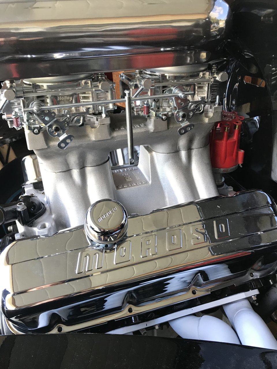

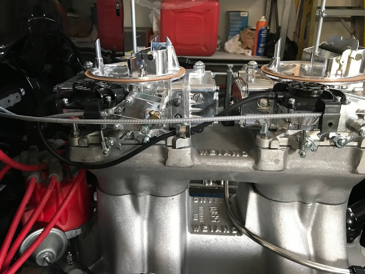

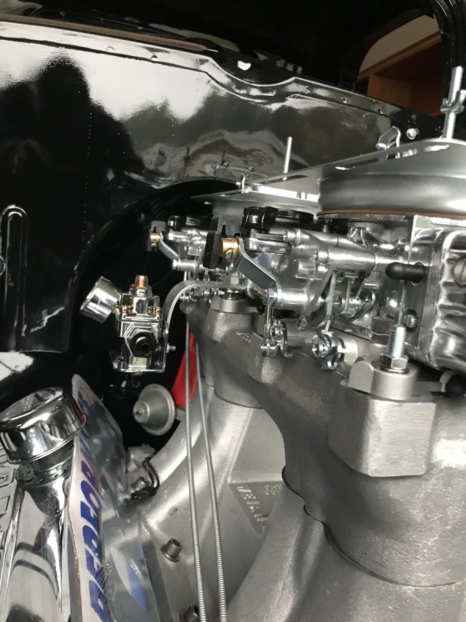

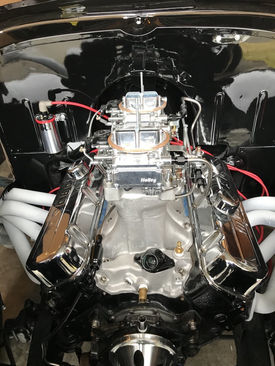

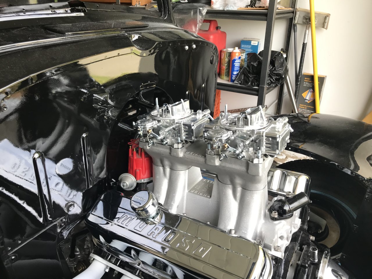

    Some minor updates.. most of which can't be shown. Updated the carbs to 50cc accelerator pumps and added dual quick change covers for the vacuum secondaries. Changed out the thermostat housing for a straight unit.

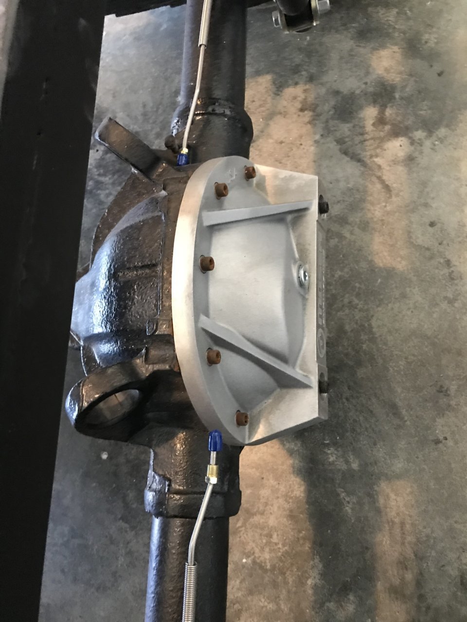

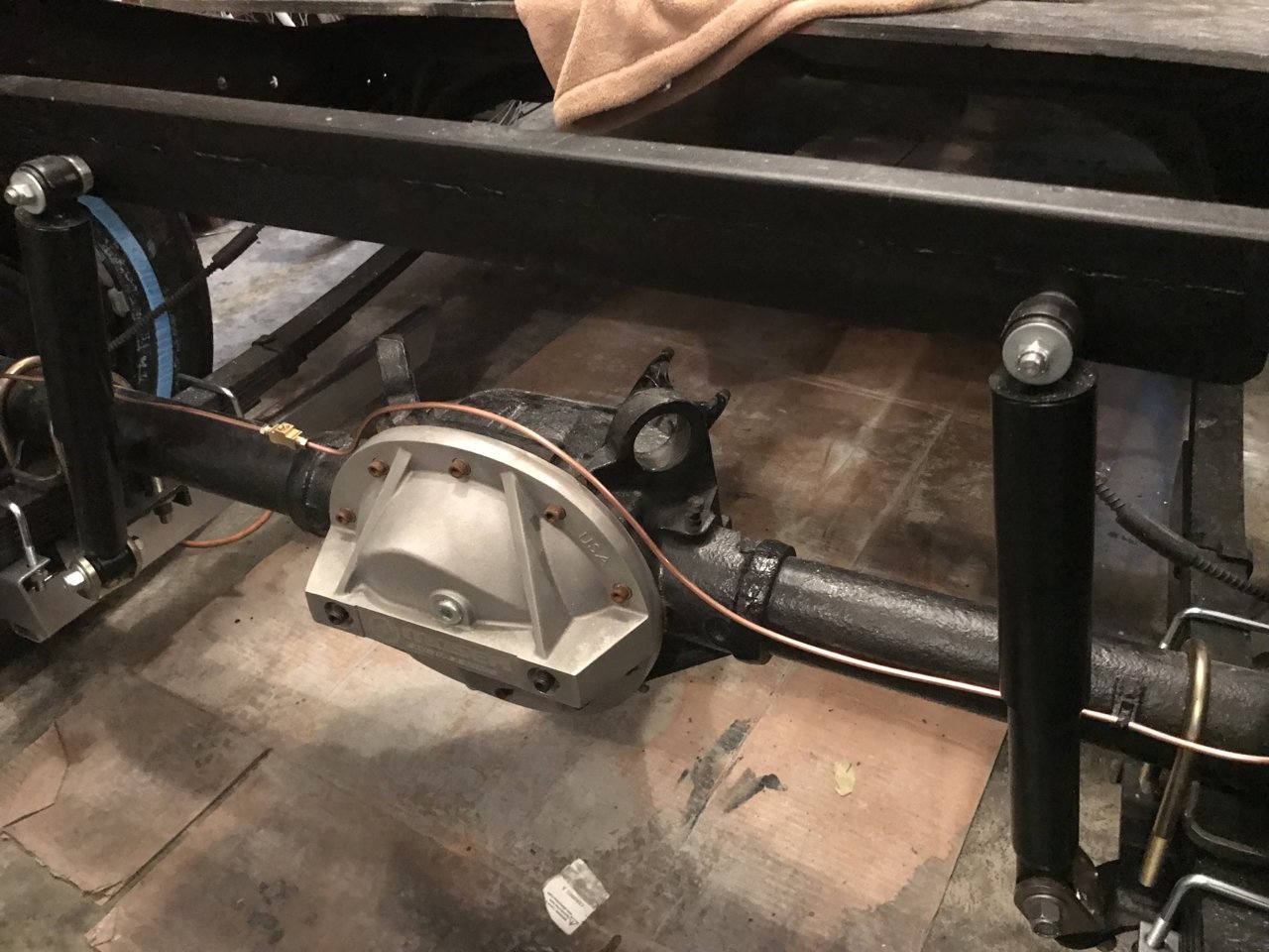

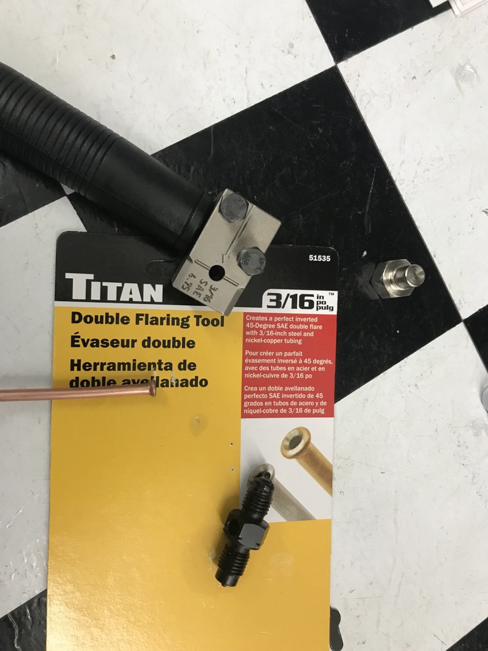

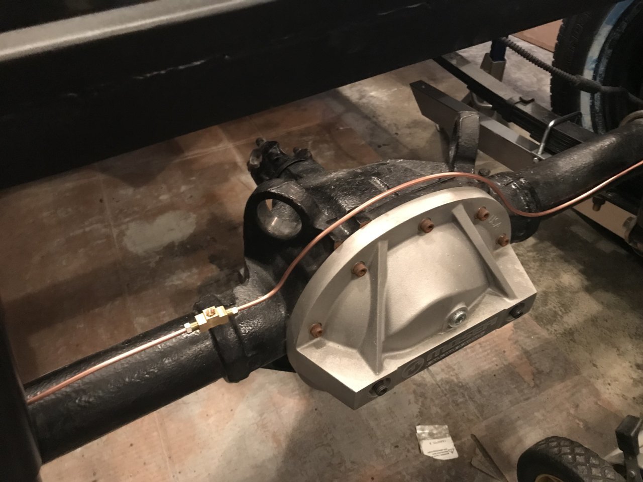

    Rear brake lines installed, used the TItan tool for flaring the lines...highly recommend it.
    Connected and ran the choke and hand throttle cables through the firewall, just need to cut them for length. Nice part about having dual carbs with manual chokes is I can utilize the original dash controls.

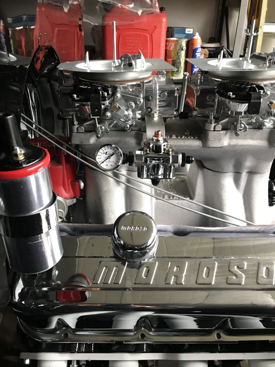

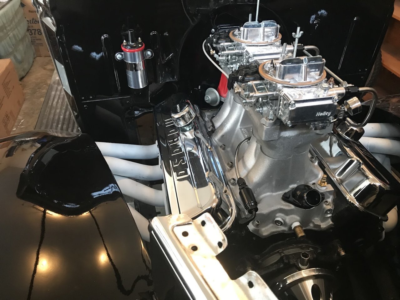

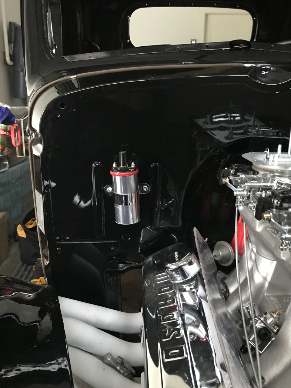

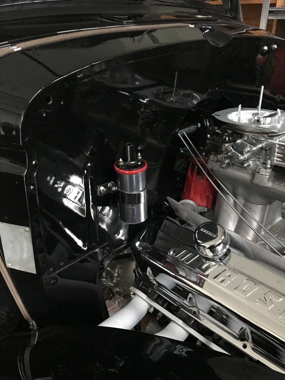

    Got a couple of hours out in the garage. Coil mounted and made a bracket for the fuel pressure gauge.
    Used two of the original firewall rubber grommets to isolate the coil bracket from the sheet metal

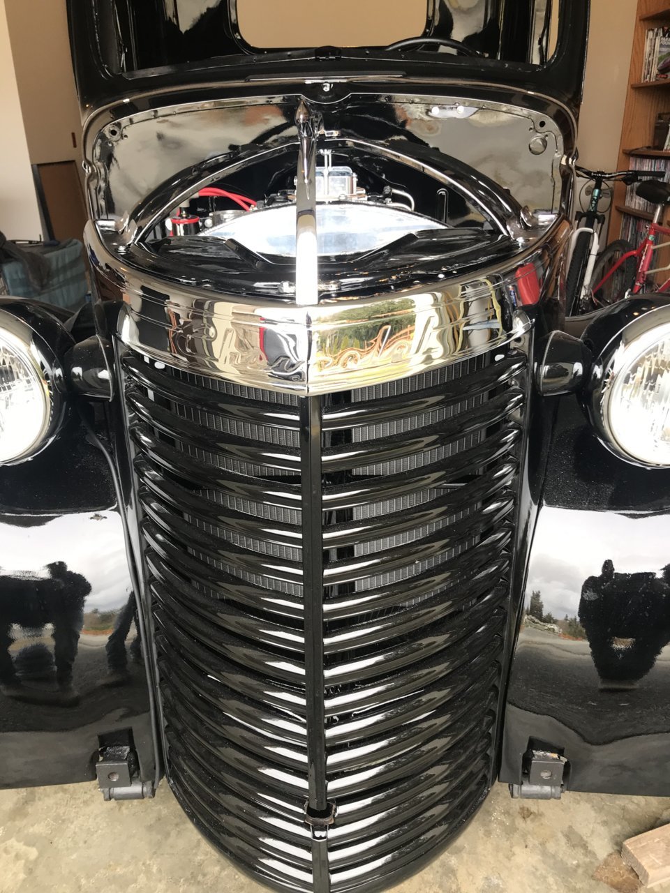

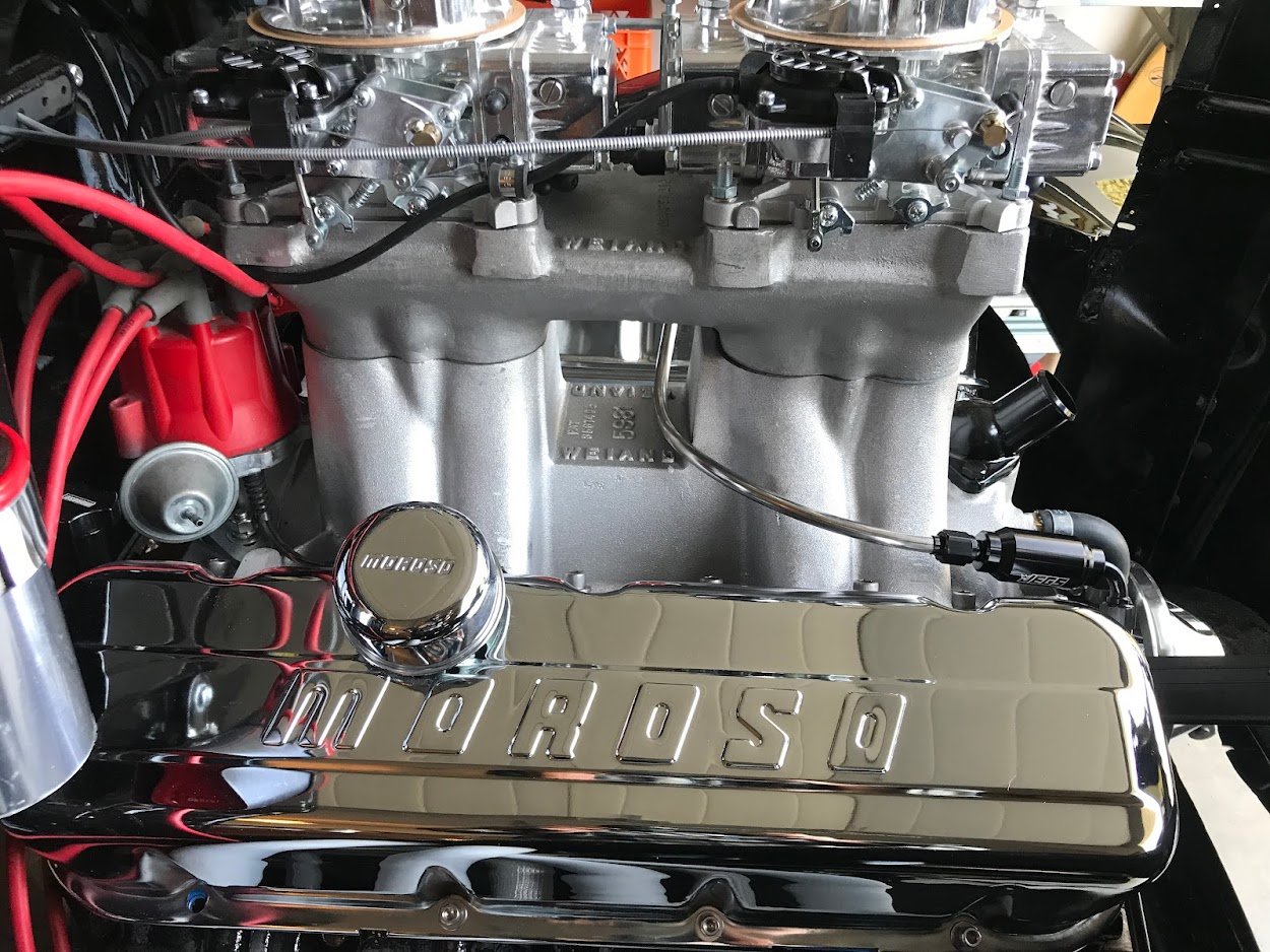

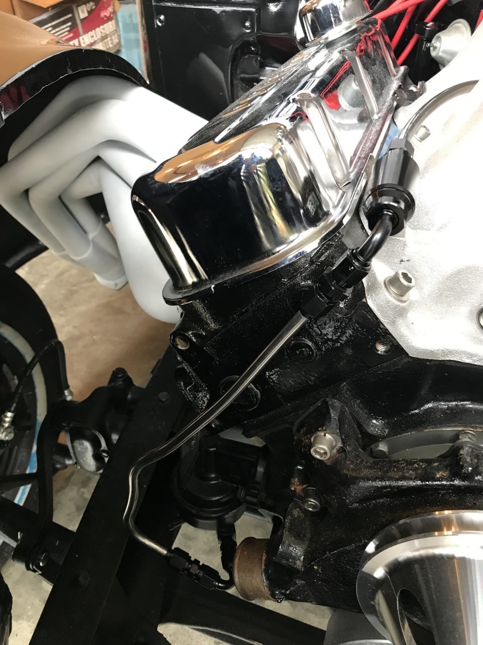

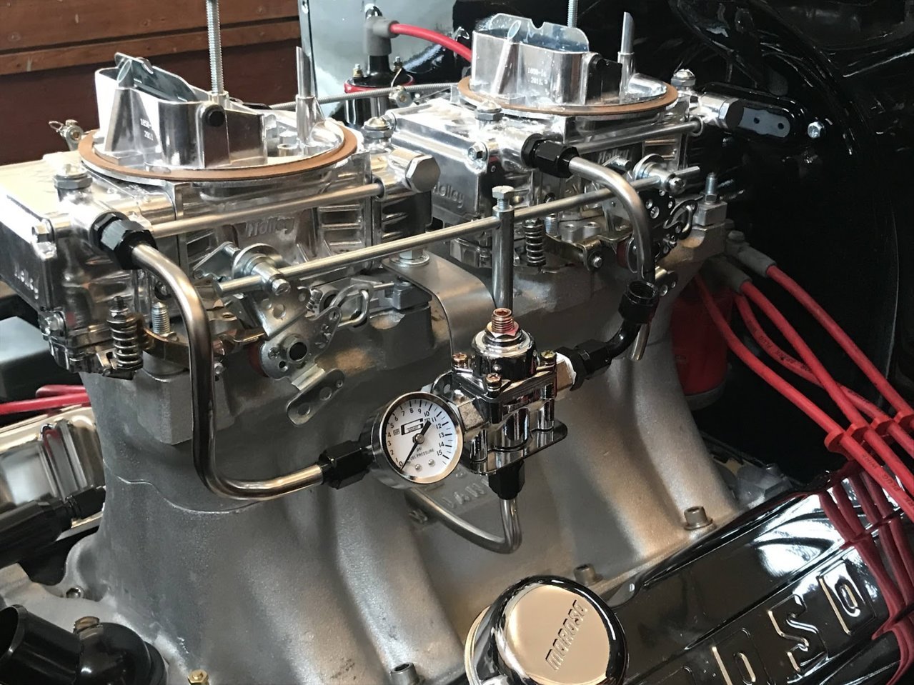

    Took some time off as winter hit, but I've slowly started back at it. Working on the fuel lines the last couple of days... decided to make life more difficult and use a combination of 3/8 stainless lines with -an fittings.
    Using a Rigid 37 Degree flaring tool for stainless and a Jegs tubing bender. Thankfully I don't have a lot of line to run as I find stainless is a pain to bend.
    Also got some parts back from the plater... mounted the top hat and that's about it for now.

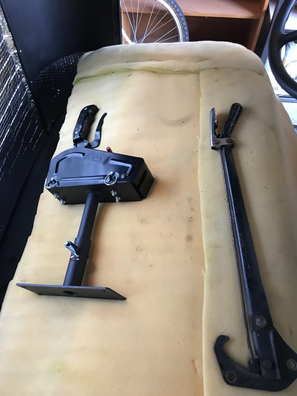

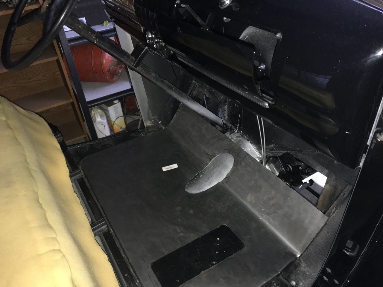

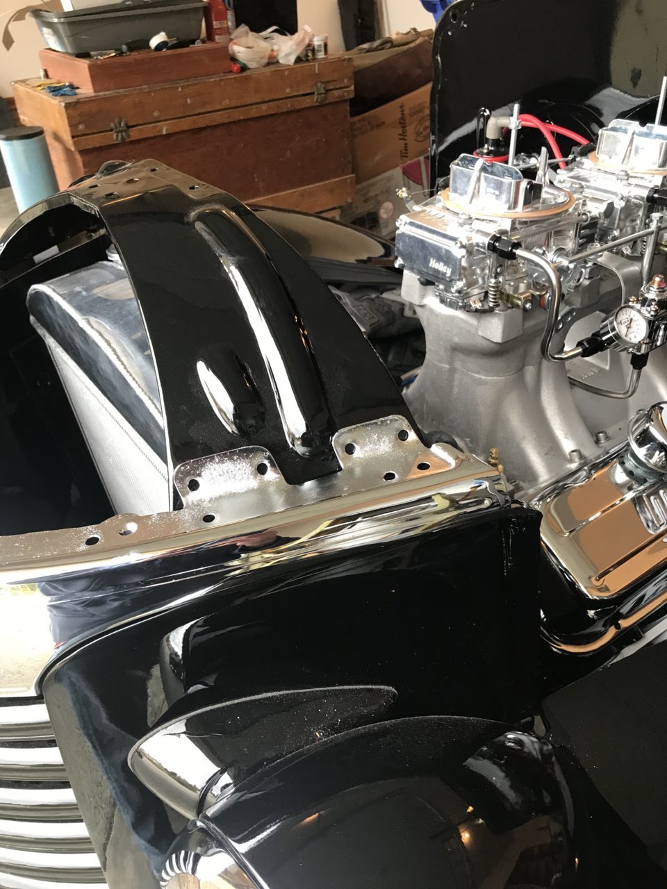

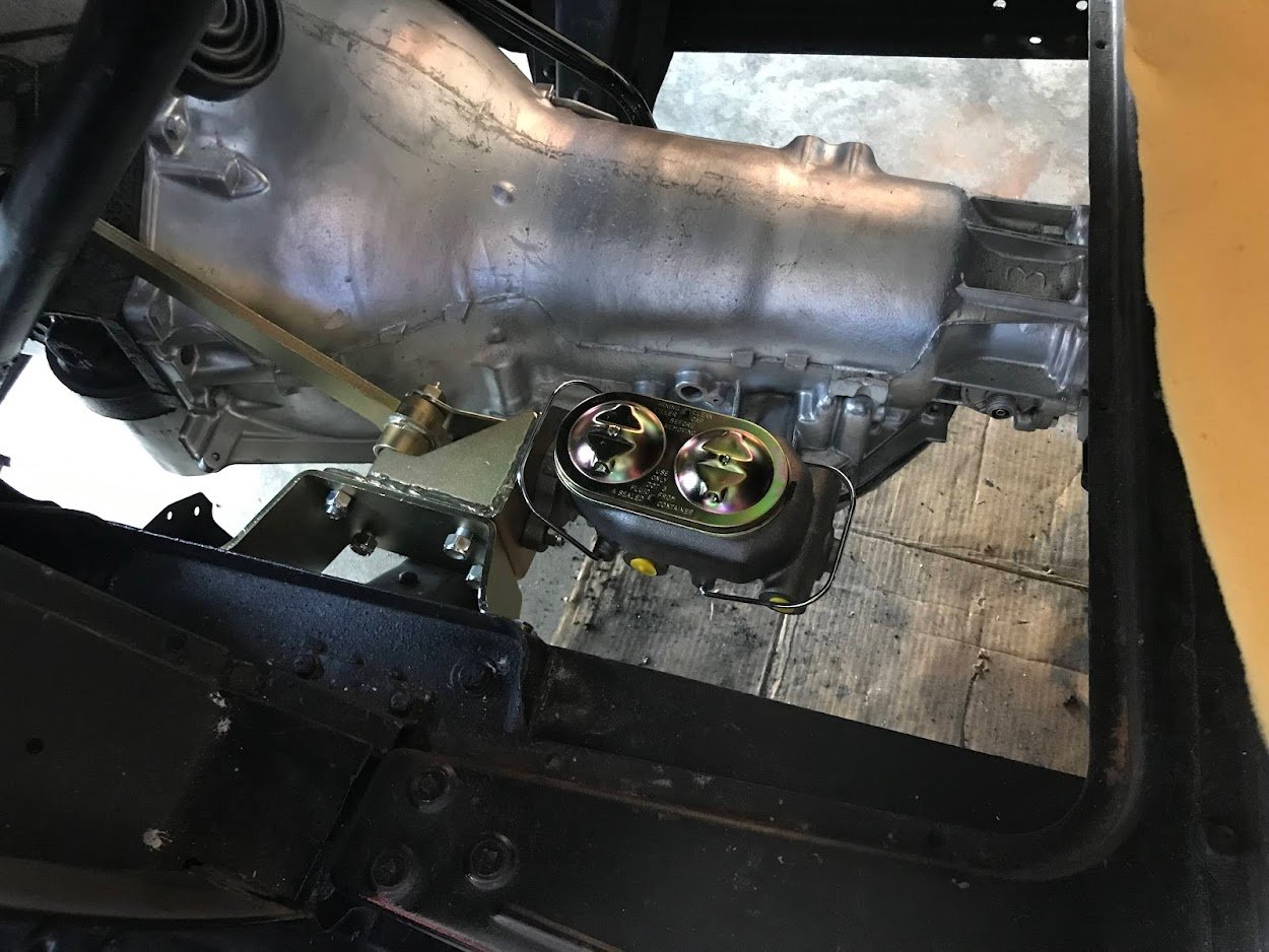

    Getting some more small items completed.... finished the fuel lines, brake pedal assembly is in, started mocking out the floor for the shifter and parking brake

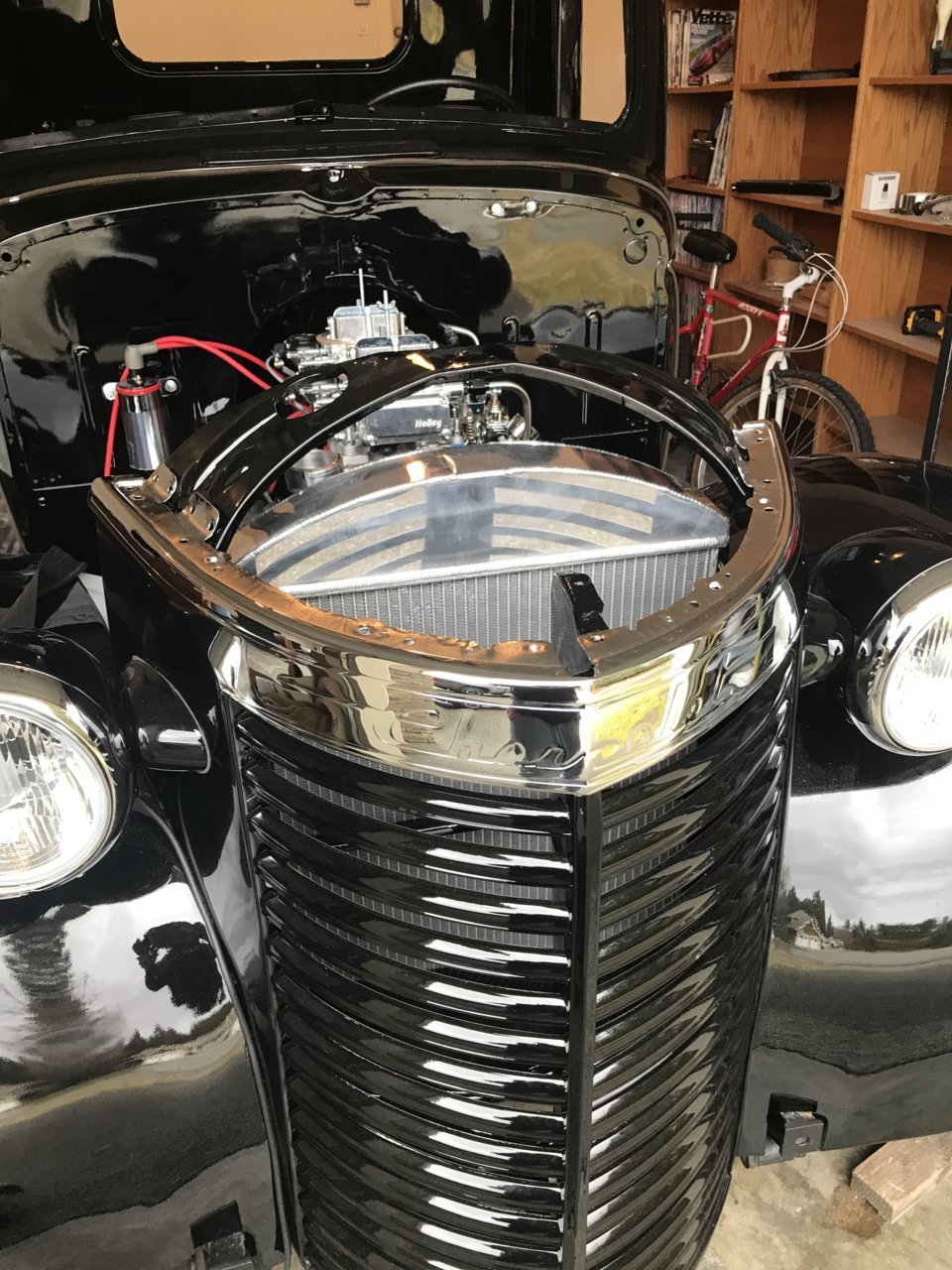

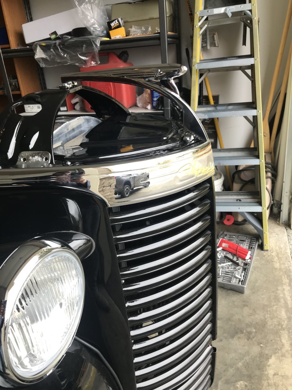

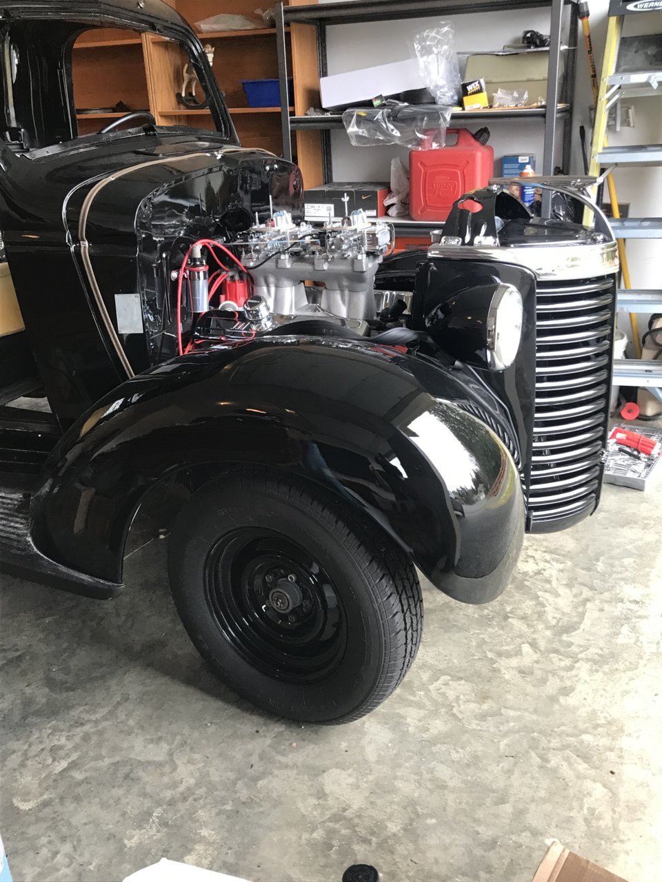

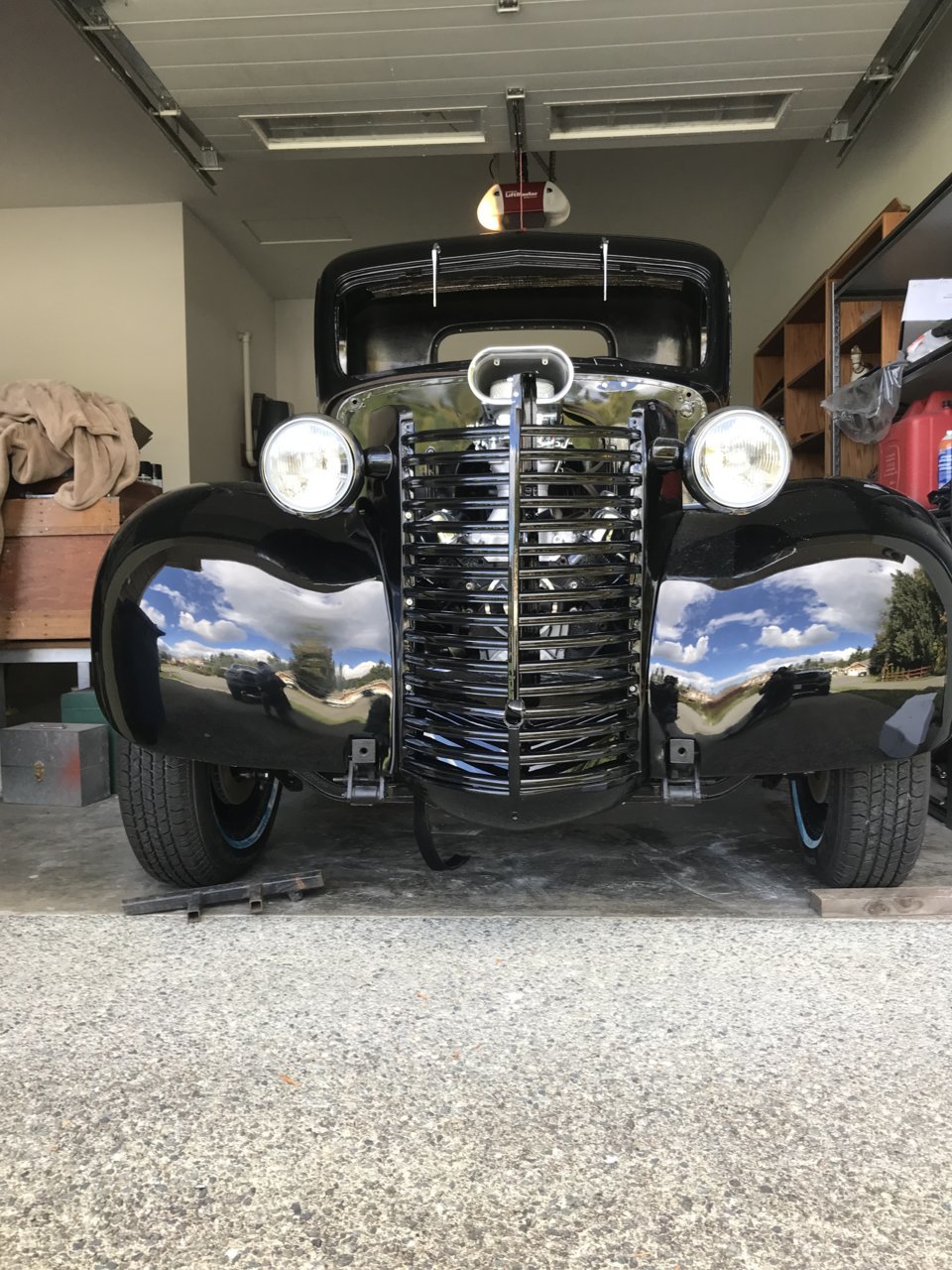

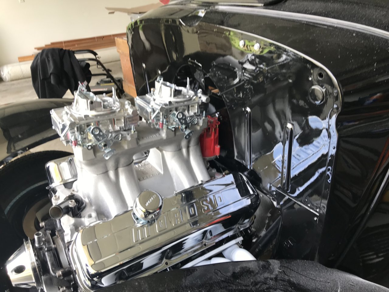

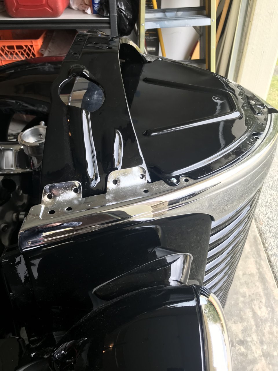

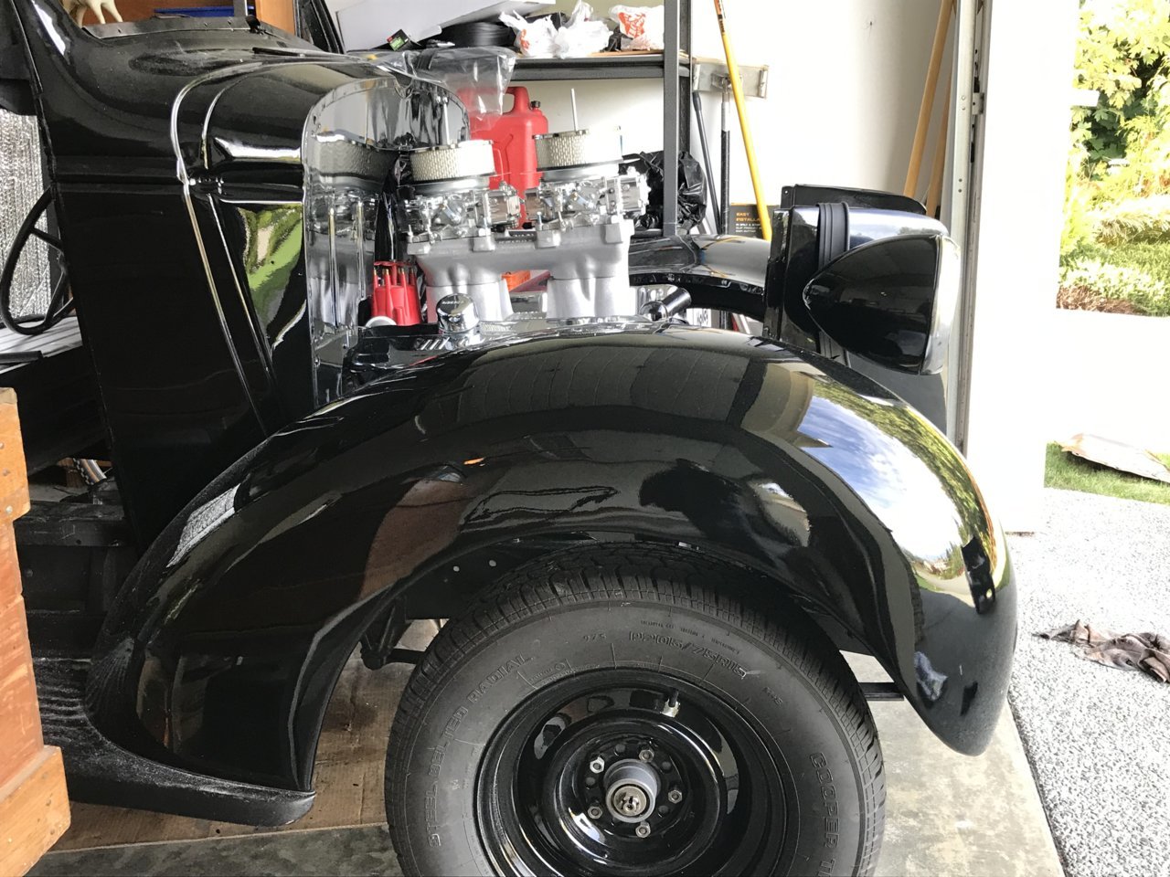

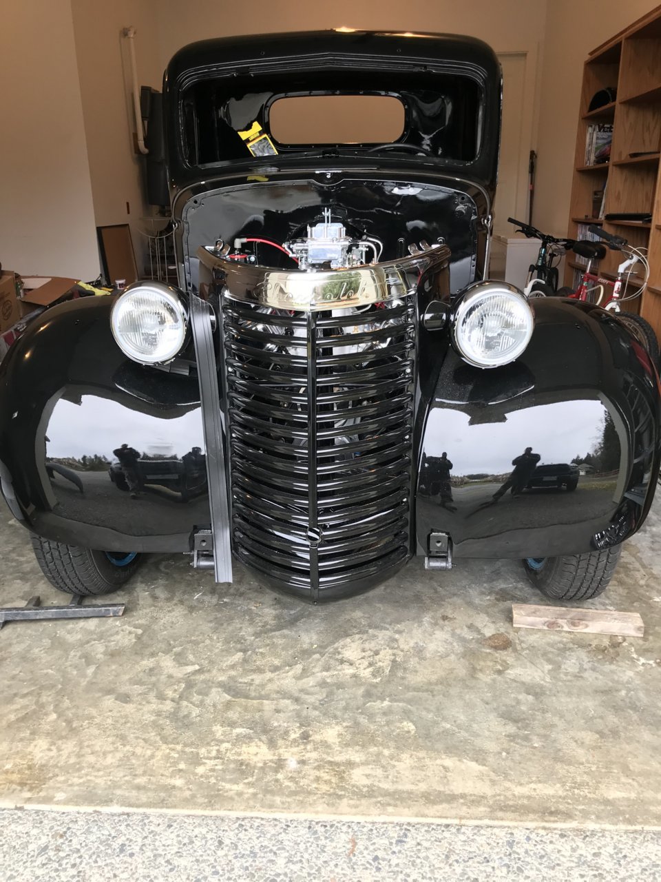

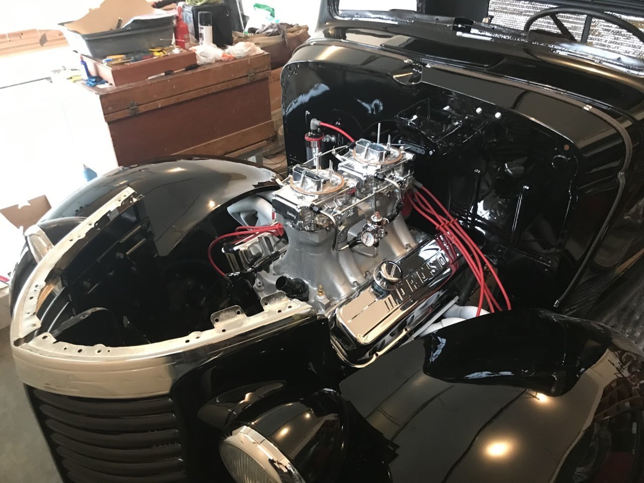

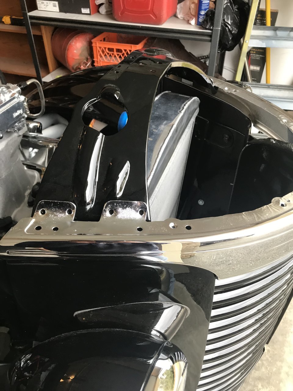

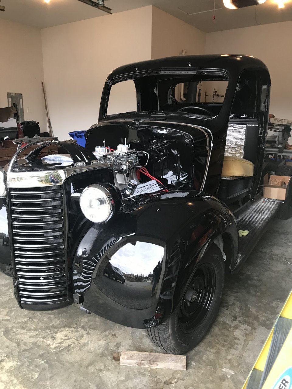

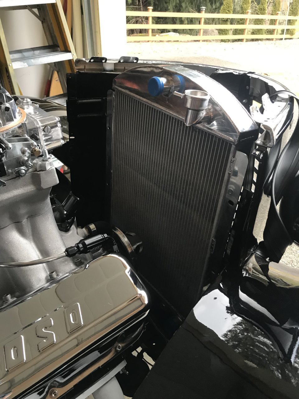

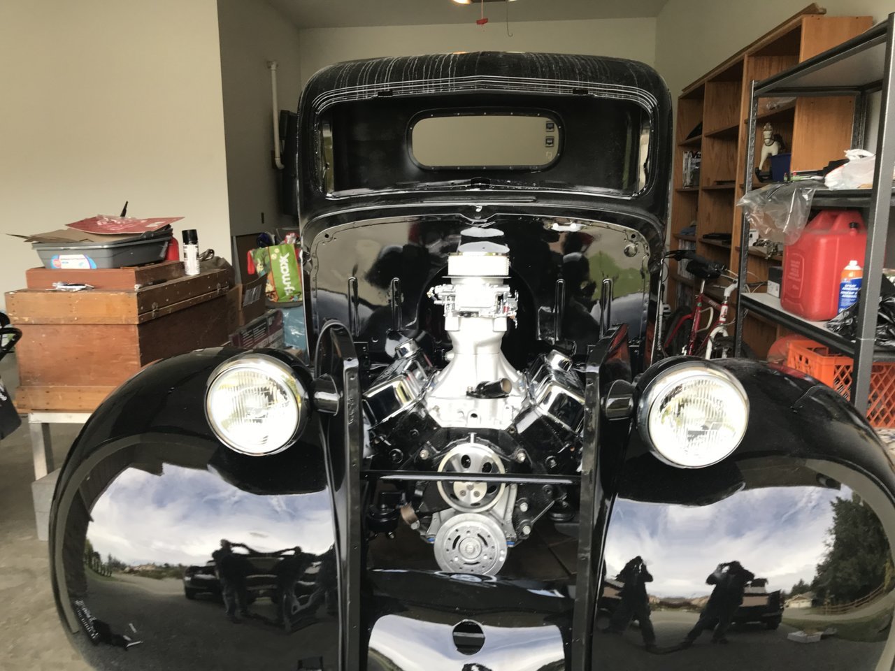

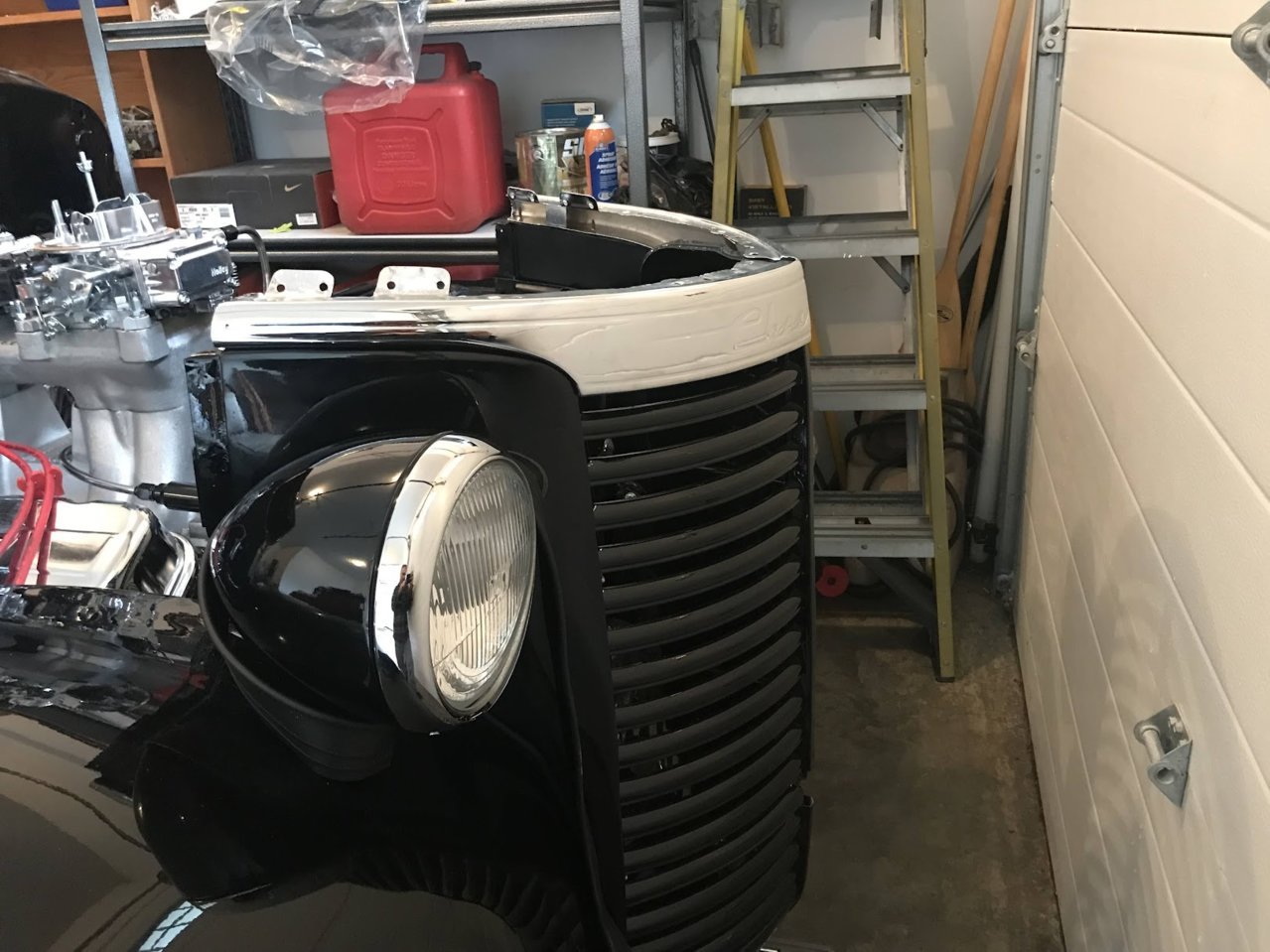

    Spent some time mocking up the rad and the grille pieces... Need to make some adapter brackets for the rad and will be raising the rad a couple of inches from where it currently sits.
