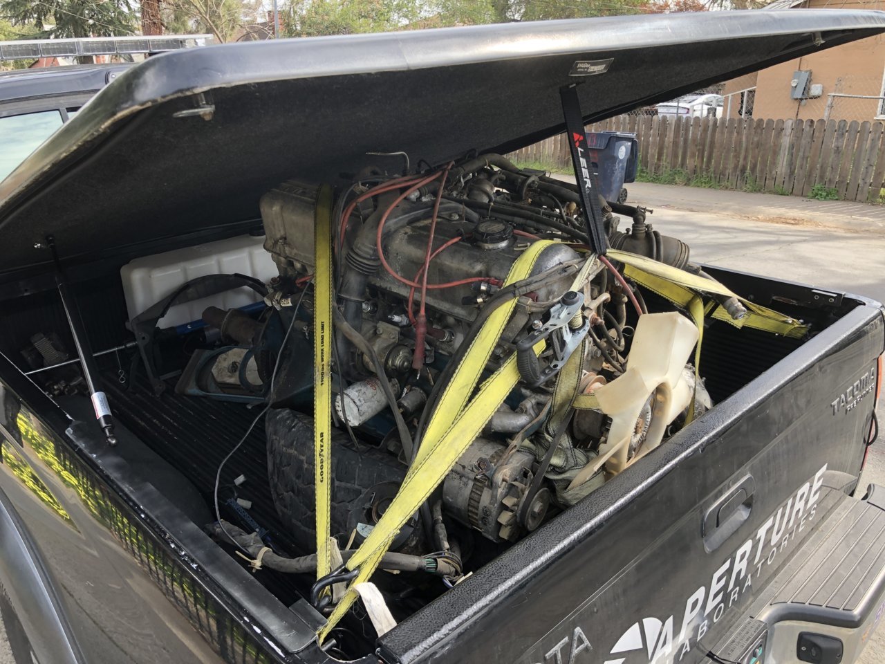

    Got the new L28 for the Datsun from a 1982 Nissan 280zx. Will start stripping it and cleaning it up at home. Has headers too!

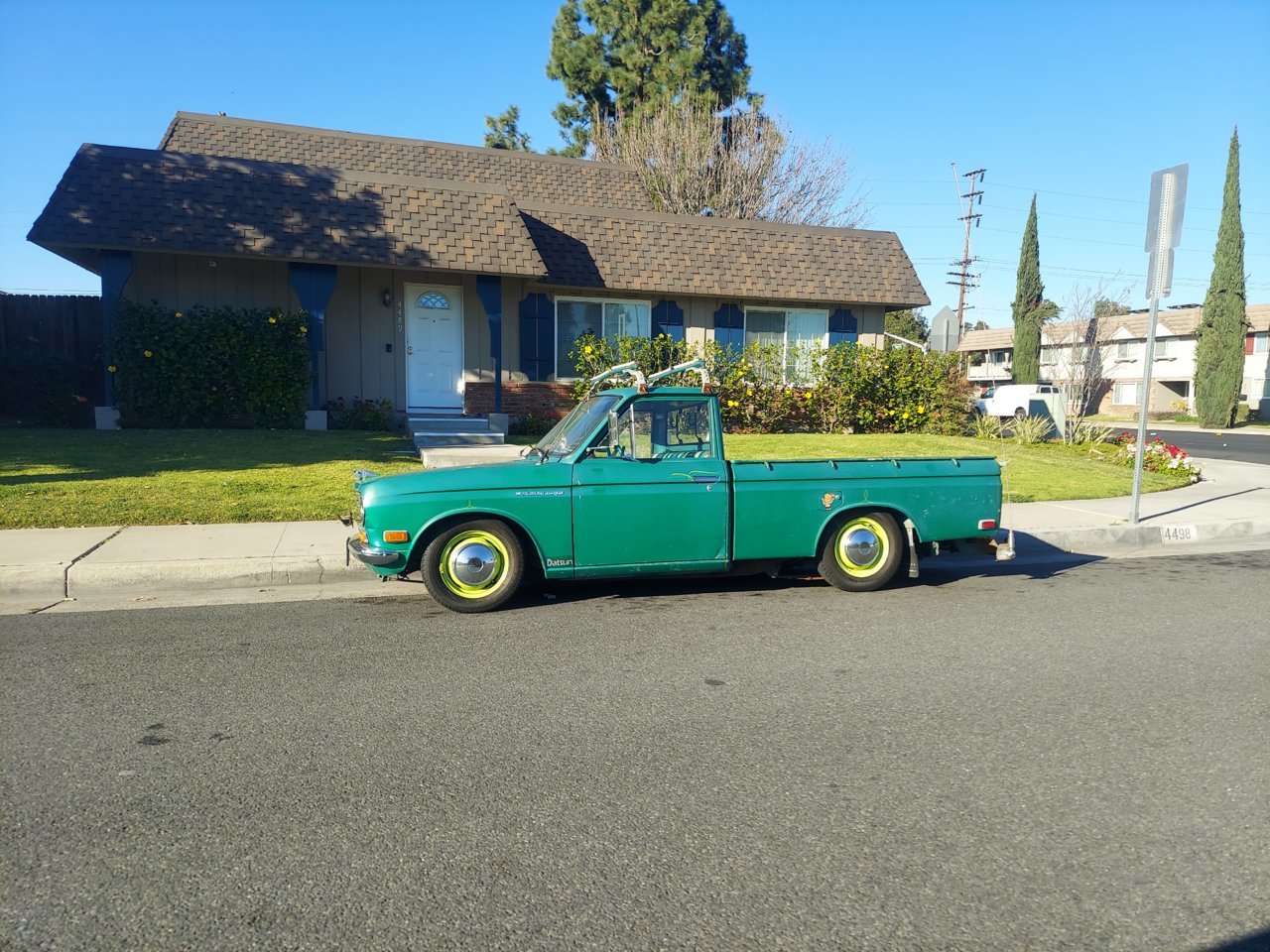

    Couple Datsun trucks I've spotted recently. Sorry if this is off topic.

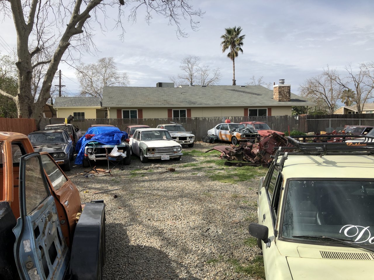

    They’re very cool trucks and use similar engines to the L28. The seller of my engine actually had one for sale.
    Wish I got it in the picture. But here’s all the other cars they had.

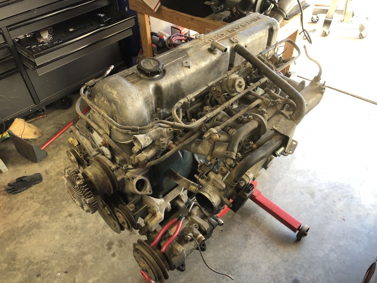

    It’s on a stand now. I’m at the point in the project where I’m staring at the engine hoping something happens.

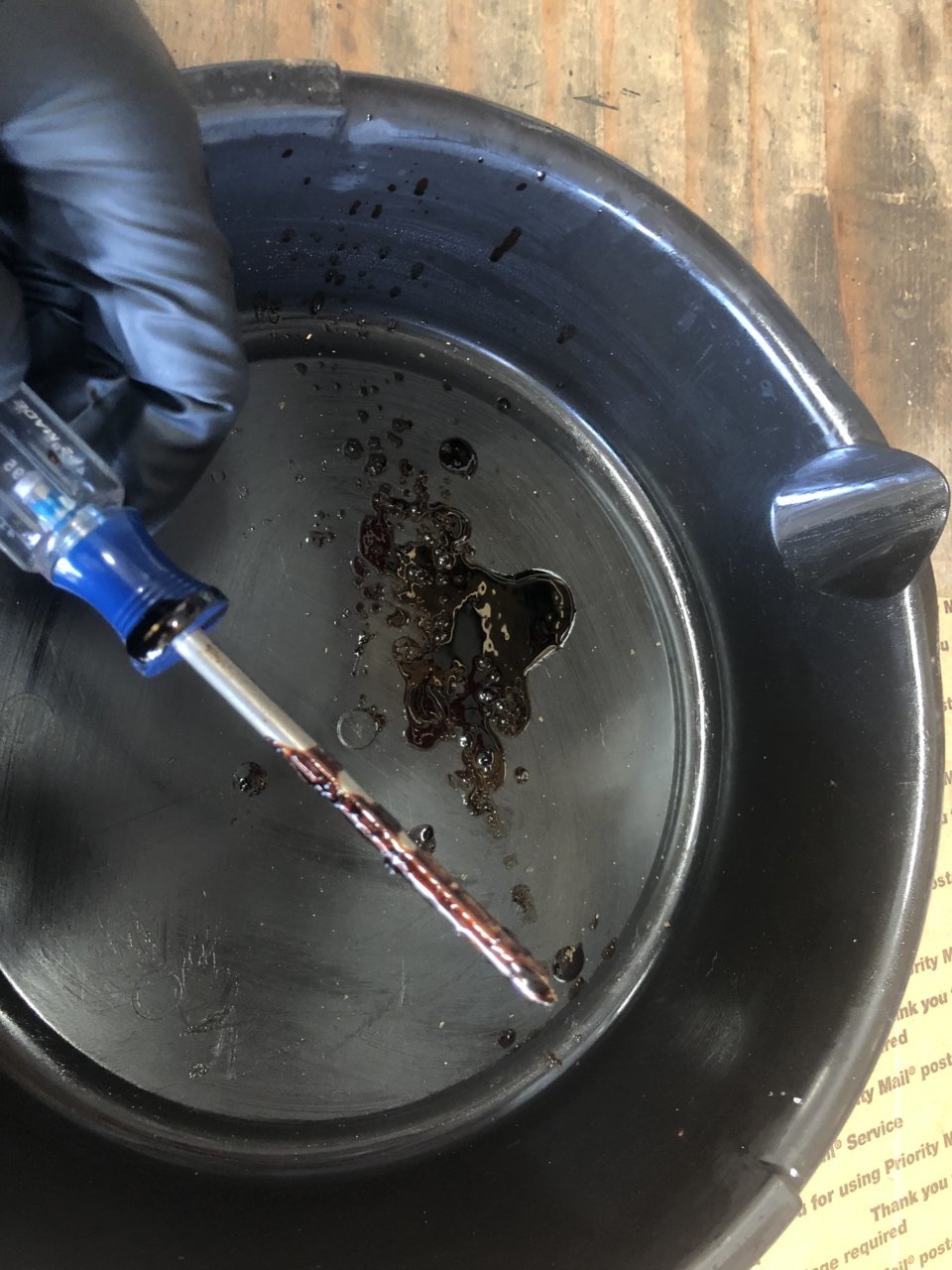

    Well, today I was curious how much has I had left in the tank. So I went to remove the drain plug. Remember, the last time this was at a gas station was in 1986.
    This is all that came out.
    And boy did it stink.

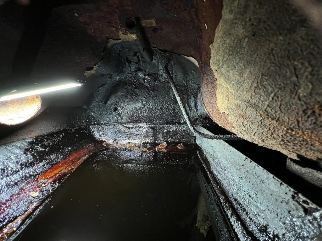

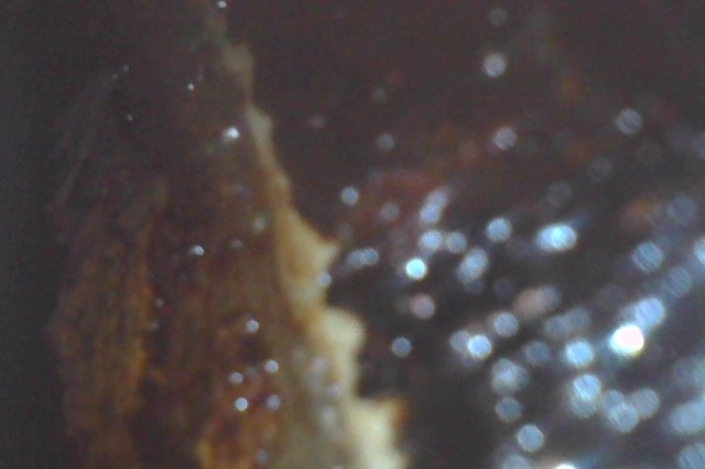

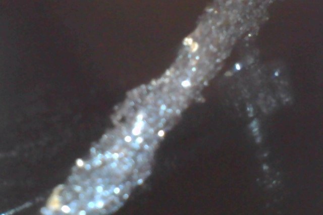

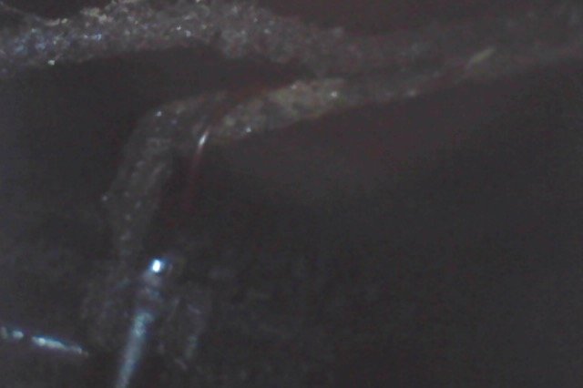

    Well, gas tank doesn't look good as I suspected.
    The tank was completely empty, which could mean one of two things.
    1. The original owner drained the tank in 1986 as a storage precaution
    2. There is a hidden rust or pinhole in the tank where all the gas leaked out the 36 years it was parked
    I am hoping for the former, although some moisture definitely got inside the tank over the many years it was parked because it looked like a real shipwreck in there. It's full of crud and corrosion. I am going to see if a radiator shop will acid dip the tank for me to clean it out.
    Here are pictures of the tank. I used my boroscope camera and made egress through the fuel filler neck. In the pictures, you are looking at the metal rod for the fuel sender float.
    Photo on 3-10-22 at 9.42 PM.jpg Photo on 3-10-22 at 9.41 PM #2.jpg Photo on 3-10-22 at 9.41 PM #3.jpg

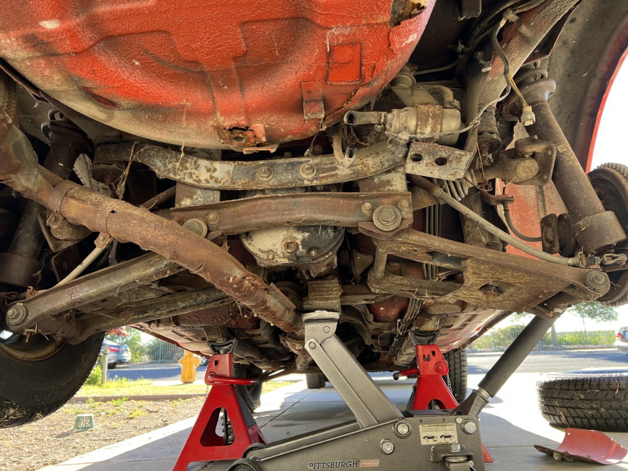

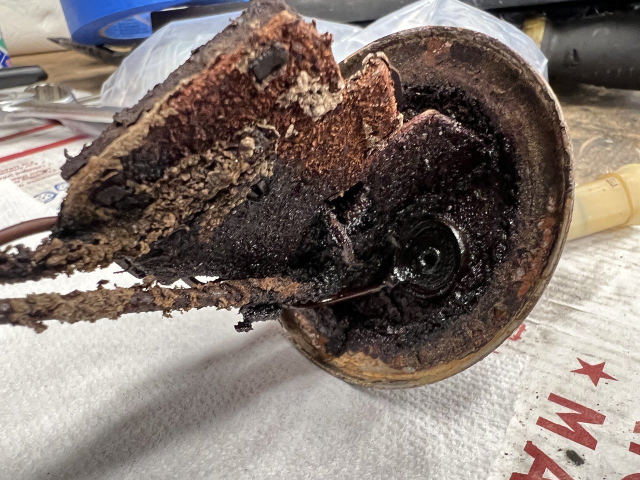

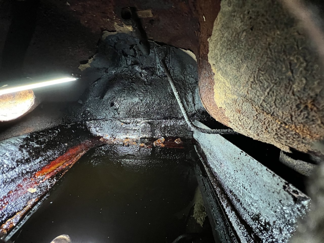

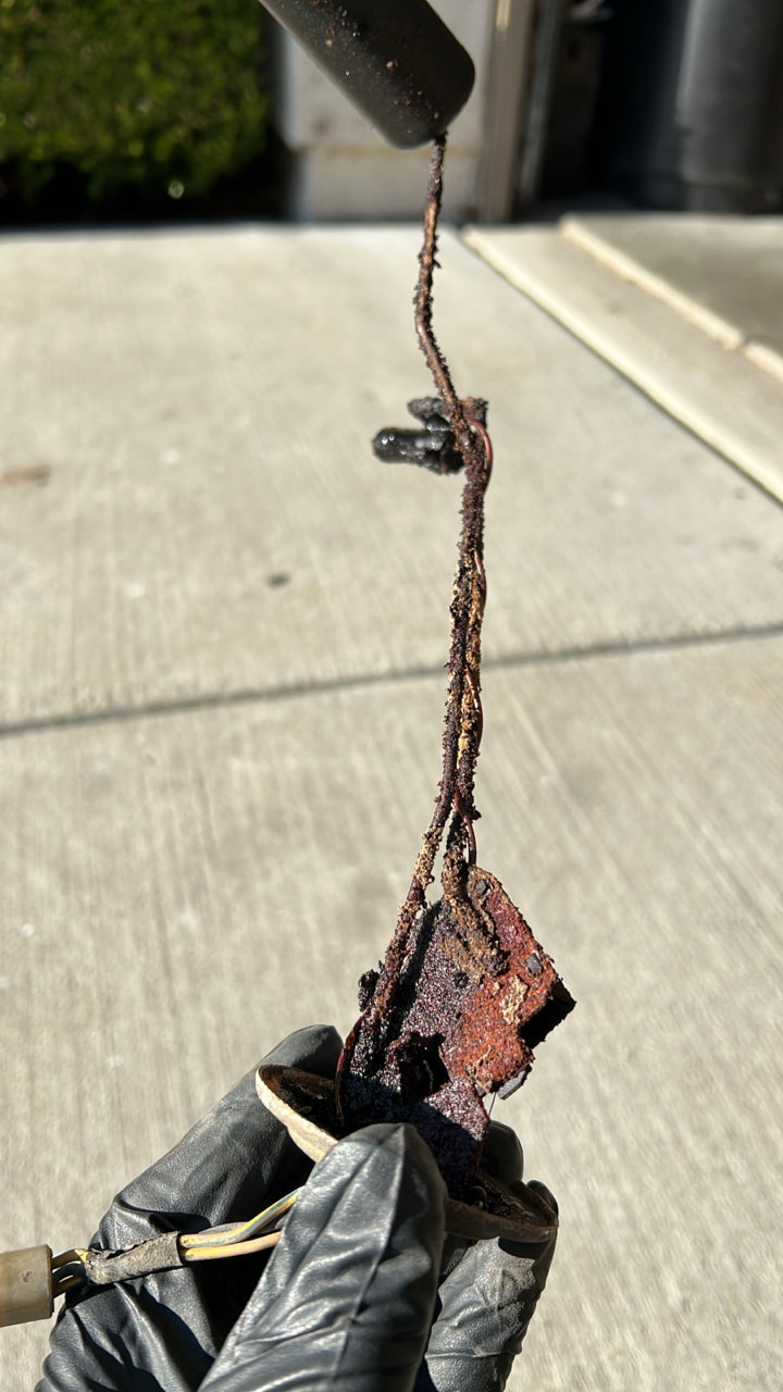

    Update! Took the fuel tank out, since I knew it was bad.
    I didn’t know it was this bad.
    Photo was taken through the hole for the fuel sender.
    Here is where the tank was. You can see where the worst of the rust on the car is, the spare wheel well.
    So the nice thing about American cars versus Japanese cars is that you can get a new fuel tank, for say a 70’s Ford, for like $60.
    Good like finding a new tank for a 70’s Z car. So I brought it to our local radiator shop to boil out and re-coat. The amazing thing is he looked at it for 20 seconds with no prior context, looked at me, and said “280z”. Now that’s a crazy skill I want to have, identify a car based on a non descript gas tank with no markings.
    Steves104x4 and GHOST SHIP like this.

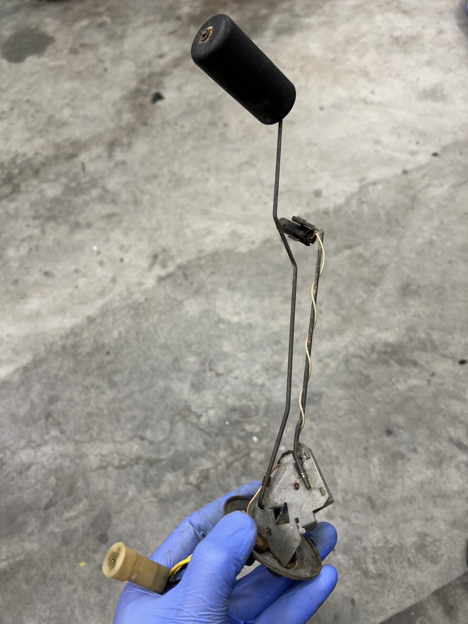

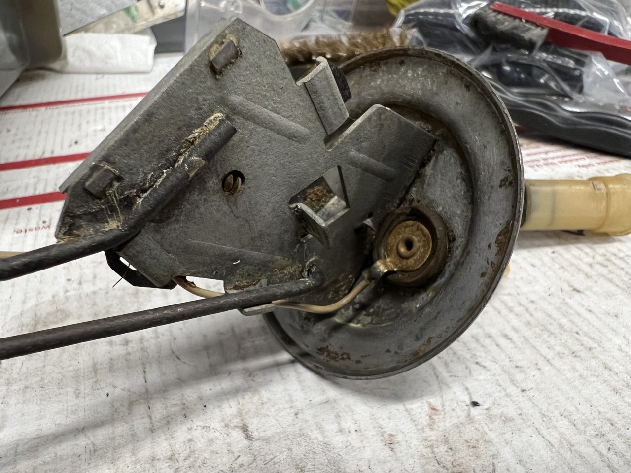

    This was the fuel sender. It made a miraculous recovery after soaking in rust remover. I tested the resistances of the float versus the FSM, and by golly, it was perfectly in spec.

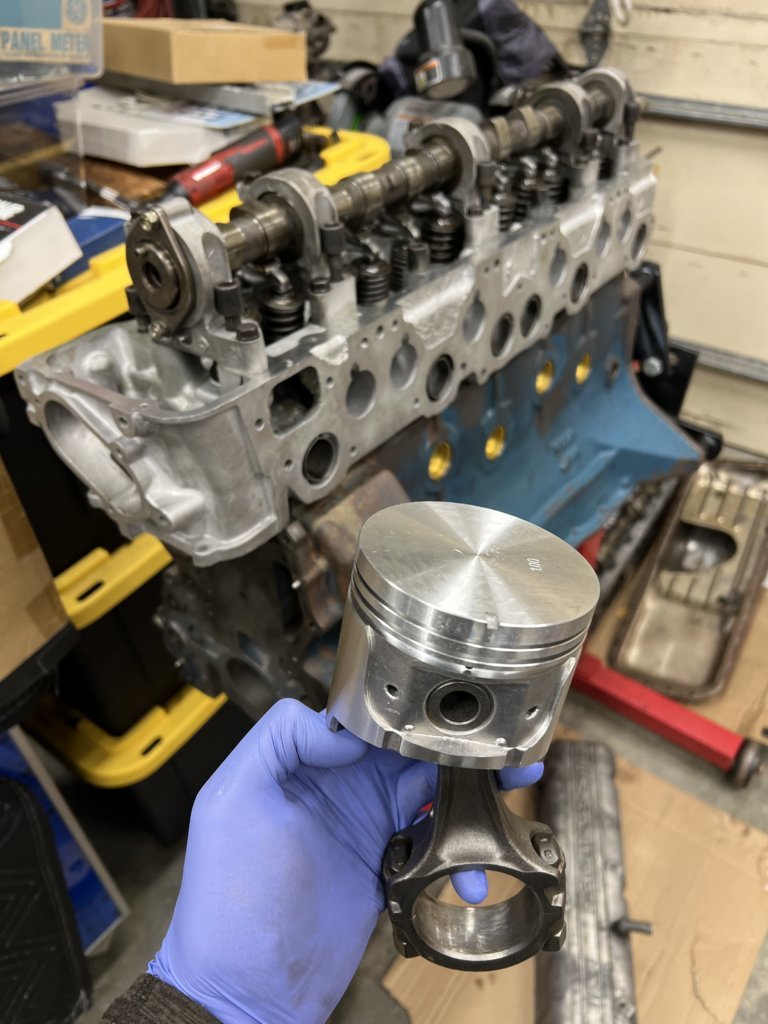

    Long story short, the engine in the car was too far gone. So I got one from a 280zx and had it rebuilt. Cylinders bored out 0.40”, crank polished, block dipped, head rebuilt, etc. I just got it back from the machine shop last week.

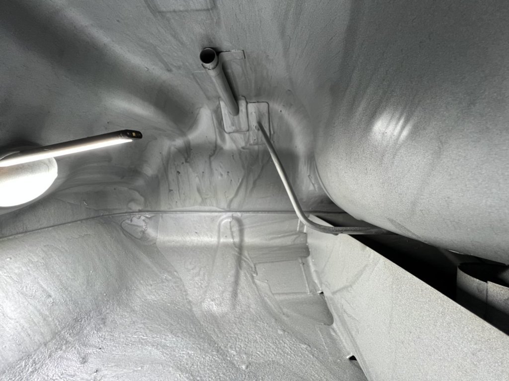

    Here’s a before and after of the gas tank. Shop did a hell of a job.

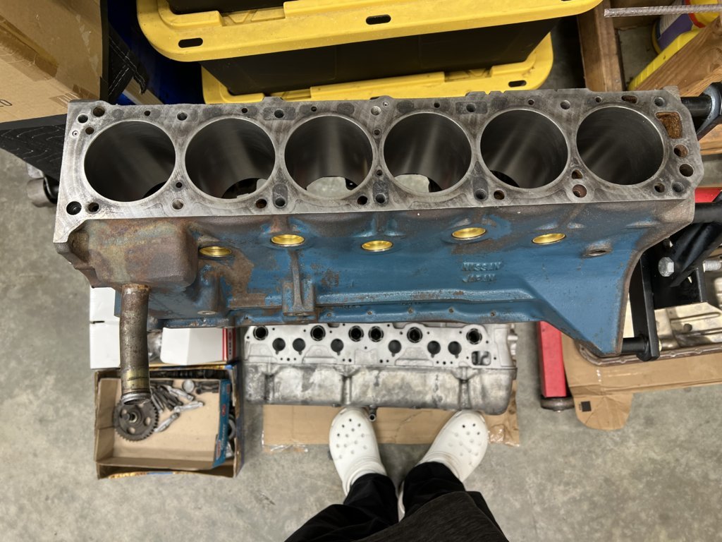

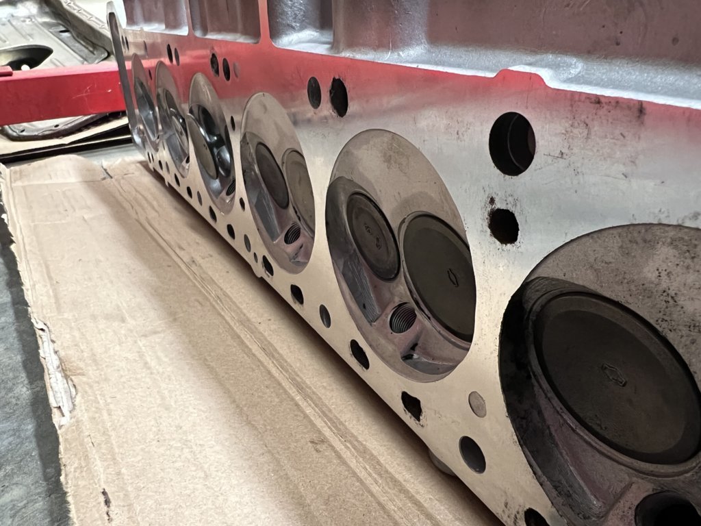

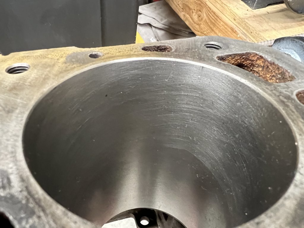

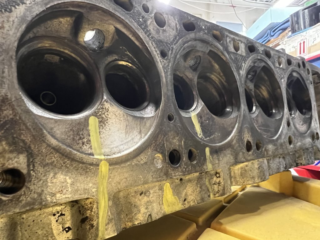

    So if you were paying attention, the L28 engine in this car is locked up. There was no point saving it, it was too far gone. So I bought another one from a wrecked 280zx.
    It had good compression - but that was the only thing it had going for it. Machinist called and said I needed a new head. He said this one overheated, and then was oil starved. The camshaft wore grooves in the cam towers from oil starvation. I tossed it in the trash.
    You can see all the cracks from when it overheated.
    They did a hell of a job boring out the new block and rebuilding the new head I brought them.
    Yes I am wearing crocs. No you’re not cooler than me.
    Cylinders bored out 0.40” over. That’s how bad they were pitted from rust.
