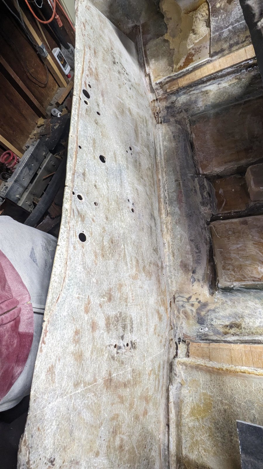

    Correct, the stock ones just had a 4 inch tall contact patch with the top of the transom. These will help to keep the transom straight by transferring some of the load into the bottom of the transom instead of all the load being concentrated on the small surface the old ones had.
    Here is the old beam, there was actually a gap of about an inch between the old beam and the transom, so it was held on by that terrible fiberglass work.
    I left them empty, I will be cutting 1 inch holes near the top that I can put a hose down to suck any water that might build up in there, but also the open air should keep moisture from building up in there due to temperature changes.

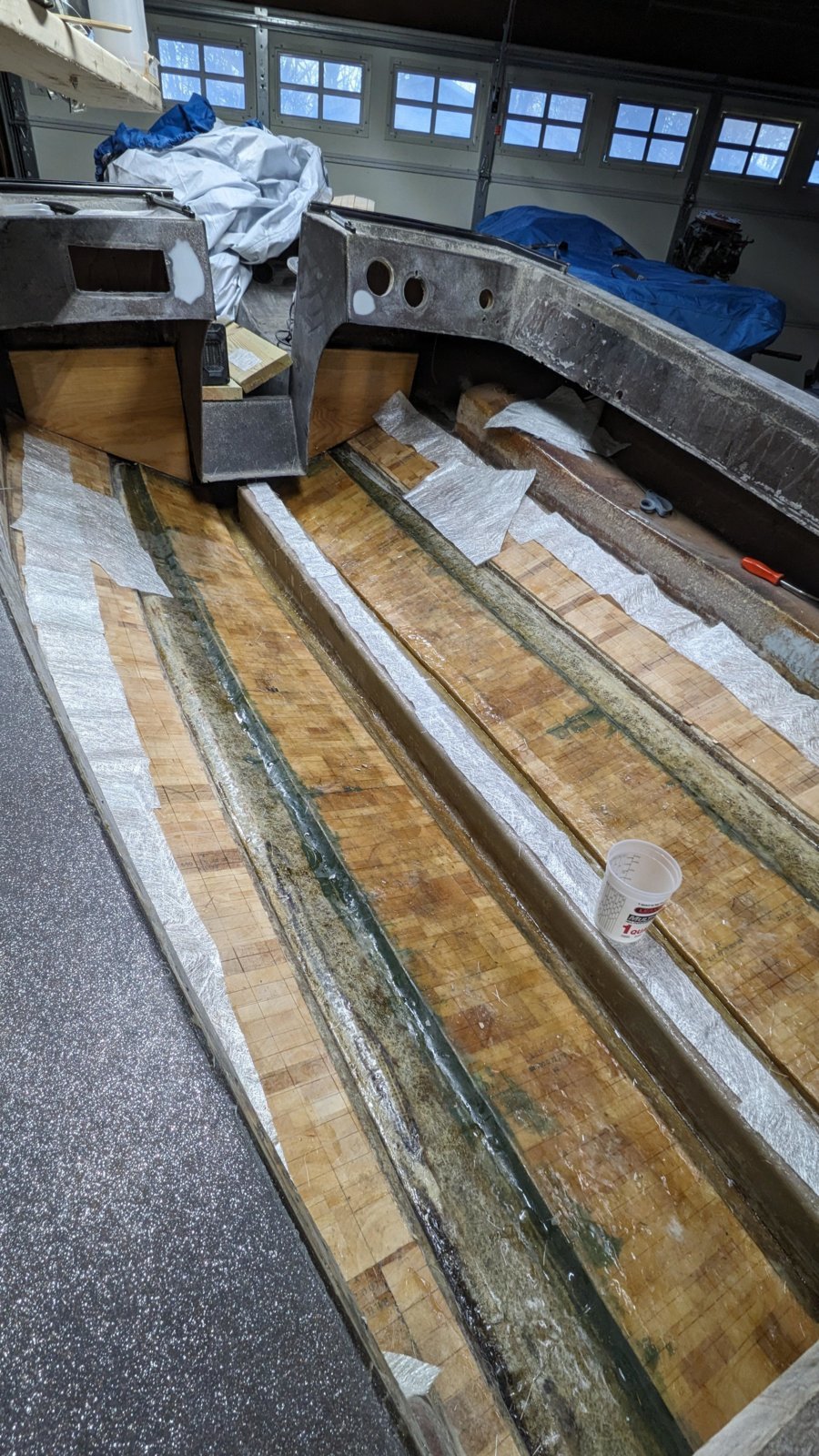

    Playing around with ideas for glassing the support beams in at the transom. The beam cuts into a section of the float pods, so the backside is inside the pod and I cant get to it. Originally I was going to wrap the beam in glass, put it in and then smooth the glass into the pod. But I think I have a better idea, I will cut another hole in the float pod, further forward from the beam. This will let me reach in there and glass the backside of the beam to the transom and float pod, this should give me a much better bond for the beam, I will be able to glass both sides of the beam to the floor and transom instead of just being able to glass one side of the beam to the transom and floor.

    Did some trimming on the transom cap, fully committed now to the low profile splashwell. I am using just the top of the transom cap for its body lines, then the wood (not the wood in the picture) will go right under the cap and link to the transom, I will be cutting the splashwell along the black lines I drew in there so the wood goes right under the top of the hull and rests in its own structure.

    Outboards of the time had clamps that needed a deep splashwell as they went up over the top and then down into the splashwell. Newer outboards can bolt to a flat surface, so you dont need that deep splashwell, and for the time being I will be using my tilt and trim plate, so I dont need the splashwell to mount that either.

    All trimmed out, Now I just need to finish the support beams. So that means cut out the last foot of beam up by the dashboard, then grind and clean up the mounting surfaces, clamp what I have already in place and then measure from the dash to the end of my beams. Then I can cut out those and attach them to the ones I have built already. I will end up with two 10 foot long beams that will be a absolute nightmare to install....

    Well that was a pain in the ass.... getting the last 10 inches of support beam from under the dash..... But I got one side out, cleared the foam from the area on both sides and measured the new beam section I need. Looks like 42 more inches of beam and it will be done. So tomorrow I will measure out a template beam from scrap. Get it all fit and perfect then I can transfer it to the good wood with the router.
    Then I get to connect the two beams together, I was thinking of doing finger joints, but I also want to do something simple and just laminate a little 10 inch section over the joint with some resin.

    I actually ended up doing a little bit of work on the front today, I still needed to smooth out the patch I did in the floor, so I was doing that. I need to get a drain to put in there still (see last picture of red boat), but Im not too concerned how smooth that bottom area is because it will be covered in carpet anyhow. Speaking of carpet, I was at menards the other day and they had a reminant of black marine carpet, 10f X 6f for half price. I grabbed it and put it in to see how it looks, the black looks really really nice in there.

    Spent more time today grinding at the gunnels. One side is 90% done, I just need to grind the upper part in where I spliced in the rear caps.
    But after getting the mounting surfaces cleaned up, I put the support beam back in again for one more test. Everything lines up really well. The beam butts right up against the inside of the rear caps and pulls everything inline.
    So now I am off to start making the forward section of the beam. Going to use a shiplap joint to link the two sections of beams together.
