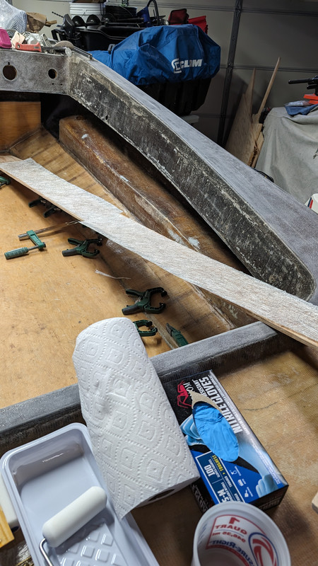

    Bonding the beams on right now! Once they are cured I can go back in and bond it to the transom, float pods and then lay more glass along the back of the beams. I also need to bond the beams to the front of the bulkhead too.
    I used old engineered wood flooring as a backer to hold it tight and smooth.

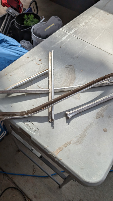

    Also I started removing the rub rail on one side. Its riveted and glued every 4 inches.... such a pain in the ass. Also I found a screw sticking out of the side of the hull... it wasnt holding anything but a tuft of carpet.

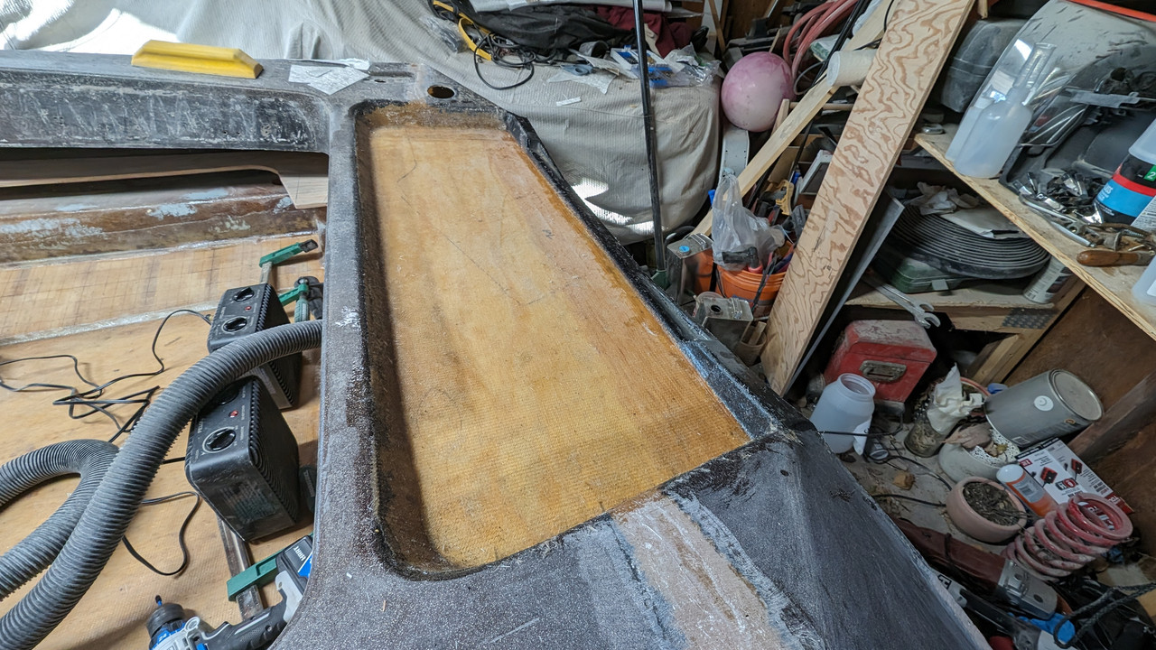

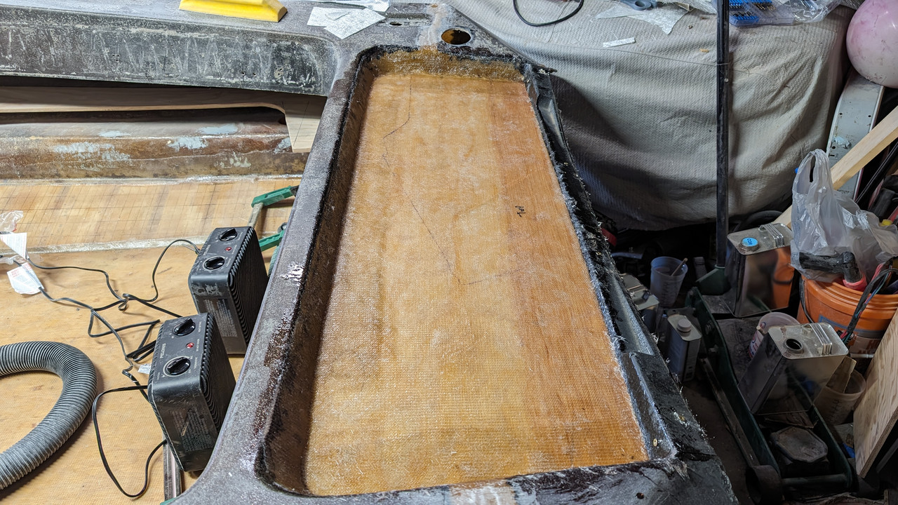

    ok there we go. floor and center of the transom is glassed with 3 layers of 1808. I need to the the right and left sides of the transom thats under the caps.

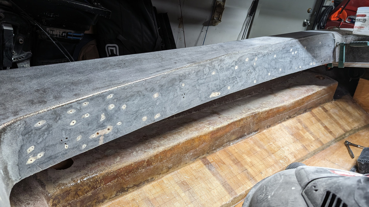

    Alright, now on to tonights pictures. Holes, lots and lots of holes (143 total). In 40 years the amount of things that got screwed into these gunnels is ridiculous.. The big holes (first picture, left side) got patched with fiberglass first. All the rest of the holes will be filled with kitty hair, its a fiberglass reinforced polyester filler. Its very thick and has small fibers in it that results in a very strong hole patch.

    143... :frusty:
    The upholstery must have been a fair amount, probably the regular groups of 3 down both sides, the rest though, damn...
    The right rear corner especially.
