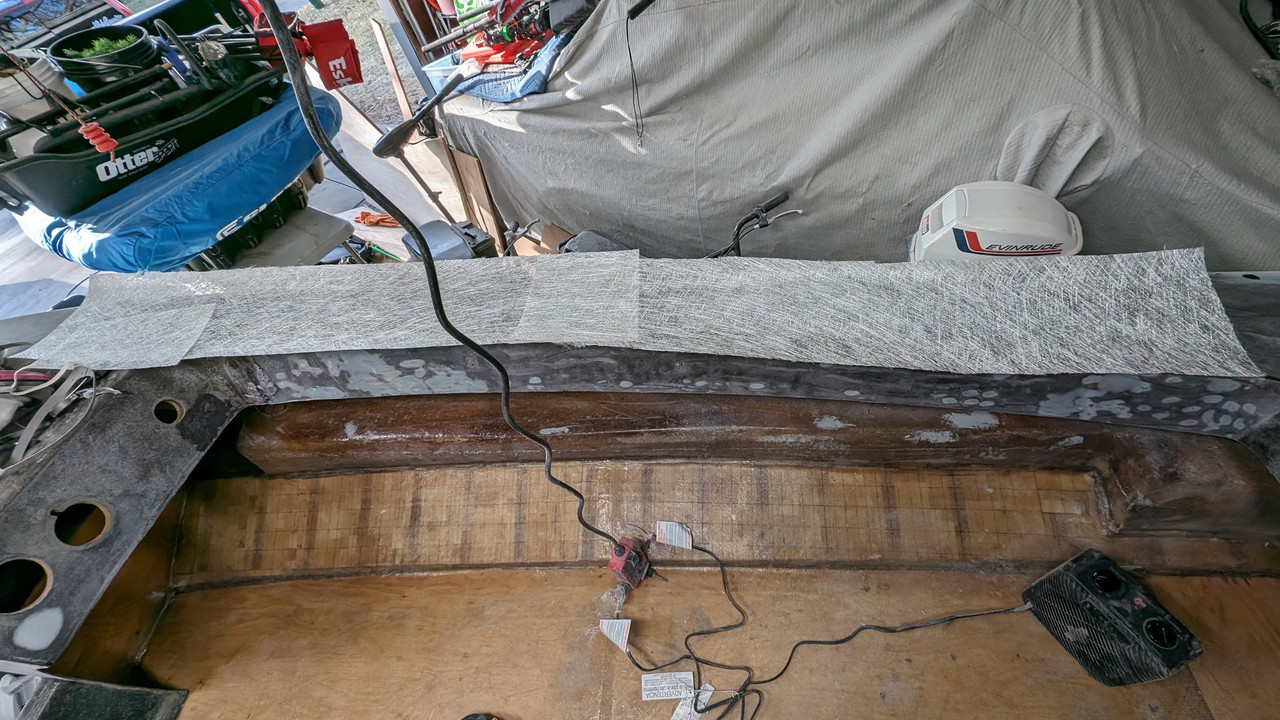

    Staging the fiberglass for the backs of the main beams. This is pretty light fiberglass, so there is a good chance I will have to go over it again with another layer, but being light it will stay up against the panel in larger sheets. So while I have to hang more of it, it will be easier to hang.
    Also bonding the cleat backers to the hull. Used thickened resin and screws through the holes for the cleats to pull them tight. Once cured, I will glass a layer over them.
    I also need to order a through hull fitting for the bilge pump to fit that big hole Its slightly larger than I would like for it to be, but im not going to fill it and redrill it. I will just get a fitting that fits close.

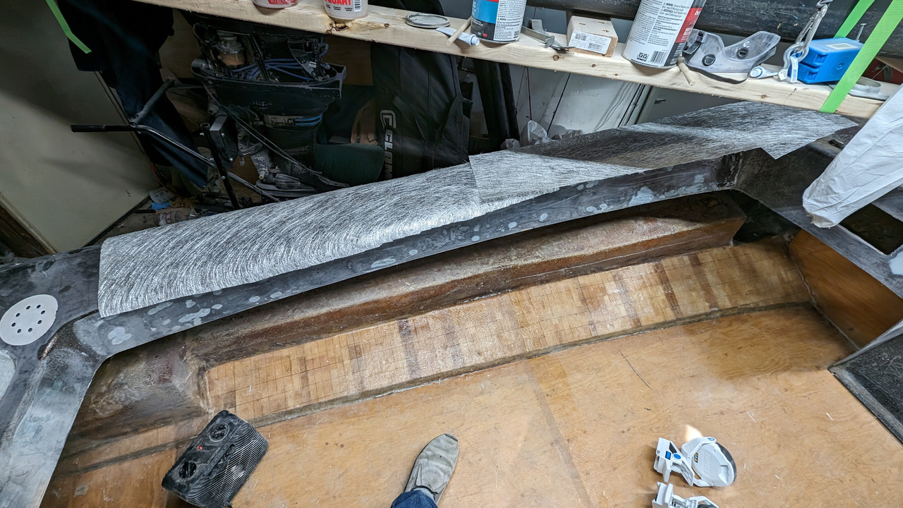

    Here is the 1808 fiberglass thats holding the beams to the front bulkhead, there is also chop mat on the other side and a mixture of loose chop, cabosil, and resin bonding the surface of the beam to the surface of the bulkhead.
    Also the fiberglass mat going all the way down the beams to the back.
    I think this pretty much concludes my fiberglass work in here. Im going to do one last inspection tomorrow and if all is good then I will vacuum it out really really well. Once its all super vacuumed out, then I will go ahead and lay down plastic wrap to try to keep the dust out while I sand the rest of the hull.

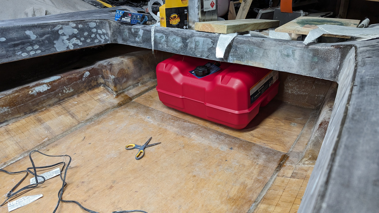

    Fuel tank showed up today! Also the rear drain tube. Seat bases will be here later.
    But fuel tank fits pretty perfect, I can get to the bilge to run the hose out of it. Plan is to put the fuel tank on one side then the batteries on the other side.
    Trying to decide the best method to get to the fuel tank to fill it. The backrest of the rear seat will be covering it up, so im thinking either making the rear seat a split 50/50 so I can remove just the section covering the fuel tank, or putting a fuel filler spout on the hull and routing a tube down to the tank. I like the idea of having the fuel filler on the outside of the boat so I dont need to spill gas on the seats or carpet.

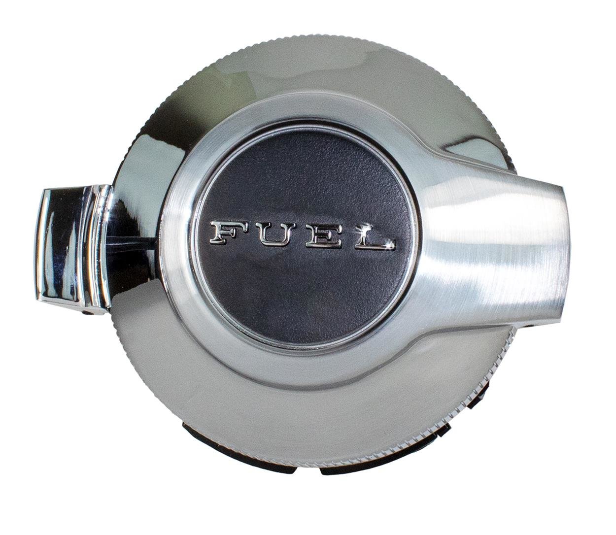

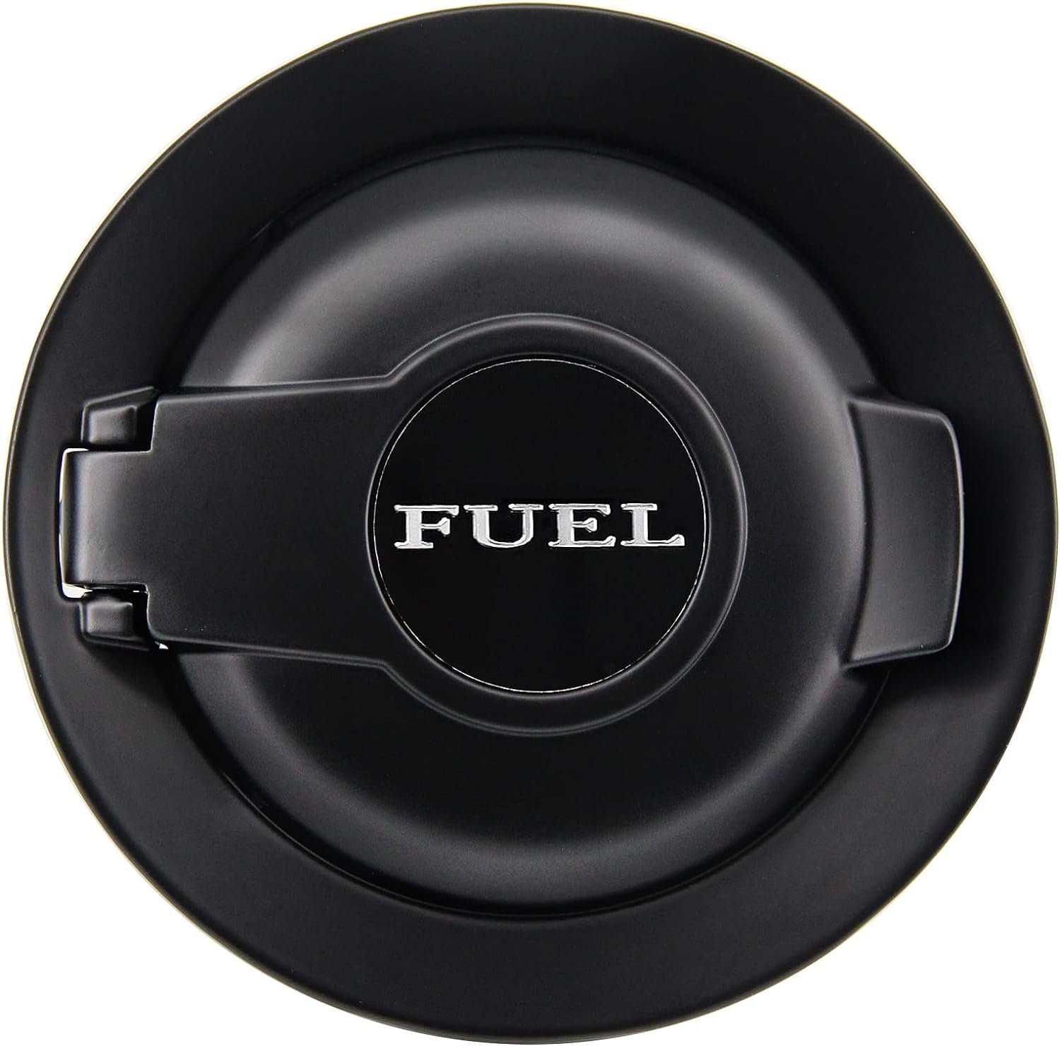

    An external mount fuel filler would be a nice touch.
    My first thought was a 1970s Dodge Challenger:
    Thinking about you black/gray theme maybe a 2020 Challenger would be more appropriate:
    I don't know if either of these are "boat grade" however the modern car fuel systems are all sealed up so perhaps yes?
    5nahalf[OP] likes this.

    I have a 1973 challenger :) Me and my dad restored it 27 years ago. For a external one, I need to just make sure that I put it somewhere water cant flow over the top of it.

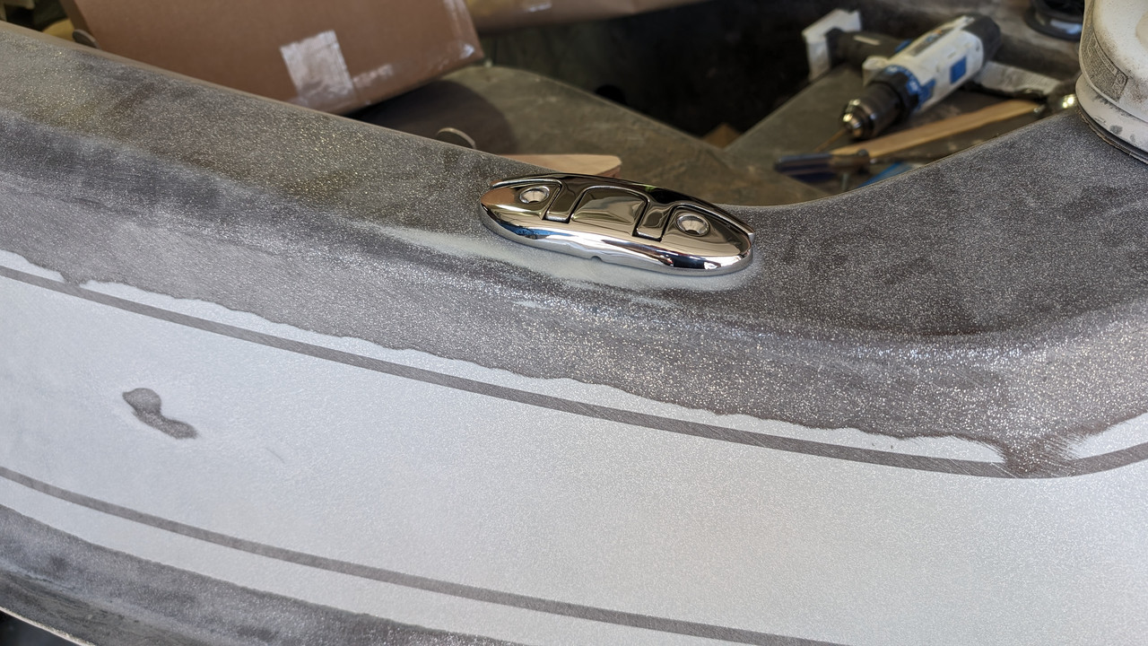

    Got a couple packages today, switch panel, cleats, hatch covers, fuse boxes, drain tube tool, and sotme marine glue.
    I also grabbed some battery trays from fleetfarm. Got 2 trays, a group 27 and a group 24. The 27 is the starting battery, the 24 will be for radio and lights.
    The cleats are pretty neat, looks like they will fit pretty well too and keep the kids from catching their toes on them.

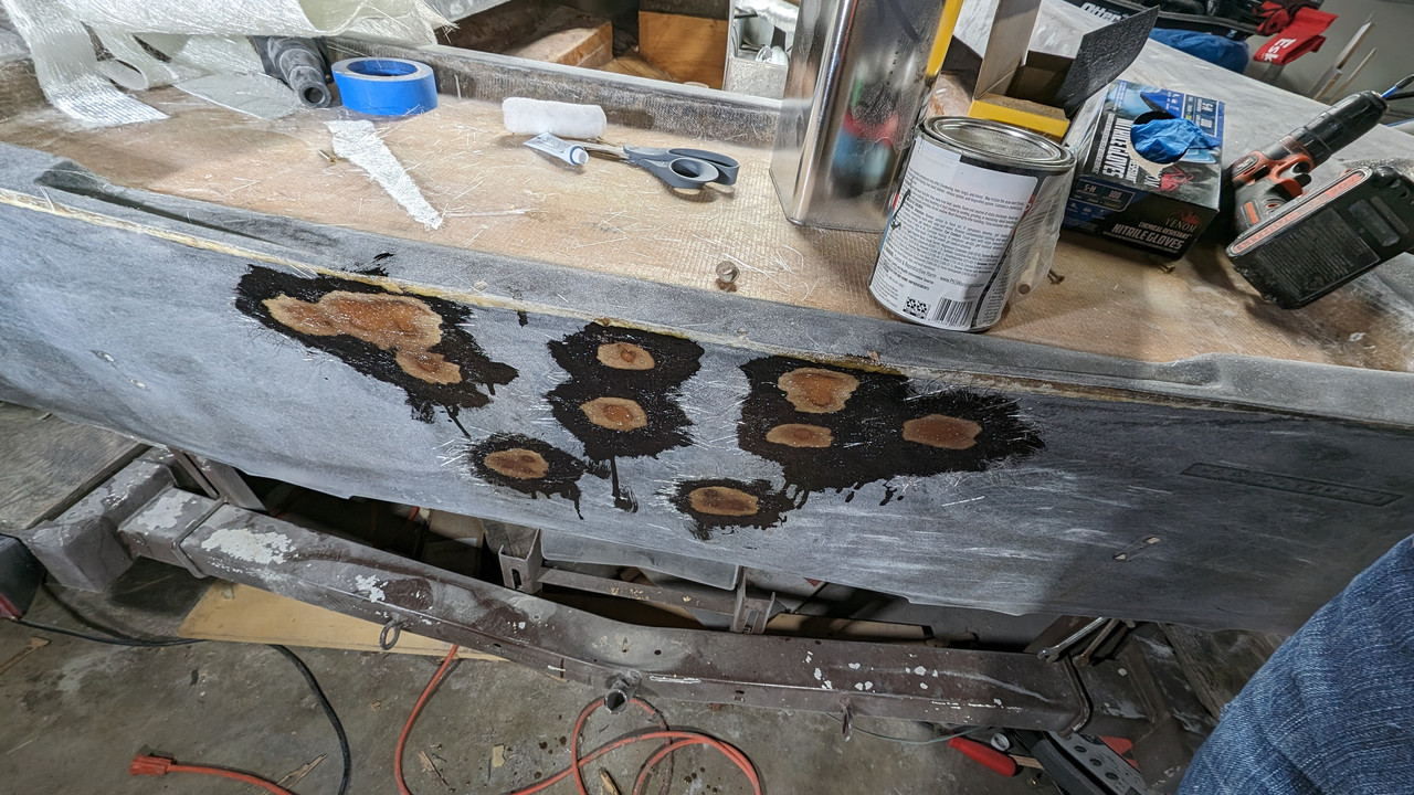

    Started patching the old holes in the transom skin this afternoon. I had completely forgotten about them until recently. Each one is filled in with like 8 layers of chop mat, then I will go over it with the grinder to flatten it all down, then block it and see how close to flat they are. Might have to put a little filler on them, but I am hoping to of gotten them built up enough that I can just grind them down flat.
