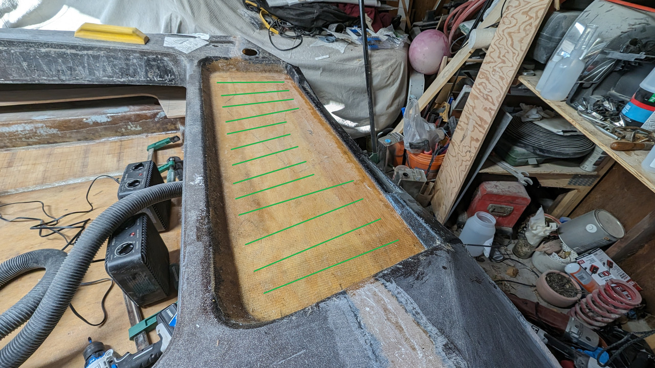

    To give an idea for the teak strips on the back, I made this little photoshoped picture, the green lines would be the teak beams, each one is 3/8 inch thick, and 7/8 inch wide like the factory front teak is. I would have 2 options, either side to side or front to back. Either way, I will be making it from cheap wood first to make sure I even like it before I dump $30 per 5 foot beam. Im not sure what version I like better. I think B would look better though.
    A
    B

    I vote for B, it emphasizes the low, wide, muscular look if that makes sense. :muscleflexing:
    Also I can envision where someone might put a foot on the splash well under different situations so it seems the cross orientation would give a better grip.

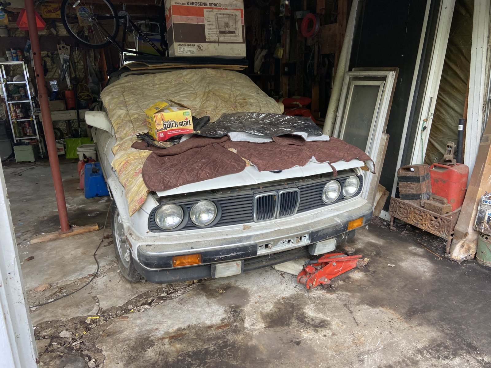

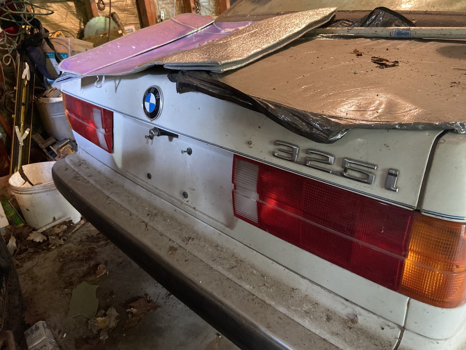

    Nice work on the boat…I’d imagine that much time with resin would have me loopy.
    This BMW is not particularly special but found it curious that it’s also a ‘91. My spring project is to dig it out of my parents garage and go through it, probably to sell.

    Looks like you have the pre-facelift car, its got the small tail lights, different rear wheel arches and the US spec bumpers (diving boards) Thats the perfect car to do a euro bumper conversion on as they bolt right on.
    I have a bunch of 1980s "coke dealer" body kits that would fit that car.

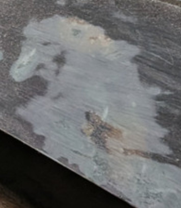

    Sanding mark looks like a horse head to me. :notsure:
    5nahalf[OP] likes this.

    Sep 22, 2018
    #267058
    11,000
    Erik
    Minnesota
    2018 Inferno Longbed
    It does look like a horse, lol
