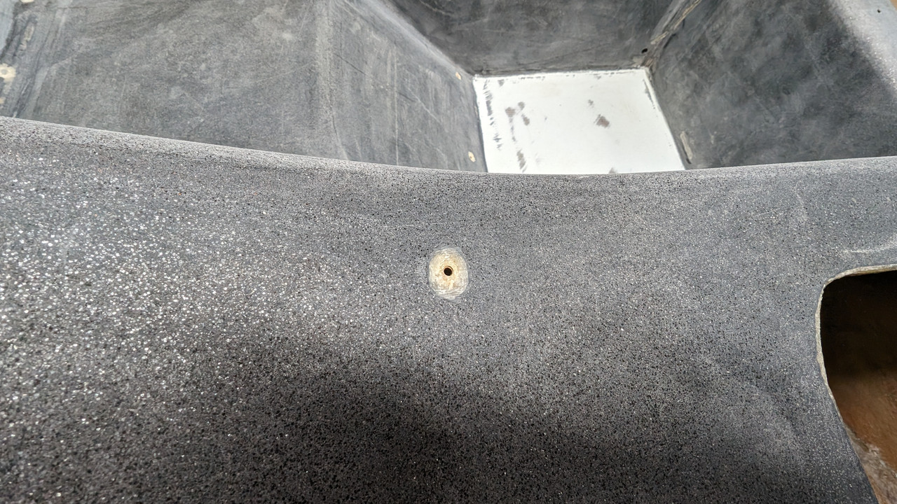

    Alright, all the holes are now filled with cabosil and resin. After my daughters dance class tonight it should be cured enough for me to put filler right over the top of it. Im not planning to sand the cabosil and resin before putting the filler over that top, since its laminating resin it remains tacky unless you seal it over, and thats bad for sanding. Putting the filler right over the top will allow it to cure all the way hard, and will let me get away with only blocking the area once.
    On a wiring related note, my ground blocks show up tomorrow, so I can start planning that all out soon too. Im going to run extra wires up to the front dash for a tach and fuel gauge. I plan to add those at some point, so might as well make it ready to hook up right away.
    RustyGreen likes this.

    Quick shot of the front holes filled in with thickened resin before I take my daughter to dance class.
    Rezkid and RustyGreen like this.

    Alright, the resin was not solid enough last night to fill, but it is semi solid now. So its just tacky enough to chemically bond with the filler, but solid enough to keep its shape. I put the heaters in the hull to run for 2 hours then lunch I will get out there with some filler to clean up the holes.
