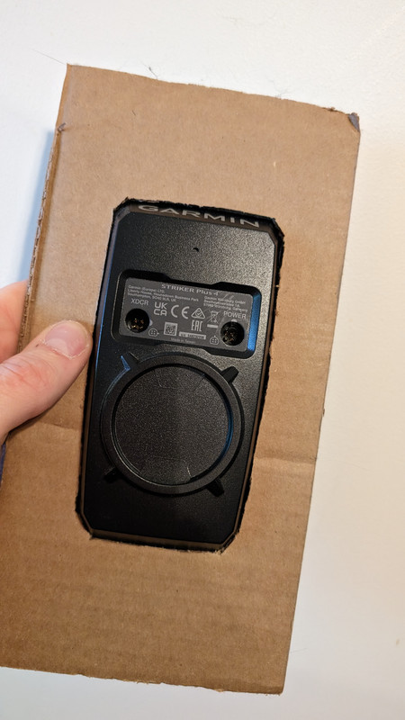

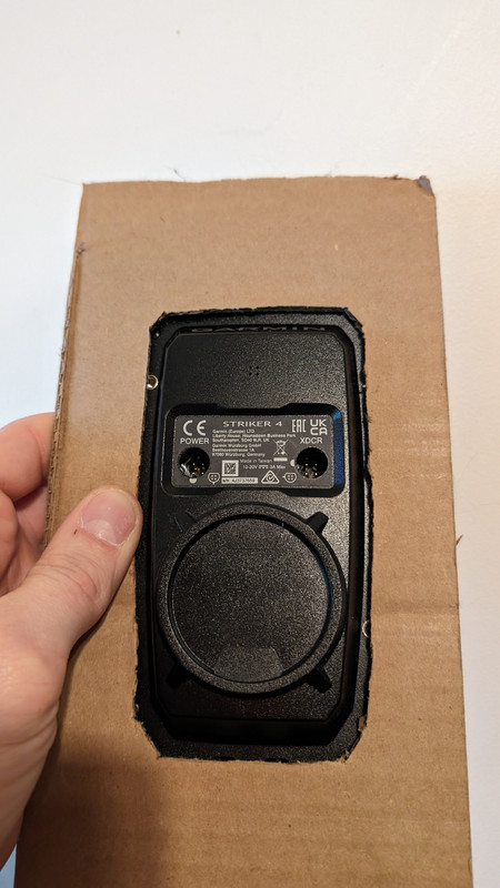

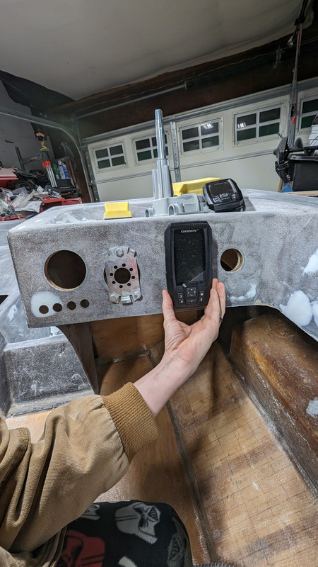

    I remembered I wanted to put a fish finder on the boat. Not a super fancy one, but something that will give me depths, water temps, and just basic info for the water I am in. I have a bunch of these garmin striker 4 units laying around, two are normal striker 4s, one is a striker 4+ and the other is a striker 4cv. The 4+ and 4cv are both taller than the normal 4s are, the 4cv has much better resolution than the 4 and 4+ models, but it has a massive transducer that sticks off the back of the boat. The 4 and 4+ have small transducers that wont get in the way of anything on the back of the boat.
    These units also have the ability to be semi-flush mounted, so I want to mount one into the dash to the right of the steering wheel. Im not going to use the 4cv due to the size of the transducer, so I get to choose between the 4 and the 4+. The 4 fits really nice with ample space on the top and bottom, the 4+ fits perfect into the allotted space, but im not sure if the space on top and bottom will look funny. So, I am going to make a template for the 4+ and see how the regular 4 fits into it. If the smaller unit fits the bigger units hole and still cover the hole then I will probably just cut the bigger hole so I can swap them to see what version I like better.
    Best to do this stuff now before gelcoating, if I end up hating it then its quick and easy to fill in the hole.
    Striker 4
    Striker 4+/cv
    Backside of striker 4+/cv
    This is how the last owner had a striker 4 mounted just on top of the dash.
    RustyGreen and Front sight like this.

    Showing how semi-flush the unit sits on when mounted. Also looks like the 4 model in the 4+ hole is a no go as the screw holes are on the inside of the cuts so screwing it on securely would be a bit of a pain.
    So, I guess I need to decide what version I want in there. I did order the flush mounting kit for both units. They were $10 each, comes with template, screws, and gasket. That should be here in a few days.
    The 4 and 4+ are functionally the same, just one has a slightly larger screen. So I wont gain or lose anything by choosing one over the other.

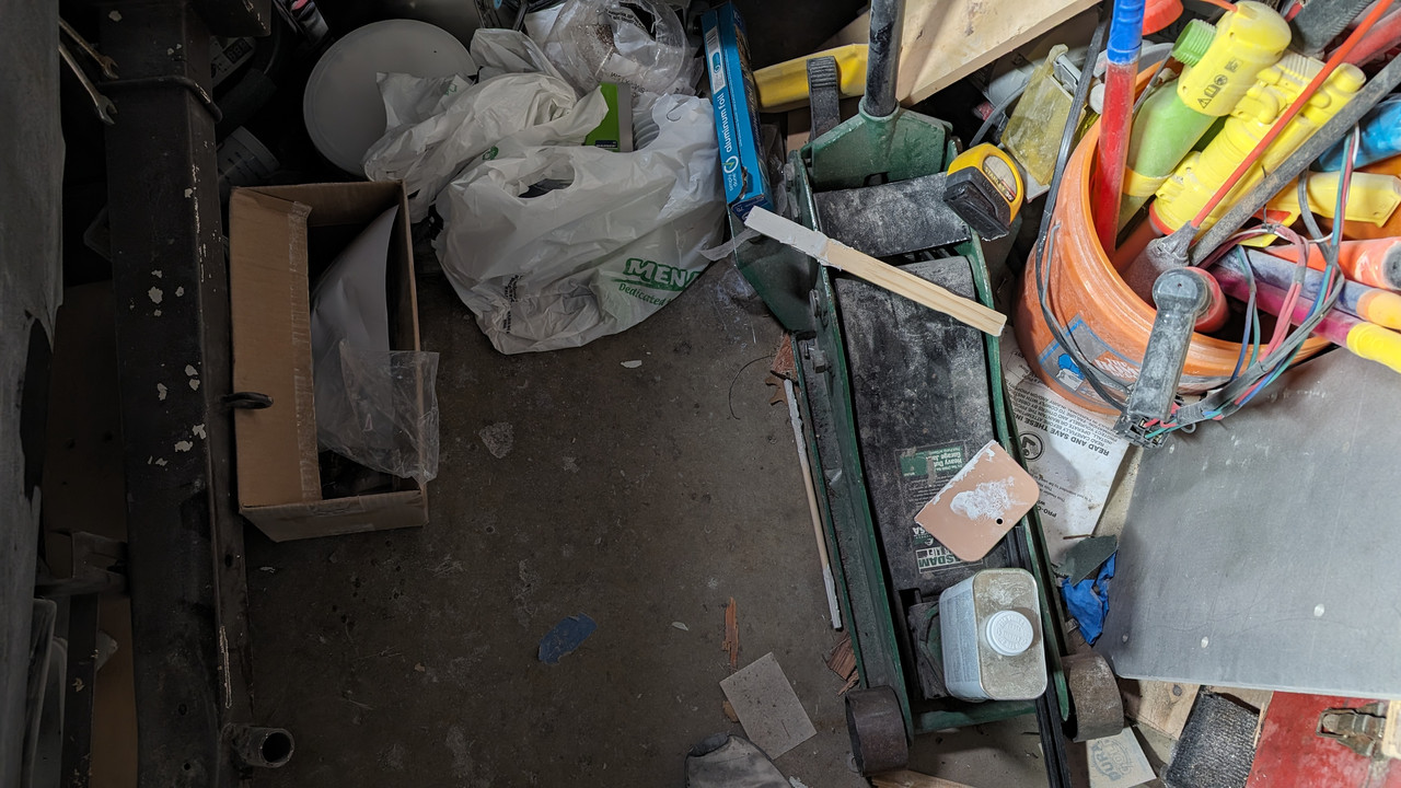

    I did put another layer of filler on the splash well in anticipation of having the sander going, but I screwed up by mixing the filler right there on the splash well, so it ended up giving me a 5 inch square blob of uncured filler. I scraped out the bad filler and blocked the whole thing by hand, then mixed up another batch of filler, I put a skim coat on the whole thing, then using my large putty knife I was able to fill in the remaining low spots I found after blocking. I've got the heater running right at the splash well right now, hoping to be blocking it tomorrow afternoon then finishing the sides going up the splash well.
    This is the floor jack I landed on, there was a tub of fumed silica (cabosil) right next to it. Just glad I didnt land on that as it would of made a cloud of toxic particles around me.

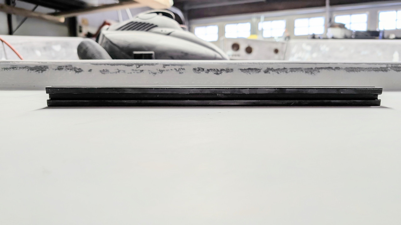

    Blocked down to fiberglass, still some slight low spots on the left and right sides. So I will fill those along with filler on the sides of the splash well to smooth that out. I blocked a little bit of the rear corners, those were actually pretty wavy from the hand blocking, but that makes sense as its hard to get perfect lines with the hand block. You dont have as much control with the hand blocks as you do with the air powered one.
    Im excited to get the whole boat blocked with this thing, if the lines are perfect, the gelcoat can be buffed to a mirror finish with no waves in it.
    Checking the straightness with some aluminum extrusion, dead on straight!
