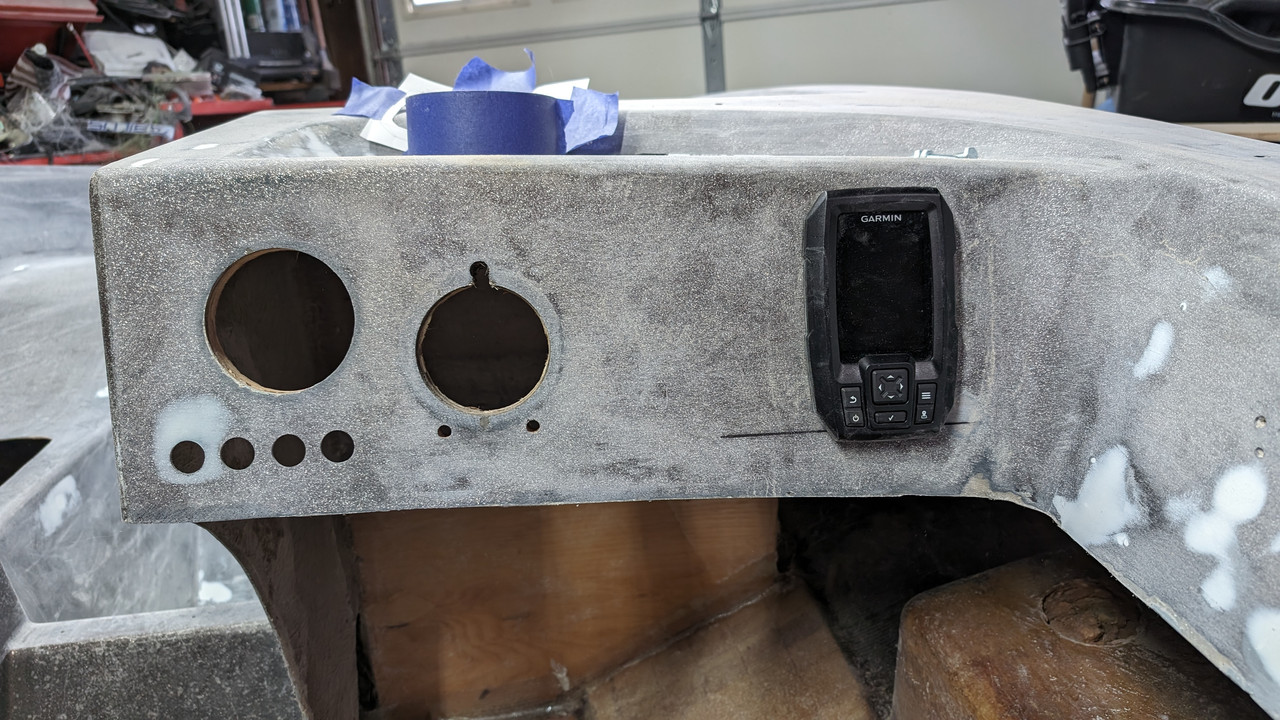

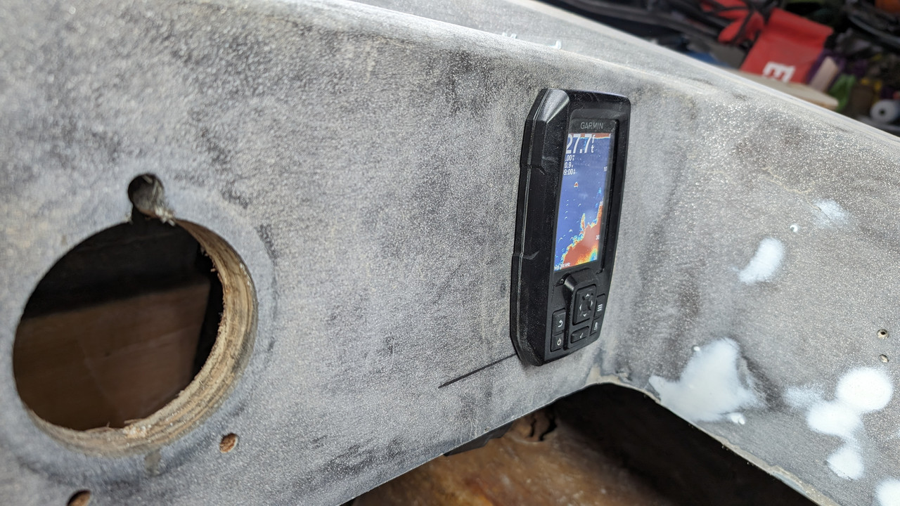

    Testing out the templates, the smaller unit just fits better, the bigger one gets a little too close to the edges. But while testing out location I decided to put the unit where the voltage gauge hole currently is sitting. This will let me put 4 smaller gauges to the right of the steering wheel instead of being stuck with just the single small gauge on the right right.

    It looks kinda crooked due to how the bottom of the panel swoops down, but its level with the side of the stairs. I think once the black gelcoat is down, it will blend in more and not look tilted.

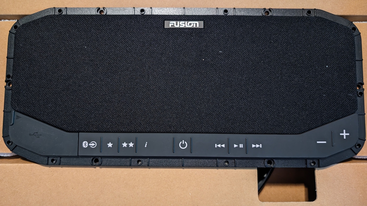

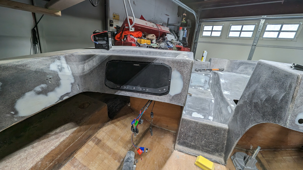

    Radio is here! Its pretty cool, bigger than I thought, but should still fit nice. Going to cut it in this afternoon.
    MGMDesertTaco and RustyGreen like this.
  7. Mar 24, 2024 at 8:55 AM

    Just tested out the speaker in my basement, holy shit this sounds amazing... This was a good choice and I am very very very happy with it. We will see how the bass is out on a lake, I can always add a subwoofer later if needed.

    Radio installed! this thing rocks pretty good. Might look into a small 6.5 inch subwoofer just to round out the bass on the thing when out in the open lake.
    There is a small trim ring that goes around the radio to cover up the screw holes and give it a nice finished look.

    Also I should note, I had to cut the radio in at an angle instead of perfectly level. These 2 pictures show the difference. Putting the radio at a slight angle lets it follow the body lines, its so long that making it level results in it looking really crooked. The sonar is level, so its slightly crooked in the panel, but since its tall and narrow you dont notice it very much.
    This is the radio parallel with the sides of the steps making it perfectly level.
    This one shows it parallel with the top and bottom of the dash, so its slightly tilted with the left side being lower than the right
    RustyGreen likes this.

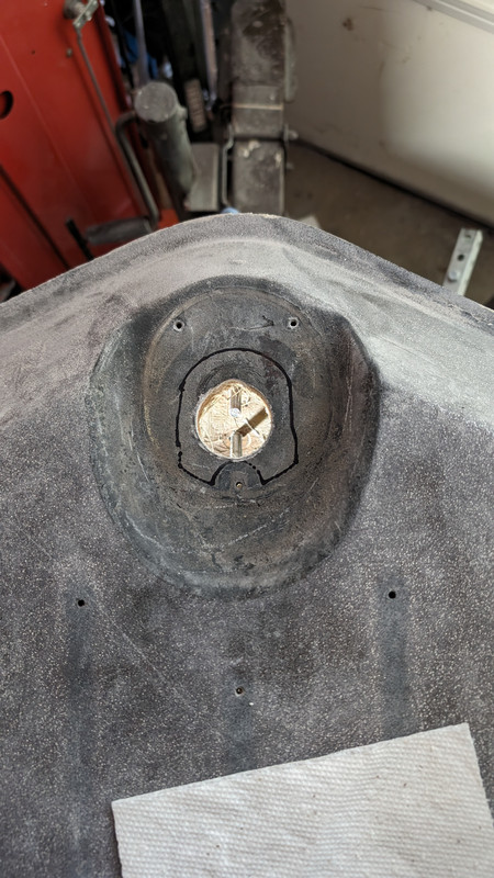

    Cut in the front hatches, but there's a problem, the hole is too small for me to make the turn to get my whole arm in there, I might be able to get the cleats on, but not the bow eye. So, I ordered some 6 inch hatches and some 8 inch hatches. Going to enlarge the holes to 6 inches and try, if I still cant reach then I will boost them up the 8 inches... if I still cant reach then I will have to figure something else out. I can probably put one of these 4 inch hatches in the front center angled part, that would give me the space I need to get to the bow eye, but I just hate the idea of a hatch being visible.
    I have a 6 inch hatch from my kayak, and I am able to stick my arm all the way up in that inside my kayak, so thinking the 6 inch hatches will work for me.

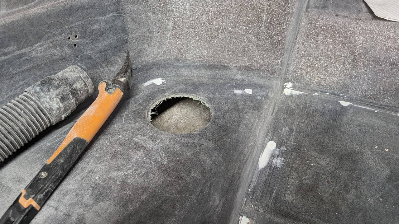

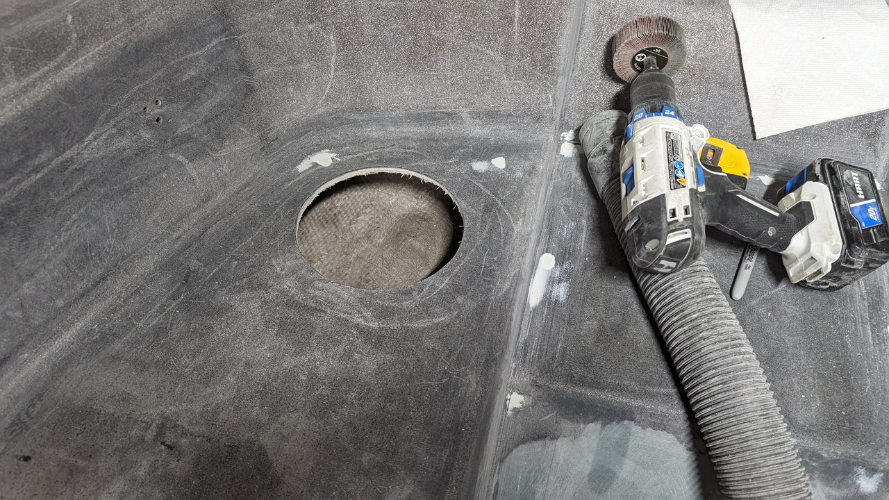

    Alright, I cut in 6 inch holes and I can now reach the cleats, I wasnt able to reach the bow eye, but I also was wearing a thick canvas jacket and didnt want to rub my bare arm on raw fiberglass before bed time. Ill try reaching the bow eye tomorrow, if I cant then I guess I will have to cut in a 4 inch hole in the front center part that Im not happy about.
    There is also a chance I can get to the bow eye by making a hole under the nav lights. It would be just big enough to fit a socket with the nut on it, but its possible.
    I do need to mix up a little bit of resin as the holes I cut went into a little bit of balsa core, so I have to reseal that back up.
    Since I had already cut a 4 inch hole, there was no where for the pilot bit to go to cut the 6 inch hole. I was able to stack the 4 inch and 6 inch bits to allow the 4 inch to ride inside the hole I already made and keep the 6 inch bit centered.

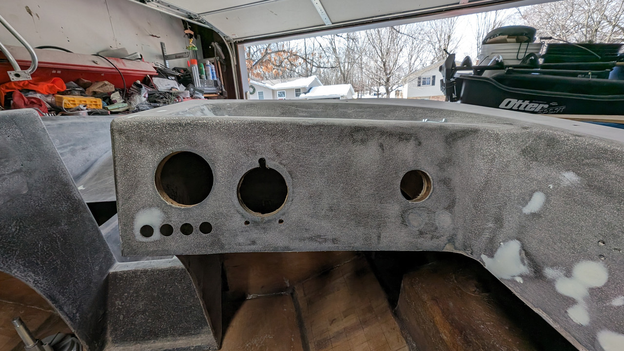

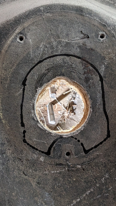

    Front and rear cleats have now been drilled and test fit, I can get to the bolts on the backside of all of them. I used one stock hole for each one, then just drilled a new hole for the other bolt. I could of just used the screws instead of the bolts to mount these cleats, but I really wanted to have the strength of the big backer plate the cleats came with to prevent them from pulling out and causing more damage.
    Also got the bow eye figured out, I was able to cut a hole big enough to fit a socket down with the nuts. Then the nav lights will cover the hole, I do plan to silicone the holes so that water cant go into the light and then into the hole.
    So, really the only holes left to drill are for my 4 gauges in the dash.

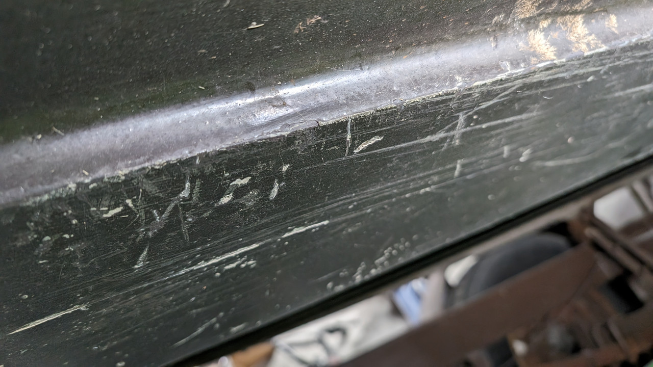

    Alright, so I went under the trailer to get some axle measurements. The axles actually not in as bad of shape as I thought. Leaf springs seems pretty decent too. So, bunks, rollers, wire harness, lights and winch tower will be my start. Need to get wheels and tires (really just need tires, but the wheels are spray painted red and are rusty). Might need hubs, but wont know until I can jack up the trailer to check them. So going to hold on wheels and tires until I check the hubs. If I need hubs I will see if I can get some 5 lug ones that will fit.
    I did find some concerning "paint" and chipping off fiberglass though. So, going to have to clear out the area under the boat and get sanding on it to see whats there. Im like 99% sure that its a keel guard thats flaking off, but I want to make sure.

    Alright here are some close up pictures of the fiberglass that was hanging off. Looks like old weathered carbon fiber thats been underwater for the past 30 years.... But its way too symmetrical to be a hull repair, so I think its some old keel guard that was under there.
