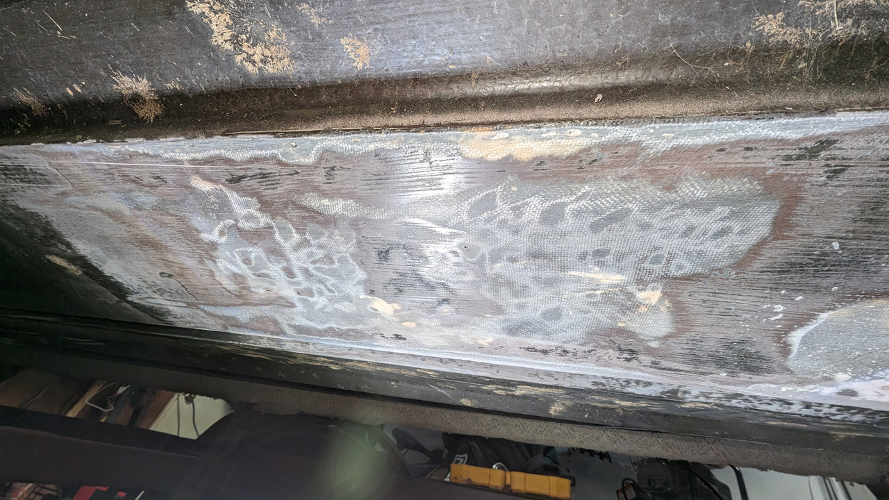

    Alright, little update. I went under the boat again with some more time and space. Everything under there actually looks to be in pretty good shape. I currently have the high output heater blowing at my air compressor to warm it up before I use it (it blows the breaker if its too cold) Im going to get under there with the air block and block out a bit of the pad and see whats under the paint.

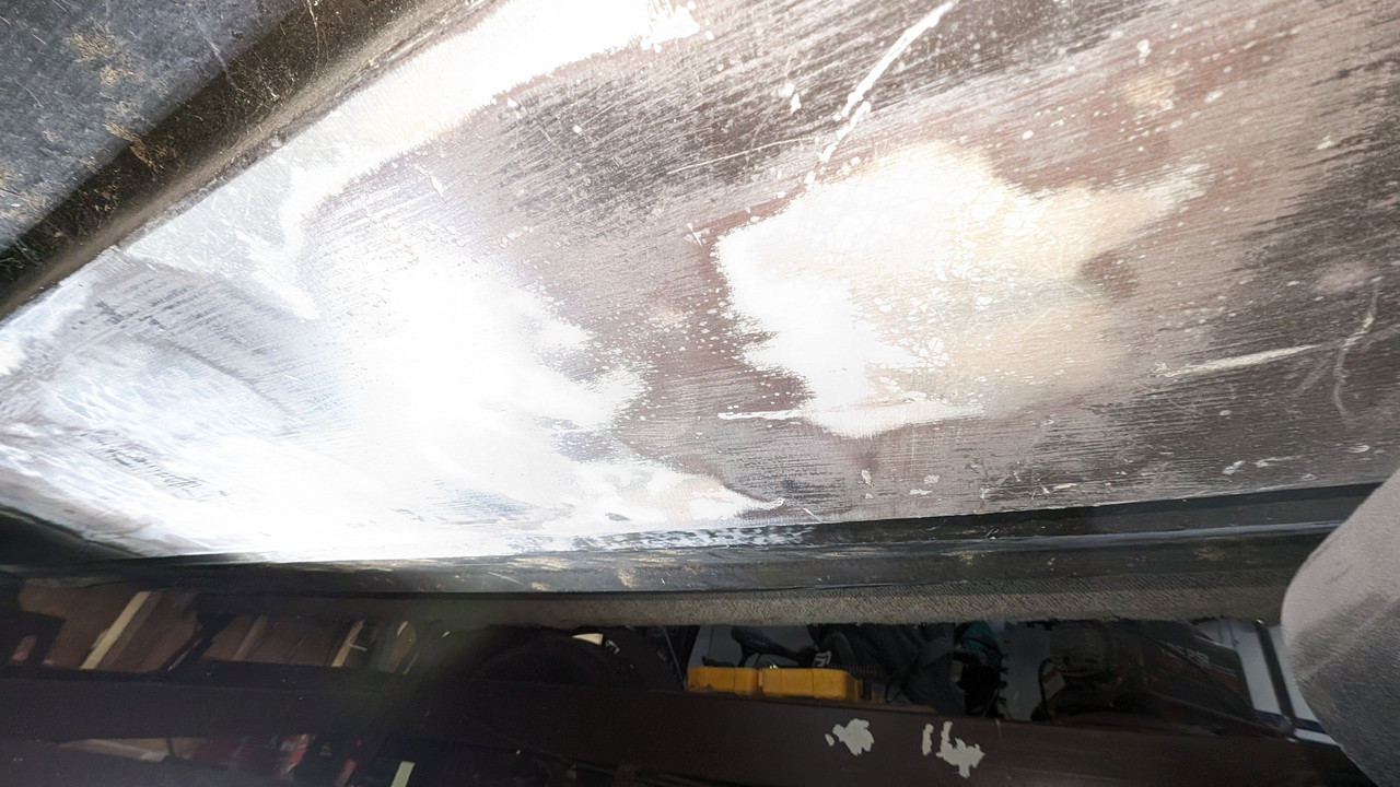

    More updates, somethings goofy under there. I started sanding one of the spots with the air block, its wavy as hell, but there is 4oz weave and chop mat under there. Im going to need to pull the rollers off and block a larger section down to bare glass.
    There was no damage to the keel inside the hull, so if there was damage that was repaired, it seems to of been surface level on the outside. Im going to pull off the middle roller and get back under there tonight and get it down to either gelcoat or bare glass depending on what I hit first.

    Did a little more sanding and said fuck it, this feels like a job I want to do when I can pull the boat out of the garage and its warm out. But, I did find some more clues under there. First picture shows heavy chop mat like the factory would of used, second picture shows 4oz cloth thats not really great for what its being used for here. But there is fairing compound on most of it.

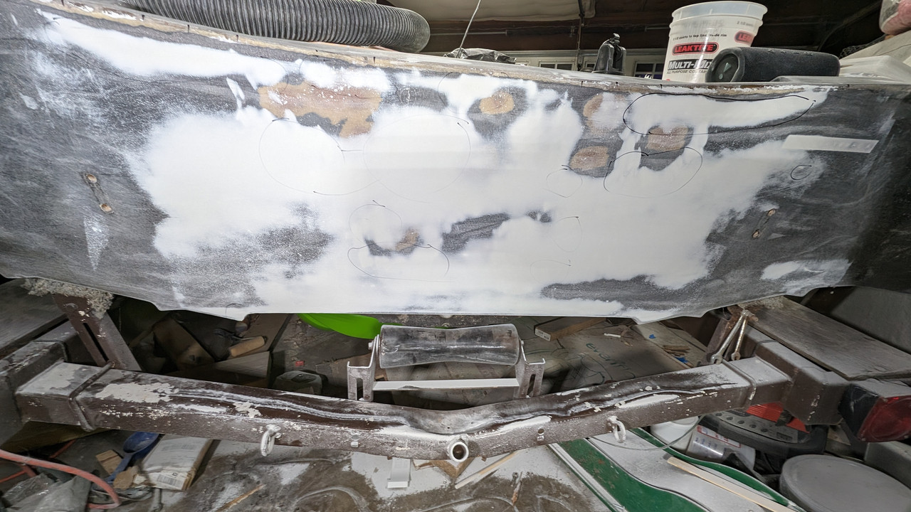

    Took a couple of phone calls, but I finally found a shop that can drill my transom. Amazing how all these boat repair places dont drill transoms. But I got one, $180 and they will drill it for me.

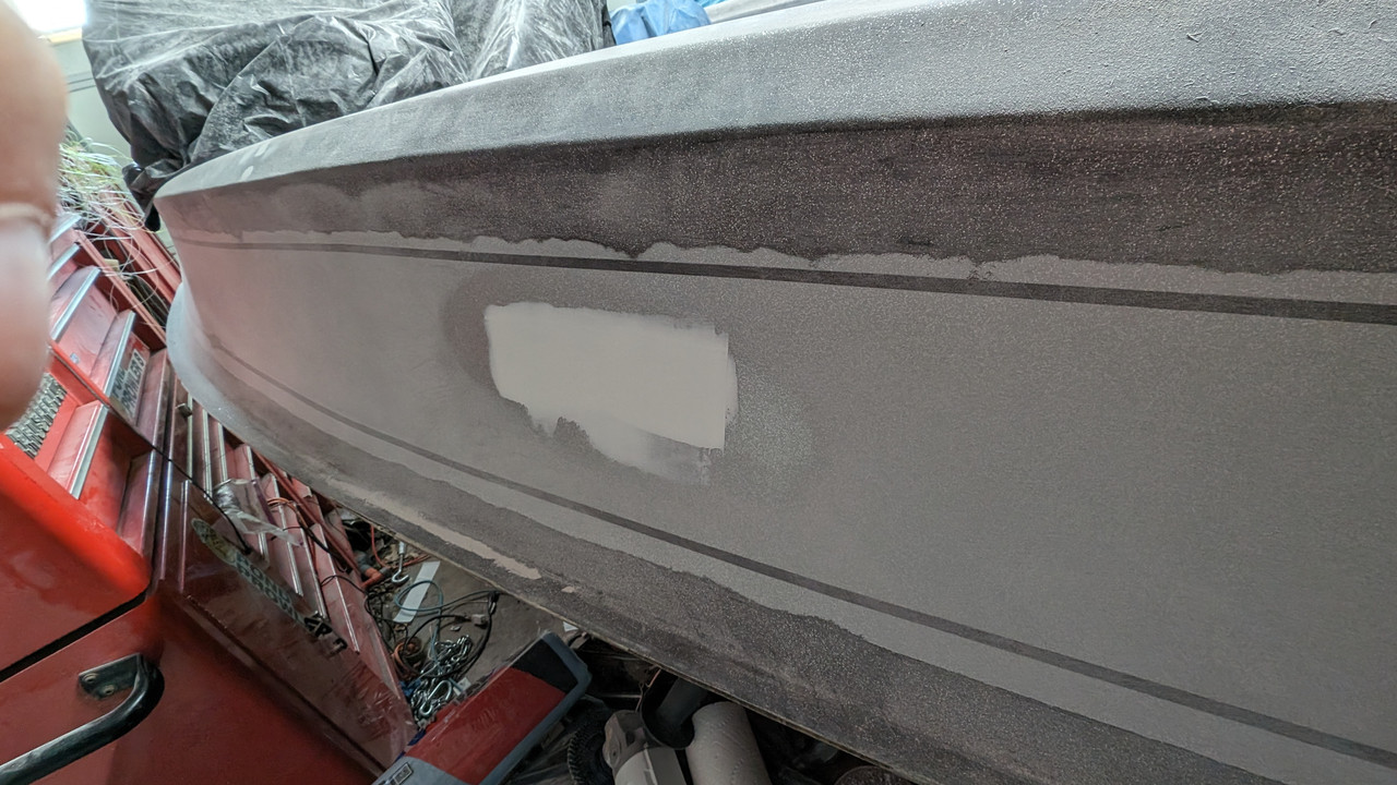

    And there it is. Top of the hull is 100% sanded, 100% blocked. So tonight I will just spend some time putting filler on the transom, then going around the outer topside of the hull and fill in some of the chips and gouges in the gelcoat... There are a couple spots on the right side where the gel is chipped pretty good, then a spot on the left side with a 6 inch gouge in the gel. Then I have 1 spot on the side of the entrance to the steps where I had to use a wire brush to remove a aluminum decal that was covered in resin, its got some deep scratches I want to fill.

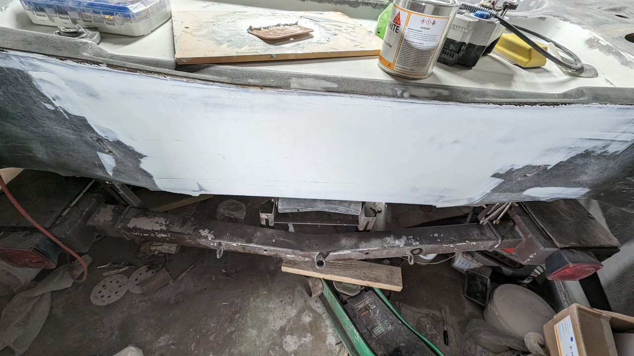

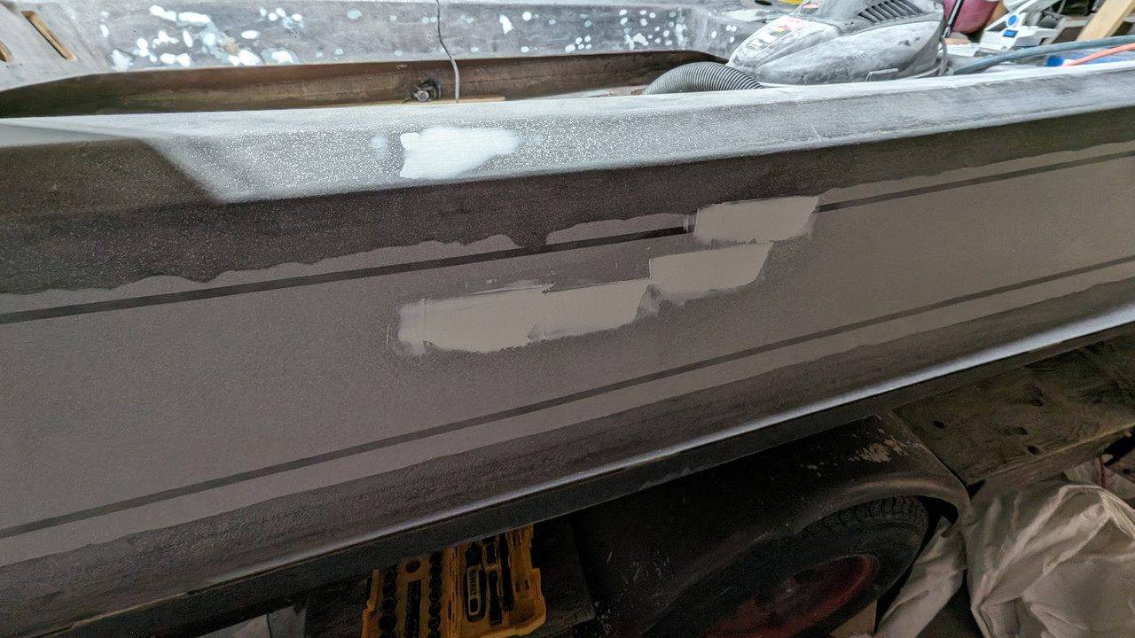

    First layer of filler down on the outer top hull and transom. Once I block it all down, I will check again for level then fill again if need be. Only the center part of the transom really needed filler as its the only part that gets warped with the outboard and tow eyes on it.

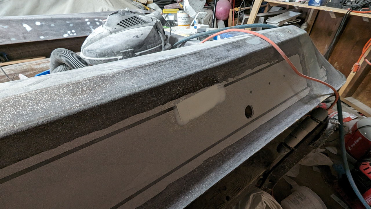

    Forgot to post pictures

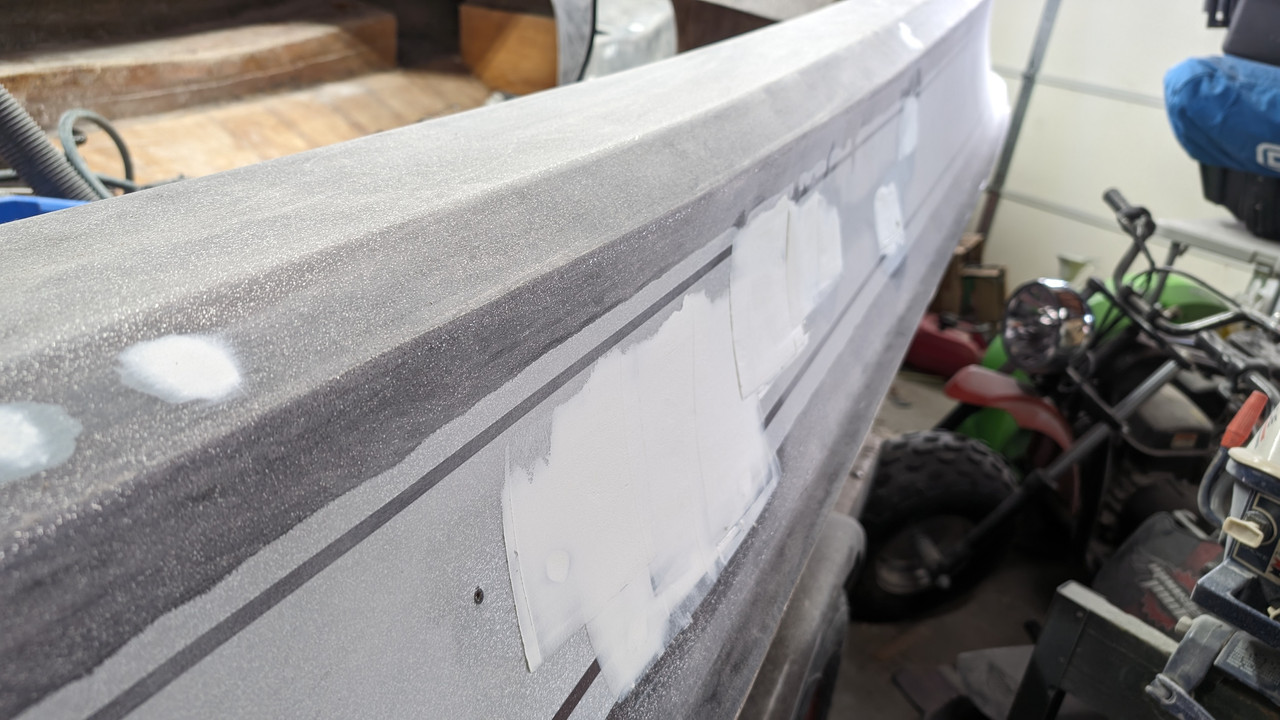

    First pass with the block, Not terrible, the fairing putty is pretty thin So im pretty happy with how close it actually was, but I want to make it better. There are a couple of small low spots, so I will mix up some more filler tomorrow and get those low spots filled in. Also need to block out the sides of the hull tomorrow and check for low spots there too.

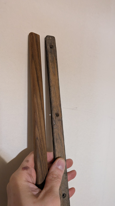

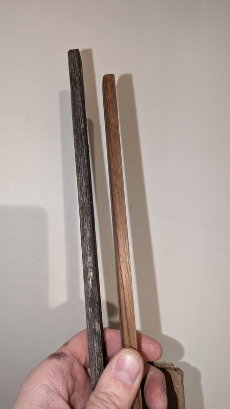

    2018 Inferno Longbed
    Alright, transoms done, sides are done, garage floor is straightened up. Now I just need to pull the boat off the trailer and turn it over to get the bottom of the hull done.
    Teak showed up just now too! Going to have to go buy a nice new blade for my chop saw so I can cut it perfectly.
    New left - old right
    Old left - new right

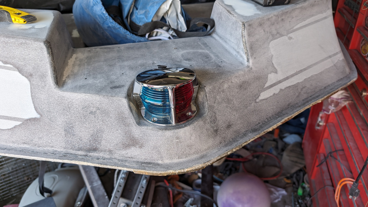

    Nav light came in, wow this thing is pretty. The chrome is perfect, lenses are perfect, even the plug for the top screw is perfect(not installed all the way right now). My old wire and bulb holder screwed right into it and its ready to go!
