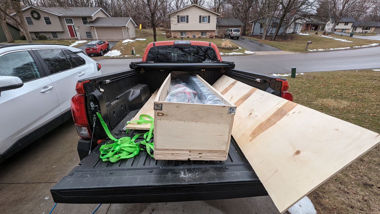

    These are the 2 cranes, the first one is a hair too tall, But this second one is a perfect fit. BTW, neither comes with the crane hook cart thingy, you have to buy that separately. I dont really want that part, as I want to use my 12v atv winch anyways so I can have the remote in one hand and guide the boat with the other hand.

    Alright, 400lbs of crane is now sitting in the garage waiting to be built.
