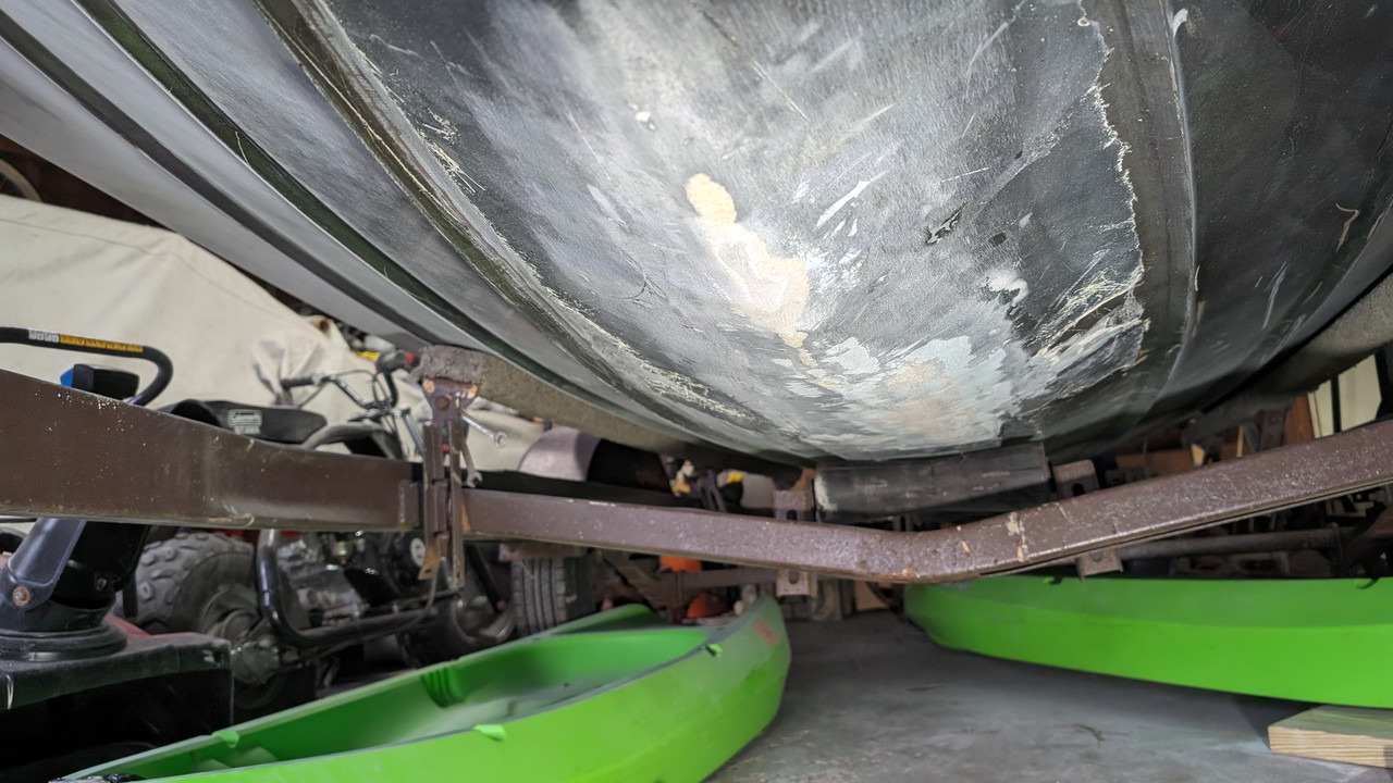

    Holy shit this repair is on a new level of crack head... like this repair makes your corner crack head look like a fucking rocket scientist.... There are 2 cracks in the keel, their repair was not to grind them out, but rather to cover them in bondo, cover the bondo with 4oz cloth with no resin, then more bondo, then chop mat with resin, then more bondo, then oil based house paint.... The repair smells like wood glue, the bondo is still soft, bondo is like a sponge, it soaks up water and should never be used on a boat, especially below the water line.
    I dont think the human race has much time left to live is this is the type of shit people are doing for repairs... like how have the last owners lived this long without killing themselves or others.
    Fuck this is going to set me back some time to get this cleaned up.

    Wow! That is a mess!

    Alright, took me about an hour to fix it right.... took longer to clean up the old repair than it did to repair it right the first time.... 7 layers of chop, 1 layer of 1808 structural, 3 more layers of chop. It will get ground down to about 5 layers worth of glass on the edges and the full 11 layers in the repair cracks.

    Since there was no evidence of damage on the inside that should mean the structure of the boat isn't compromised, correct?
    :fingerscrossed:

    Right, it should be just fine. Also, the fact that the old repair was working just fine despite how terrible it was, makes me think I could of just spray painted some duct tape and been good.

    Fiberglass is mostly cured, I put a layer of duraglass over it so it cures all the way over night (have to block off air from the surface for the resin to cure right). Tomorrow I will hit it with the grinder until its close to where it should be, then I will get back onto cleaning off all the glass the last owner put on so I can get the rest of the bottom cleaned up and ready.
    After finding the first bit of damage, I was thinking this is going to put me way behind, but looks like it only set me back about 2 days.

    After spending some time investigating and looking for clues on the hull and trailer to this boats past, I have determined that these "repairs" were all done sometime from 2005-2006. There is resin drips on the trailer frame, they have been covered up with brown spray paint that the trailer was painted with. There is a registration sticker from 2005 that is spray painted over, and a lake sticker from 2007 that is on top of the brown paint. Now there is also a little bit of brown spray paint overspray on the boat.
    So this leads me to believe that these repairs somehow lasted nearly 20 years.
