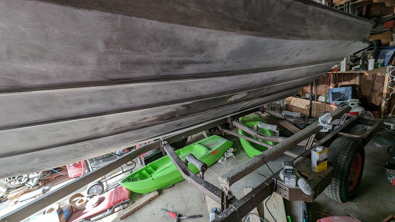

    Some better pictures of the repairs after some more sanding in the area. Looks like I wont be able to get much work done this week and will have to rely on the coming weekend to hopefully finish the bottom of the boat. Between taking my daughter to dance tuesday, tutoring friday, and taking both kids to a water park weds and thurs, I dont really have much time to work. This under hull work is a little more time consuming since I have to take stuff out of the garage, setup the front crane, then lift the boat and roll it over (then reverse all that) each time I need to work on it. But this weekend I should have a good solid 20 hours of open time to spend on it.
    If I can get the whole thing sanded out, blocked, and filled then I should be able to pick up gelcoat next week and start spraying the bottom of the boat next week, give it a few days to cure up in the air before setting it down on new bunks. Then I can start spraying the topside.

    Got about 40% of one side of the hull sanded down today, going to try to do 40% of the other side tomorrow before the water park. Then I only have the remaining 60% of the bottom to finish up. Then I get to go over the bottom of the hull with a fine tooth comb and mark every spot that needs some filler. Not sure how much filler I have left, but I think its enough to finish the bottom of the hull off.

    How thick is the outer skin on the bottom, has it been patched before, if you patch it will it be better than that bondo stuff you removed... I think what I'm getting at is, the bottom is constantly in the water so its GOT to be good. How can you tell it is 100%, or better than new? Are you going to put a new outer skin on it? If you already addressed this just give me the post number and I'll refer to that.:) I'm just curious how strong a patch can be on the underside.

    It varies, but most of it is actually pretty thin, this boat is constructed using a core material, so they can run a thinner fiberglass and still get the same strength. The core is balsa wood that is sandwiched between 2 layers of fiberglass.
    It had been patched, poorly, but the bondo that I had removed was the patch that was done nearly 20 years ago.
    This hull design is unique in the fact that its a open deck style, but the stairs in the front actually link to the hull right where the bow starts. This adds a ton of structure to the front of the boat that normally would have to be built up in fiberglass and core material.
    Kinda, the outer fiberglass skin is good, just needs some patch work done and some sanding. But I will be putting a new outer skin of gelcoat on the hull. This will beef up the hull a bit since it is being applied over the old gelcoat.
    You can make them really strong or really weak, but there is a fine line you want to keep where its not too much where it just adds weight and extra bulk, and where its too thin and cracks.
    In car terms, its like putting military 14 ply tires on your truck or putting 2 ply trailer tires on your truck. One is overkill that would never be used to its potential, the other is too weak and would pop right away. But a 8 ply tire is enough to support the truck up to its own capability.

    ok, Stripping this old glass without damaging the gelcoat under it is proving to be a pain in the ass. Im thinking its going to be easier to just use the grinder and take it all down, then cover the whole area with fairing compound. Its about the same amount of work, just easier work as fairing compound sands much better than glued on fiberglass covered with oil based house paint.
    I did try the heat gun, while it works its takes a ton of scraping and I dont know how it affects the fiberglass under the paint.

    Last ditch effort to get the paint off the bottom of the hull before I hit it with the grinder... Put paint stripper on there. Its kinda working, Im using citrastrip stuff, but I also have the toxic stuff to try out.

    ok, one side is like 90% cleaned up and sanded. I did find a little more damage, its not bad so a couple layers of fiberglass and some filler will do the trick. But I am going to need to get more filler on monday. So this weekend is 100% going to just be sanding and getting everything ready for filler during the week, then gelcoat next weekend. Taking a break now since I have been at it for 7 hours... going to hit the liquor store and also get some dog food.

    Couple pictures from today, nothing super exciting. The spot thats not sanded in these pictures has been sanded. Pictures of the ground out damage on the hull and a picture showing where I need to get filler down to smooth out those angle grinder marks.
