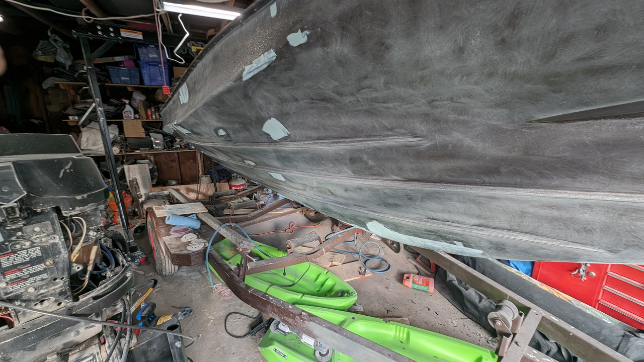

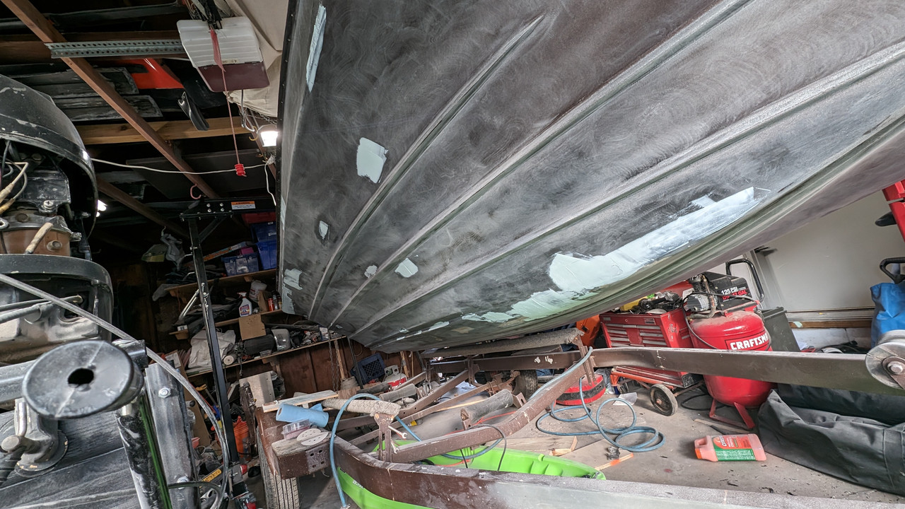

    ok, left side is 100% done, bottom pad is 100% done, little more paint on the right side to take off and I can finish sanding the right side. Then I get to start mixing up filler to get everything smooth and level. There are a fair amount of nicks and chips in on the ribs under the boat, so I will have to spend some time marking out every bit that needs to be filled. Going to be a long week of filling and sanding.

    First layer of filler on the right side of the hull is down. Going to let it cure then I will start sanding again, I am doing the filler in stages, so there are spots that have no filler, spots that have not enough filler and spots with just enough filler. This will allow me to sand the filler, if a spot needs more I can add more to it when I fill the spots that have no filler. Doing it this way results in the least amount of wasted filler as when the filler starts kicking off, I can quickly spread it over a spot with no filler and not worry about being perfect with the application.
    So, the spots on the right side that needed filler ended up being 4 screw holes, the patches on the keel, a couple of dock rash marks, and where they loaded the trailer wrong and the fender rubbed the fiberglass pretty good. Also a bunch of misc scratches and chips in the gelcoat.
    I went over the whole bottom with 60 grit, when I sand this filler I will be switching over to 80 grit and sanding over the entire bottom again.
