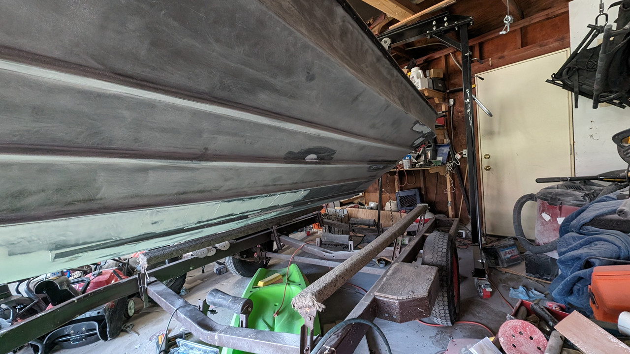

    Next layer on, had a couple of spots that needed more filler, so some went there, but the bulk went onto the keel.

    2nd layer sanded and cleaned up. Tomorrow I will start on the other side of the hull and continue to put filler on the keel and bow. The keel is a concave shape that flattens out near the bow, so I will have to get that close to right. The final sanding and filling on the keel will be done with the boat level instead of tilted like I have been working on it. This will let me get a better look at how straight it all is. But doing it that way means I get to lay on my back while all the dust from sanding falls right on my face.... Thinking I might setup the box fan to blow it all away as it falls.
    Then last thing will be to go over the bottom of the hull with a flashlight and mark out any little spots I might of missed.

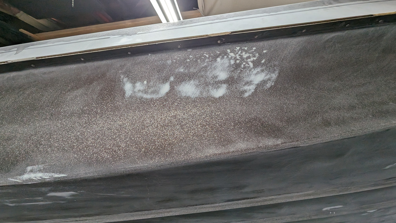

    Filler down, I got most of the spots, but I will need to go back over it again after I sand. There are less spots on this side of the hull, but they are bigger than the other side.
