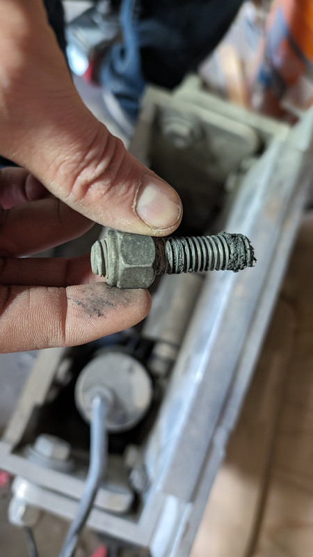

    So while the filler cures more, I decided to clean up my tilt and trim plate. The main bolt that holds the ram to the plate was bent, so I figured lets figure this out.... yeah, it was not bent, it was broken in half! This is the bolt that keeps the ram attached to the plate.... I dont even know how this didnt fall apart at this point.
    This thing was 3 good waves away from falling off the back of the boat.

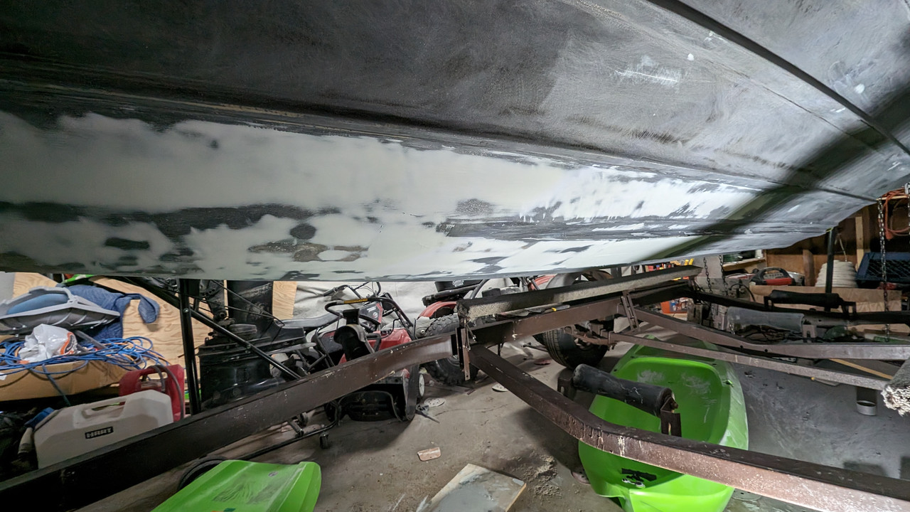

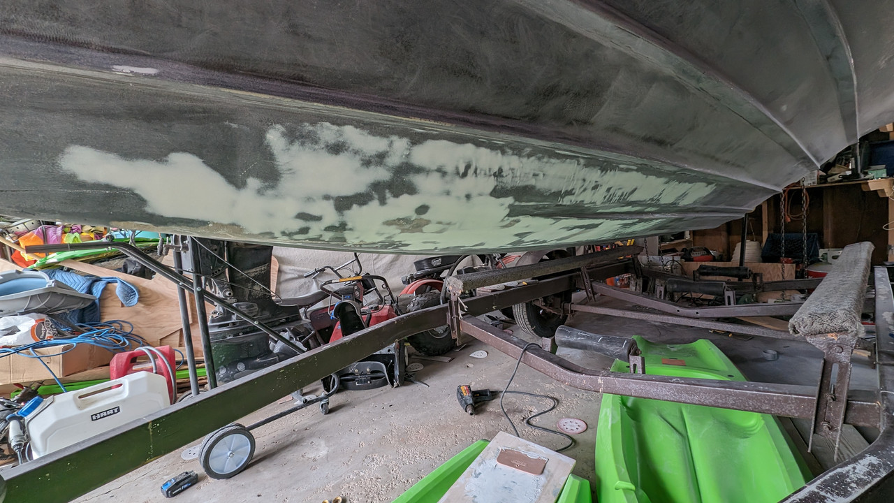

    First layer sanded nice, couple of low spots so I put some more filler on then the weather turned... drop 20 degrees in less than a hour. So the filler is taking longer to cure and I have to wait a bit.

    Second layer of filler sanded, adding a 3rd layer to finish getting some of the pad straight. I think one more layer over the whole front area and some hand blocking and it should be good to go.

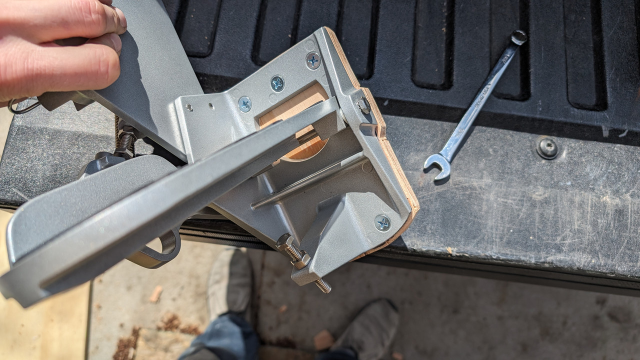

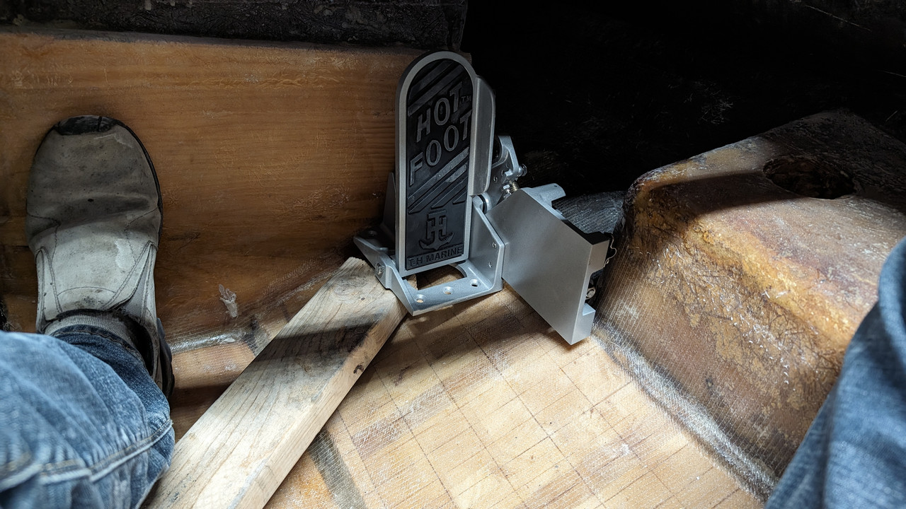

    Got my throttle figured out, and its more or less universal for motors and it was cheaper than getting a new control for the motor I have. Cabelas had the hot foot in stock, and they price matched Amazon for $100 off.
    This is a foot pedal control for throttle, gets rid of the clunky hand throttle and allows me to keep both hands on the wheel while driving. Pretty much all the hydrostream owners on facebook agree that this is the way to go on these boats.
    So, now I have some new fiberglass work I need to do, going to make a platform for this unit, Also goin to trim out part of that float box to give clearance for the cable to come off it.

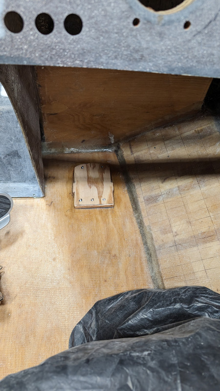

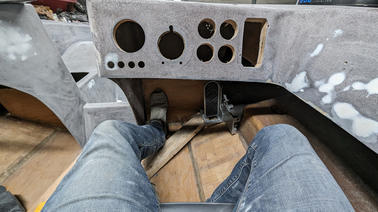

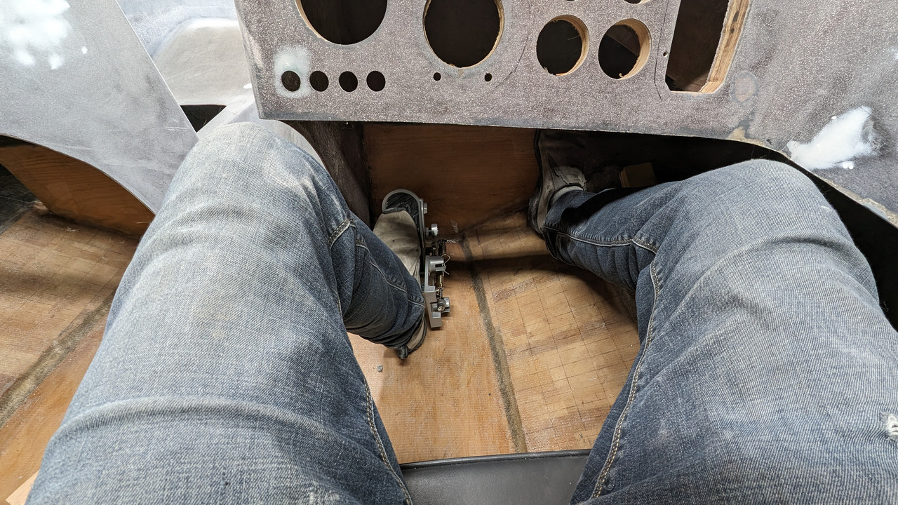

    Base made for the pedal. Still trying to decide on the best location. I would like to put it on the right side, but its just a bad angle and my leg cramps up trying to use it up there. Most people with these boats end up running the pedal on the left side and just use their left foot. So, I think I am going to make 2 bases. One will be on the left side and one on the right side. I will glass them both in and see which one I like better, but I will always have the option to switch between the 2 mounting spots.
    But this base is made the same way as my seat base was but its thinner wood since it doesnt need to support my weight.

    While I dont like it a ton, it feels like the best option here and will used to it. My only real concern is the throttle cable coming off it will go right under my seat and then need to go up to the gunnel where it can go out to the motor.

    Got some work done today, this bottom is proving to be a pain to flatten out, but I think im on the last fill as its 90% smooth and level.
    I do have to be in the office tomorrow, so that sucks as I wanted to get my primer tomorrow. Guess I will get it Wednesday and start painting wed and thursday evening.

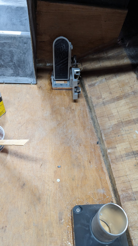

    Alright, bottom is good! Since I have all night still, I am going to bond the hot foot pedal down to the floor so its all set and ready for the motor.

    Pedal bonding right now, used ample thickened resin to make sure its fully on there. Should be cured by later tonight and I can take the screws out and remove the pedal and put a layer of resin over the top to seal it all up.
