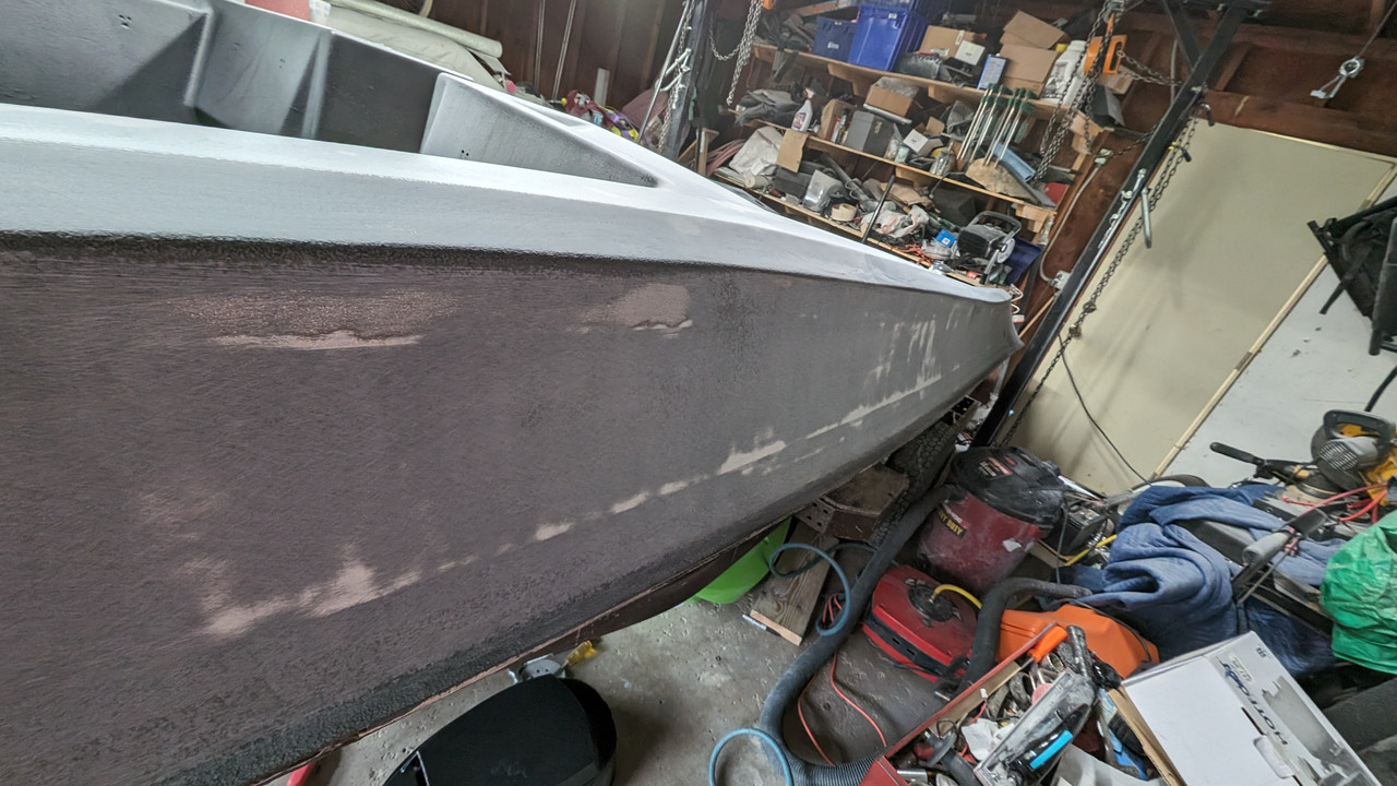

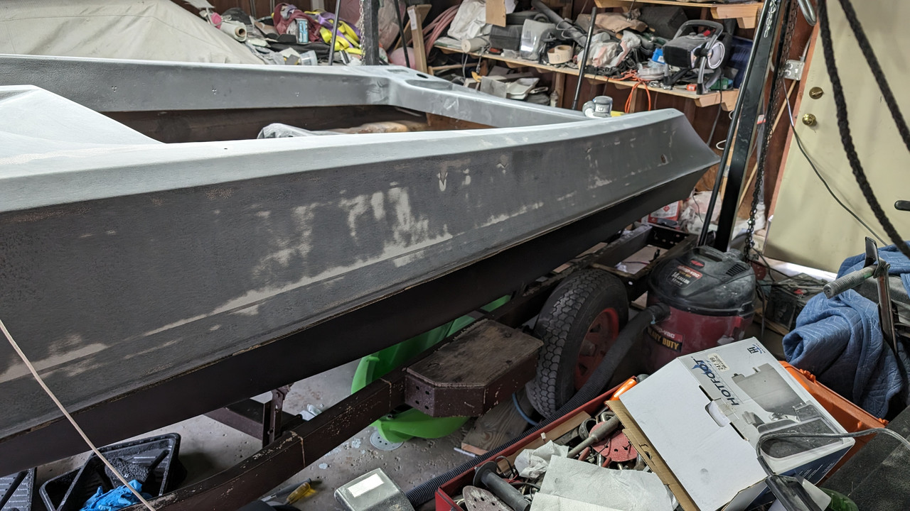

    Alright, one side mostly done, going to sand out the other side then sand the lounge. The lounge I am not concerned about it being that super straight as there will be panels on the walls, cushions on the seats, and carpet over the stairs. Once I have the other side sanded out then I will mix up some more primer and give it another coating and block it all out again.
    You can see the area in the pictures that are a darker black vs dull gray, those are the low spots. Plan is to put a coat over each of the low spots, let it flash over then put another coat over the entire thing. I need to get more rollers, but I am thinking of getting foam rollers as they produce a smoother finish. Its a thinner finish, but its smoother and will require less sanding to get flat.
    Foam rollers tend to fall apart from the resin, so I have to work fast before the roller falls apart.
    This boat is going to be so ridiculously straight when its done. Im hoping for the perfect glass finish on the top half of the deck, the bottom can be "good enough" since it will mostly be under water.
