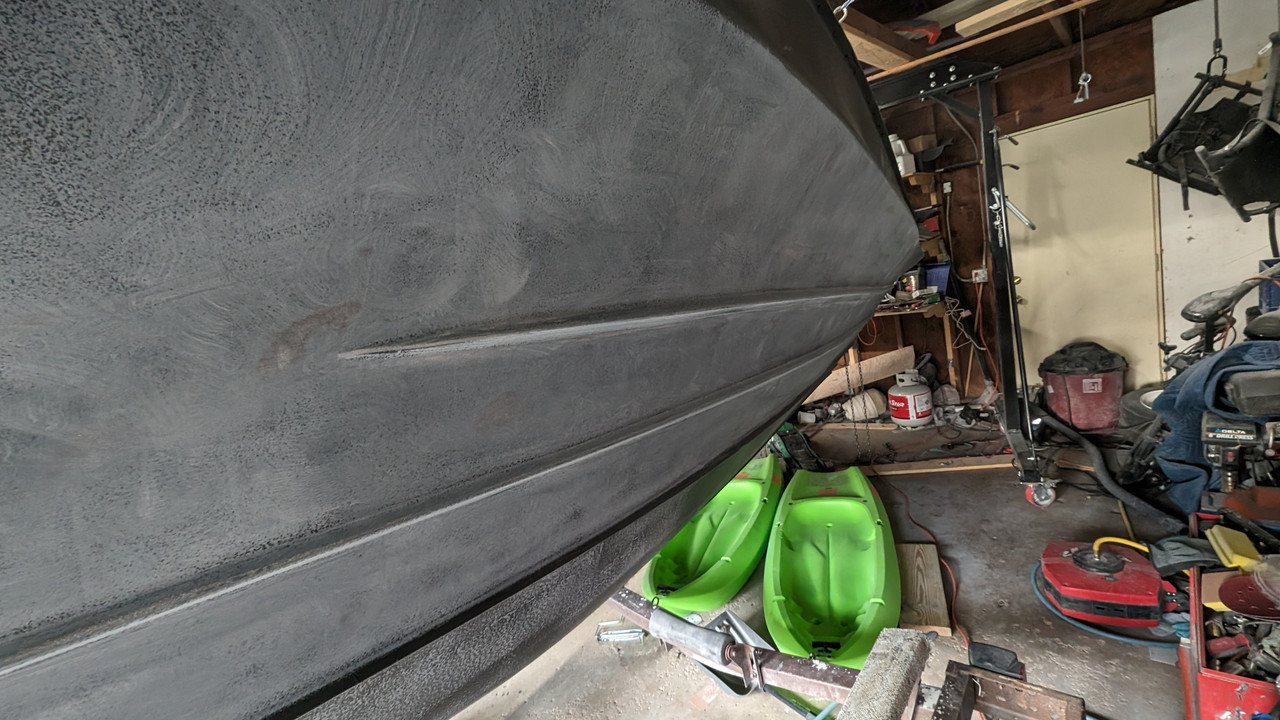

    Also, nice glamor shot of the boat as it sits right now. Hoping to get blocking the bottom half tomorrow afternoon, then this weekend I am out of town for a fly fishing trip, so what I dont finish tomorrow will have to wait till monday. I think I will probably try to pick up the gelcoat on tuesday as I have wed and thurs open after work to spray it.

    ok, this sucks... sanding this bottom is going to take some more time than I had planned. On the plus side, the bottom doesnt need to be 100% perfect like the topside, so good enough is infact good enough.

    So done for the night.... too fucking much sanding, I got a good chunk of the left side of the boat done. I need to do the keel and the upper sides of the bottom, then I can start on the other side.
