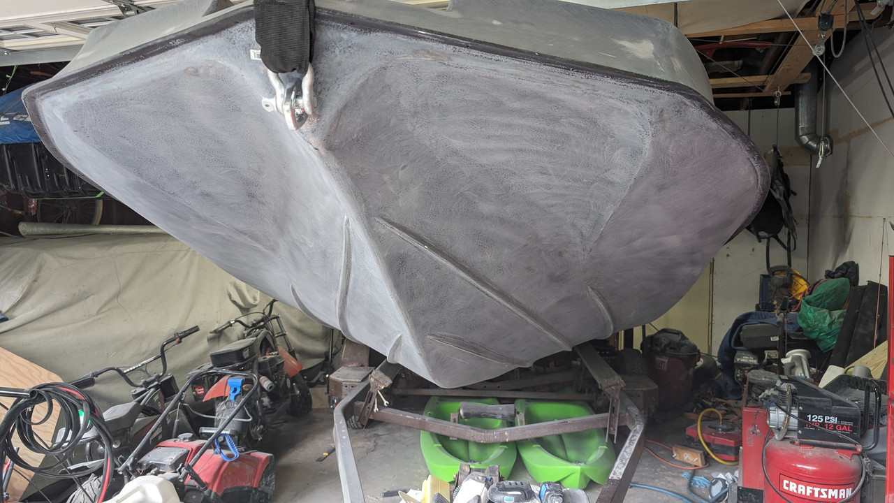

    Ok, there it is. Primer is sanded and done. Going to pick up gelcoat tomorrow or friday and get it all ready to spray!
    I do need to figure out my air compressor though, its causing me some issues by struggling when it gets over 50psi. It might be a power issue as the outlets I am plugged into are a bit shifty, so I am going to bring home the gas generator and try that for some better power. If that doesnt work I might just grab another big air compressor and get rid of the 2 I already have (the small craftsman in the pictures I got for free, never actually used it, but its been taking up space for the past 12 years)

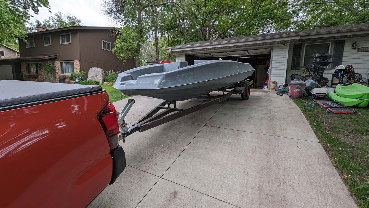

    Boat pulled out, cleaned all the dust up from the boat and the garage. Got it lifted up and the trailer pulled out. Just need to run and get more acetone, tape and plastic drop cloth so I can get the bottom all wiped down and the top all sealed up.

    Slight delay while I try to figure out a random grease stain on the underside of the hull. Rather large stain appeared on the bottom of the hull, not really sure where it came from or what the deal with it is. I cleaned it up and sanded it, but I want to let it sit for a bit to see if it comes back.
