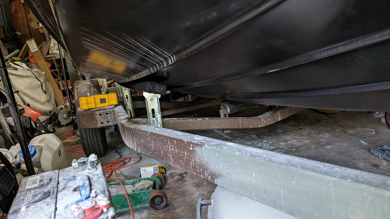

  3. May 21, 2024 at 8:44 PM
    #703
    5nahalf
    5nahalf [OP] I build dumb things
    Sep 22, 2018
    #267058
    11,000
    Erik
    Minnesota
    2018 Inferno Longbed
    So I put my new bunks on tonight, I need 2.5 inch x 5 inch square u-bolts.... yeah, thats not a easy size to find it seems and every online retailer has horse shit descriptions of the bolts they sell. I got some 3 inch ones, they kinda work for now, there is a half inch gap between the top of the bolt and the top of the beam. Im going to try putting the bunk mounts at an angle and see if there is enough space between the hull and the fenders.
    EDIT: just tried out the bunks, yeah, too low. Guess the 12 inch bunk mounts are what I need. So tomorrow I will go grab six 12 inch bunk mounts, do a quick swap and then I can place them in the correct spots while I have the boat in the air.
    Also, the bunk mounts need to be angled in the rear and kinda straight in the front to get the bunks to line up right with the hull.
    RustyGreen likes this.
  4. May 22, 2024 at 2:04 PM
    #704
    5nahalf
    Sep 22, 2018
    #267058
    11,000
    Erik
    Minnesota
    Alright, bunks are on and mostly adjusted right. I will have to redo them again when I paint the trailer, but with the boat back on the trailer I can start prepping the topside to spray on saturday.

  6. May 23, 2024 at 1:42 PM
    #706
    5nahalf
    Sep 22, 2018
    #267058
    11,000
    Erik
    Minnesota
    Came across a little problem, but I am glad I caught it now as its easier to solve. So I need to spray the transom and the nose with black gelcoat before I can do the top side. Boat has to be on the trailer for this, but the bunks sick out of the back of the boat a few inches. If I were to just gelcoat it now, I would end up gelcoating the bunks to the bottom of the transom. So, since I still have the transom eyes on, I will be lifting the back of the boat and scooting it back far enough that the bunks are not near the transom. At the same time I can put some plastic sheeting on the bunks to keep the trailer from getting sprayed with gelcoat too.

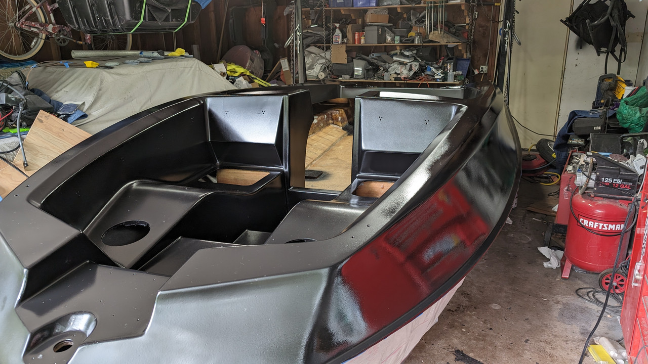

  11. May 25, 2024 at 2:03 PM
    #711
    5nahalf
    Sep 22, 2018
    #267058
    11,000
    Erik
    Minnesota

  13. May 25, 2024 at 3:42 PM
    #713
    5nahalf
    Sep 22, 2018
    #267058
    11,000
    Erik
    Minnesota
    Clear and glitter are on, not sure what the glitter looks like as its a cloudy dull day... so I will have to wait till tomorrow. Waiting on the sides to cure so I can clear the lounge area. I couldnt reach it from the outside, so I have to get inside to do it.
  14. May 25, 2024 at 4:06 PM
    #714
    5nahalf
    Sep 22, 2018
    #267058
    11,000
    Erik
    Minnesota
    Now we let it sit and cure for awhile, then I can start wet sanding the whole thing again... I used a 50:50 mix on the clear coat with duratec, so it should cure without PVA on there. Hoping that actually happens, otherwise I guess I will spray the whole thing with PVA tonight.

  15. May 25, 2024 at 6:53 PM
    #715
    5nahalf
    Sep 22, 2018
    #267058
    11,000
    Erik
    Minnesota
    Alright, nearly 3 hours later and the surface is still tacky.... I just sprayed a bunch of PVA over the whole surface, even though they say its not needed... im not going to be pleased if this shit doesnt harden and im stuck with a mess to clean up.
  16. May 26, 2024 at 7:28 AM
    #716
    5nahalf
    Sep 22, 2018
    #267058
    11,000
    Erik
    Minnesota
    Fresh in the morning, I went out and cleaned off the PVA, gelcoat has cured! I am going to wet sand the whole thing today and get it buffed up to a nice gloss.

  17. May 26, 2024 at 8:36 AM
    #717
    5nahalf
    Sep 22, 2018
    #267058
    11,000
    Erik
    Minnesota
    Ok, so after wet sanding a part of the hull, I have decided I did not put the clear or the glitter on thick enough... not by a long shot. So, I will be wet sanding the whole thing smooth, mixing up the rest of the clear and glitter I have and putting it on until there is nothing left.

  18. May 26, 2024 at 2:15 PM
    #718
    5nahalf
    Sep 22, 2018
    #267058
    11,000
    Erik
    Minnesota
    New problem, the clear didnt setup right at all, so when I wiped it all down with acetone it turned into a sticky mess. Welp, guess I am going straight black, no sparkle.
  19. May 26, 2024 at 3:56 PM
    #719
    5nahalf
    Sep 22, 2018
    #267058
    11,000
    Erik
    Minnesota
    ok, the whole boat has been painted black again.... but this time I added glitter to the black... not sure what will happen, but the black was not 100% black, it is like a tinted window. So I am hoping the glitter shows through in the sunlight.

  20. May 26, 2024 at 5:06 PM
    #720
    5nahalf
    Sep 22, 2018
    #267058
    11,000
    Erik
    Minnesota
    Its curing! its hard in most places, so looks like we got a working finish on it. Going to wet sand it all out again and buff it tomorrow. Then I get to start wiring and installing gauges and the radio.
